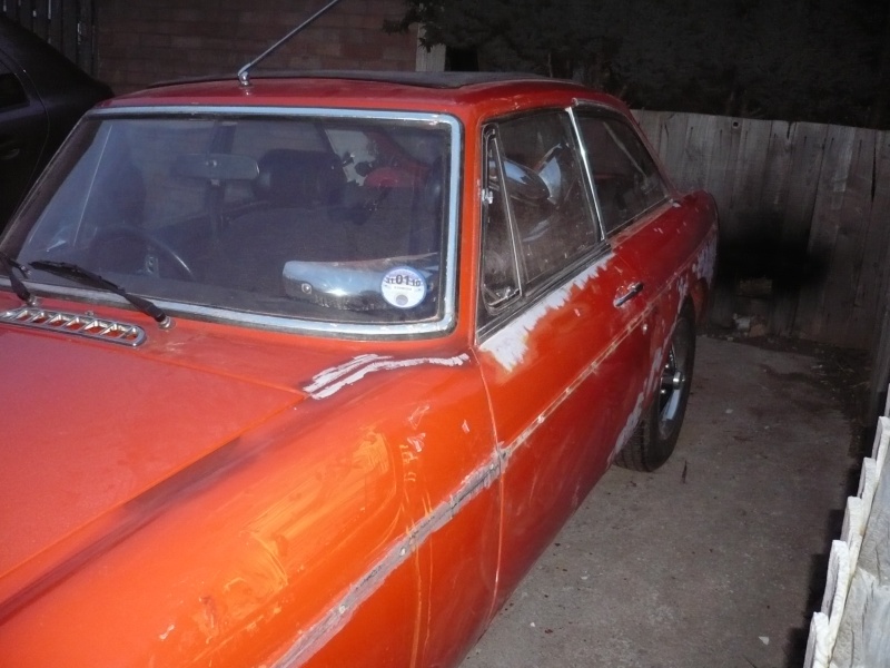

That's what I thought at the time, but the cellulose reacted to the underlying coat after a few months and I got shrinkage and previous sanding lines started showing through the top coat. I attempted wet sanding but had to cut so deep through the surface the primer started showing through.
The following year I consulted the guy at the local car paint shop and he advised apply a coat of Barcoat to provide a barrier layer between a fresh topcoat and the underneath layers
The worst affected areas were given a coat of Barcoat barrier paint.
A big problem with Barcoat is that you are supposed not to flat it back after spraying, it's quite thick so it's very difficult to get a decent finish on which to lay on a topcoat. Anyway, a best effort job was done and the topcoat was flatted back to once again look quite presentable.
Unfortunately, a year later the shrinkage problem was still reoccurring, although no as bad this time. Seeing a ray of hope I decided last Spring to add another layer of Barcoat and another topcoat as I figured I many not have laid on the original Barcoat thick enough. Sadly a few months in to the none-too-scorching British Summer sun the shrinkage again started to occur although this time is mostly manifested as a dulling of the paint, although the tops of the wings (fenders) and doors still shrunk quite bad.
Looking at the dull paintwork whilst the car was in raised up on a two-post car lift at a local repairer I decided that the jaded paint was something of an embarrassment and coating the car again with cellulose would probably be futile, so I started to look at alternatives. The most obvious solution would be to have the car stripped back and resprayed with 2-pack, but this is not a DIY option and a decent professional job would coat far more than the car's worth. Remembering back to my youth I recall brush painting an old Morris Minor Traveller (woody) with a a paint called 'Re-Paint' and it actually looked rather good. It whilst while researching for the availability of 'Re-Paint' that I came across the idea of hand painting a car using Rustoleum and a simple gloss roller and from there to this site!
Seeing some of the superb results online and with the hope that an oil-based paint will not react like cellulose, I decided to have a go on the MG using this method...

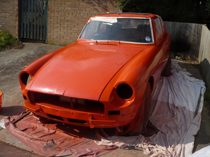

With early lessons learnt, it's on to the second coat.
Post by Mike MGBGT on May 21st 2012, 6:37 pm
For the second coat I mixed the paint down to about 70/30 paint/thinner mix. This gave much better results than the first coat and the car was starting to look reinvigorated.
To prevent any more paint dripping on the concrete I laid down sheets which I also dampened lightly to help contain any dust.
Only two coats, but I can see the car is going to look good in this colour (RAL3020).
Still some orange peel, but much better than the first coat. I had cleaned it off here, but I had a problem with paint seepage under the masking tape.
After the second coat had hardened off over night I flattened the car back with 320 grit wet-and-dry.
For the third coat I thinned the paint down to about 70/30 paint thinner mix. After the problems with the masking tape I decided to abandon using it and instead cut in using a Harris perfection 1" brush. I tried the foam brushes but aside from quickly falling apart I find I get a much better result using the Harris brush. I also felt confident enough now not to bother with the sheets under the car and besides I was tripping on them too often whilst laying on the paint.
Still some orange peel, but it's at an acceptable level now.
