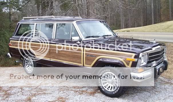

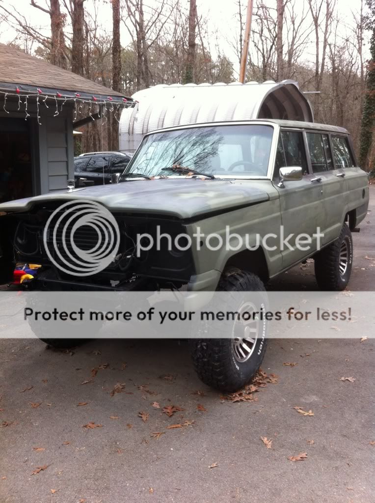

Its time I jump into the mix with my 91 FSJ Grand Wagoneer...

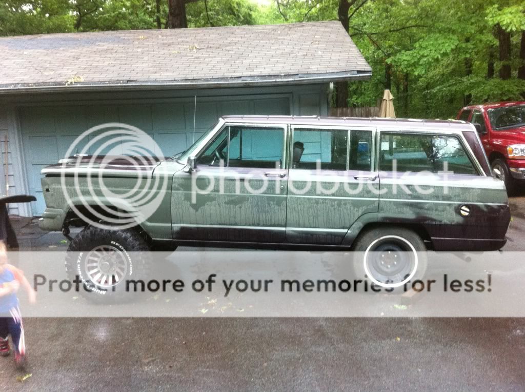

This was about two years before I bought her.
She wasn't this nice when I got her home clear coat was shot and rust was under the wood vinyl in some areas.
Being a family man funds are rare. So I knew it was up to me to bring her back from the dead. It was a LONG process due to my family duties and no Shop.
I found this website which was a blessing. Here are some pics of getting her right and making her mine enjoy.
I stripped the wood Vinyl off... Not Easy...

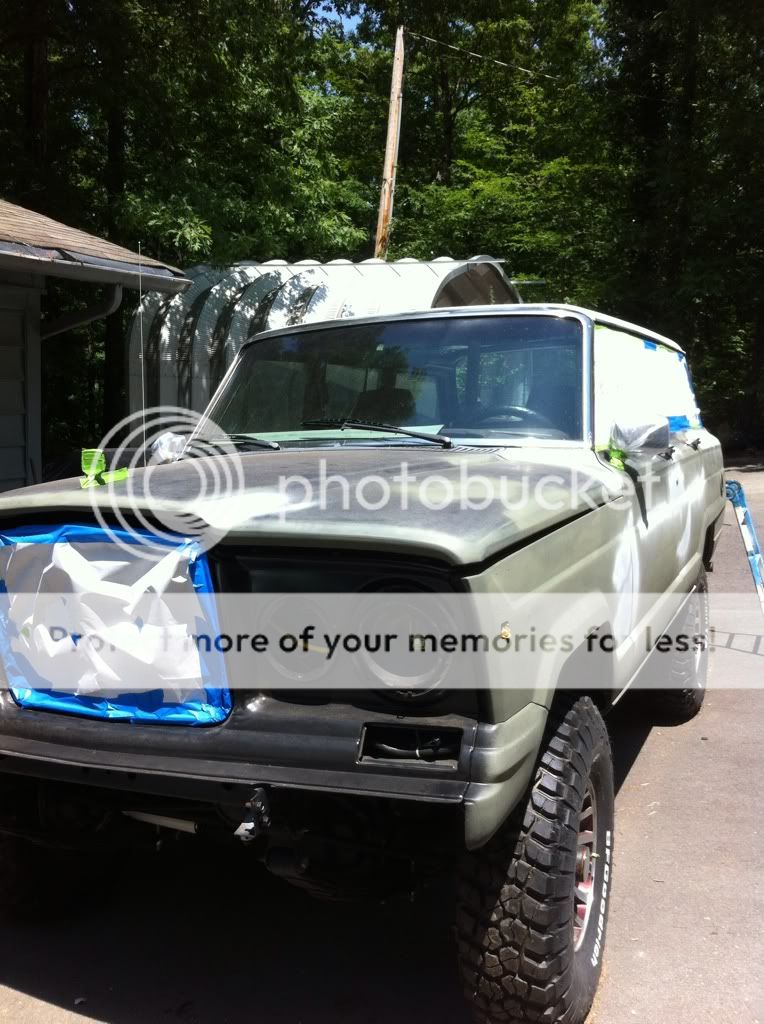

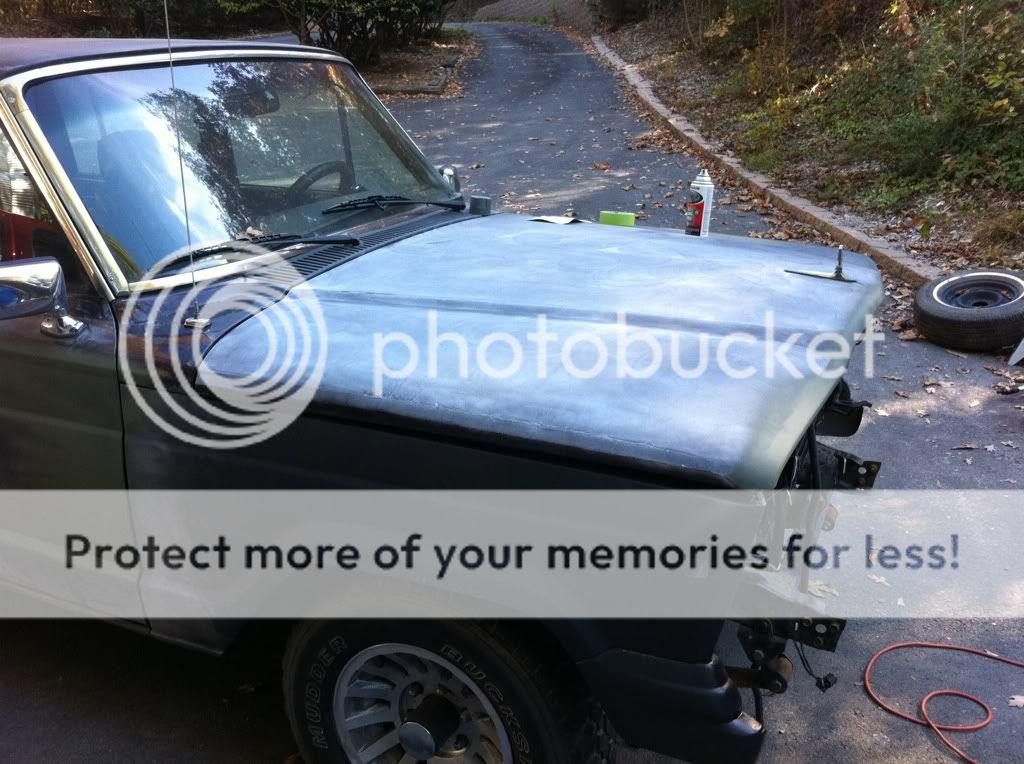

Sanded and primed her removed the few small dents and replaced passenger front fender.
I gave her a facelift with a Rhino grill.
then a 6 inch lift.
Lots of sanding and priming. Shes a big canvas to work on...

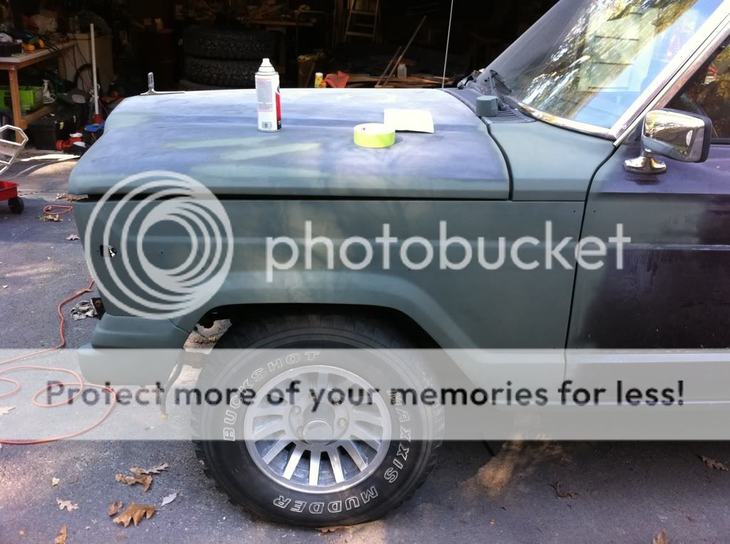

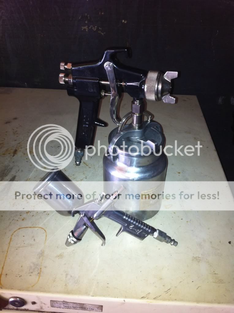

I used cheap set up for spraying all from Harbor Freight.

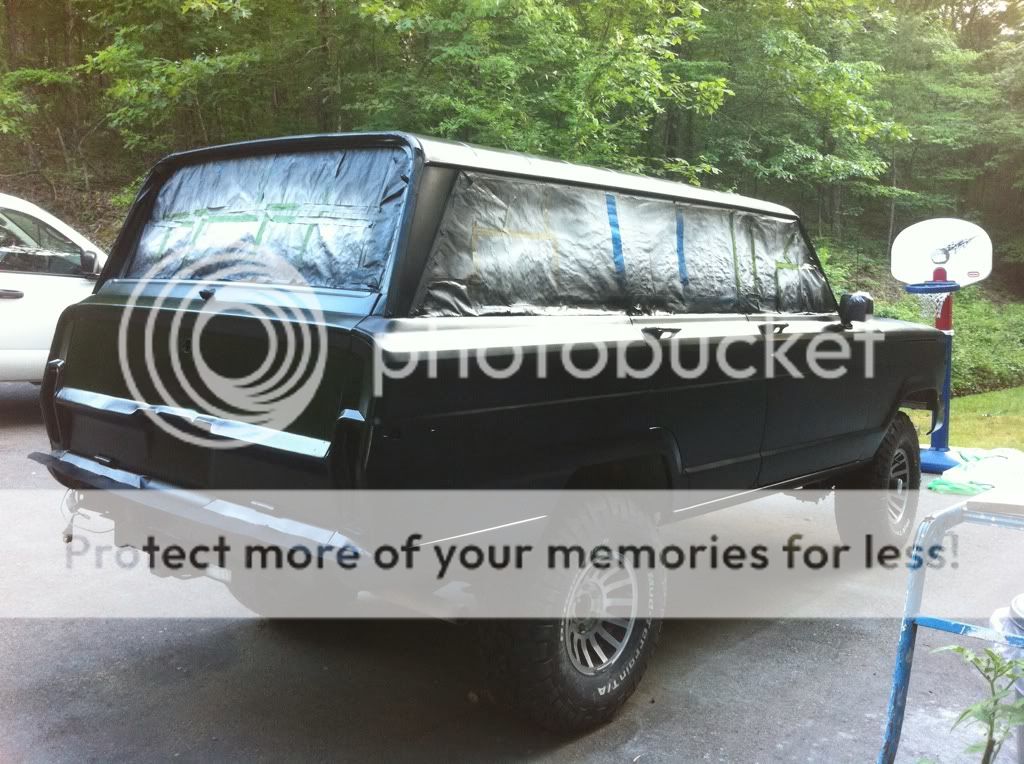

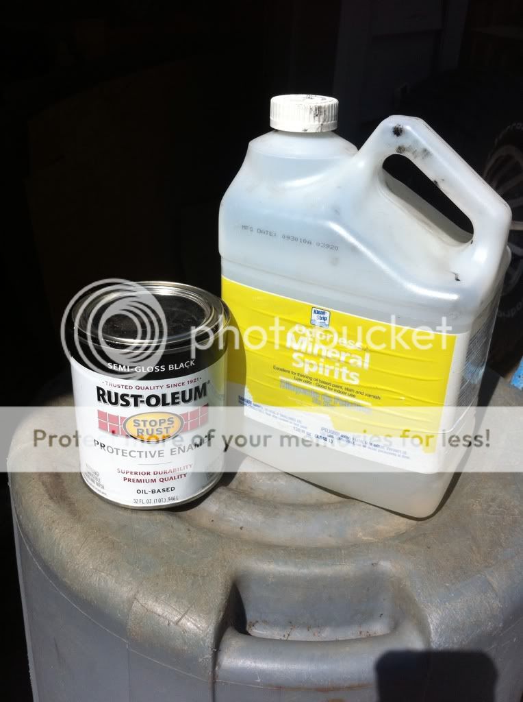

I sanded all the tired paint off. Primed her with self etching Rust-Oleum rattle bombs then sprayed it 4 to 5 coats in 95 degree weather over the holiday weekend outside.
My mixture was 1/4 Mineral Spirits to 3/4 Rust-Oleum. I was amazed on how it turned out so has everyone else who has seen it.

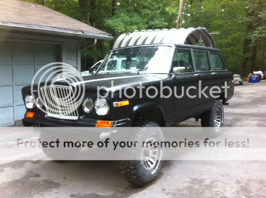

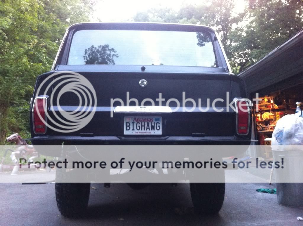

Her she is...

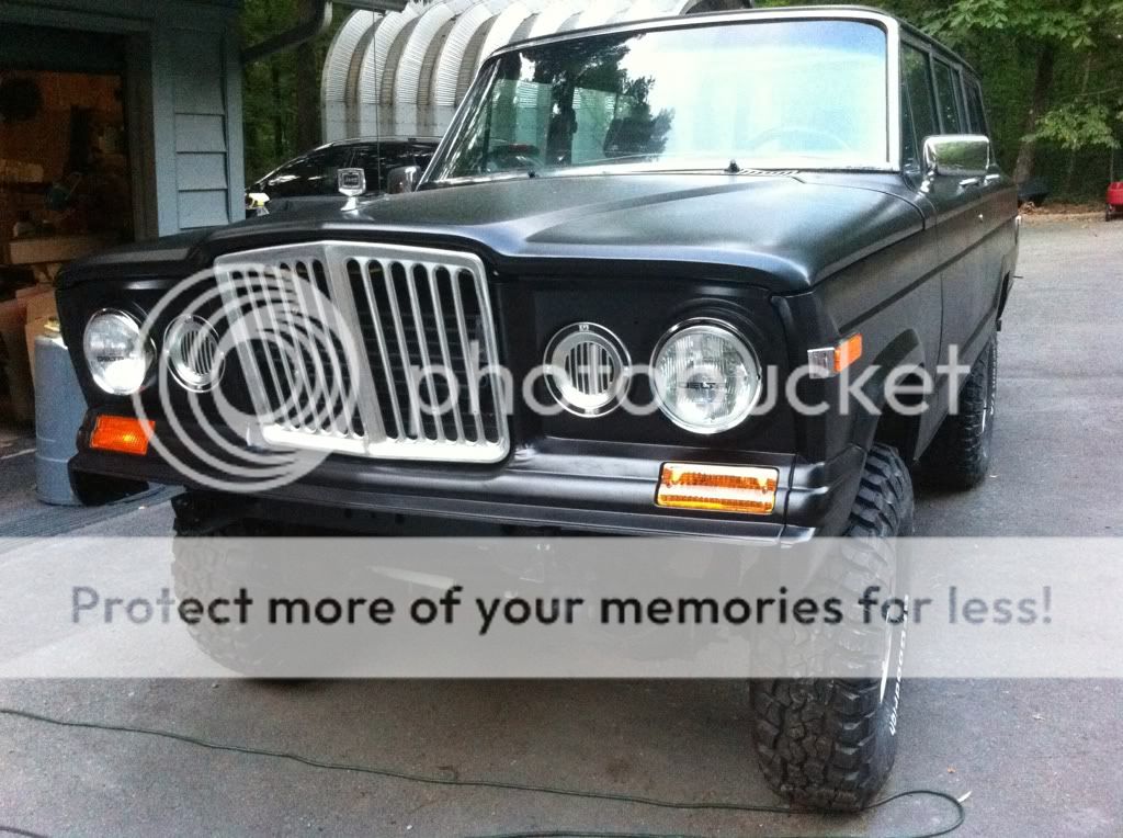

Hood up close.
She has a Black Satin or Denim look to her now. I am very glad I able to do all of this on my own for so cheap. I wore a very high end 3M breather which was the most expensive item I used in this project.
This was my first time to spray paint a vehicle would I do this again In a Heart beat. cheers

Here is a pick after a light wash and towel dry. 6 days since I painted her.

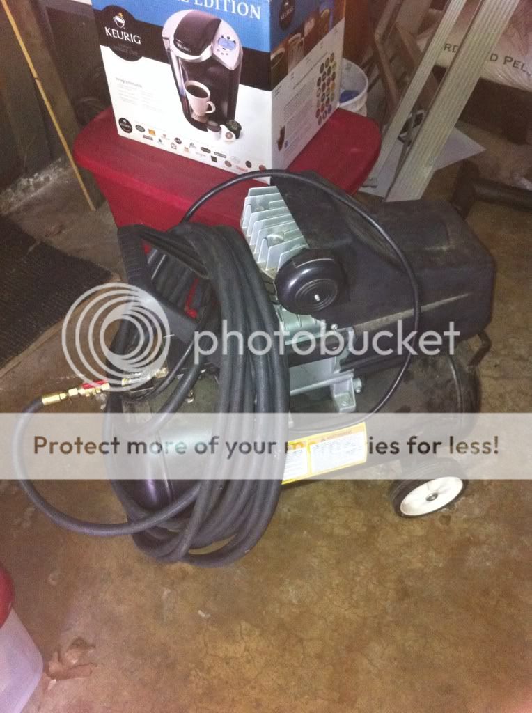

That looks really good. Is that an 8 gal compressor? Did you have to let the air build back up alot? The reason I'm asking is because I have a H.F 21 gal (older red one) and I didn't think it would be able to keep up. Really nice. Got me ready to go out and get a paint gun. Very Happy

That looks really good. Is that an 8 gal compressor? Did you have to let the air build back up a lot?
No. Using a HVLP spray gun the compressor keep up just fine I just took my time.

The spray guns I used were super cheap.. 33 oz. Household Low Volume, Low Pressure Spray Gun
16.99..
Very Happy
2 Horsepower, 8 Gallon, 125 PSI Portable Air Compressor. (This is the one I used.) At about 60lbs dialed in presure. The compressor keep up just fine.
