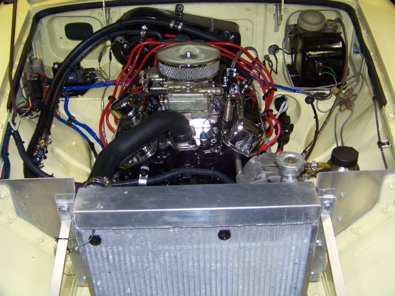

Post by superdave on June 28th 2012, 1:39 pm
canuwoo wrote:My future plans for this car is to put one of the two engines I have just sitting around. Either the 305 or the 302. That maybe the winter project.
Choosing a motor for a swap because you have it "just sitting around" is the worst way to choose and often results in aborted projects. Do some research and decide what is best for you. The 302 Ford is a common swap but does require a bit of fabrication and cutting the fenderwells for headers. The 60 degree Chevy V6 is a very common swap and highly supported. It is what I have in my 70.
Tons of info here...http://www.mgexperience.net/phorum/list.php?40
