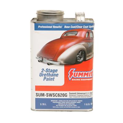

ive been thinking about the idea of putting some SUMMIT BRAND acrlyic urethane clear LOW VOC 2.1
http://www.summitracing.com/parts/SUM-SWSC620G/
over the TOPSIDE GLOSS BLACK, but i want to do 2 midcoats of pearl.
i dont want to do the whole 2 stage paint, because i live in California painting my car in a garage and dont want the smell to bother the neighboors. so, ill be spraying the TOPSIDE on any removable panels outside and rolling the TOPSIDE on the body in the garage, i may even spray it depending on smell and overspray.
after a couple of weeks, ill be spraying the pearl midcoat from the summit clear, then 3 coats of just clear.
how bad is the smell of LOW VOC 2.1?
and anyone think this is a bad idea? i just sprayed a coat of regal red on a fender using 1:1 paint and acetone. there was fisheye but i dont give a ****. this was just a test panel. later today ill sand it to 800 grit and the spray a light coat of pearl withe some leftover duplicolor paintshop clear. JUST TO SEE WHAT HAPPENS. ill be posting some pictures soon later on today.

Post by cac1967 on June 28th 2012, 10:21 pm
The smell is still kinda bad imho, even though it is low voc, it just does not have as many volatile chemical's in the mix.
