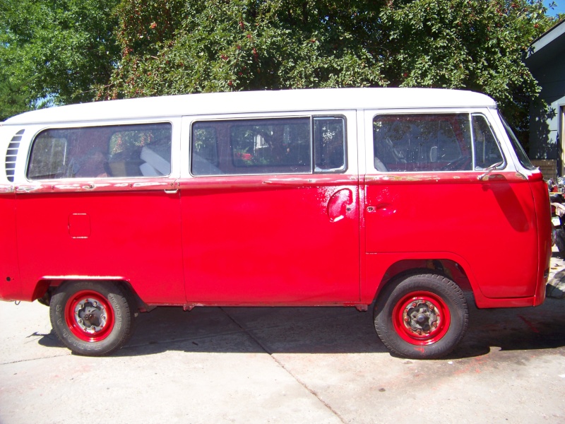

Well i finally got close enough to throw some paint on her today cheers after sanding every bloody day on the week ends ahhh it seemed like i would never get done sanding! ( still have do the easy side!)so far about 45-70hrs of sanding & beating the dents & bondo out of her! the P/owner just filled the dents full of bondo & called it a day! some of the dents were 3/8 of an inch deep! i don't wanna post 125+ pictures so here's a link o my photobucket album grin
http://photobucket.com/VWbus4DJ
I really thought i screwed up during the first coat & it orange peeled BIG time wow (wrong mix!)to thick,I'll have to wet sand the day lights out of the door, but the rest of the right side settled pretty good-i think....
here's what i did today::::
My son grabbed the wrong White paint (Latex) & can't seem to find the receipt! ahhh take a look at the album & look to see how it's coming! enjoy give me any feedback--i'm up to it!

OH yeah, 1 thing i think i need to change is roller size? i'm using 2' closed foam roller pads. whatcha think?? maybe smaller?

4 inch is the norm, the one,s that are made for cabinet,s with a rounded end I think the brand name is shurline.

That's a BIG project! thumbs up To reduce the orange peel, add some Penetrol to your mix. Is that a Kawa z900 ducktale next to your van? rock

Penetrol is an oil based additive for paint. It will make paint flow. I don't know if you can get it in the USA. floodaustralia.net/products/paint_additives/penetrol.php

I think paint-penetrol-turps : 50-27-13 is pretty good for toplac in colder conditions. Still high gloss and little or no orange peel. I paint after work/dark in the shed and it's around 12-14 C at that time. eye turn

I'm using Rust-Oleum safety red mixed with mineral spirits,i started out at 50/50 mix & thats where i got the heavy orange peel, i think i ended up with something like 70/30 MS to paint mix,i'll have to check when i get home,

WOW usually 50/50 is really thin. What is your humidity at? Any over 60% humidity and the paint sets up to fast. Also try Penetrol in your mix to get it to flow better.
That safety red is an awesome color. I spray canned all my trim in safety red.

i did do 2 parts paint--1 part MS. & humidity was around 10-20% & around 95-100 degrees mad3

well i think i figured how NOT to get O/Peel-----try not to care! i didn't care if i got any on the top & guess what very little,it's there but real shallow hair pull
we did the top today-acouple coats.

well i threw 2 more coats on the top,with very,very little O/peel Laughing 2 parts paint to one part M/Spirits.
decided to use the left over paint as a primer for the front..MAN is it BRIGHT!!!

well i finally got to throw some paint on it,it NOW has two coats all the way around it cheers dance
I was afraid to stick it any closer but the O/peel is little! elephant

well after a couple of other crap,i decide to throw some paint at it. all was good till i got greedy & threw an extra coat on it..
D sigh MN-D frustrated MN! well all i screwed up was the door-but it can be saved! sigh
