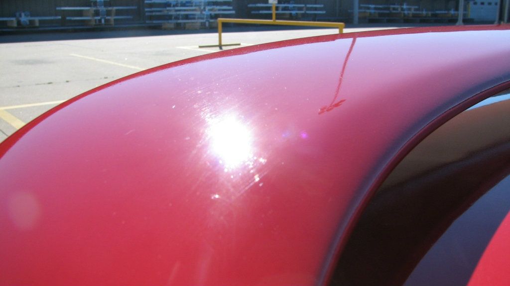

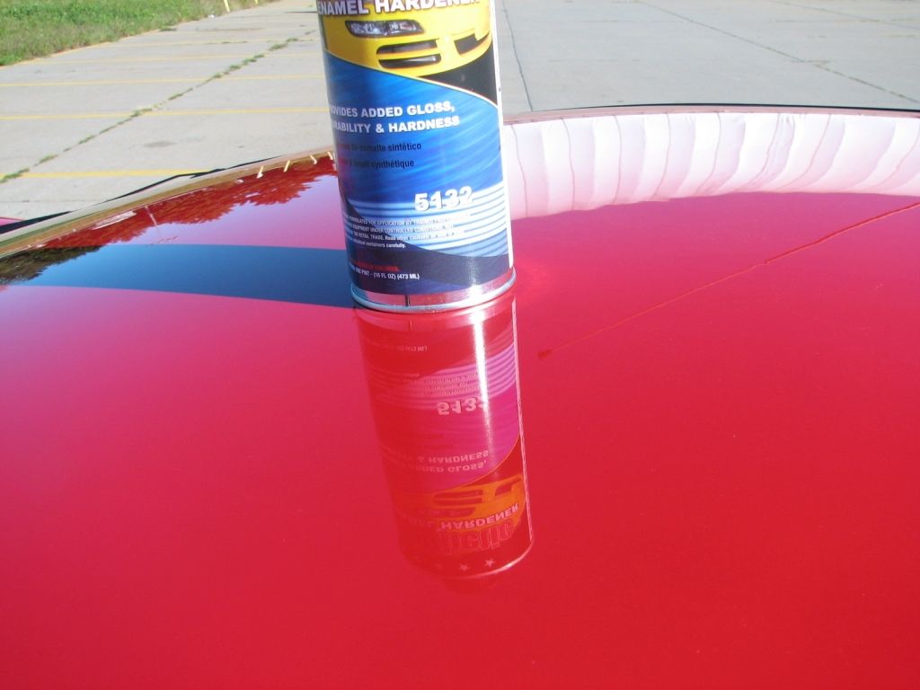

This first pic is a reflection shot of the roof:

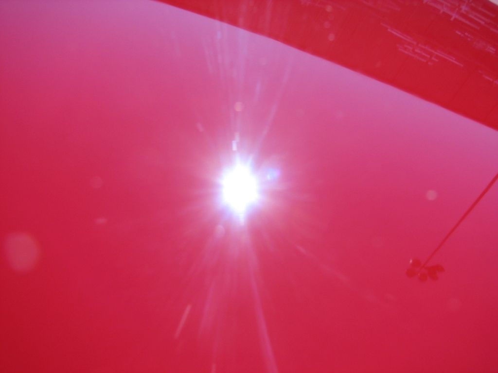

Just the sun reflecting off of the hood:

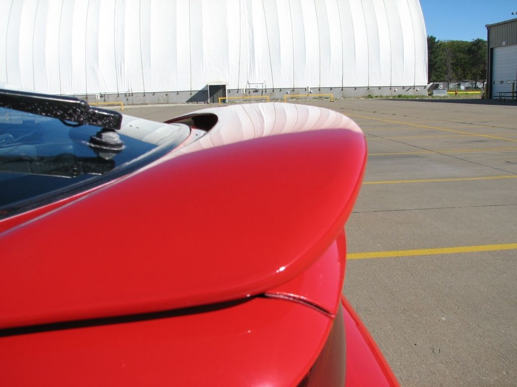

Reflection shot of the rear spoiler:
Sun reflection shot off of the rear spoiler. This shot shows what's left of the final 2000 grit wet sanding scratches. Even with multiple hard pressure compounding with an aggressive compound, these scratches are still just barely visible from a foot away and the light at the right angle. I was initially worried about the paint being too soft for the Megs 105 compound, but this hardener really did it's job. This paint is HARD:

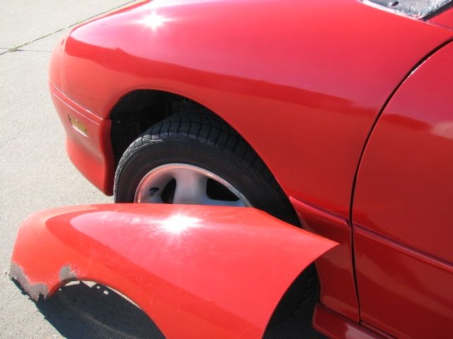

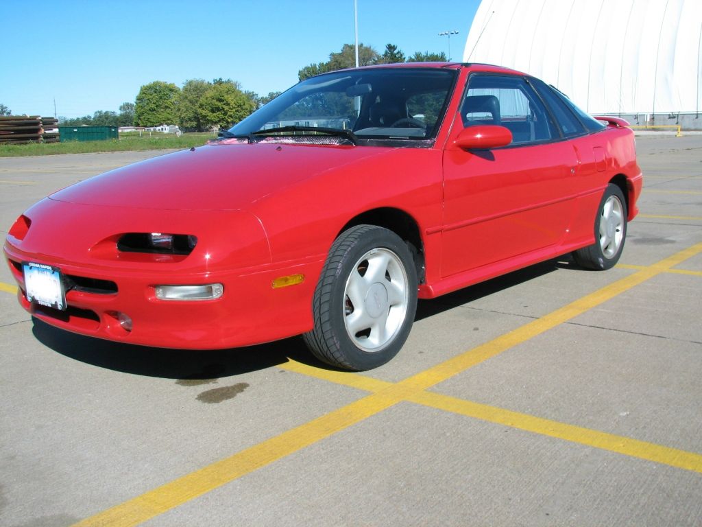

Comparison sun reflection shot off of the old front fender and the newly painted fender. The paint on top of these old rusted fenders was actually in the best shape of the whole car, with all of the original clear coat.

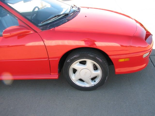

Reflection shot of front fender:

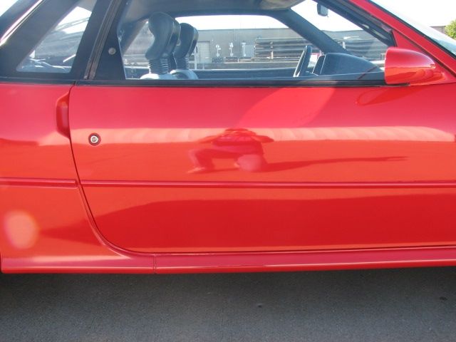

Reflection shot of front door:

Thanks, I'm really pleased with how it turned out. I noticed one thing that needs to be corrected, the first picture is of the roof, not the hood. I tried taking a reflection shot on the hood at first, but it was too windy, and the empty can of hardener kept trying to slide off of the slick hood.

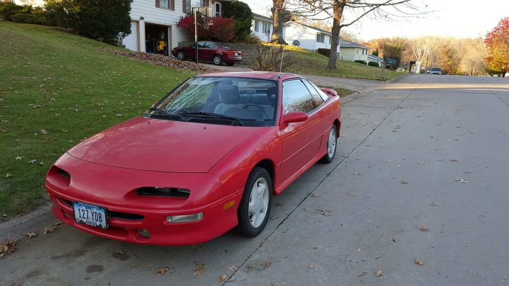

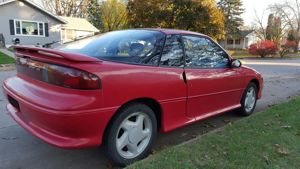

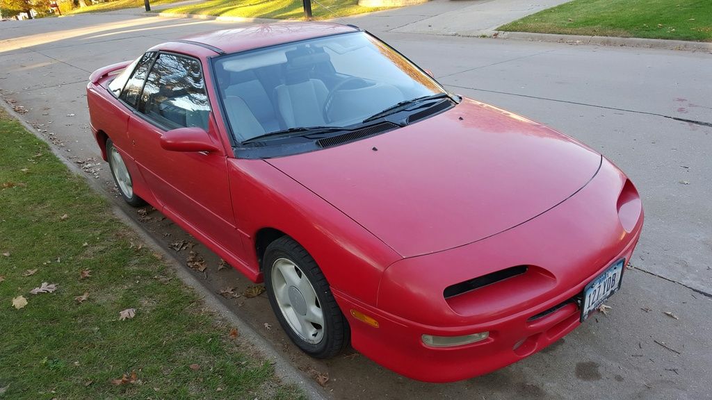

3 year update
Post by Samilcar on November 10th 2015, 6:42 pm
I thought it was only two years, but I guess it's been three. The Storm has turned into my daily driver for my five mile commute, it's spent all of that time outside. I had pictures of it this spring after I had waxed it (it gets washed and waxed once a year), but those got lost with my old phone.

Post by wantajav on November 10th 2015, 8:36 pm
That's a great looking car. I remember back in the 1960's every new red (enamel like Rustoleum is) car was soon faded or pink within about 5 years. It was considered "normal" until the latest urethanes and mainly the synthetic di-azo reds came along around 1980 from DuPont. Your car has held up well considering, nice as is- can always bring it back anytime if you want. I notice - no visible chipping on the front, that is a testament to the durability of your paint job.
Check out "extreme makeovers" from Meguiars or a detail website if you are interested, with a Porter Cable polisher and some ultimate or poorboys you could bring that back in an hour....
one thing for sure I'm definitely getting a Porter cable and trying some of the latest pads and compounds on my cars including the roller jobs coming up
Great job
Re: 1993 Geo Storm GSi -Rustoleum sunrise red
Post by Tommy Hillbilly on February 17th 2016, 9:48 pm
I agree. I'm seeing a little hazing on the hood and roof - perfectly understandable for a car which is always outside. A little polishing compound before your next wax job should make it look like it did in 2012. It still looks pretty damned good anyway.
