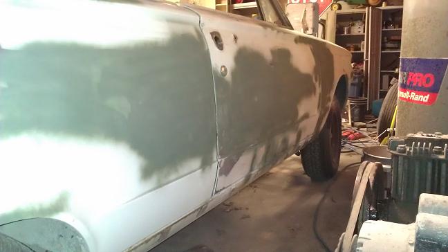

Found even more filler. The lower section of the passenger side door and the drivers side 1/4 panel had a bunch. The 1/4 what not way off and I got a lot of the old bents out with a hammer and dolly and reapplied a skim coat to finish it off. I think I will just replace the door. Its not worth the hassle of trying to fix.

Might be cheaper, quicker and easier to just carry your door in to a local body shop and have them complete the necessary metal work to a roughed-in stage, and then bring it home and finish it out yourself?

Maybe, but a new(used) door is $150 complete or $75 for the shell. If you look at the second pic, you can see that the top of the door does not match the top of the sheet metal next to it, but the lower body line is spot on. Im also thinking about adding some custom door handles and I can use the old door as a test piece. I will need the extra sheet metal if it works out.
