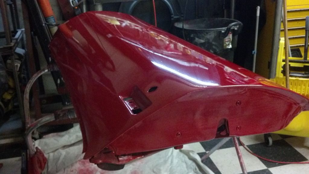

heres some recent progress on the door:

That looks pretty good. Is that just one coat?
Also, IIRC, orange peal seems to occur worse on vertical surfaces, than on horizontal ones.
I stopped using penatrol after I noticed it tinging my white paint. From what I've heard, that Japan dryer has a good effect.

no I forgot which number that coat was I think around 4 or 5. Ive been noticing the orange peel can be sanded with 1000 and 1500 almost no matter how severe it is.

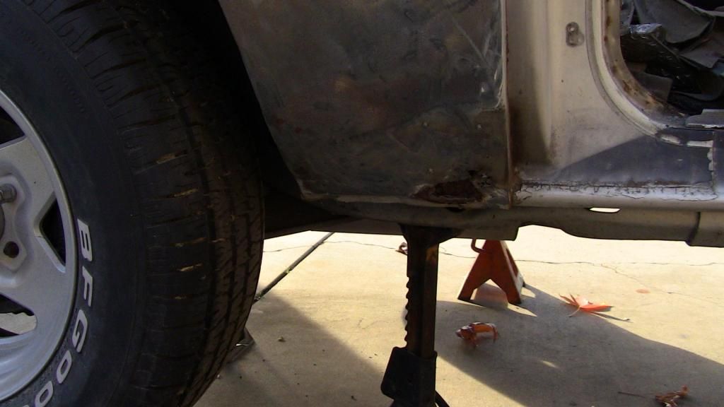

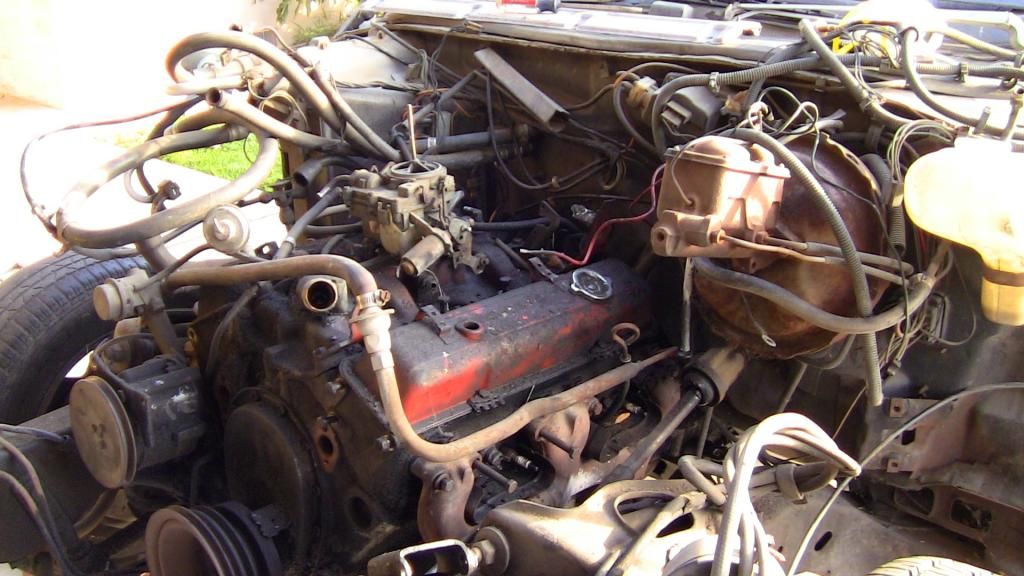

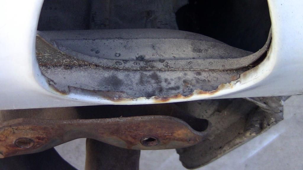

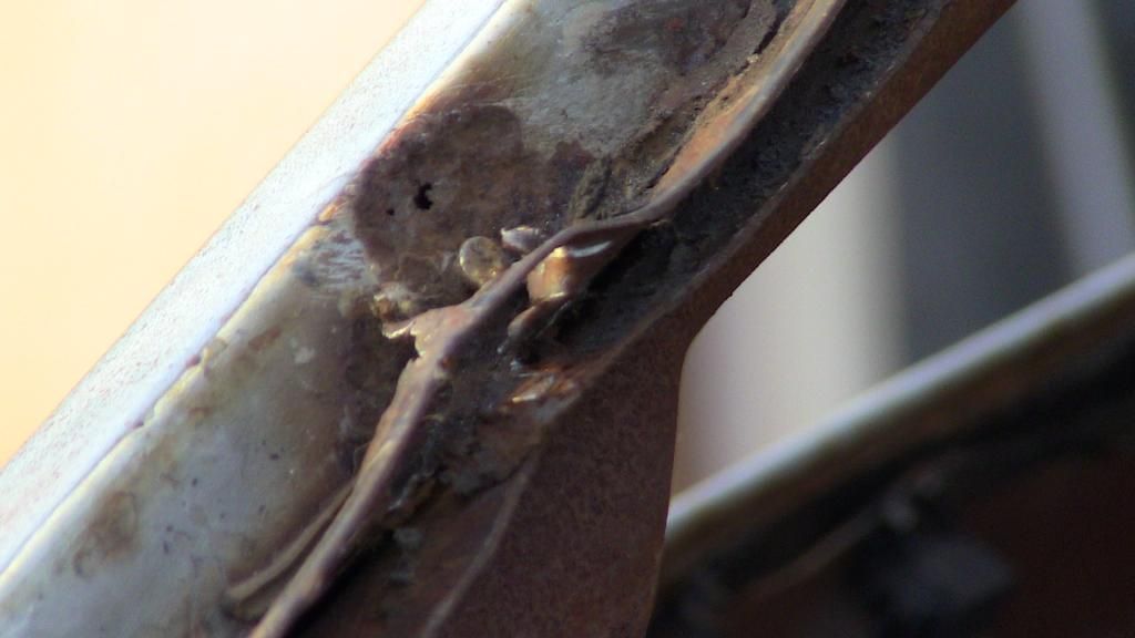

Here's a bunch of pictures i just took for another forum, but it shows all the little welding projects i have ahead of me. Wish me luck!
http://www.youtube.com/watch?v=fbOshyp4UL8&feature=youtu.be

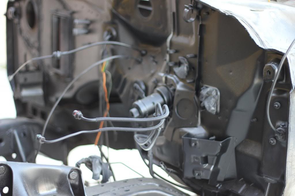

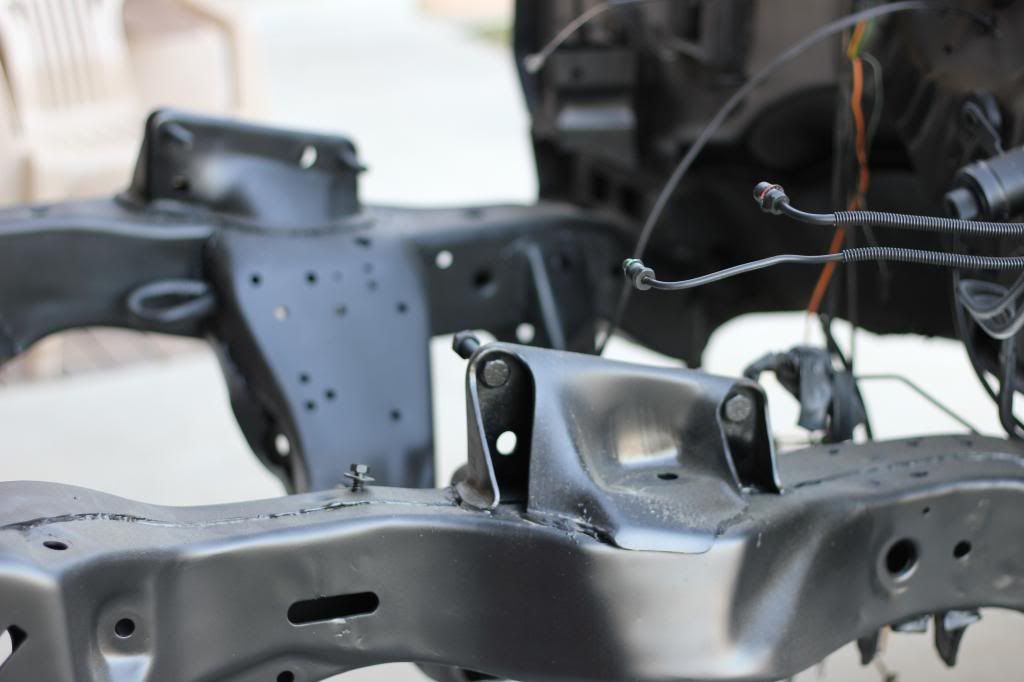

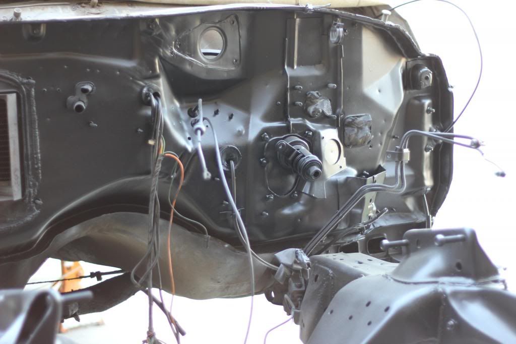

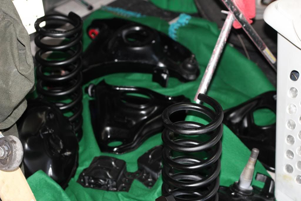

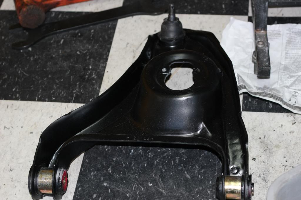

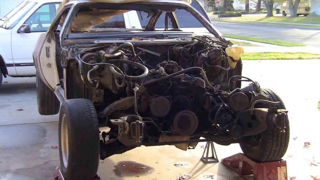

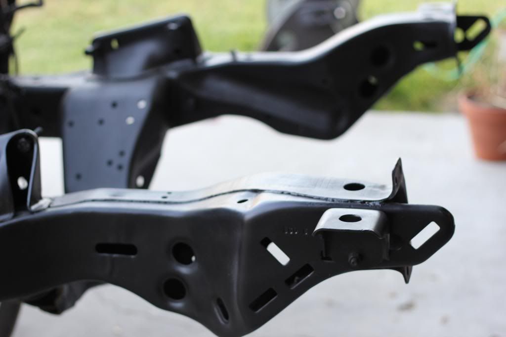

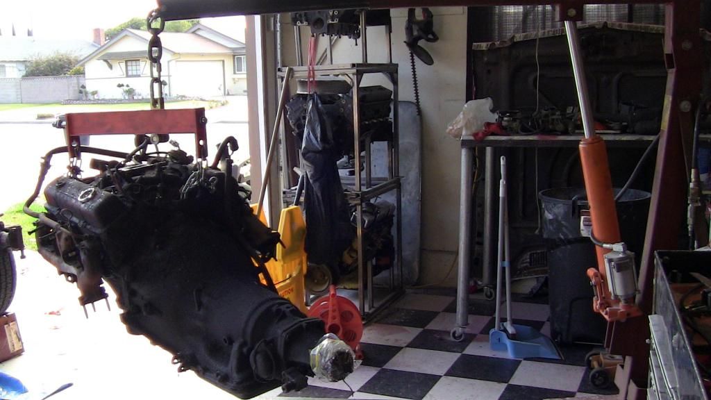

Well had a death in the family that sent this project a little off track. I'm back on it and got the firewall and front frame area primered with rustoleum smooth surface metal primer, and painted with my favorite spray paint right now- rustoleum satin black (# 7777 on can). I've sand blasted every part off the front end and primered and painted it. I've put in polyurethane control arm bushings and moog ball joints. Here's a few pics. I've since installed the suspension, and if you've never tried installing springs/control arms on a chassis with no engine or weight on the front.. its fun. My next thing on the radar is to do some quick floor board hole repair welding jobs. Here's some pics of my work on this car lately:

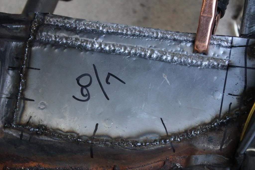

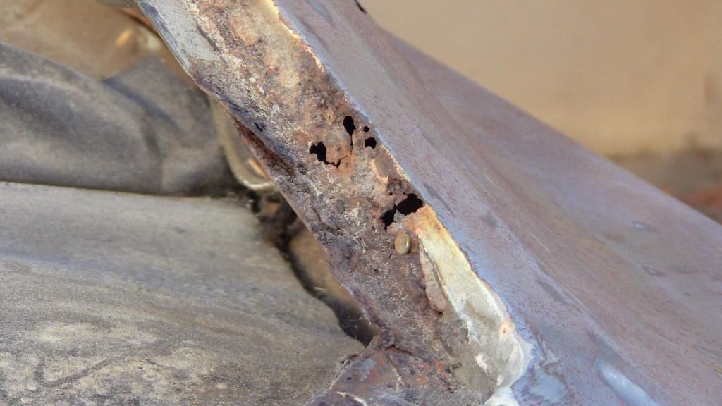

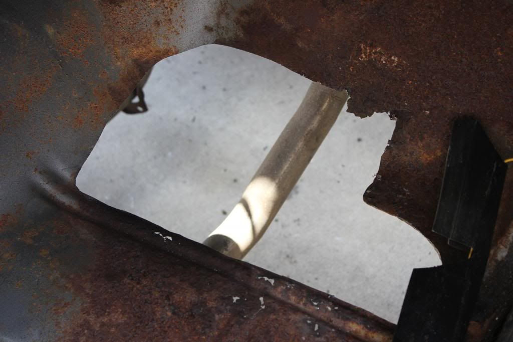

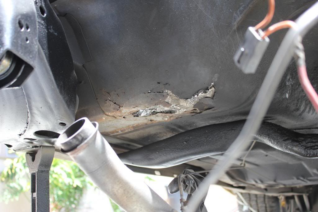

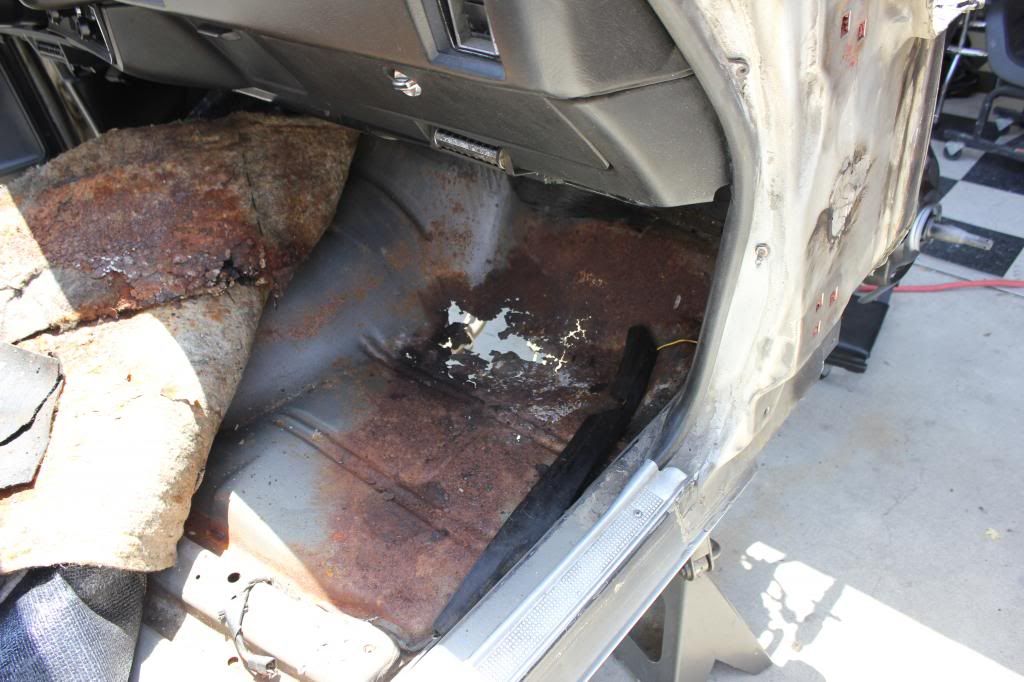

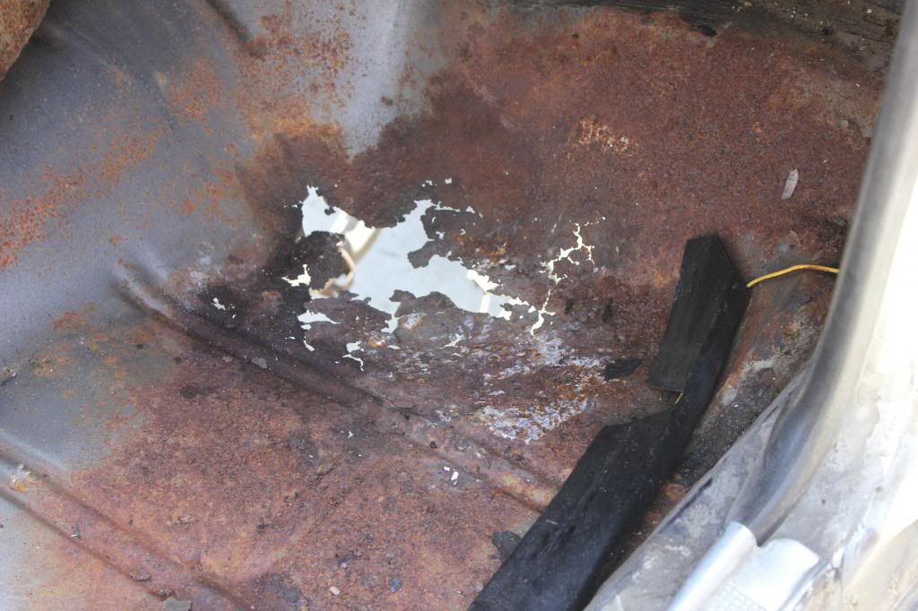

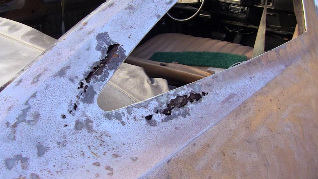

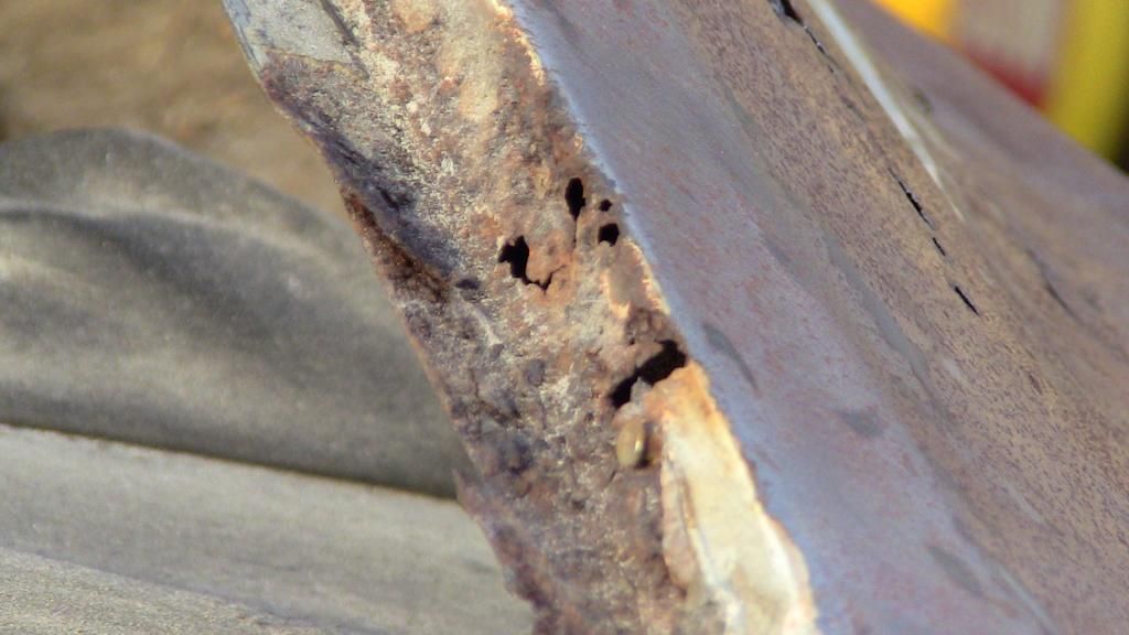

well I don't have paint in my hands yet, but I'm moving forward on this project.  I'm tackling this front floor board that's rotted out.  I put the foil there a few years ago when I replaced the carpet, I didn't want the heat from the exhaust to melt it.
So I got to pulling the carpet back and saw the whole picture.
I went at it with a body saw and at first I stopped here:
Then my guilt got the best of me and I knew I should drill out the spot welds along the side and try to do a little better patch job on this damage.

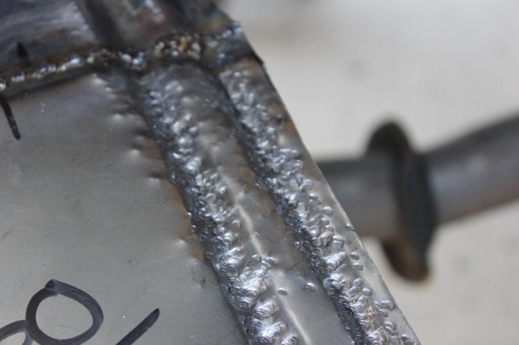

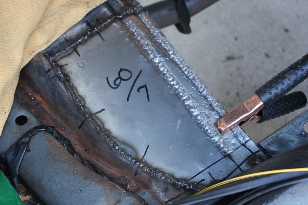

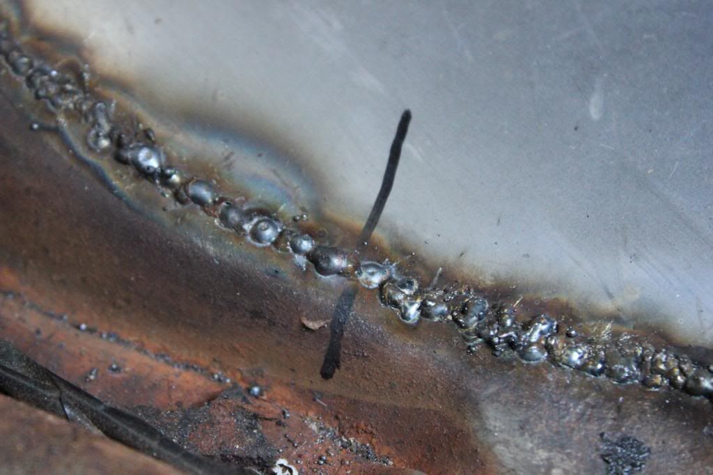

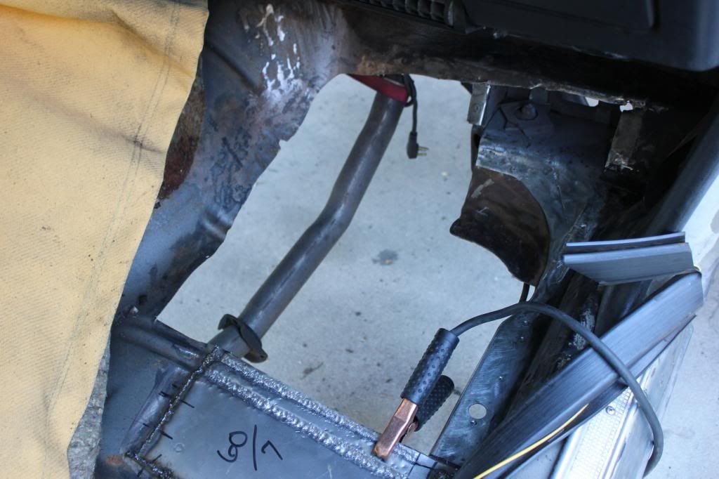

I didn't take pictures of how I made the patch, but my wife got some big heavy free cardboard from costco- there were stacks of soup on an aisle seperated by these giant cardboard pieces that are perfect for making sheetmetal templates out of.  Anyway, I made the template and cut it out, and here it is welded in.  I still have to grind these welds smooth, re weld the pin holes I surely missed, then do it all over again on the bottom side.
I wanted to try to copy the seams that were seam rolled in from the factory.  I almost went out and bought one, but it seems like my only time i'd use it would be when doing floor boards.  So it's very ugly, but what I did was open vise up about a 1/2 inch or less, drew matching lines on my template, and used a body hammer to beat a valley into my patch over the open vise jaws.  Then I tried putting a long bolt halfway sticking up horizontally in the vise so I could try to beat the template "seams" into a more respectable shape but it didnt work so well.  But when I was done, I had seams that made the pach a lot stronger and it shouldn't tin can at all.

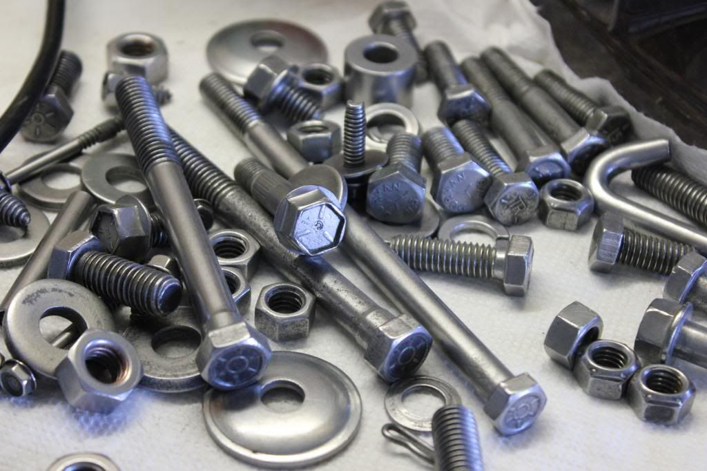

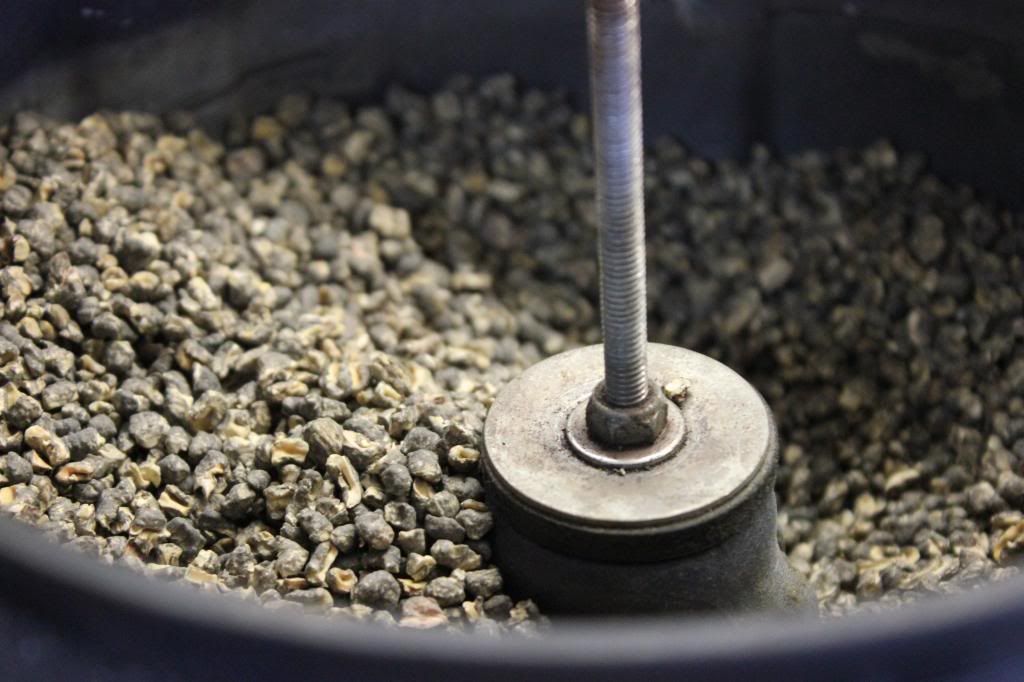

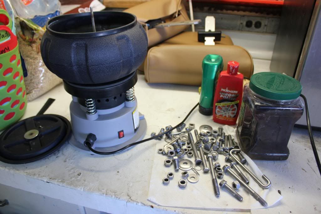

And here is my new favorite restoration type toy.. a parts tumbler from HF.  I used corn cob from walmart in the pet aisle and the hardware came out looking great!  I have a sandblaster, but it'd tedious to hold small things and not sandblast your own hand/glove.  This thing you just set it up and walk away for a few hours, or even overnight if you want and your parts get cleaned and polished.

Are you kidding?  None of that is off-topic.  That tumbler is a good thing to have, as those fasteners look freakin' sweet!
This forum is primarily devoted to one aspect of car building - that aspect being paint - specifically rolled-on paint.  All other aspects of car building are relevant here (according to my sensibilities...Rolling Eyes )
It's cool as heck to see some of the different steps members here take on the way to finishing their rides, especially off-the-beaten-path ones like your tumbler, which most everyone here could find a use for.
