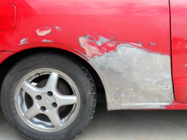

Did some more work on the Mirage. Continued with the 3M heavy stripper all the way to the wheel well and up the quarter panel some more. I was able to pull the interior panel out and discovered more filled drill holes near the wheel well and some damage above the wheel well. I decided to remove all the filler by the wheel well and fix the metal correctly. A few of what I found:
After removing all the filler, I was able to see how many previous drill holes there were and how bad the panel felt out of shape, compared to the other side. So, I broke out the stud welder and started welding and pulling. The stud welder works really well and is very easy to use. The combination of the larger studs and the thin sheet metal made the larger studs hard to work with so I stuck to the smaller studs:
I probably used about 80-85 studs and I'm curious to see how straight I got the panel compared to how it was. I guess when I lay the filler on it I will find out. I decided not to disrupt the filler that is over the wheel well to pull the sheet metal because it's holding now and there are no signs of cracking like the spot at the bottom of the quarter panel. After I felt I got the panel to shape as best I could I grinded off all the studs and began to block sand the quarter panel with 80 grit. This panel has original primer, paint, filler, primer, paint, clear coat...thus my choice of 80 grit. I wanted to get all the unnecessary layers off and the clear coat had started to peel on top anyway.

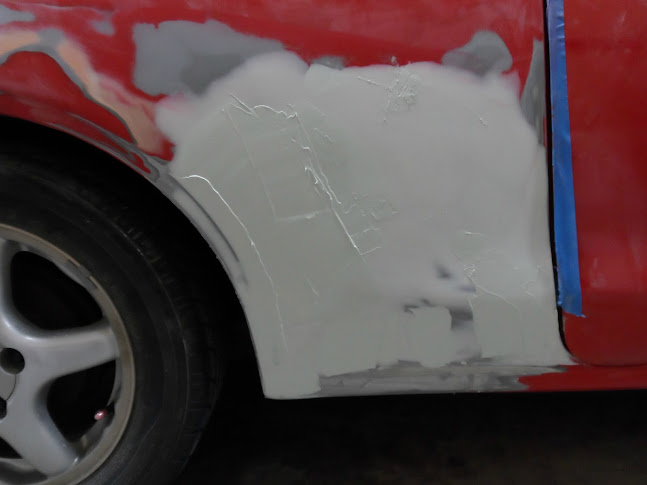

More work on the Mirage today. Tried spot welding/brazing the holes but the sheet metal is so thin in that area it wasn't turning out well and warping the metal so I decided to use Bondo Glass. Reasons for going the Bondo Glass route, it's Sunday and no body shops are open to get the holes mig welded and I am still driving this car and working on it at the same time. I didn't want to leave the exposed metal and old filler and bare metal spots exposed to the elements because it would be another couple days before I could get to a body shop because of my work schedule. I've used it before and for the size of the holes, I think it will be ok. Would I have rather had the holes welded up, for sure. I even think the previous repair just used Bondo because of the play-doh type resemblence on the inside sheet metal.
After the Bondo Glass dried I applied the first round of Bondo Ultimate:
Followed by block sanding with 80 grit and second coat of filler:
Followed by block sanding with 80 grit and third coat of filler:
After blocking again with 80 grit, I was out of daylight and needed to primer the bare metal, old filler and my repair area so I can drive it tomorrow morning:
For only blocking with 80 grit I think my first attempt at body work turned out pretty good. I still have a couple areas that will require filler and one area where I need to address the body line by the fender well. However there are some pinholes in the filler which I didn't think I would get with the Bondo Ultimate. Should I get a glazing putty to fill these because I know they will be visible throught the primer and paint.

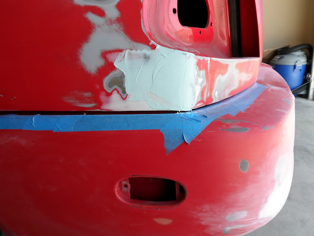

Sanded the rear bumper with the DA and 400 grit, then used spot putty on various areas and re-sanded. It's hard for me to spend a lot of time on the bumper, so I don't know how many applications of spot putty I will use.

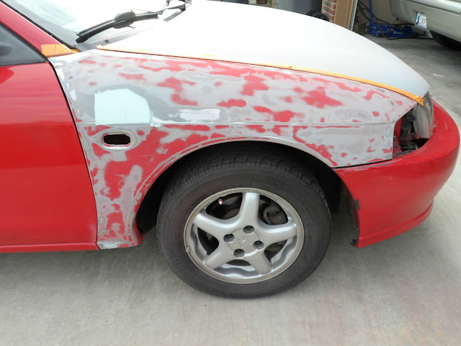

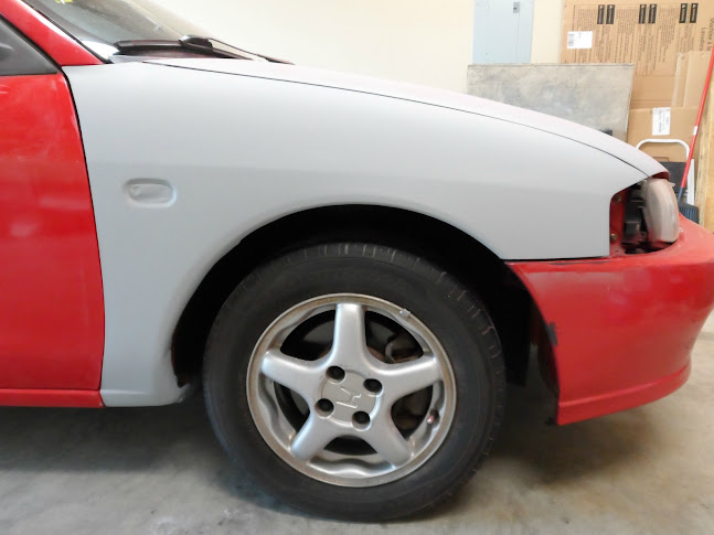

More work to the Mirage today.  Spot filled an area on the passenger rear quarter, sanded the driver side rear quarter and sanded the trunk lid.  I also sanded the driver side front fender similar to the passenger rear quarter.  The clear coat was failing so I decided to get rid of it all and in the process I discovered this....more filler:
Sanded the fender again with 180 grit to remove the 80 grit scratches and took the dents to bare metal since I was close anyway and on went the first round of filler on the fender, drivers quarter panel, trunk lid and rear bumper.
Only took two rounds of filler to get the two fender dents and the dent in the trunk filled.  I used a little glazing putty on a few low areas and pinholes after the final round of filler.  The drivers rear quarter by the tail light had been wrinkled before and I was able to get the majority of it reworked from inside the trunk and I ended up using very little filler, which I am proud of since at one time I thought I was going to have to use the stud welder to get it back straight.
Sanded all the areas with 220 grit before priming to see if I could see the scratches through one coat of primer.  I only see very few and am pretty sure once I sand the filler with 400 before primer, I won't have any scratches through the primer.  I am also going to primer the entire car.  I have one coat of primer on this area and you can see the filler below the primer where the two dings were.  I'm assuming the primer will cover the filler with mutliple coats.  I plan on rolling on the primer because I have found I hate masking off more than sanding and filling.

Small update since I won't get any time to work on the car this weekend. Sanded the passenger front fender, eliminating the failing clearcoat and pretty much duplicating what I have done on the other panels that the clear coat was failing on, DA with 80 grit, sand with 180 and 320 to remove previous grit scratches. Filled two small and one really small ding and sprayed some temporary primer on to keep the elements off the filler and bare metal.

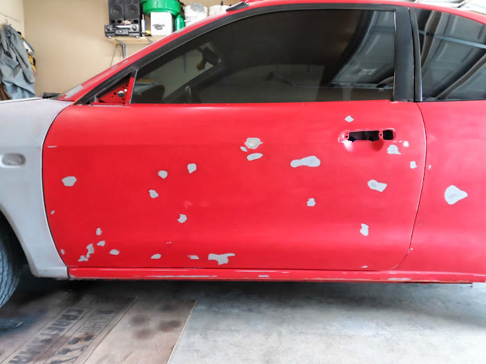

Removed the door handle, weatherstripping and mirror in order to finish sanding the door. I was able to get a little of the door ding on the body line out but not all of it because of the interior door structure and limited amount of room. On went the filler and the sanding started and continued and continued some more.
Also did some filler work on an area that I had been forgetting about by the drivers rear quarter/tail light area. Primed for element protection. Only the passenger door left, which will require almost complete strip because I know it's been repainted and has multiple layers.

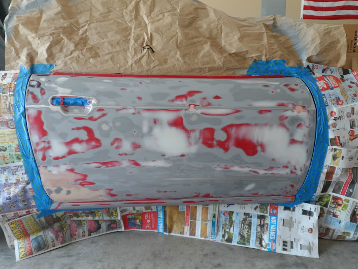

Tackled the passenger door. 80 grit DA to remove the failing clear and multiple coats of paint. Guess what's underneath...not surprised though:
You guys know the drill, 80 grit DA, filler, 80 grit block, 180 grit block, 220 grit block, primer for element protection.
I think I have figured out how body shops knock down the filler before blocking. I was ready to be done block sanding with 80 grit so I got the DA and knocked the high spots down and then blocked with 80 grit. Following this method would have saved me a lot of time..luckily I figured this out on the last panel doh
Anyway, with this being the last panel requiring body work, I think I am ready to start priming. My plan is as follows:
DA sand with 400 over everything, removing temporary primer and sanding all the scratches that are still visible through the temp primer (mainly around the edges of some panels). Wipe with Denatured Alcohol, wipe some more and wipe some more. Finish it off with a tack cloth and start rolling on the primer. Any hints, tips or suggestions? I am using the Rustoleum filler primer and a high density foam roller.
