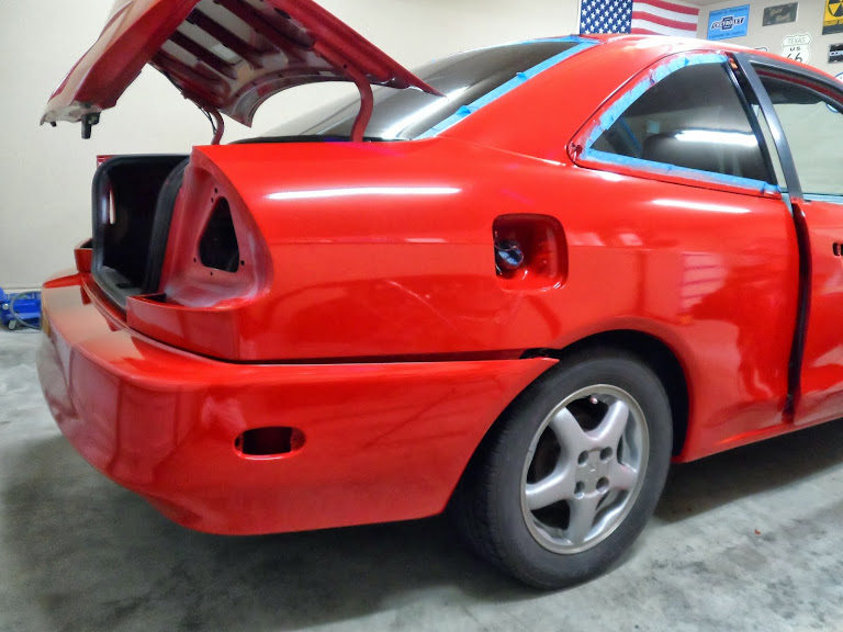

Final wet sanding is done.  I know I spent a lot of time on the final wet sand and I would say the hours were in the teens but not quite sure the exact amount.  I test spot buffed part of the fender and if that is any indication of how the rest of the car will look, I'll be very pleased.

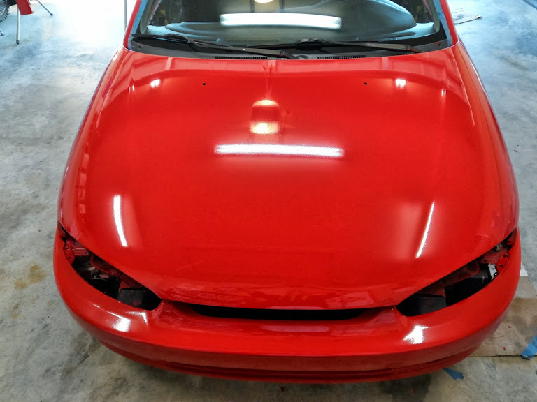

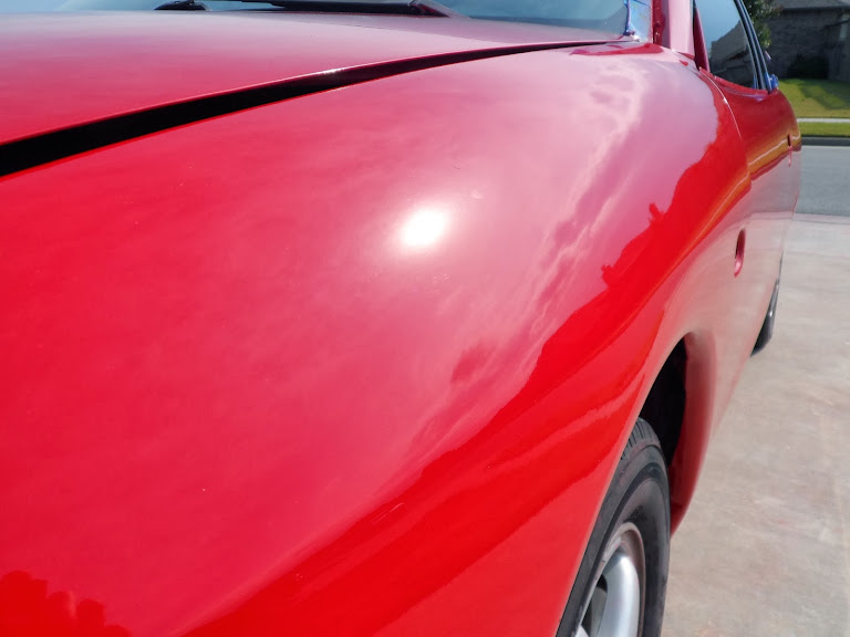

Tried DA compounding and something is going wrong.  I am doing the same process this video used and this website:
http://www.detailedimage.com/Ask-a-Pro/polishing-how-to-with-meguiars-m105-m205/
This is what I am using:
Harbor Freight variable DA on setting 5 (second from highest)
Meguiars 105 copmound
Meguiars W7207 foam cutting pad
Heavy pressure on the DA
On the first sectin of hood, everything went great:
So I went to another portion of the hood using the same technique and things started turning out horrible.  See how it compounds and then hazes the paint over in certain areas:
I even tried hand compounding to see if I could remove some of the hazing and got this result after trying to buff off:
Couple things I did notice is the backside of the foam pad was really warm, almost hot to the touch.  There was a lot of paint buildup on the foam pad but that may be normal, not sure in this particular instance.  It's almost like the 105 is flashing fast, like the stated in the website but it's flashing so fast I can't even make two-three passes before it flashes and hazes over, if indeed the hazing is it flashing.
What are your guys thoughts?  I have removed the foam pad and cleaned it by hand.  If I only get a small section compounded before I have to clean it, this is going to take forever, longer than wetsanding..
88k5jimmy
Number of posts : 57
Registration date : 2013-01-10
Re: 2001 Mitsubishi Mirage
Post by Samilcar on October 13th 2013, 12:53 pm
The compound is flashing (drying) too fast. Use the pad priming technique here: http://www.detailedimage.com/Ask-a-Pro/polishing-how-to-with-meguiars-m105-m205/
Also, don't use the fast application technique shown in that video you posted. Just prime the pad, apply a little bit more compound on top of the primed pad, and then start with slow speed, heavy pressure compounding.
Number of posts : 76
Post by Samilcar on October 13th 2013, 12:55 pm
Also, the pad getting hot is normal, the heat actually helps the abrasive polish better.
Post by 88k5jimmy on October 26th 2013, 12:30 pm

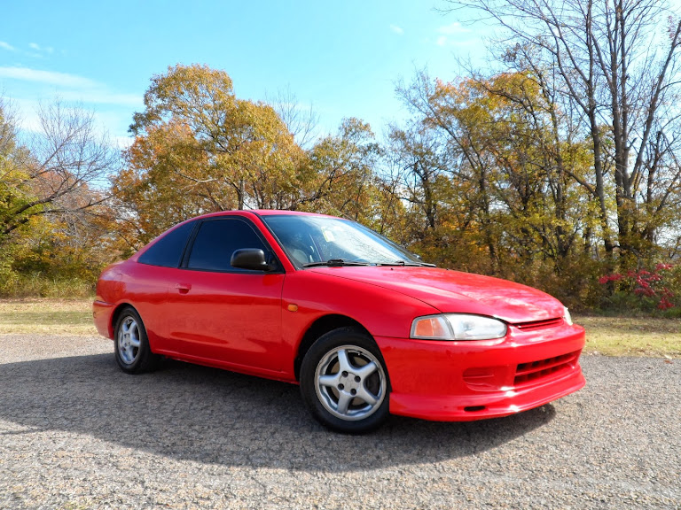

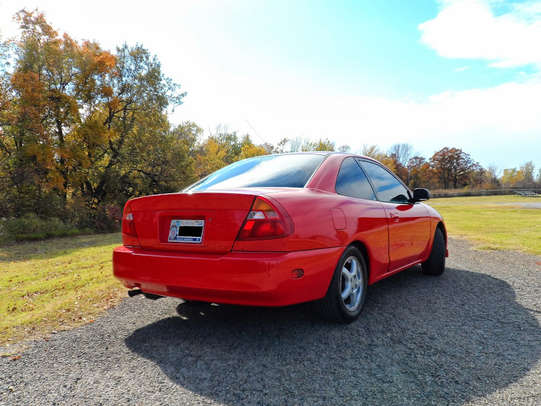

Alright, compunding with the 105 on a Meguiar's 7207 cutting pad on the slowest speed, hard pressure, then going right back over the compunded area with no pressure and the pad just spinning taking off the excess 105 did the trick.  Then wiped the rest of the 105 off wth a microfiber.  The paint polished out and brightened right up.  I also used the same process with the 205 on a Meguiar's 8207 polishing pad with moderate pressure.
I plan on using the same DA for final wax.  What speed and pressures do you guys recommend for the final wax stage?
Added some pics after polish:

I ended up polishing on speeds 3-4 with light pressure on the finishing pad and Meguiar's carnuba wax.  Reassembled all the trim, added a Honda civic front lip and sprayed the side marker turn signals in the front fenders orange.  Also, sprayed the mirrors and windshield squirters with some black Rusto spray bumper and trim paint.
