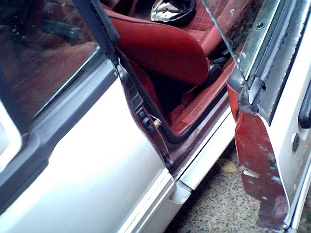

thanks. i did chck it out but for the price, ill try to do other means first.. ill try to blower heat method and see if that works... also, how do you guys get to paint the door jamb and other areas that are difficult to paint using a roller? since i may be mixing my own color, buying a spray can is not an option...
You're asking the wrong guy...Twisted Evil

ill probably try to roll/brush the door jambs. if im not pleased, ill just buy a spray... i dwcided to just use thw charcoal gray rustoleum instead of mixing my own color...
