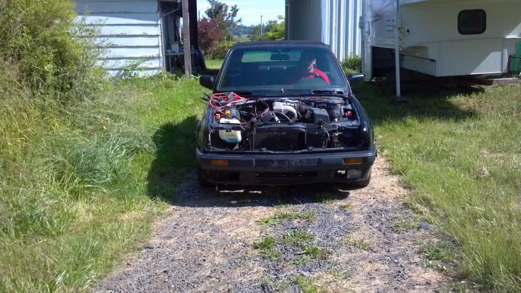

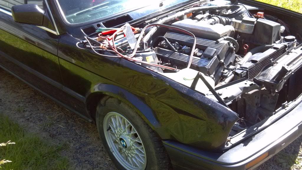

[img]http://[/img]  [img:f1ae]http://[/img]  [img:f1ae]http://[/img]

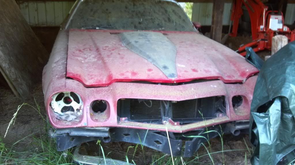

and then a pic of a recent barn find...not sure what will happen to it[img:f1ae]http://[/img]  and look at these monster crager ss width on rear[img:f1ae]http://[/img]

oh and obviously, those pics in first thread are after I tore it mostly apart
