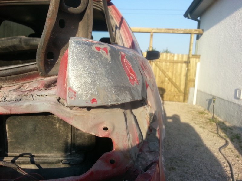

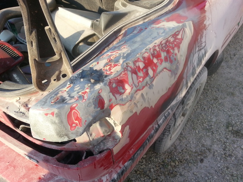

Well this is a disaster.....I've never seen so much bondo in my life!!!
Im thinking they just bondo'd over the damage and dents. I'm thinking I should try to get down to the metal , pull the dents as best I can, then re bondo or fiberglass? The bondo must have been at least a 3/4 inches thick in some places!(which explains why is cracked like crazy.
If anyone has ANY suggestions please feel free to suggest away. I'm a little worried at this point.....Don't really know where to go from here...

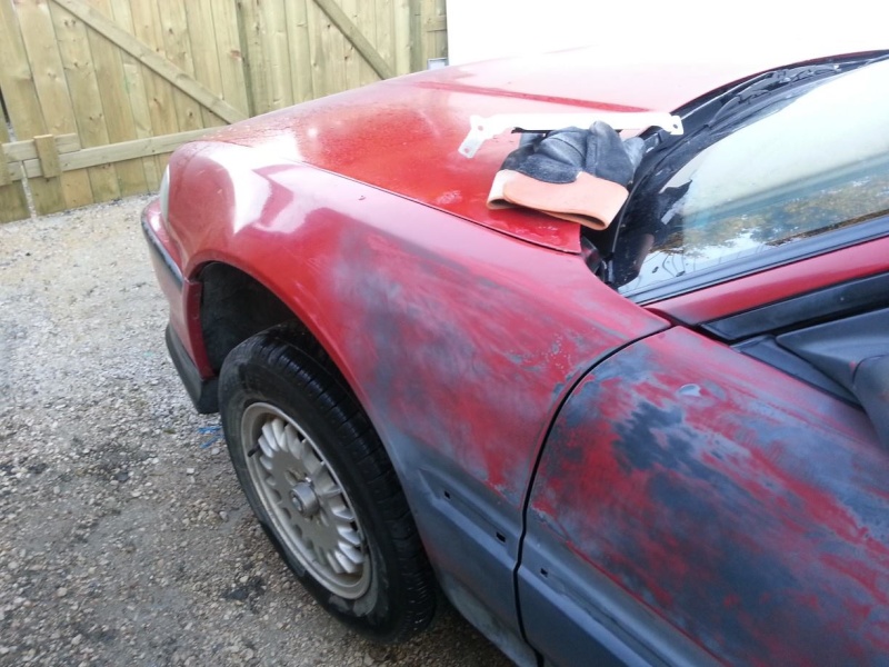

On a side note I started scuffing the driver quarter panel and door. Massive orange peel from the idiot that last painted it and paint runs too.....

Post by Prospector on August 14th 2013, 1:11 am
That Bondo is the deepest I've ever seen .... what were they thinking?

Re: My 1992 integra project
Post by Samilcar on August 14th 2013, 9:48 am
Yikes! That's definite "Bondo abuse".
Number of posts : 75
Post by Noah Zarq on August 14th 2013, 11:33 pm
That's incredible! But take a deep breath, relax, and lay out a plan. If it was my car, I'd go to a pull-a-part and cut off a quarter panel. Measure the car and cut the damaged part off your car, leaving about a quarter inch difference. Buy a flanger (cuts a little step into the sheet metal) and the replacement panel pops into place. Might need a little file work to make it exact. Clean everything and use panel adhesive. It's not as hard as it seems. No worse than replacing a door skin.

Post by integrafan on August 15th 2013, 10:52 pm
Removed most of the bondo today, doesn't look as bad as it seemed. Unfortunately there is not a single wrecker that has this car at the moment. So I'm thinking of  putting fiberglass over it, then just paint over it as a temp fix, once I find a replacement quarter I will fix it properly.

Post by Noah Zarq on August 17th 2013, 3:53 pm
I bet a lot of that quarter panel will improve with some hammer and dolly action. If you screw it up worse, well...  you were going to replace it anyway, right? But if you try, the worst you can do is learn something. Work from the outside of the dent inward, sort of in a spiral. You will probably need a shrinking hammer but if you get it straight enough you'll only need an eighth of an inch body filler.

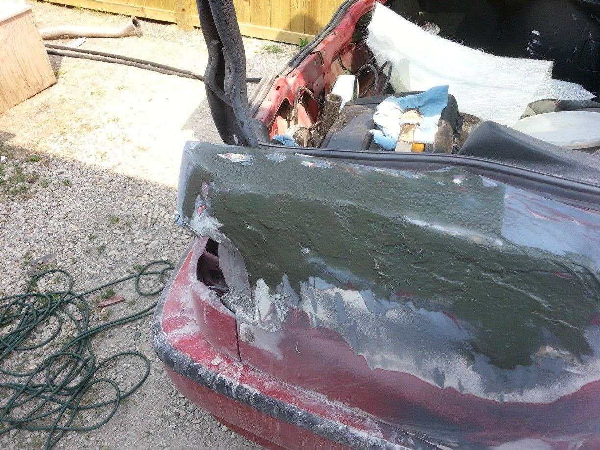

Post by integrafan on August 17th 2013, 4:44 pm
I was actually thinking of just throwing on some fiberglass over it. It is actually not that bad. I think the last owner just used too much bondo and didn't prep the surfaces properly. Its just a temp fix anyways.

Post by integrafan on August 20th 2013, 3:25 pm
I know it looks absolutely horrible right now, BUT, I'm not done yet....just slapping on the fiberglass
