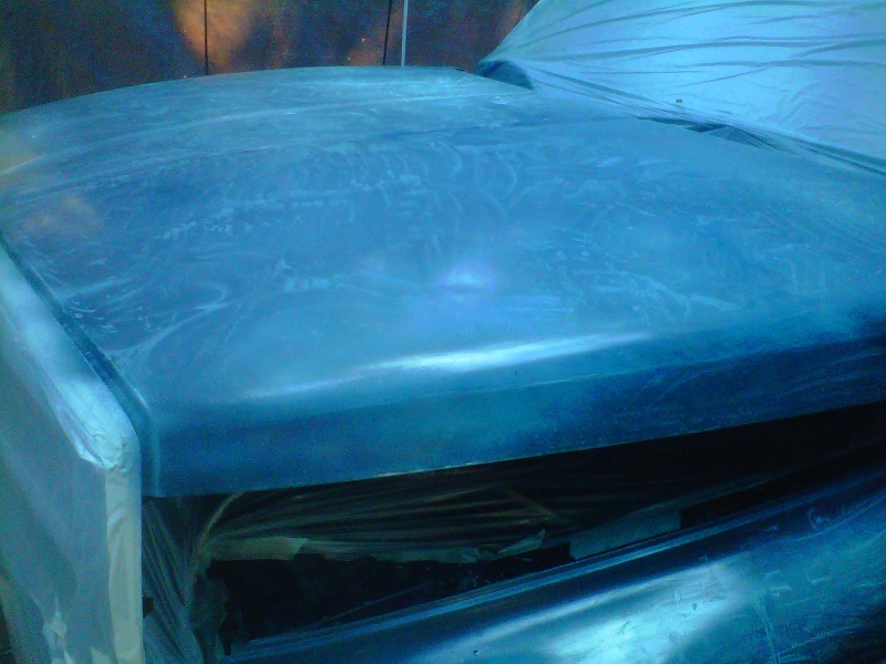

Re: 2nd Gen Dodge - The Resurrection
Post by VeggieBullet on August 25th 2013, 10:05 pm
Sorry for the bad quality on the pictures of the 2nd coat but was done with the phone and the otterbox on it.
So far so good, at least we think so, now it's time for some wet sanding, have the 600 ready

Post by Prospector on August 27th 2013, 10:30 am
Starting to look good....as far as wet sanding, I use a spray bottle in one hand, the sanding block in another...

Post by Tommy Hillbilly on August 27th 2013, 1:10 pm
VeggieBullet wrote:wow....wet sanding this monster takes 1/2 day!!!!
Is there any particular technique that you guys recommend?
Add a little dishwashing liquid soap, like some Palmolive or Joy or something, to your water.
That will add some lubricative properties to the water, and allow the sandpaper move across the panel with less resistance. You'll still be getting a workout though...
Post by VeggieBullet on August 28th 2013, 5:26 pm
thanks for both tips.
Tried with the sand block but it seemed to hard on the paint, at least for my impression so we used a sponge. Good idea or bad idea.
Will try the detergent and the bottle next time, any preferences regarding the "Patern" straight lines, circles, length of the sanding area and of course, how smooth it supposed to be?

Post by VeggieBullet on September 1st 2013, 8:06 pm
Here are some pics of the 3rd coat

Post by VeggieBullet on September 2nd 2013, 12:41 pm
Tommy Hillbilly wrote:That's looking nice.  Are you going to color sand it and buff it out?
thanks!
A lot of hard work, as we all know.
We will love to sand it and buff it out, but still unsure if we are doing something wrong or we don't have the right technique.
There still a lot of imperfections after wet-sanding, at least to the eye but not to the feeling, is this normal?
Post by VeggieBullet on September 2nd 2013, 5:47 pm
hope this is going to work.
These are the little imperfections that we mentioned.
Is this something to worry about or they need to be totally gone with the wet-sanding before the next coat?

Post by Prospector on September 6th 2013, 11:01 am
looks like a mess of orange peel. A lot of wet sanding to do...

Post by VeggieBullet on September 6th 2013, 7:02 pm
Prospector wrote:looks like a mess of orange peel.   A lot of wet sanding to do...
I wish you replied before since I got another coat in top of that affraid
So basically I need to wet sand that until they are gone?
