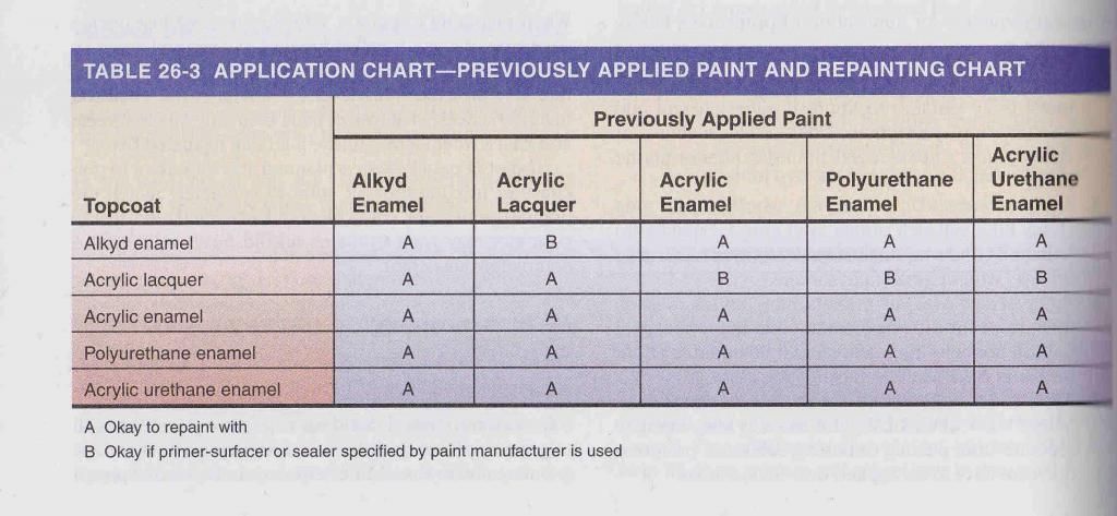

I scanned this chart from one of my books (Auto Body Repair Technology by James E. Duffy). Scuffing and respraying should be all you need to do if painting over alkyd enamel paint. The only exception might be non-acrylic lacquer.

Thanks, that answers some of my questions. Still haven't pulled the trigger, but will be pretty soon. I got the door jams and under the trunk lid to do first. Rattle can should be OK I'm thinking.
