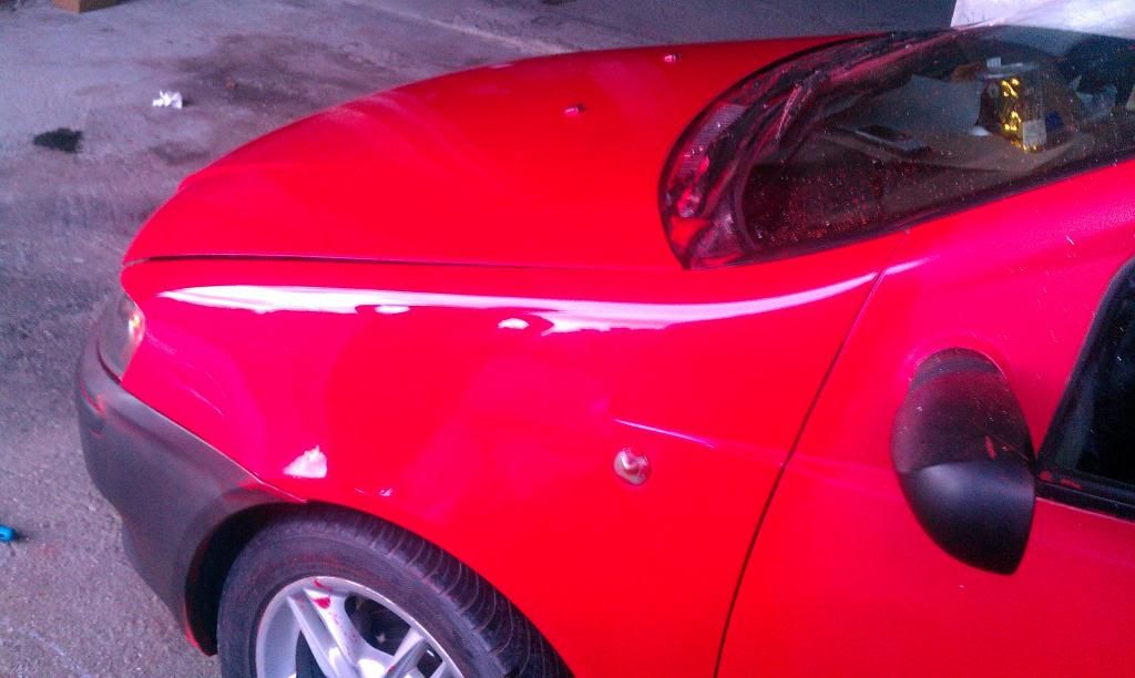

so,this being said here are the pictures from the bodywork and first coat,second coat,first sanding,3rd coat and original paint with the orange peel that was present Smile
bodywork done before applying the primer all over the car

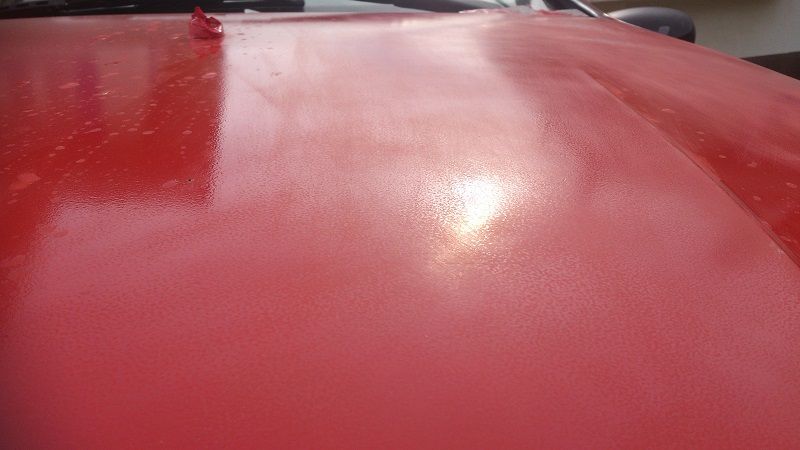

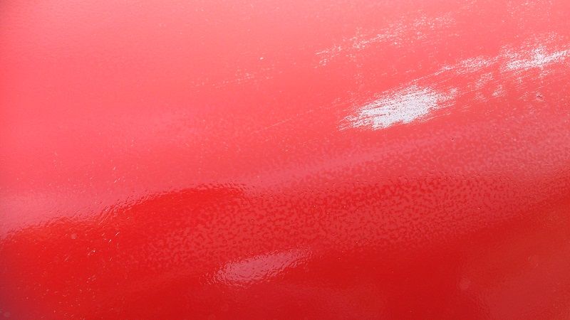

second coat sanding with 320 grit.burnt through paint in some areas
third coat of paint better coverage and better colour.the more coats the darker the colour gets
original colour and orange peel

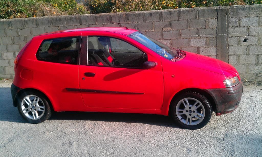

Done.It took me 14 days from start to finish and I did work 6-8 h a day on it.It was a fun project but hard work and still I am not very pleased with the finished look...enough is never enough.
Anyway I have 10 coats of paint out of which the last 2 are paper thin which makes the paint dull but cool Smile I would keep it this way but missy wants it glossy.
Now comes the question....when can I sand it with 2000 grit and buff it ? How many days should I leave it to cure ? I've read 2-3 days,2 weeks or 1 month.So...when should I do the dirty job?

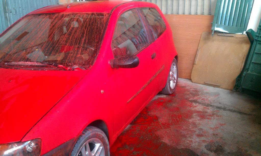

For now I am cleaning the plastics,windows and rest as despite the covers some paint still ran there .

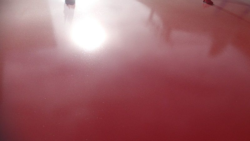

THanks for the reply,I intend to wait for 1 month to wax it.For sanding I started 2 weeks after final coat and still not finished.
I am 1 month and 3 days in this project already and there is one step forwards and 2 backwards.
I started on the hood with 1200 grid directly.Worn my hands off trying to remove the orange peel,left some ugly areas with orange and buffed with wool and 3 types of foam pads and I must say I have the glossy-est hood in the world.It even has some nice shades the paint and it looks like a deep river when you look into it(I guess the paint was not spread evenly during the first coats).Now I am really thinking to paint a second car with some ''defects'' in the first coats that will reflect as ghost images when buffing.
With the hood done I jumped on the fenders and doors,got lazy,tried to buff with wool pad,different speeds and nothing worked.Now back to good old hand sanding all the orange peel.
I guess the paint I have is a tough one Smile)))

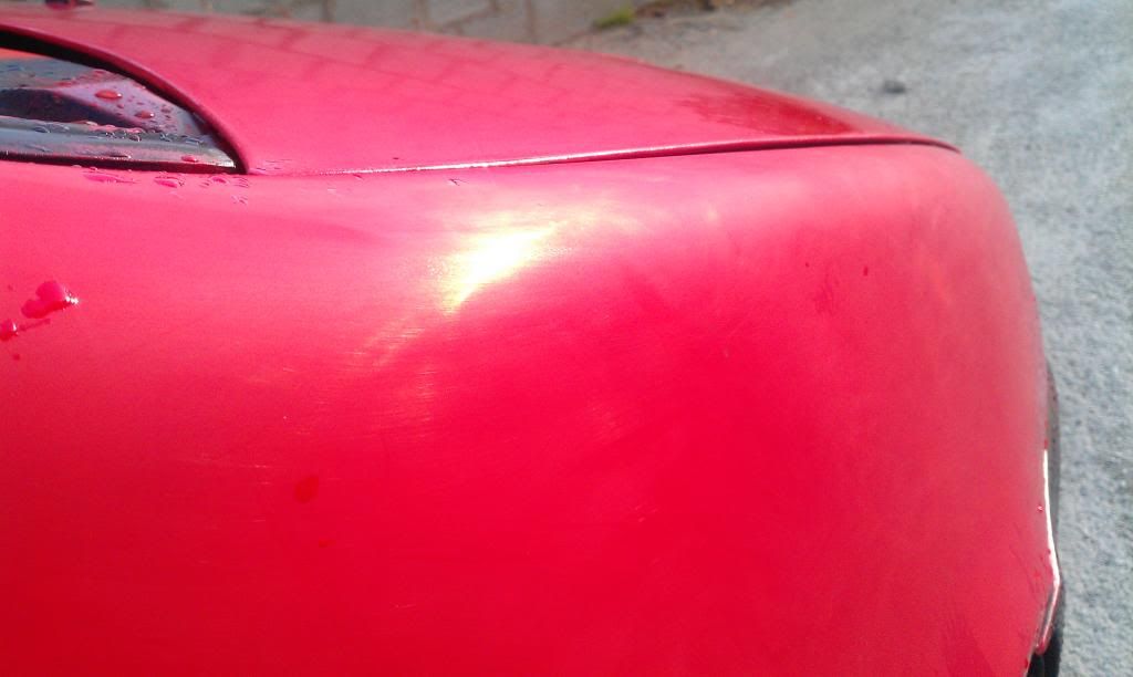

Working with 1200 grit I figured out it would take me some years to finish so I took the 600 grit and amazingly I finished one fender and door in only 4 hours.
I buffed it with 3 foam pads and 3 compounds,it looks shiny but shitty.Full of scratches when in full sun( in the garage all fine).There is no gloss in it Sad
So...today I took a 800 grit,sanded again,took 1200 sanded some more and took 2000 and sanded the hell out of it.Buffed it and deep gloss is back.
I took it on the hood to remove the orange left here and there and will do it one part of the car a day just to keep my mind safe from blowing the fuses.
One fender takes me 1 hour to complete on all stages-600,800,1200,2000 and buffing.
Tmr will buy some 1000 grit and a 3000 so I don't cut too much with the buffer.
It's just I've been working so long so far and I want it finished properly and not just as missy said ''anyway it looks better that it did before'' =))))))))

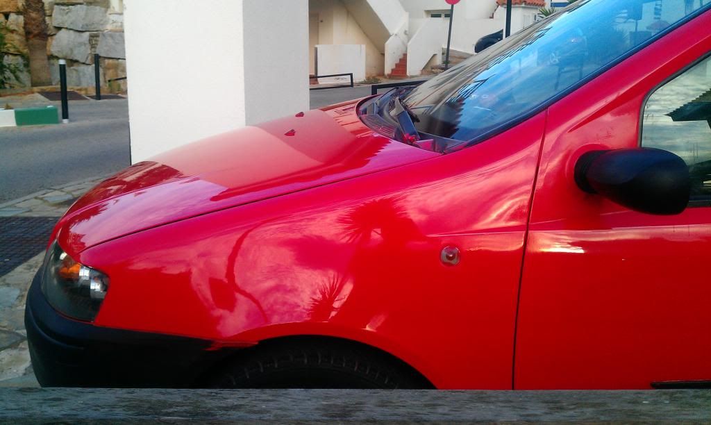

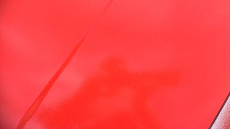

In terms of gloss now-sanded the final coat (I had 10 coats in total) with 600 then 1200 then figured out that I cannot skip grits so went back to 800 then 1000 then 1200 then 2000 and 2500 before buffing with wool pad then orange foam pad then green foam pad and finally black foam pad.
The result is a gloss and wet look far better than any factory paint job.The dept of color is so big it will turn heads on the street.Too bad my prep work on the sanding was not that good and some scratches were not covered by the paint and I can still see them from close range.
Anyway the looks on my wife's face worth all the time spent...she was jumping around it and smiling a lot.

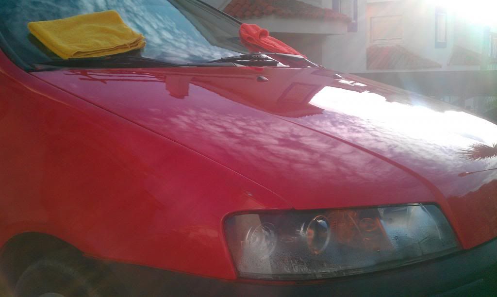

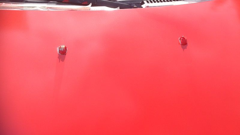

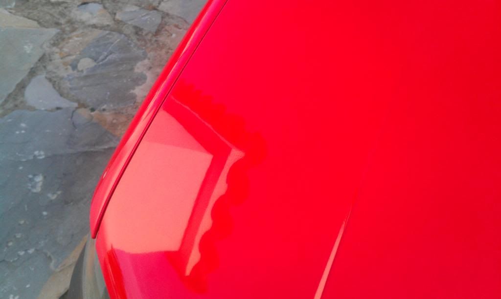

Anyway,here are the last pics during last sanding,washing,first buffer test on front fender then final product.Obviously there are plenty of paint marks left (paint dust from sanding)as I do not wash the car with water or under pressure and I was waaay to lazy to clean all back then so it took me ages to clean it all....and I can still see some marks even now.
Would I do it again? YES as there is no painting shop here in Spain where I live that can do such a mirror finish job for a decent price.For 700-1000 EUR all they offer is a 2 coats paint (if you are lucky),drips of clear coat all over and orange peel that can be seen from the moon.
