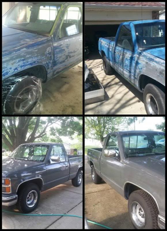

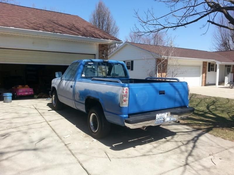

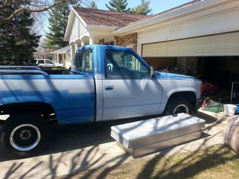

well It has been a while and starting another project here is my 1990 chevy 1500 picked it up 2 years ago in alabama for 800 bucks.
I have since moved to Illinois and this winter sucked after living in Ga for the last 7 years.
I did not start taking pictures as soon as i would of liked to, I tore out the raggedy interior and painted everything light grey and upholstered it in charcoal grey.

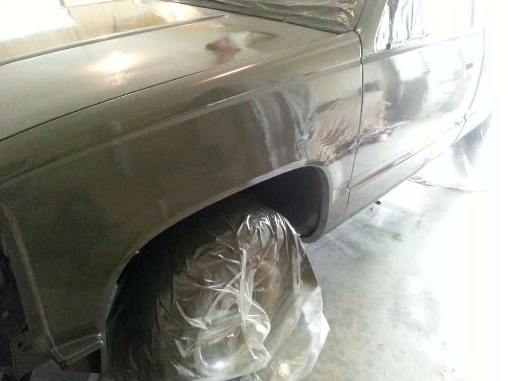

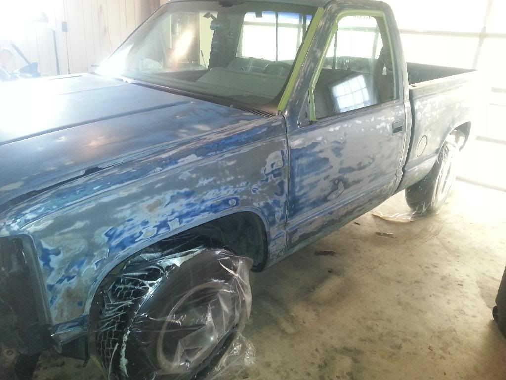

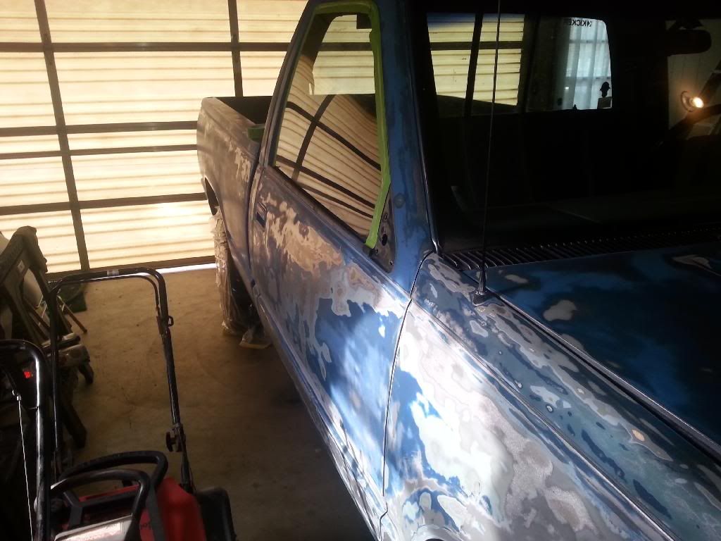

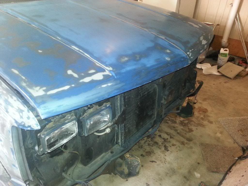

I believe the truck had a rattle can rusto job on it already the paint was delaminating pretty bad so they just covered with out any prep and so now i am trying to get everything smooth. the pictures in primer is just rattle can filler primer to cover the bare metal areas I am hoping to have it in primer by the end of the weekend as i am fairly far along in first smoothing out phase.
I plan on Spraying Rusto Charcoal Grey below the body line. and am experimenting with Rusto silver wheel paint for the top may just go with the rusto aluminium paint instead.

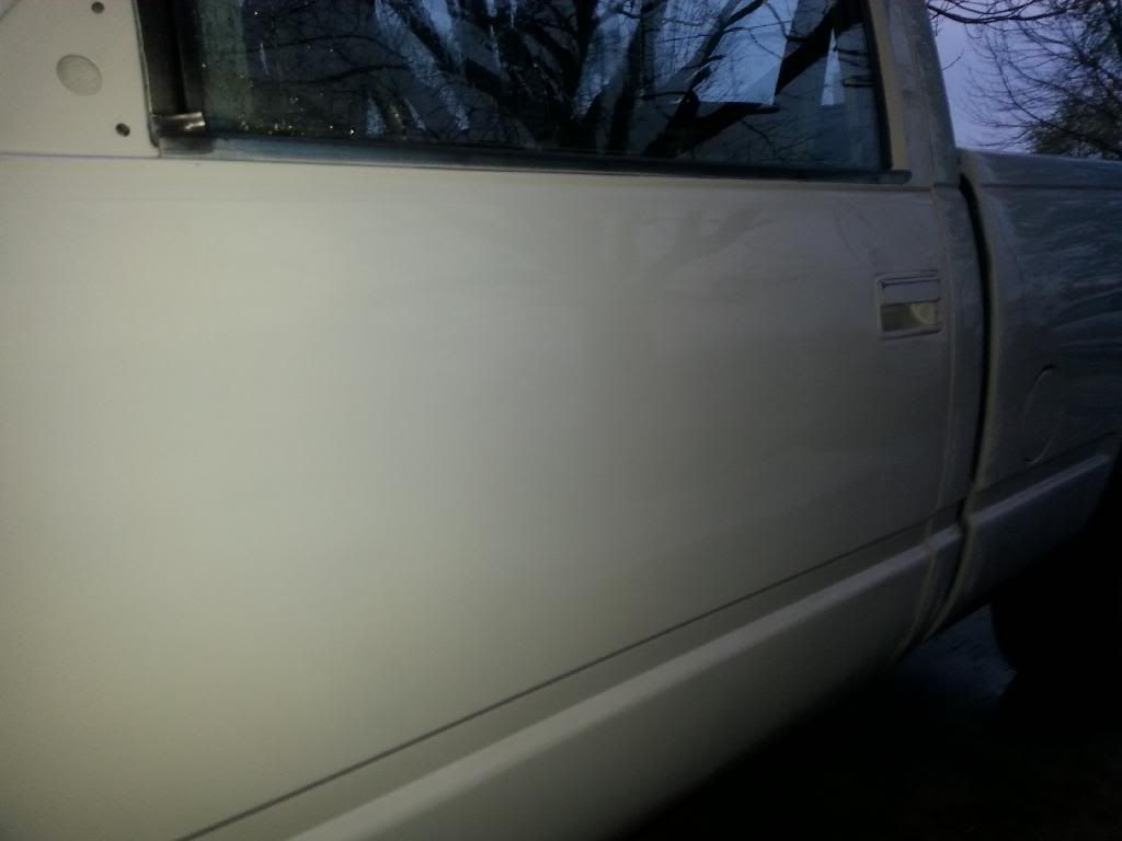

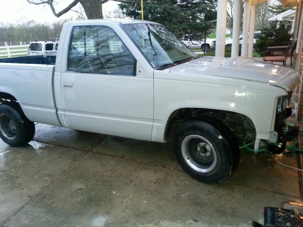

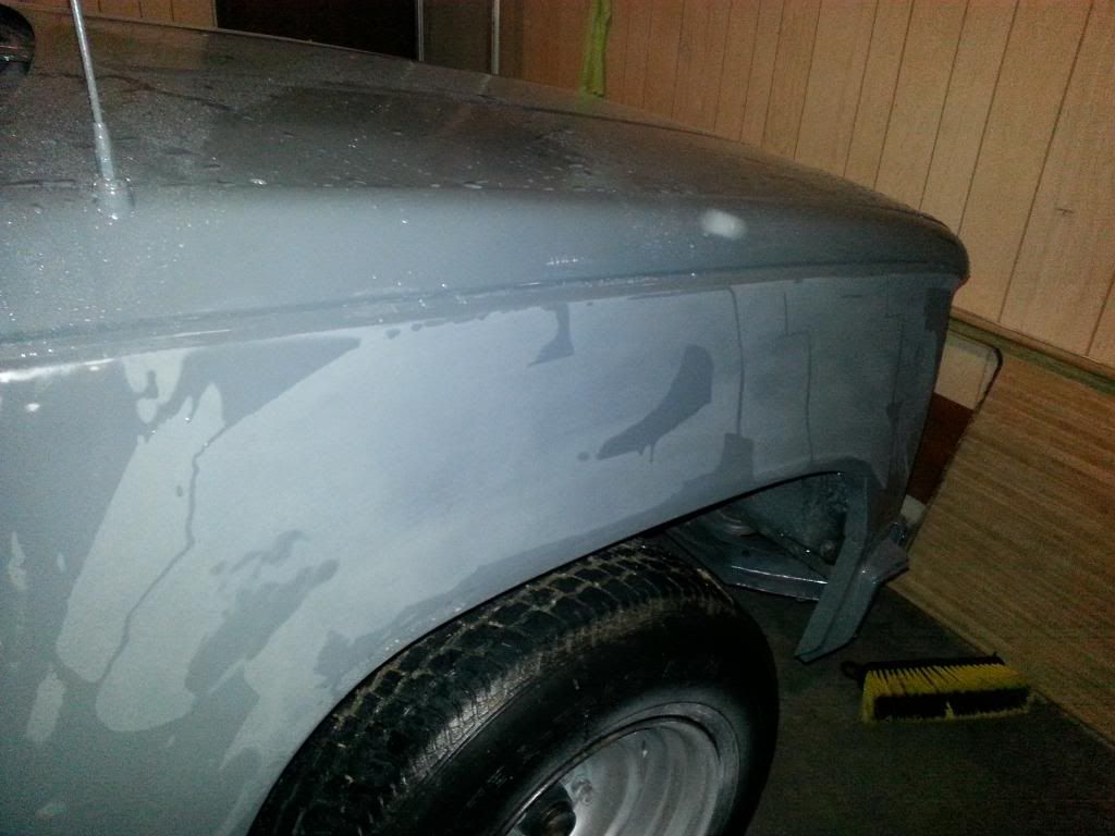

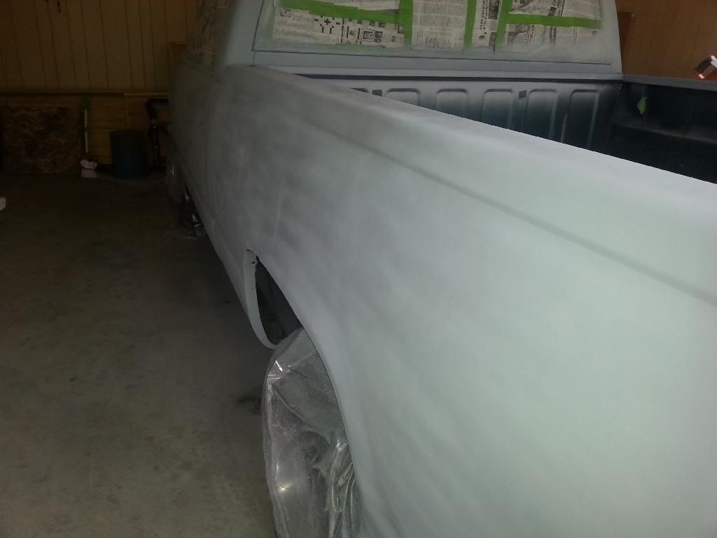

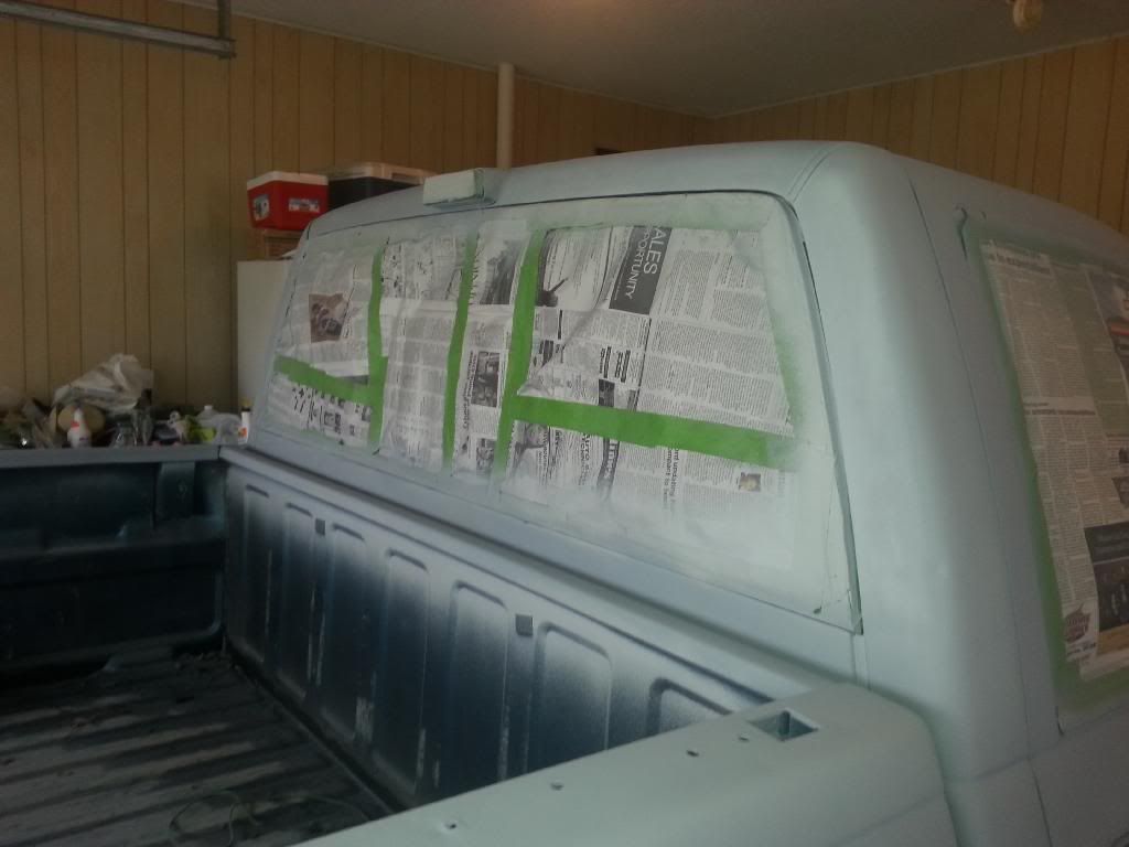

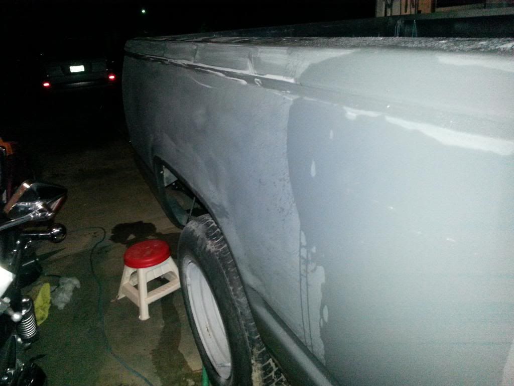

well finished sanding down the truck with 80 grit then 120 and 320 yesterday washed and is now sitting in the garage waiting for primer today after i get it all masked off
very small rust behind the wheel well trim hope my fix stays put for a while just filled it.

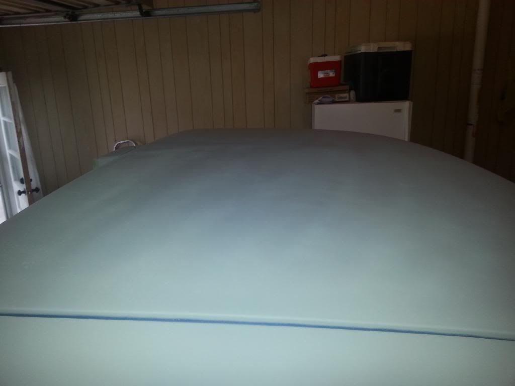

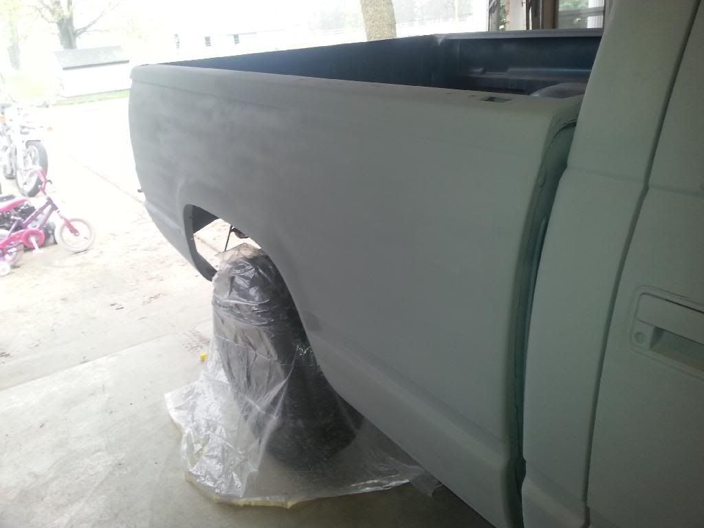

2 coast of filler primer

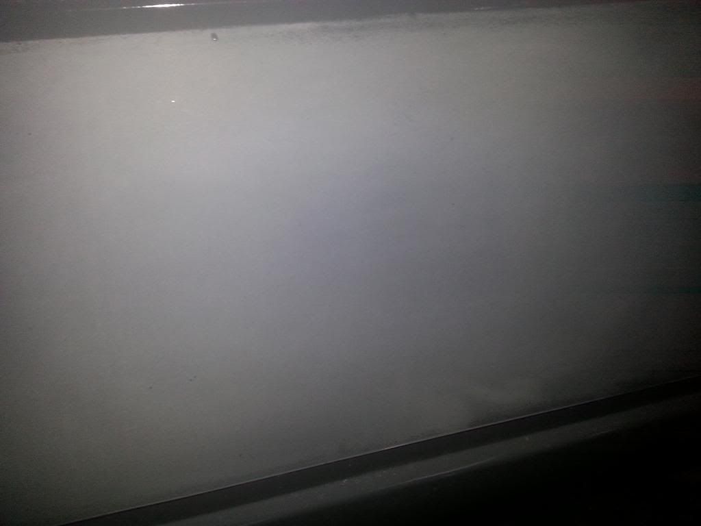

primer sanded with 400 dry on 6 inch random orbital buffer with a foam backing
had to sand off almost all of the primer on the driver side bed and whole tail gate because my sprayer decided to puke all over

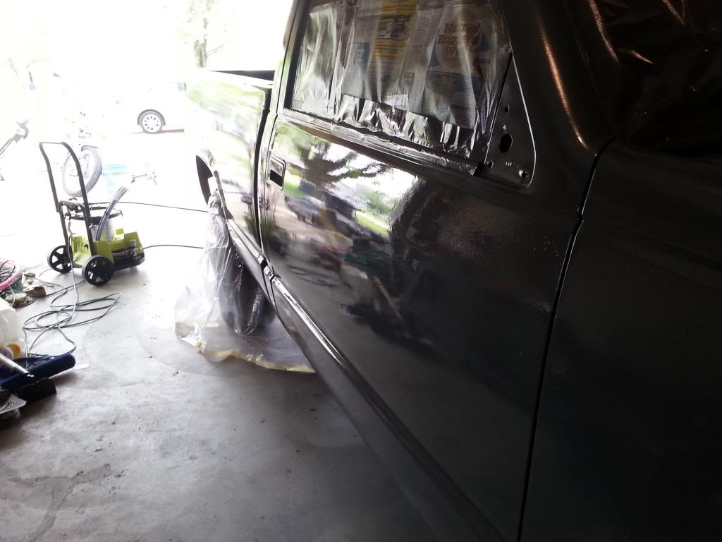

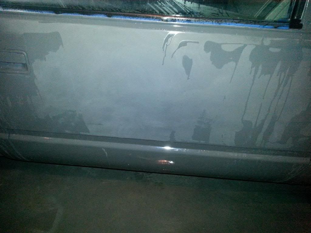

ok After a failed attempt at rustoleum Metallic from a can sanded it down sprayed primer over it and it cracked everywhere so I left it for about a week of being pissed and then sanded it all of and reprimed and got is sprayed today and holy runs and orange peel mixed it 3:1 should have been 4 so instead of driving 30 min to get another can to thicken it up i back rolled the runs did not turn out as well as i had hoped straight out of the gun the last one i sprayed was white so it was alot more forgiving.
so I am going to let it dry for a few weeks and wet sand the OP out some areas are terrible some areas flowed out the hood looks amazing

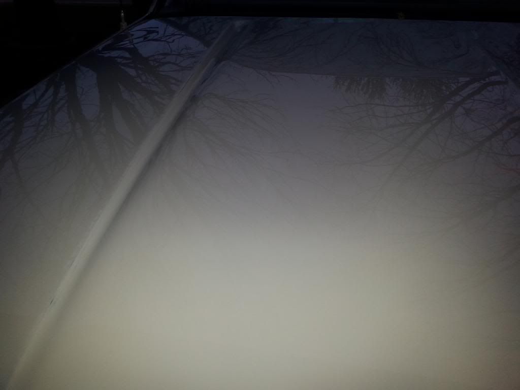

Hood

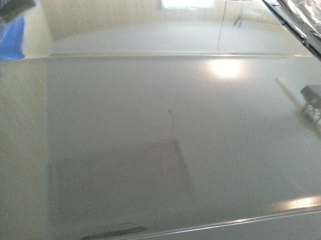

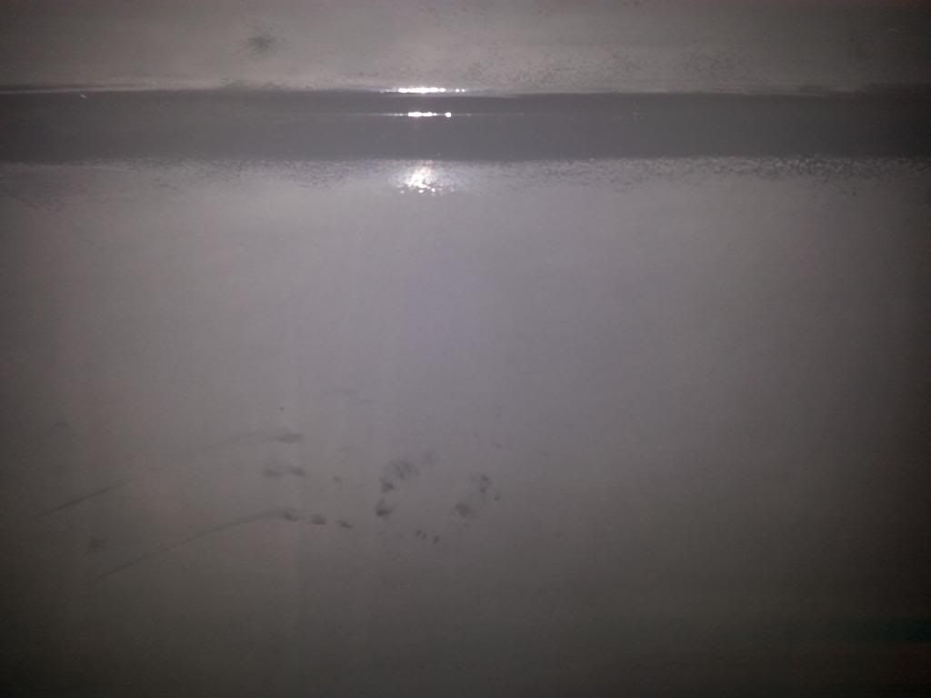

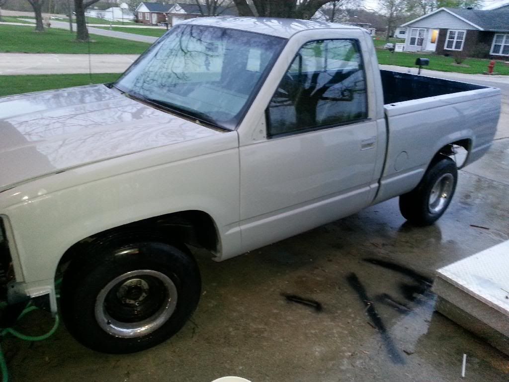

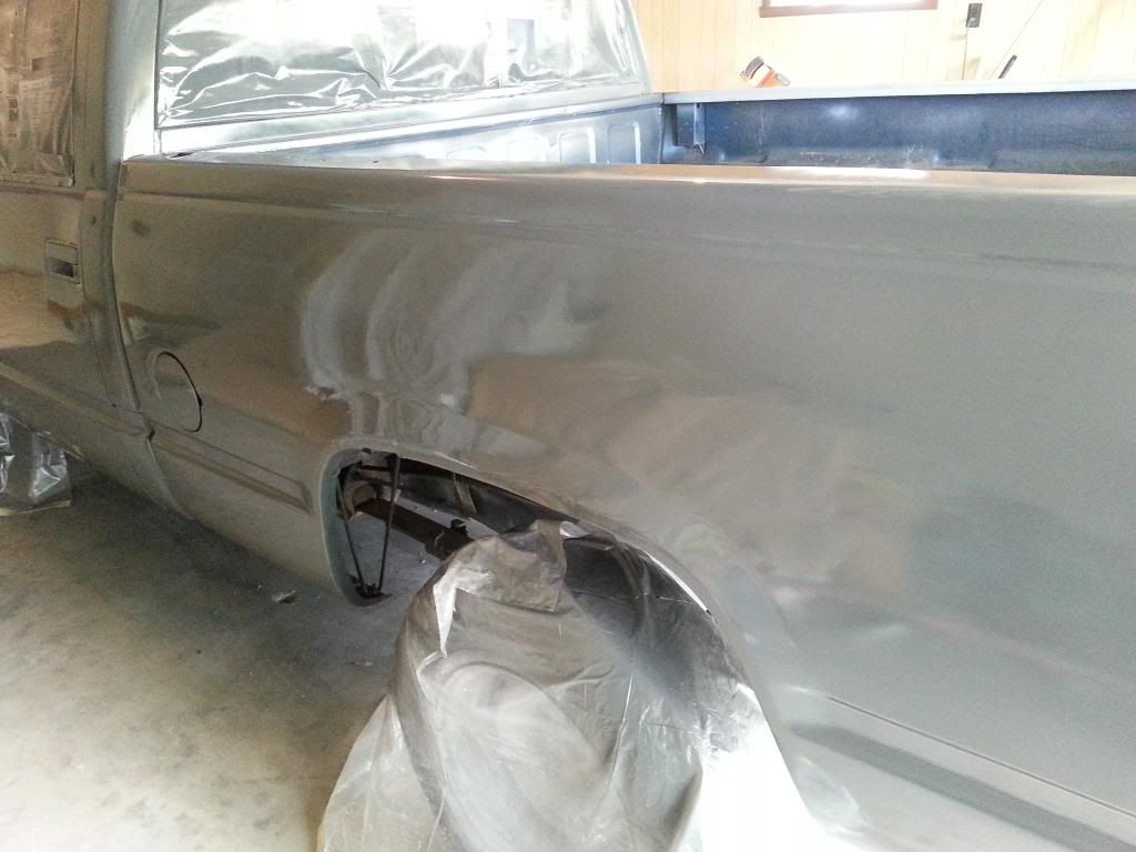

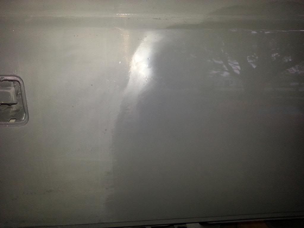

wet sanded all the massive OP out burned through a few spots Touch up those spots tomorrow wet sand 2000 grit and polish i cut the tailgate to see how it looked am pretty happy with it has a haze to it which i believe to be ultimate compound that i did not get off fully

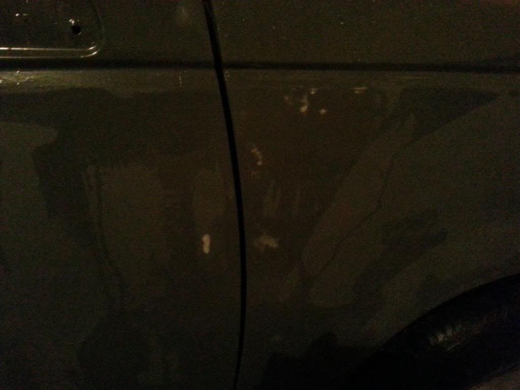

Burn through really bad OP in this area
I damp sanded with 400 grit on my random orbital buffer at about 2000 rpm to cut the Op down Quickly
tailgate test area

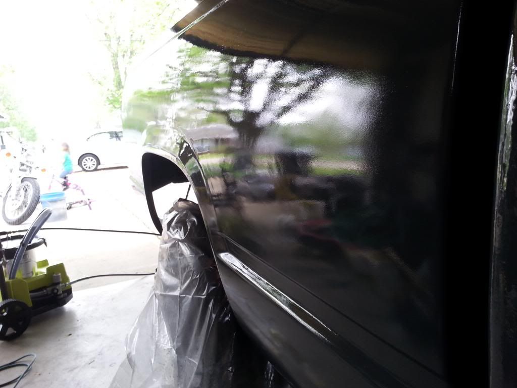

Post by stang87gt on May 28th 2014, 10:06 pm
well i do believe my build has came to end after about 30 hours wet sanding and another 20 cutting and buffing

thanks mike. it is actually charcoal grey and the gloss came out better than expected and it hides pretty well for being a dark color
