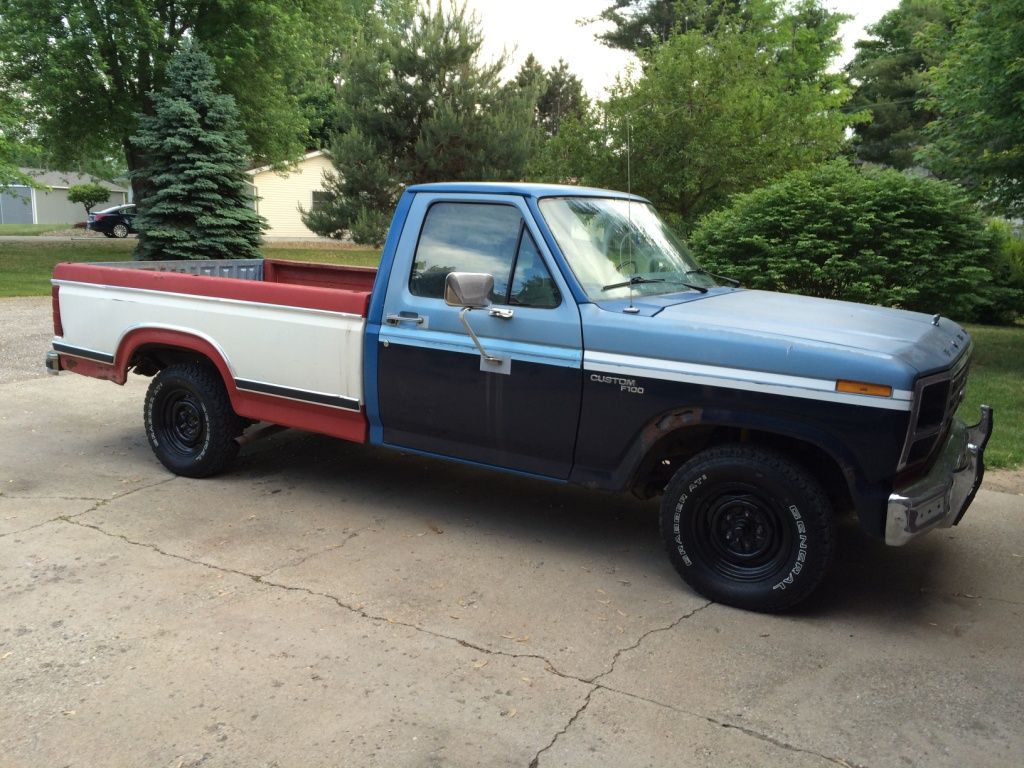

First off, my truck is a hybrid of 1981 and 1982 F100/150 parts. The 81 was sold to me by my wife's grandfather for $1, and I picked up the 82 out of Arkansas for $350 and sold the 302 for $250. The 81 being a Michigan truck from day 1, it had a lot of unusable metal. But I wanted to keep the interior and engine/trans (or the 'soul' of the truck Wink ). Basically everything else came from the 82. The emblem on the 82 said F100 but I'm not convinced. The frame was solid vs the Swiss cheese of the 81 (weight savers), the brakes were bigger, and there was an extra leaf spring. I'm not a huge car guy, so I hope I don't get shellacked for not knowing why. I only assume it wasn't really a F100.

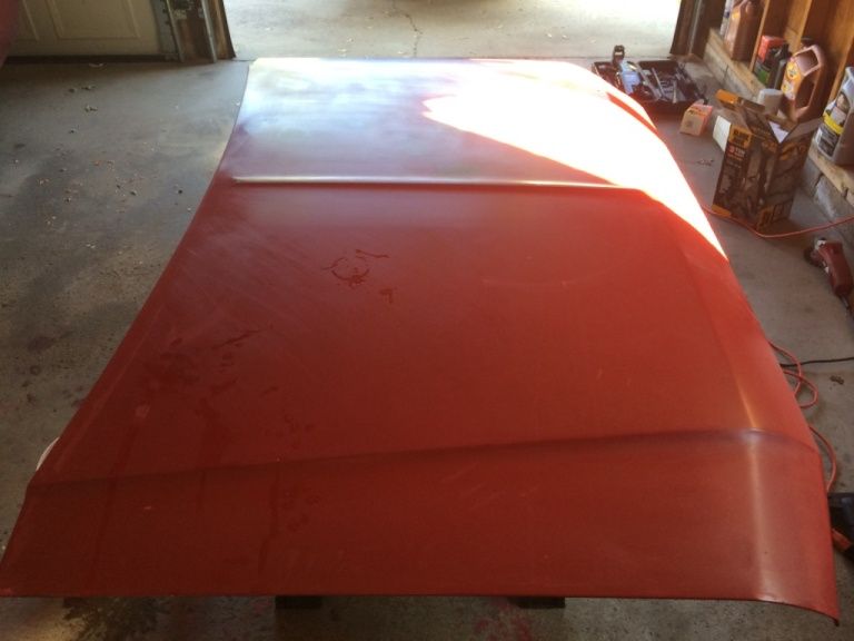

Here is a pic of how I found her 7 years ago...

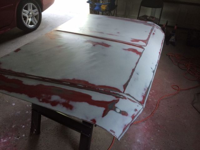

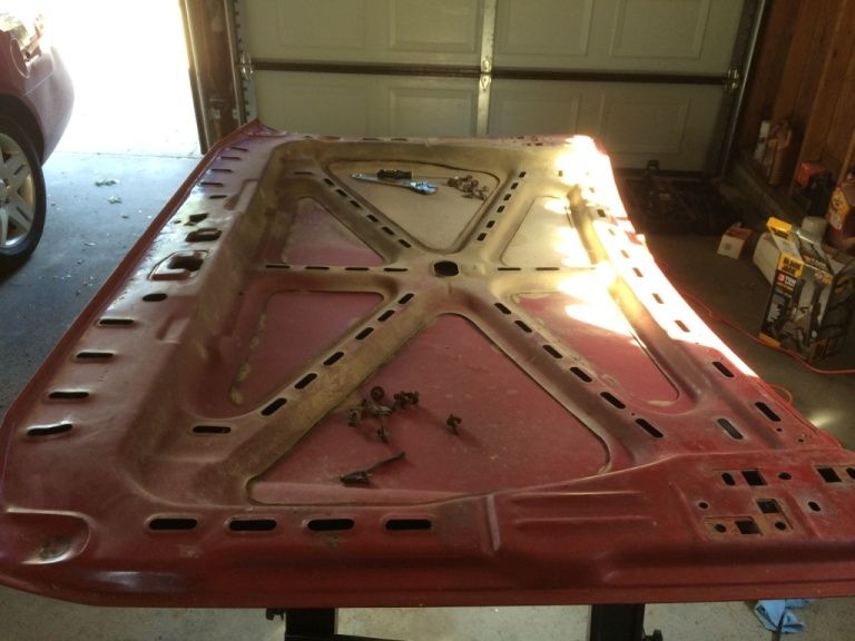

So now for the paint... I've started testing my technique on the hood. I sanded down the original paint (to metal in a few high spots). I added some filler, wet-sanded with 180, then 320. I added a thin guide coat of Rustoleum Primer Surfacer over my filler areas to get a better idea of the high/low spots (which worked really well in my opinion). Now I have my first real coat of primer on the top of the hood. I'll likely do the second coat this evening, sanding possible on Saturday evening or Sunday. I thinned the primer surfacer 10:1 for the first try but it wasn't enough. I didn't want to thin AT ALL, but this stuff dries SO fast that I thought I should. Now I plan on thinning 5:1 to give myself a more even finish and longer application window. Oh, and I'm thinking with Penetrol thanks to T. Hadley and many others who vouched for it.
gotta love that Arkansas clay...
FYI - I tried Bondo Glass but didn't like it and went back to using normal light filler. It seems VERY strong, but applying it was a huge pain. You can't shape it or smooth it or anything during application like the normal Bondo light filler. The Bondo Glass is like trying to spread molasses.
I'm planning on doing Royal Blue... and possibly a second low-body-line color of charcoal grey. I haven't decided, but fortunately if I don't like it IT IS EASY TO CHANGE!!!

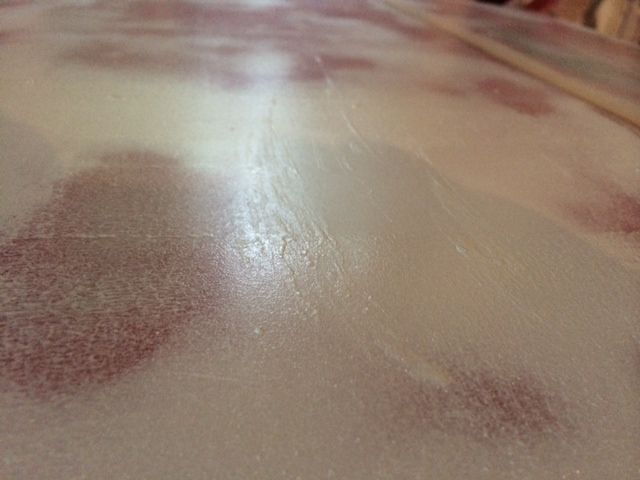

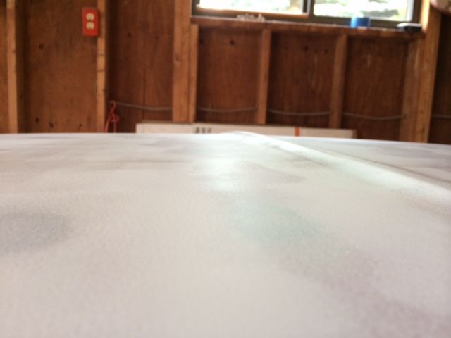

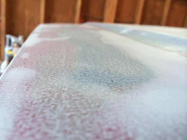

I'm not sure how well you can see in the photo, but I had 'pinholes'/orange peel or roller marks that went as far down as the original paint. Meaning to get the hood smooth, I have to remove basically everything. I think this happened because I still hadn't reduced the primer enough. It was literally drying as I rolled. I plan on trying 2:1 tonight and possible 1:1 if it is still drying to fast.
So now I have a question for anyone who used Rustoleum Primer Surfacer... did you reduce? How much? Also, did you apply 1 coat then sand, or multiple coats then sand? I think applying a second coat with my ratio was a bad idea. It didn't have any time to flow how and just make the peaks/valleys worse.
So then I broke out the random orbital and 220 grit paper dry. It left some 'ripples' that I can slightly feel with my palm, but I expected that. I left a bit of primer almost everywhere, and I'll wet sand it smooth with a block (probably tonight). I think I'll just use 180 grit with a very light touch to save time, since I'm going to be applying more primer anyways. The primer, if reduced enough, should flow and fill in the scratches (I hope).
The most noticeable 'ripples' from the random orbital were on the front contour, but this block sands really nicely so I'm not too worried.

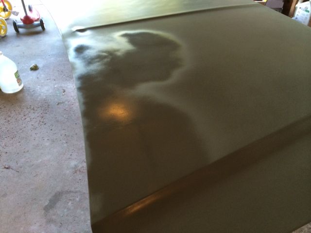

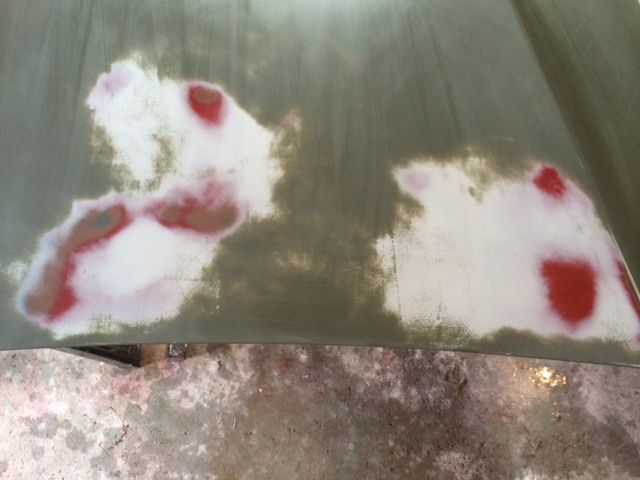

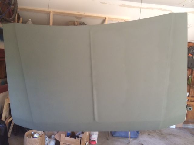

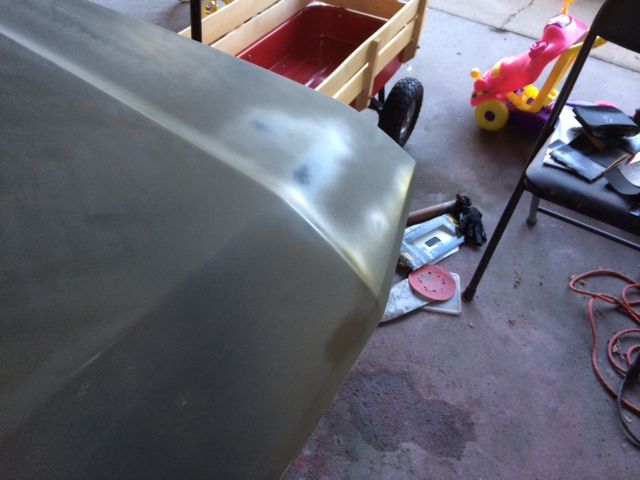

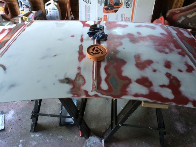

I wet sanded last night with 180 grit to take out all of the waves left by my orbital sanding. It went pretty well, and almost everything seems flat. Here is a pic showing one half wet sanded (right), and the other half waiting to be sanded (left).
I took a couple pics of obvious high spots for future reference. I figure when I get enough primer on the hood, I'll wet sand until these high spots start to show (but not enough to get to bare metal again). Then I could always apply one more thin coat of primer, wet sand with 400 or 600, and I should be good.
Here is the pic of both halves wet sanded. The left still has more primer remaining than the left. It is hard to tell in the pic, but even the primer on the left is razor thin and I could see the original paint starting to bleed through everywhere, so I thought it was 'good enough'. I can overdo it sometimes, and I read often on here that you have to choose when 'enough is enough'. We'll see how disciplined I can be with that motto.

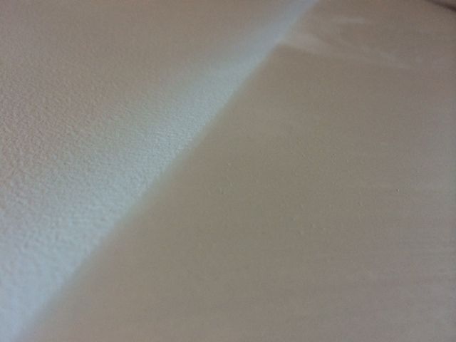

Then I mixed my Rustoleum Primer Surfacer with Penetrol 2:1 respectively because of my earlier problems. It did flow out nicer, but I still think I am too thick. Here is a pic of the orange peel I am getting with the new mix. It is MUCH better than the other thicker ratios, but I'm still not happy with it. I am getting a lot of roller marks from where my painting areas overlap. The paint is still drying to the touch in about 3 minutes, which is way to fast for me.
The orange peel can be made out (hopefully) in the above pic. Here is the overall coverage of a 2:1 ratio, 1 coat.
Here is the reason that I am still not happy with the ratio:
Literally 2-3 minutes after rolling a section, I will try to roll the section next to it. If my roller (no pressure, only the weight of the roller itself) overlaps the previous section, it picks up the fresh paint. I need an even longer drying time so that I can roll an entire piece without it drying.
I plan on wet sanding today or tomorrow with 400 (or 320 if 400 isn't doing the trick) wet. Then I'll mix up more primer 1:1 and give it a go. My other option is to add some mineral spirits to the mix. I thought Penetrol and MS did approximately the same function, but I could be wrong.
If you have any suggestions, please let me know.

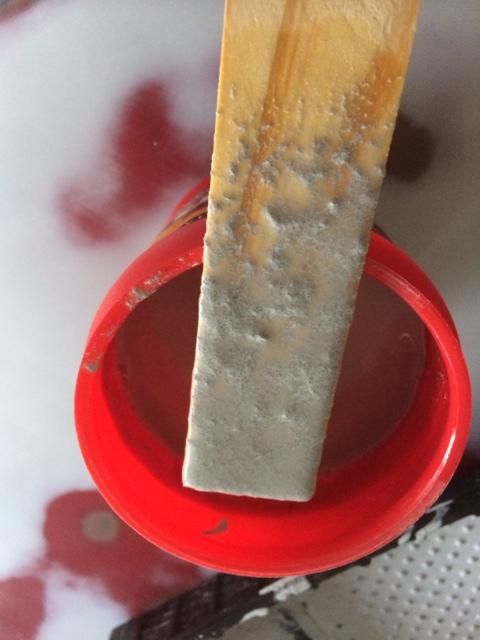

So I started mixing my 2:1:1 primer, penetrol, MS ratio... but I discovered after adding half of the MS that I have the 'odorless' MS... NOT GOOD! I'm sure you've seen the negative feedback from others on here about the 'odorless' MS, but I am here to confirm one more time. DON'T USE ODORLESS MS!
I thought "what the hell, it's mixed. I should at least try it". This is because I had 2 quarts of the primer in the mix, as well. About $25 worth... so I was at least going to try it. I quickly found out that it wouldn't work. Some sort of reaction made the paint separate from the MS almost immediately and turned the paint into a glue. You can kinda see in the pic below the 'vertical' streaks... ya that's the paint turned to glue. It would literally leave a kind of 'sticky string' between my roller and the hood as I pulled the roller away. NOT GOOD!
So then I put aside all of that mix into an empty paint can that I will dispose of later, and mixed up a small amount of the primer and penetrol only (1:1). I then rolled the rest of the hood except for the part I had tried and failed to roll with the MS mixed in. These are the results:
You can see in the above pic, that even with 1:1 the primer doesn't lay evenly at all. It clumps up and almost separates from the penetrol. Here is a pic of my 'initial mixing' with a paint stick. I always mix completely with an attachment on a cordless drill. You can see that the primer is very clumpy.

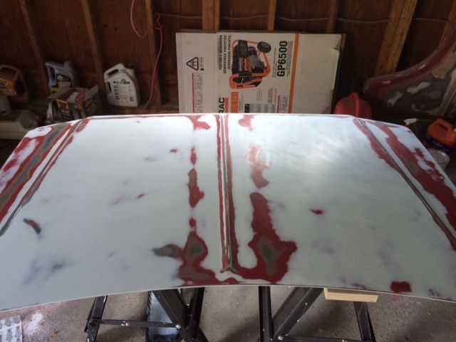

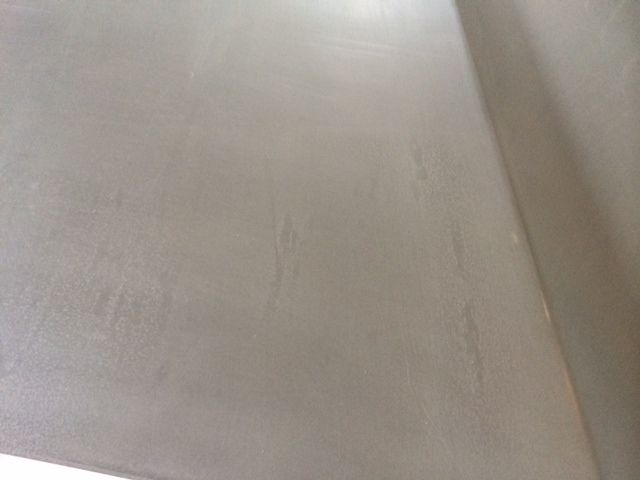

For the sake of progress, I spray painted the rest of the hood with a can of 'self-etching' Rustoleum primer. I was getting tired of messing around with the roll-on Rustoleum Primer Surfacer. Maybe I will try it again later on a different panel with a different mix, since I still have half a gallon left.
Here is the spray bomb result:

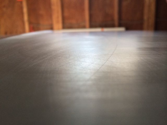

I wet sanded the entire hood with 400 grit:
The self-etching Rustoleum spray paint actually sanded quite well! It loaded up the paper a bit, but not too bad. Also, not sure if it's my technique, or the spray paint in general, but I had almost no orange peel to sand out. Mostly I was sanding just to get a dull/even finish. (I'll claim it's my spray painting technique!  loco )
However, I did burn through the primer to bare metal in one spot:

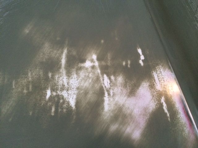

And I had another problem spot... If you recall from an earlier post - I accidentally mixed the primer-surfacer with ODERLESS mineral spirits (still a terrible idea). The mixture turned into some sort of hellish glue and left streaks. These streaks weren't sanding smooth with the 'light' wet-sanding/400 grit.
If you look closely at this pic, you can see the dark 'streaks'. Yea... that's the glue mixture I rolled on  wrong
So I decided to sand this down far enough to make it smooth with 320 grit wet
In the above pic you can see the much lighter colored primer-surfacer start to show through where these high streaks were. Needs more sanding...
THERE WE GO!  cheers

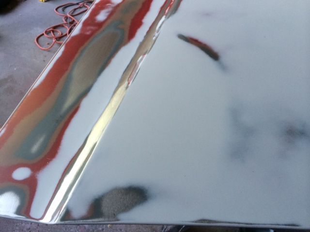

So then I decided to spot primer from a rattle can those places I went down to bare metal
and #2
So tonight (if I have time) I will sand these places dull to match the rest. I want to stop at the hardware store and purchase some 'normal' mineral spirits for the color enamel mix. I also thought about buying some 'Japan hardener' because I read some people had good luck with it. Any input on that?

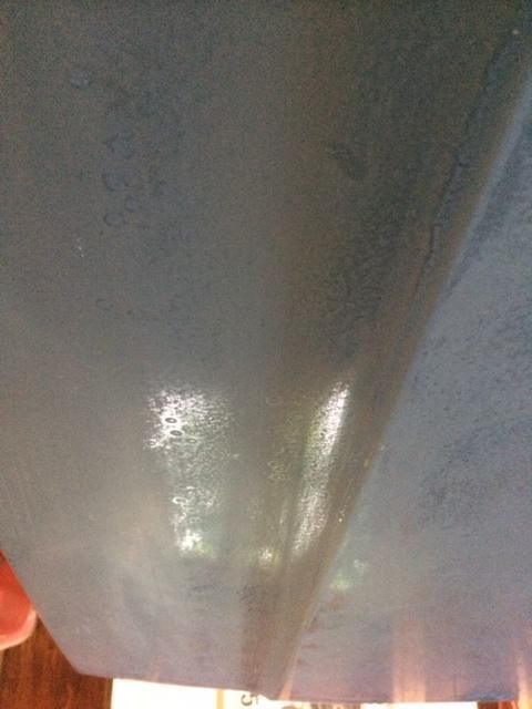

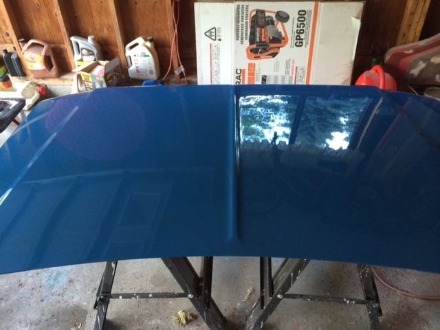

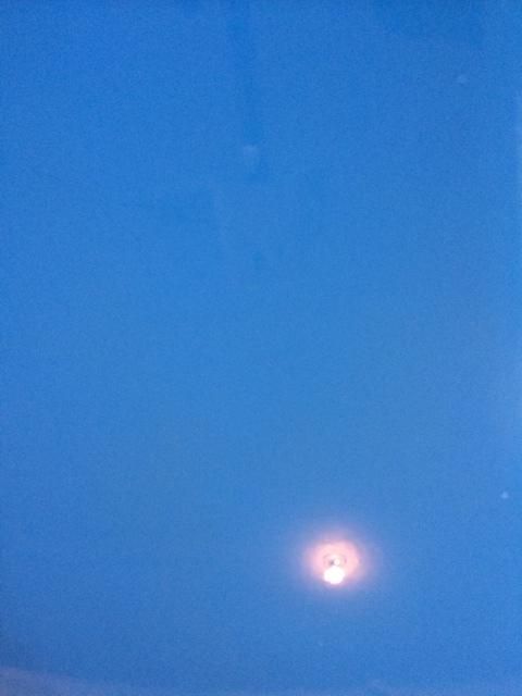

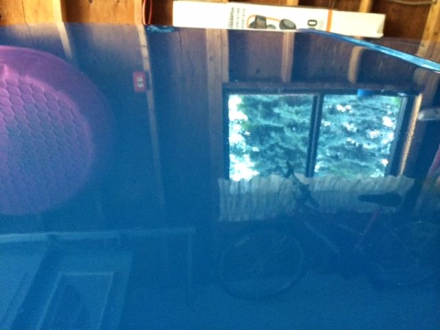

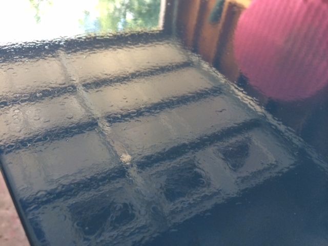

My first color enamel mixture trial:    2:1:1 Rustoleum Royal Blue, Mineral Spirits, and Penetrol

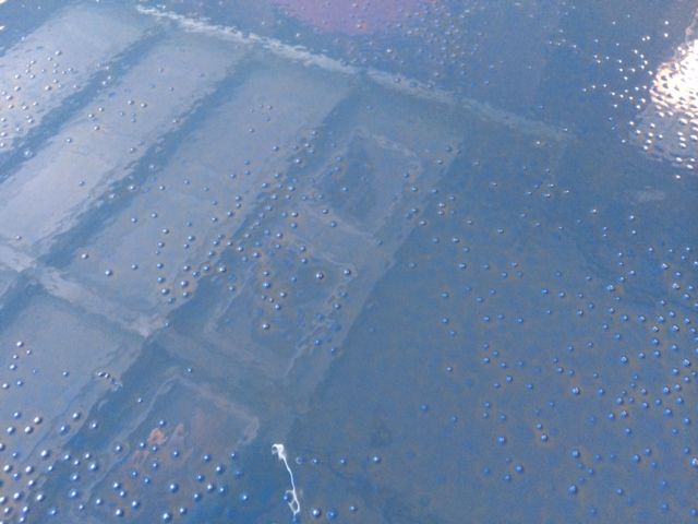

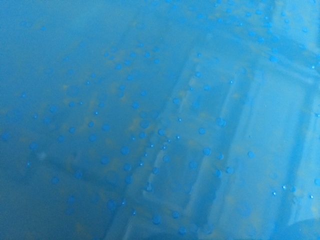

Everything seemed to go well. Though there were a LOT of air bubbles while rolling. I used a 6" high density foam roller. The "better" brand at the home depot.
Here is a picture of the bubbles immediately after rolling:
Here is a picture of the bubbles after 're-rolling' with a 'dry' roller. The roller wasn't really dry, but all of the 'loose' paint had been rolled off. It was re-rolled with only the weight of the roller doing the work/no pressure.
Is this normal? If not, what is my problem?

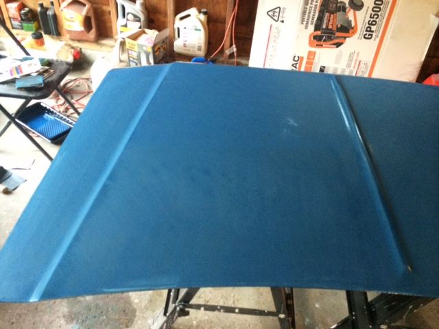

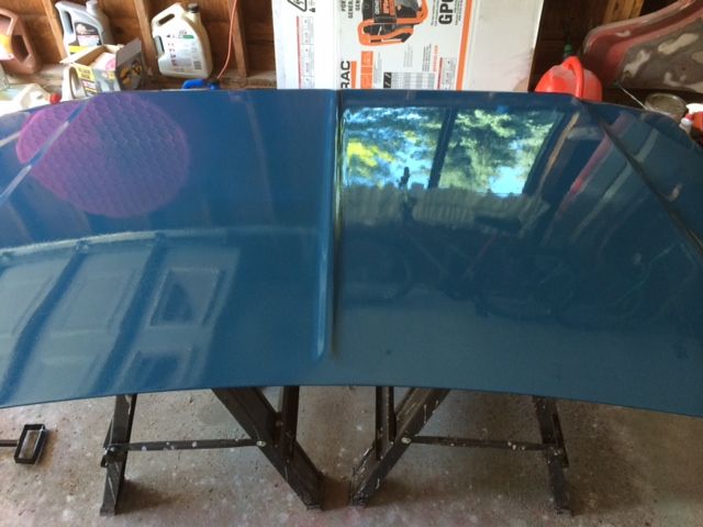

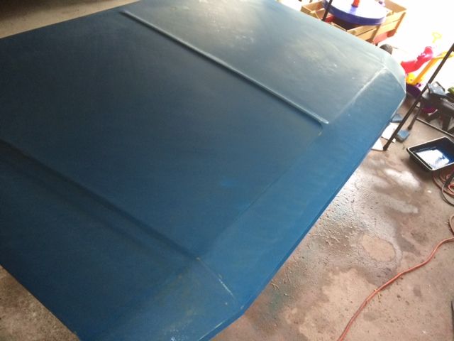

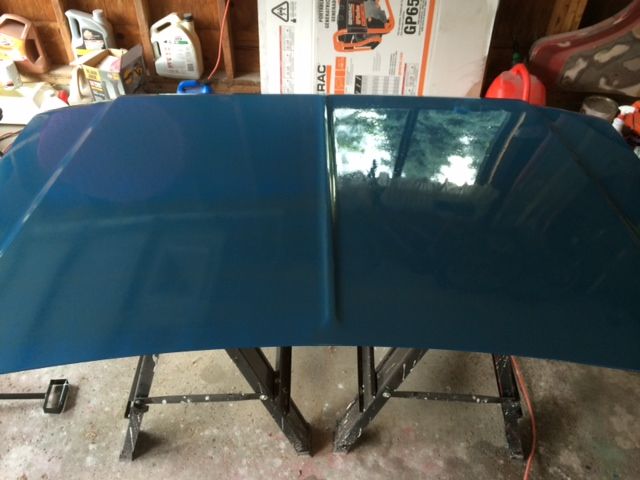

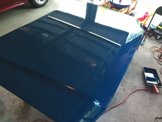

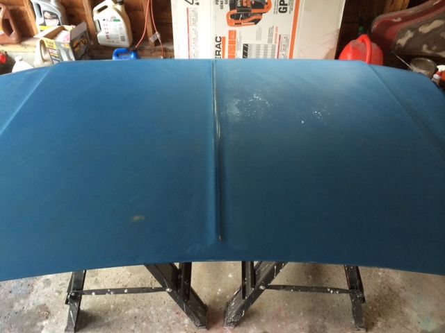

Then I proceeded to roll the entire hood. I borrowed my wife's hair dryer at the end, set to low heat and high speed, to try to pop the remaining bubbles. It worked really well. But next time I will have the dryer in hand from the beginning, popping bubbles as I go. I found that the areas I rolled first were difficult to pop bubbles. It seemed that they were already starting to set.
Here are a bunch of pics of my FIRST color coat:
In the next pic, you can see what the popped bubbles left behind:
Looks like OP to me, or the beginning of it. I wonder if they will 'flow out' any overnight. I guess I will see tomorrow. The hood looks a lot better from 3 feet away in the pics than when you get up close, but I am quite pleased with the first coat. Tomorrow afternoon I can hopefully do the second coat. I think most people wait around 48 hours to wet sand? Of course that depends on weather/etc.
I'm also glad I used a darker primer. It made the coverage of the first coat look amazing from a distance  lmao It is hard to tell, but up close the coverage of the first coat looks comparable to other projects where 50/50 mixing was used.
When finished I put the roller in a ziploc bag with a cap full of mineral spirits. I'm hoping I can reuse it, but we will see. I have extras just in case.
Oh, I have a question for you all. When you bought 800 grit paper, was it actual paper? Or was it some sort of 'scuffing pad'. My local autozone only carries the scuffing pad. I think I'd rather use paper, so I'll have to look around elsewhere unless the scuffing pads is what everyone else used with such great results?
I'll probably post some more pics of the second coat. If you guys/gals have any questions or suggestions, please don't hesitate.

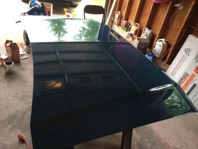

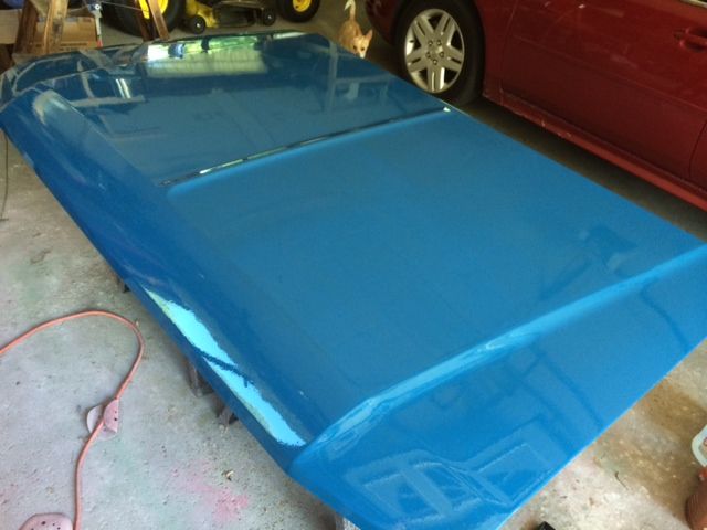

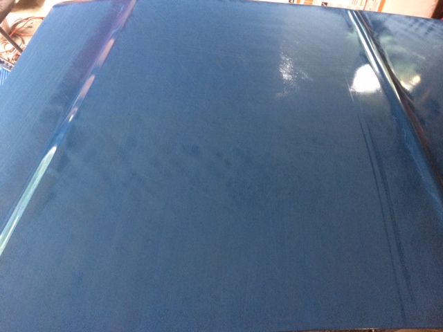

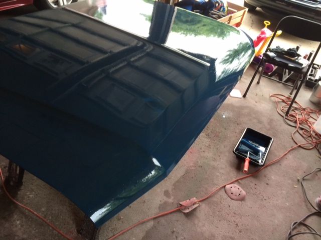

Post by 81F100 on July 13th 2014, 6:17 pm
Rolled the second coat today. I kept a hair dryer next to me, and after rolling each section I would immediately pop all bubbles (low heat, high speed). It worked really well, and seemed to let the paint flow out better once the bubbles were popped.
Here are some pictures of the second coat. The true Royal Blue is starting to show.
In this next pic you can see what the true finish is like. It's almost like a million paint-drops just flow into each other for each coat. Is this the experience of everyone else as well?
So now I'm going to wait for the paint to dry before wet sanding. I might put the hood out in the sun tomorrow while I am at work. Until next time!
Last edited by 81F100 on July 15th 2014, 4:14 pm; edited 1 time in total (Reason for editing : Not sure why the second picture doesn't show up correctly... tried to fix it and failed.)

Thanks for the support! I wish the progress was on more than just one piece of the truck  Sad
I did some color sanding last night with 600 grit wet and my tiny little rubber block. I'm starting to agree with Nomad that I need a longboard. The next time I'm near Harbor Freight I'll have to take a look. I did, however, buy a 'larger' tiny rubber block from the auto parts store last night. I'm hoping it will help a bit. The biggest problem I faced with the small block was the lack of give. I noticed that the paint buildup on the sandpaper is all in the center of the block, and not evenly dispersed on the face. This means only 20% of the block is making contact with the surface of the body... not very efficient. The block I bought last night seems to have a bit more give, and I hope it will make more contact. I will find out tonight.
Here are some pics (I know how people on this forum love pics!) of my color sanding escapade. You will notice that I need a lot more sanding for an even dull finish.
You can really make out the orange peel in the last photo. I've read a lot of comments on how the OP will decrease with each coat, which means it must be true... right? I just don't see how. I guess I will find out. I sure hope it's true because I can't imagine that 1500 or 2000 grit would do anything against this OP.
Oh, and I ordered (yes, I had to order because it's not carried anywhere) 12oz cans of Royal Blue spray paint. I need these to do the underside of the hood, doors, fenders, etc. I'm not going to roll, sand, or any of that. I really need to spray the underside before going to much further on the rolled coats.

To begin, I'll plug 3M. So far I've had the best luck with their sanding blocks and sandpaper. I'd go as far as to recommend it, but it isn't critical I don't think.
So I tried my new slightly bigger sanding block and 600 grit to finish wet sanding the first 2 coats of color. Here is where I decided to call it good 'nuff:
Then on to the 3rd coat of color. This time I tried a NEW mix, courtesy of T. Hadley and his awesome father-son project!
MIX FOR 3RD COAT:      1:1 Rustoleum Royal Blue and Penetrol
I think Mr. Hadley might have used 2:1 but I'm not sure without going back and trying to find it.
I noticed one big difference immediately... LESS BUBBLES.
Here is a picture of the bubbles immediately after rolling (they were popping immediately, as well)
Here are the bubbles (or lack there of) after 'tipping' with a spent roller (no new paint added):
If you go back a couple posts and compare the pictures, you can see that there is a big difference! I really only needed the hair dryer in a couple spots where the bubbles didn't want to roll out. It also seemed to make a much better finish. I didn't notice the "million drops flowing into each other" like I had on the 1st 2 coats.
Here are just some random pictures because I was happy with the finish, and if you are like me... you love seeing other peoples pictures. Though you might be getting tired of seeing this darn hood ( I kind of am... )
Oh, and if you notice in this next pic I shaved my scraggle while in Germany. Much easier to eat without wearing my food haha!
Oh and I followed the same prep steps as outlined before coats 1 and 2, if you were wondering.

I put another coat of 1:1 Rustoleum Royal Blue and Penetrol on the hood last night. I used a cap-full of MS in the ziploc bag that I keep the used foam roller in, and I think I used too much MS. The first few rolls of new paint had the same appearance as coats 1 and 2 (BUBBLES EVERYWHERE). But overall, it didn't have much of a negative effect.
Here's me again...
and I would like to say... fish eyes make me sadddd....  frown
I didn't wipe down the hood with anything between coats 3 and 4. I also made it a point not to touch the hood after coat 3, but apparently some debris fell on the hood that the paint didn't like very much. In the future I will wipe down between every coat to avoid these depressing dimples.
Oh, and I don't know how much I will do between now and Sunday. My wife informed me yesterday morning that I had to update/paint one of our bathrooms before Saturday 3pm because she is having guests... so that's my life after work for the next 2 days.
I should've taken another pic this morning. In the 2 pics above you can see a lot of bumps and OP. Of course it didn't allllll disappear, but most of it flattened out overnight. It's been unusually cool here the last couple days (high 60's low 70's) which has been great for painting. I am starting to see why T. Hadley said he will never roll without Penetrol going forward.
