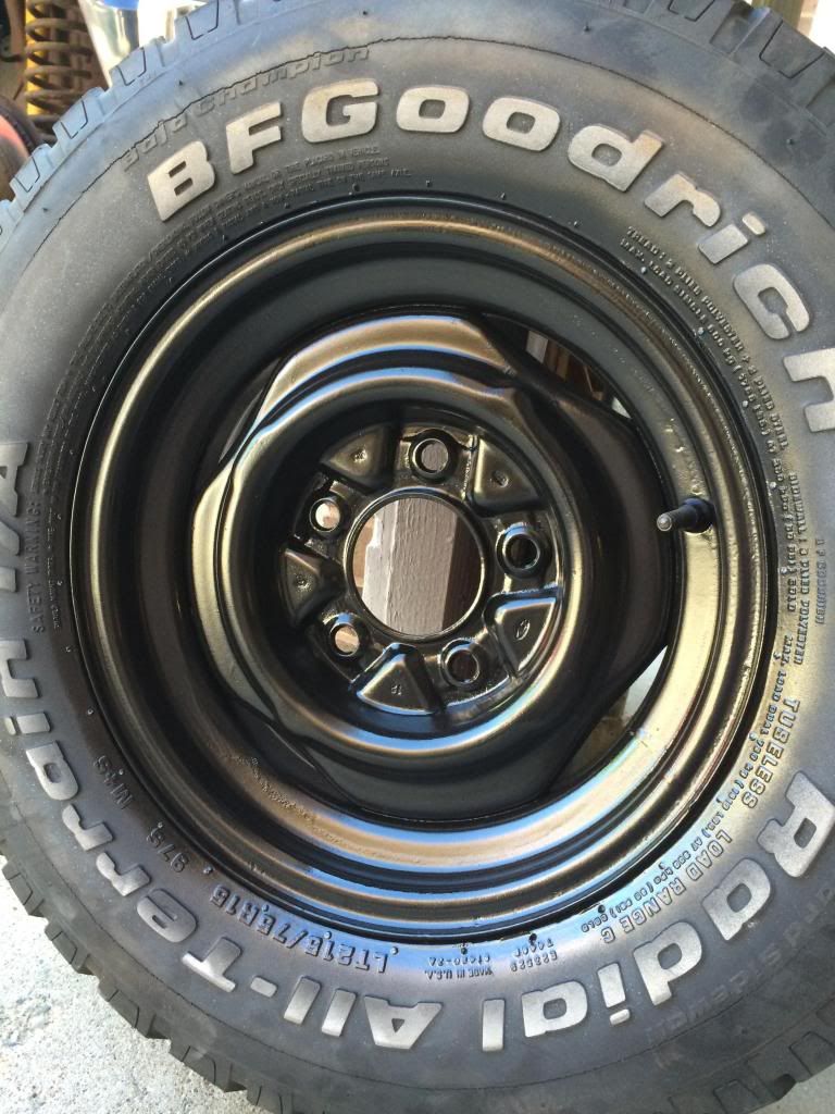

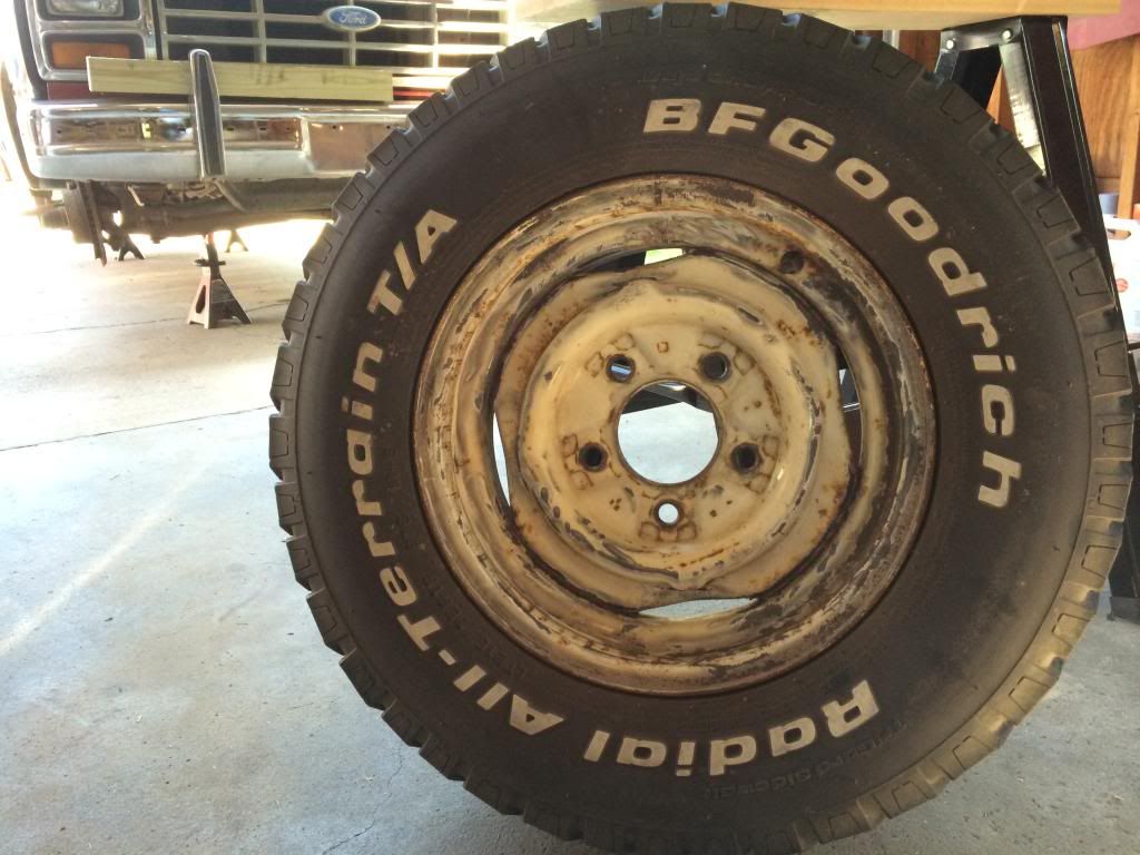

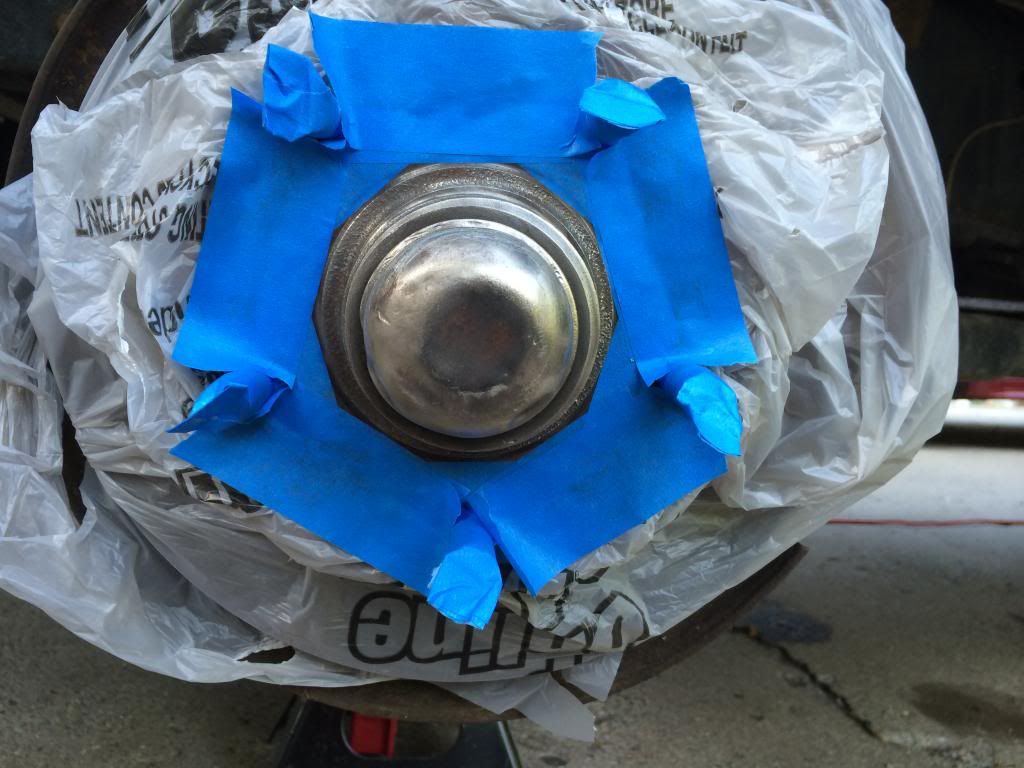

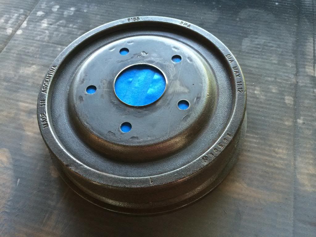

And just so this post isn't completely useless, here are some pics of my steel wheel repaint (spray can) and brake drum/dust cap repaint (VHT paint). I recommend the VHT for just about anything. Though I can't bake it like the can suggests, it seems to dry much harder and higher gloss than the Rustoleum gloss black even without baking:
I kept the old tires on the wheels while painting, then after the paint hardened for a couple weeks I mounted the new ones that you can see in the truck pic at the top of page 1.
Before:
After:
Before:
After:
Before:
After:
Looked much better IMO than before. I had caps for the 81, but like I said, the 82 had different size brakes and a different 5-bolt diameter of the wheels, so the old caps didn't fit. I'm okay with black for now.

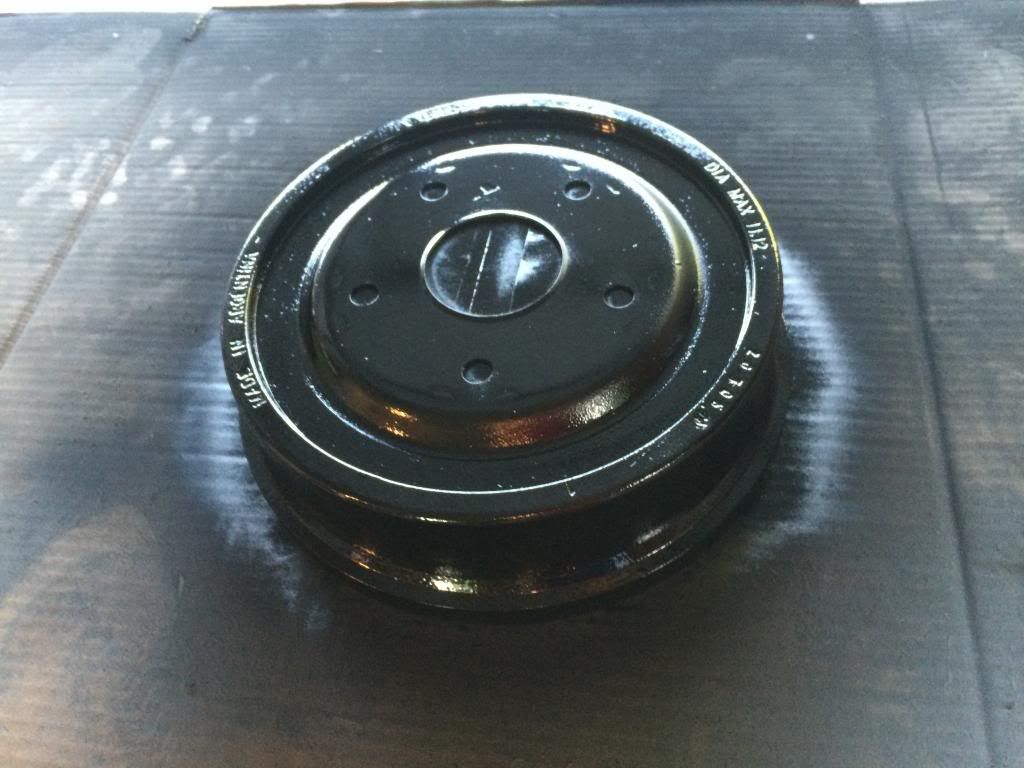

Good job. It's curious for me that being Ford an american company the brake drum are made in Argentina, the country where I was born and where Ford is one of the more important cars companies Laughing

Thanks! Yes, many "American" cars aren't as American as many people would like to believe. I always have a little chuckle when I see a "Out of a Job Yet? Keep Buying Foreign" bumper sticker on a vehicle where most of the components, and even the assembly, is performed in other countries. I'm no expert, but I am an engineer at a tier 1 automotive supplier - so I get to see some of the inner workings of these American car manufacturers. Though in this case, I'm not sure if the OE drum was from Argentina since I bought these new a few years ago. Could be, but I can't say.

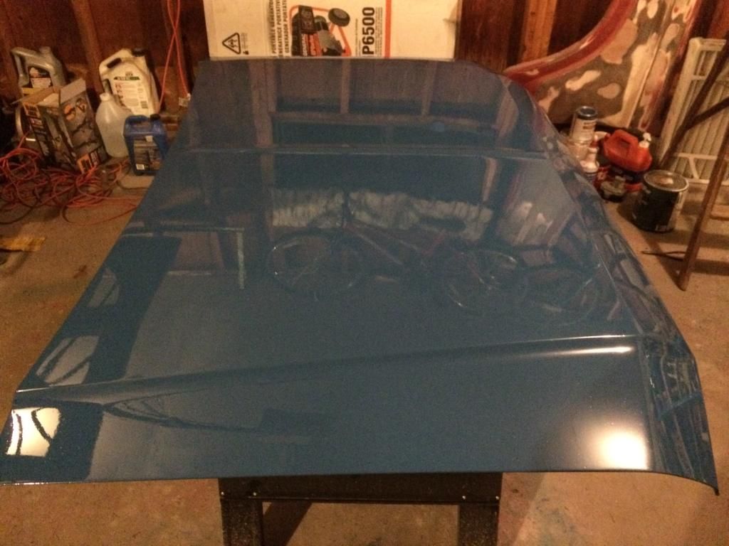

Here is a pic of coat #6. It looks about the same as all of the others haha... but this was the first time I could get my camera to focus on the light bulb. I'm not sure if it is because the finish was better, so the camera could recognize something to focus on... or it may just have been the correct overall lighting at the time. Either way, I was happy that I could get it to show up so I took a pic.
I don't know if I'll sand tonight. I might give it another day to harden before sanding. In the meantime, I am thinking about pulling either the doors or the fenders off the wall and starting some body work and prep for paint. We'll see if any other projects pop up before then. Later!

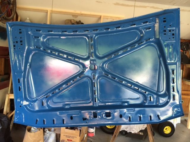

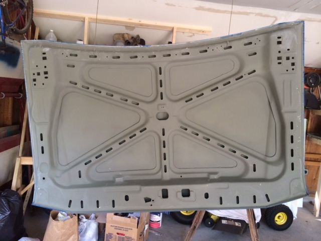

I didn't really plan on doing anything yesterday... until the UPS man delivered my Rustoleum Royal Blue spray paint!
So I went and sprayed a coat on the underside of the hood. It was good timing, because my family and I are going up north for a few days and it will give the spray paint some time to harden. I had a small issue with the primer rubbing off the bottom side where it contacted my makeshift table. Hoping this won't happen much with the color. Here is the before and after:
I know it's not that exciting... just a spray bomb coat. But for the sake of progress pics I thought I'd share. I probably won't have any updates before this weekend. Maybe Saturday evening I can sand coat #6 with 1000 grit and prep for coats 7 and 8!  bounce

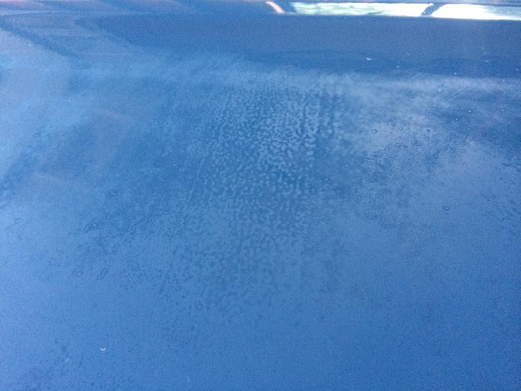

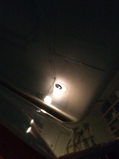

I put coat #7 on the hood on Saturday. I tried to sand out the fisheyes prior to this coat, but after rolling on the coat I could still see a couple of them quite well. So last night, instead of sanding off 2 or 3 coats in order to flatten them out, I dabbed on some paint specifically on the fisheyes. I'm not sure if it will work, but I'm willing to try. If it works, I would say it is easier than sanding off coats which will have to be repainted. And I figure that sanding down a small high spot is easier than sanding out a low spot. I'll sand these out maybe tonight or tomorrow. I thought about giving it an extra day to dry since the drops are a bit thicker than a normal rolled coat. After I sand out these drops, I'll roll on coat #8, followed by a full hood sanding with 1500 grit wet before coats #9 and 10.
Here are a few pictures on my (hopeful) fisheye elimination attempt:
You might be able to see in the photo, but I let the first drop dry for a bit, then added another drop. As the first drop dried, it layed out and a slight dimple could be seen. This new dimple may well have been above the last layer of paint, which could have been sanded smooth. But for safety sake, I added another drop just to make it higher/thicker. I'll be sure to let you know if my technique worked...

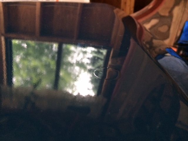

My fish-eye elimination technique worked really well in 2 of 3 spots, but not so well on the 3rd. When sanding, I decided to stop because I could start to see primer. After rolling on coat #8, the repair spot could still be seen for that 3rd location. The other 2 fisheyes can no longer be spotted. dance  Then I wet sanded the hood with 1500 grit. Inspecting that 3rd fish-eye after sanding looked pretty flat. However, I can still see that it is not quite flat after rolling coat #9 this morning. I'm guessing I'll need at least 3 more coats, maybe 5. And I'm crossing my fingers that with each new sanding job that spot will disappear. If it is still noticeable, I'll sand off more hard work and try again. This particular spot is near the front of the hood, in a spot that is easy to see. Thus, I don't want it!
Does anyone have a recommendation for using a hardener? I thought about using it for the final 2 coats when I'm ready.
What about rolling clear coat? Has anyone tried it successfully? Better end product? Tips or tricks? I'm confused whether the final color coat before clear would still be wet sanded? I can't imagine the final result would have a rich color if you do. Or do you cut and polish the final color coat, like normal, and then clear?

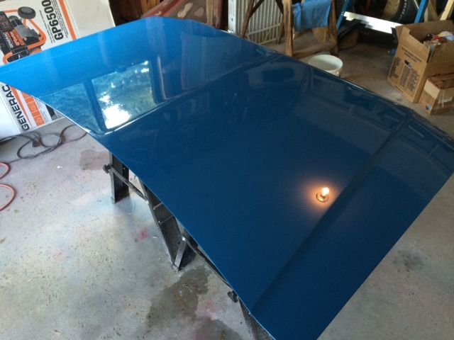

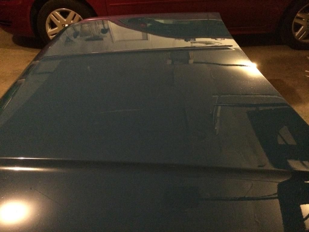

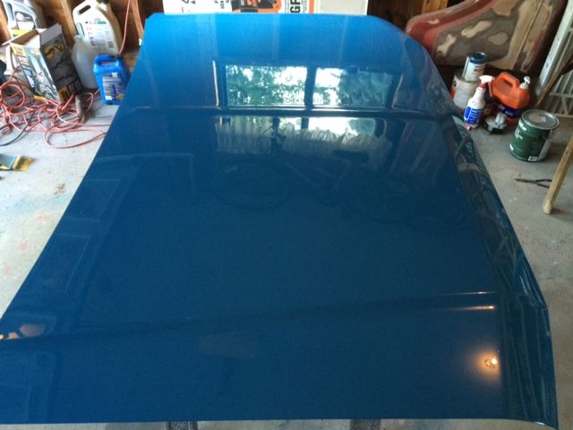

I rolled on coat #10 tonight. It is surprising how much dust settles on the hood only a few minutes after rolling, and bugs! Still using 1:1 Rustoleum Royal Blue and Penetrol. I've been very happy with the results. I asked O'Reilly's tonight about Marson Smoothie. They said they could order it, and gave me a price. I think I might look online first to see if I can find it cheaper somewhere else. I'd like to use it for the last few coats to avoid any fish-eyes. I also would like to pick up some hardener for the last few coats. I'll let you know what I come up with.
I snapped 4 photos of the 10th coat, just because. I don't know honestly if it looks any different than the coats from a month ago. But I like pictures, and I'm hoping you do too! They are kinda grainy because I need better lighting in my garage.
BTW, it looks like the fish-eyes are nearly gone from my repair!
Man how I wish they were pictures of the whole truck in Royal Blue, and not just the hood.....   Here you go! Please leave more comments and suggestions!!!

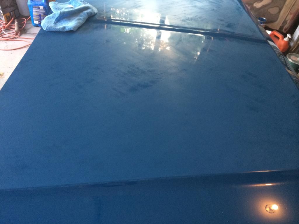

I was hoping for those with experience to give me their opinion. I'm done with 10 coats of color, and now sanding with 2000 grit wet. I'm not sure how far down I need to sand every time now. The hood is fairly smooth, even without sanding - meaning the orange peel is extremely minimal. I for sure want to sand out any roller marks... and dust bumps/bugs... but at this point is it just preference? Or... after the final sanding job, followed by cut and polish, would you be able to see a difference between the areas that were sanded to a dull finish and those that didn't lose much of their original 'rolled-on' gloss? If I have to sand everything dull to have a uniform end result, so be it... but I'm not sure if this is required?
For instance... in this picture I almost said good 'nuff:
Except, of course, for this spot where you can still see some roller marks.
In your experience, do the little glossy rings show up in the end product if the final sanding job doesn't eliminate them 100%?? Can you see the transition in the end product?
I did end up saying ' not good enough ' last night and giving the hood another round of sanding with 2000 grit wet. This is where I eventually said good enough:
It's not perfect but it's not the final sanding job, anyway.
Here is what that one stubborn fish-eye looks like now. It's still hanging around, but only just. I think after the next 2 coats I won't be able to find it any more.
I'm hoping that tonight I can roll on coat #11. I'm still not sure if I'll stop at 12 coats, or do 14 just for good measure. If I had not sanded almost through to primer trying to get rid of those fish-eyes, I probably would have stopped at 12. I've had full coverage since about coat 4-5. After coats 11-12, I'll break out the 2500 grit.

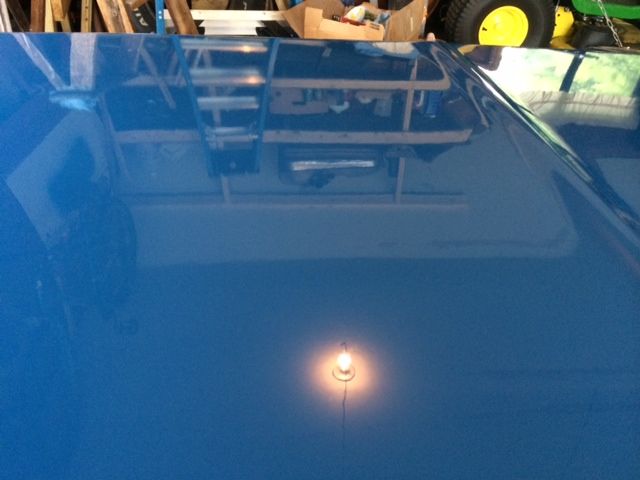

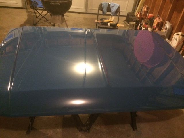

I rolled on coat #12 last week Thursday. It's a bit dark in the picture - the paint looks darker than normal. But I'm happy with the reflections  cheers
I have a business trip all this week, and won't return until Friday afternoon. I'm hoping to sand down the hood with either 2000 again, or 2500 grit this weekend. Then roll the 13th and FINAL 14th coat. Jeez I hope there are no fish-eyes in either coat!!!! By then I hope to have my answer about how long to wait to do the final wet-sanding.

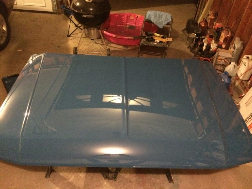

Post by 81F100 on August 29th 2014, 10:23 am

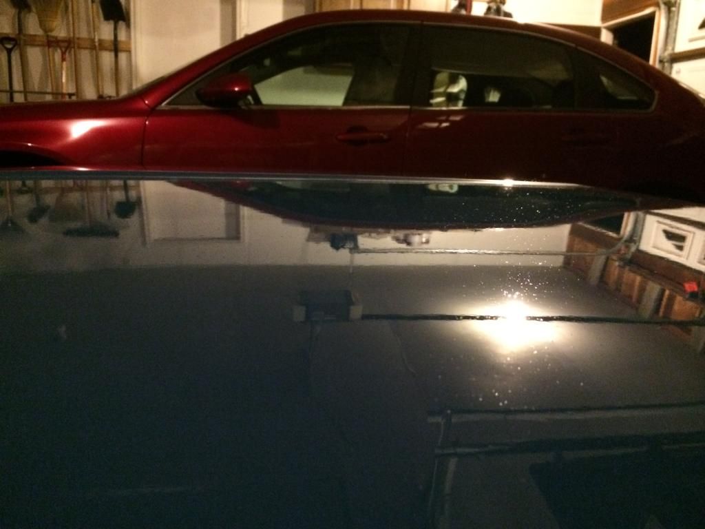

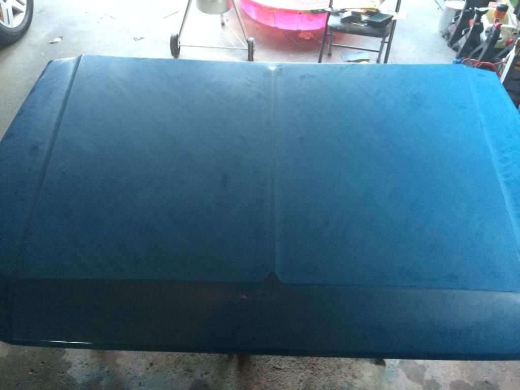

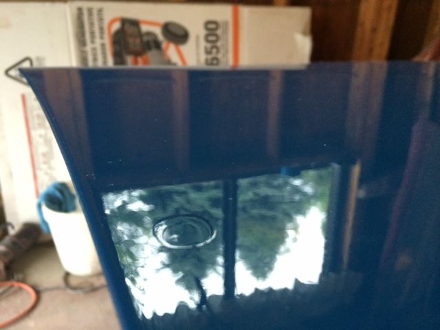

Sorry, it's been a while since I posted. I have been a bit lazy when it comes to the hood.
Last weekend I sanded the entire hood (12th coat) with 2000 grit wet. Then I went over that again with 2500 grit wet, but lightly. Then I rolled coat #13, waited 2 days, and rolled #14. I don't see any fish-eyes or other blemishes on the 14th coat, so I think I am done!!!  cheers
So now I plan on waiting about 5 weeks before touching it again. I might put it out in the sun during the day, while I am at work. When the 5 weeks are up, I'll wet sand again with 2500 grit. Then I'll have to go out and buy the HF polisher and necessary accessories, including Meguire's.
I still used the 1:1 Rustoleum to Penetrol mix. I added about 2 cap-fulls of the valspar hardener to the final coat. For the other pieces of the truck, I might try mixing in some MS... like 3:2:1 Rustoleum:Penetrol:MS. The 1:1 mix is still pretty thick, but I don't mind it too much.
It's actually decent timing, because I won't even be able to touch the hood for about 5 weeks anyway. My wife has her delivery scheduled for next Wednesday, the 3rd! I'm taking 2.5 weeks off of work to stay home with her. Sounds like I am a good husband, eh? WRONG - because then I am immediately leaving for 2.5 weeks on a business trip to Germany again.
Luckily, we have family nearby to help her out as much as she needs.
So here's a picture of coat #13. I didn't take a pic of coat 14 because honestly the 1st coat after sanding always looks the best. But coat 14 still looks great... just the same as the million other pics I've put on here hahaha.

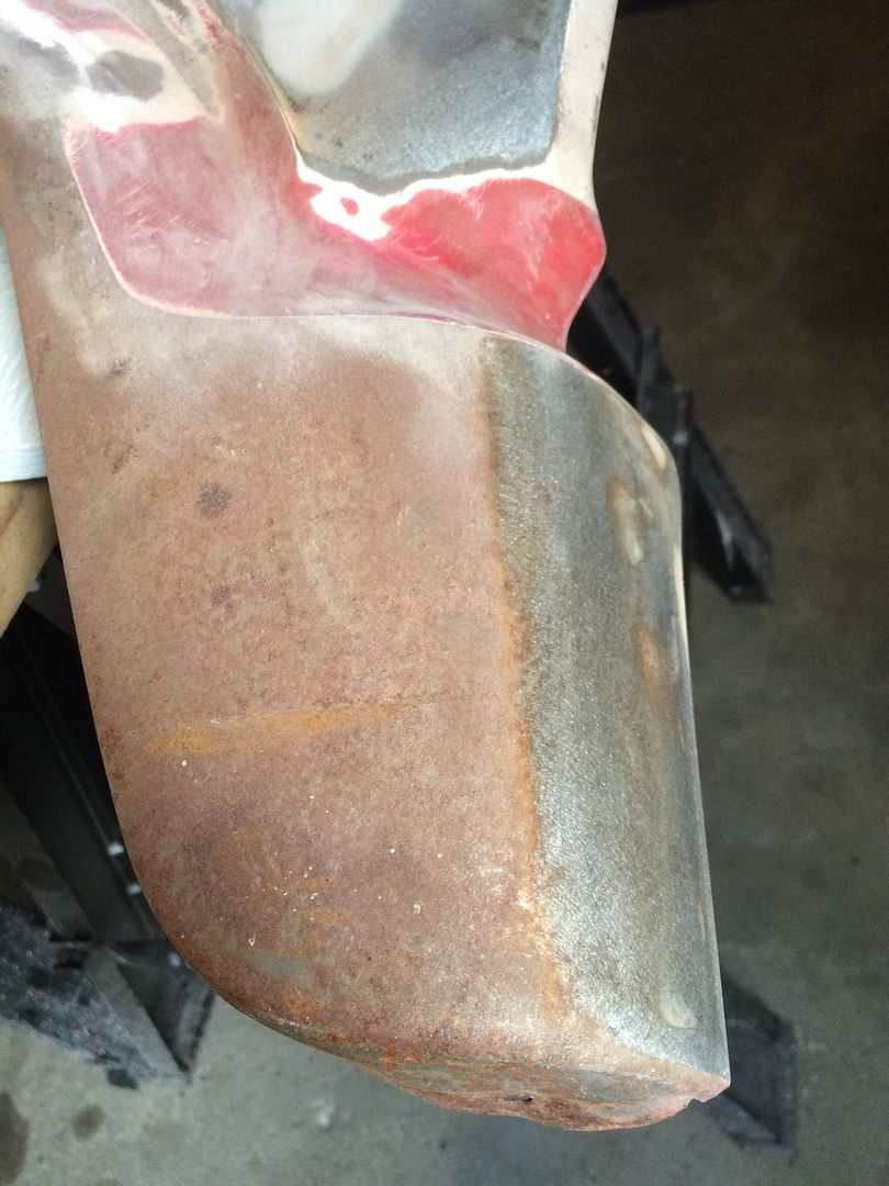

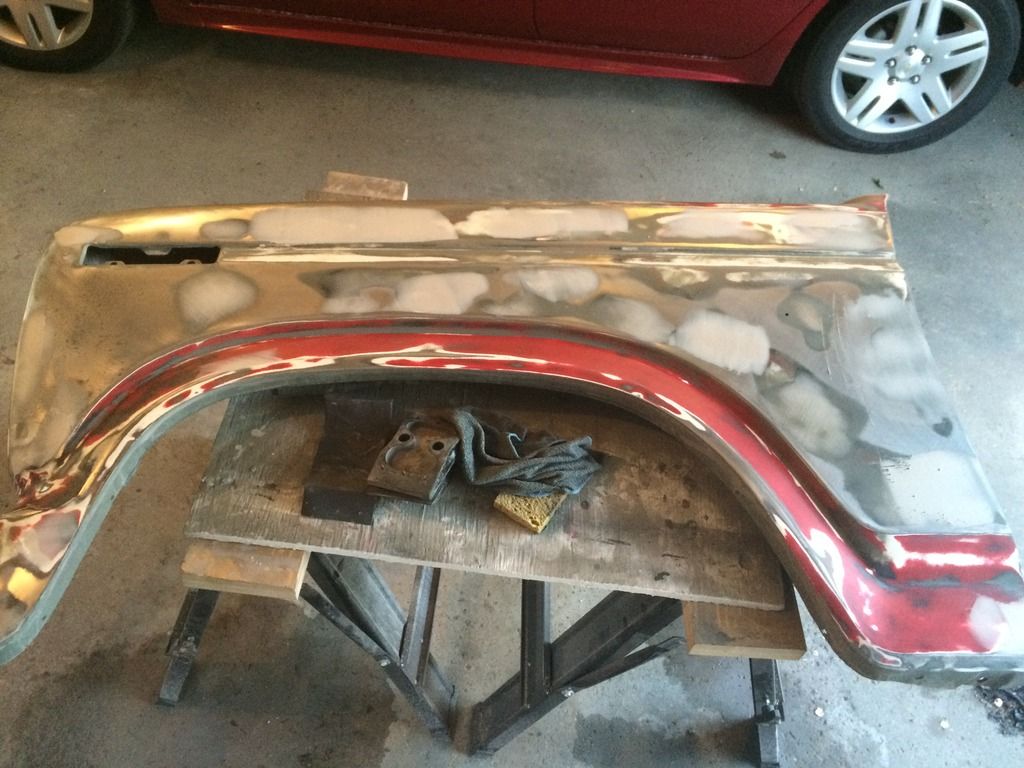

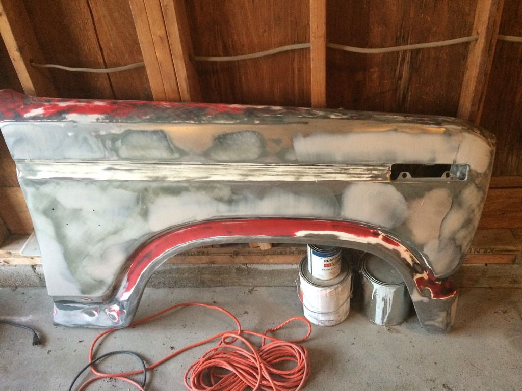

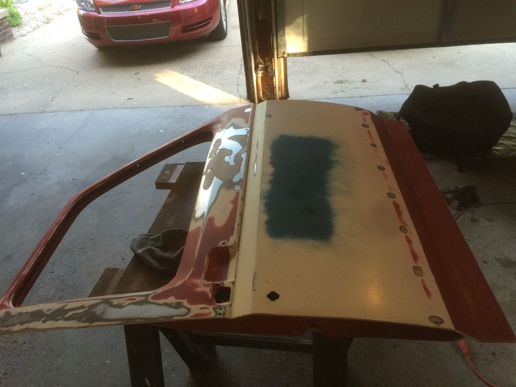

Hello everyone! It's been a while, but winter is finally loosening its grip on Michigan. So... time to go back to the garage.
I never finished the hood (final wet sand, buff and polish). I decided to wait until I have more pieces done and then do them all together. I figure the longer I leave the hood, the more time the paint has to cure. Can't be bad, can it?

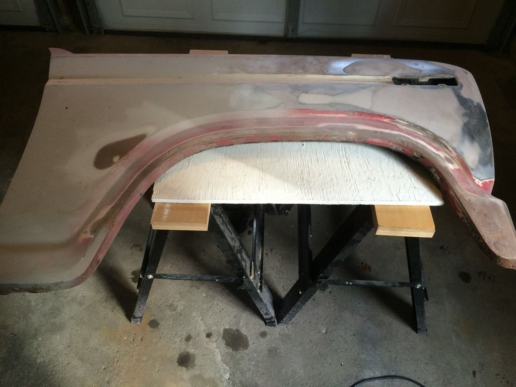

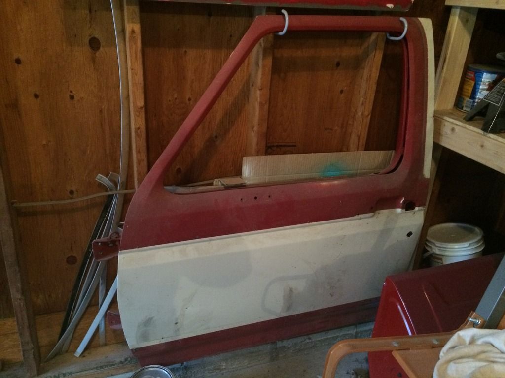

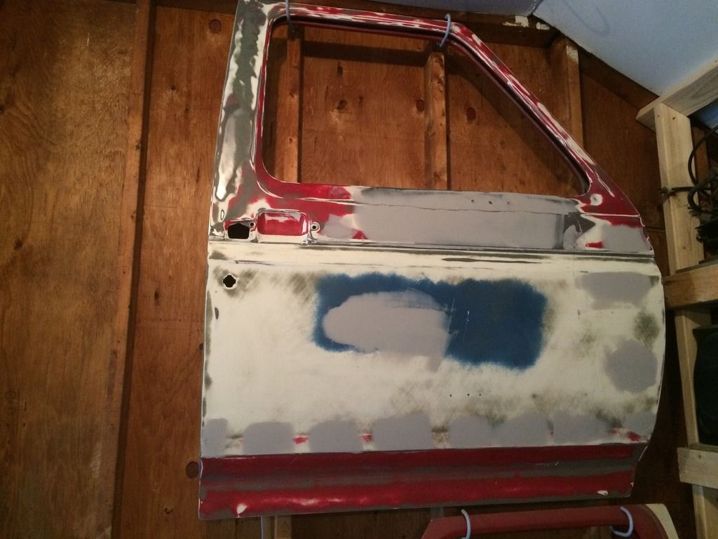

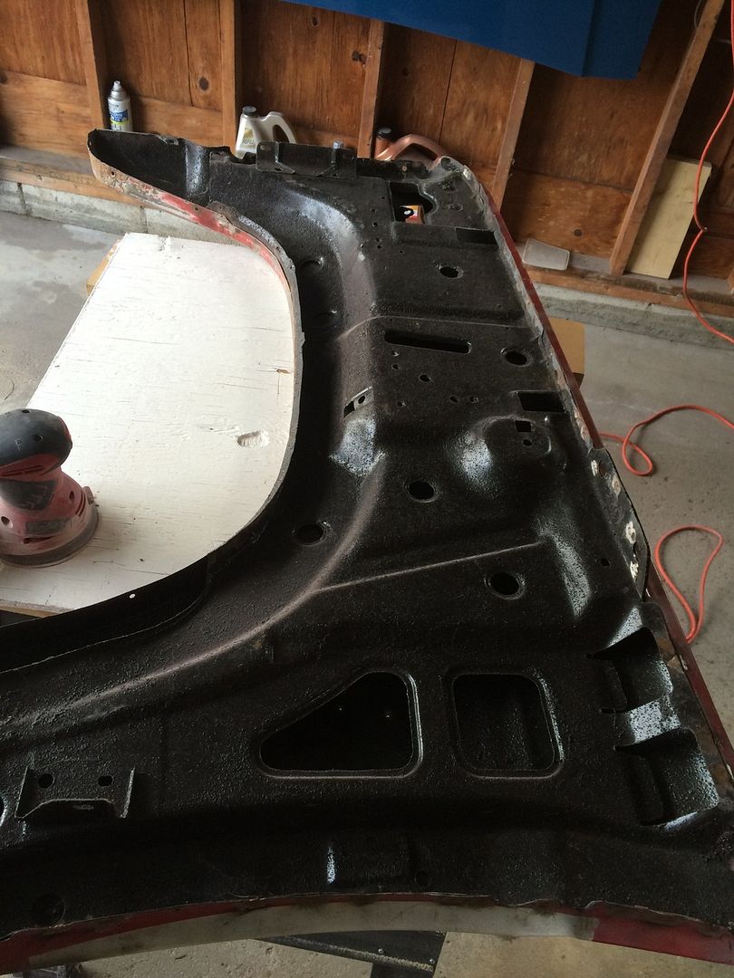

So I got out one of the front panels that hasn't been touched since 2008. It has some prelim bondo work and exposed metal, so the surface rust has to go.

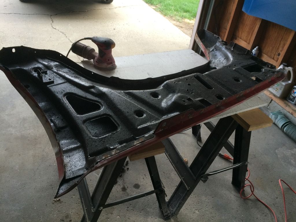

These are the panels that I had drilled apart and bedliner'd the insides. This still looks pretty good!

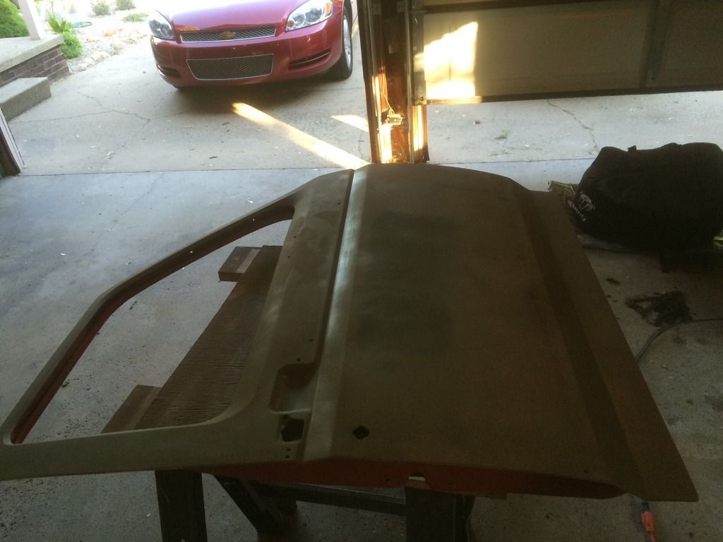

So tonight I spent only about an hour sanding down the old bondo and rust with a random orbital and 150 grit paper. The panel(s) need some body work to smooth them out, but nothing too major. Not sure how easily it will be to paint around the body lines. They seem like they will be harder to work with than those from the hood.
Also, I'm finally doing some real engine work on the truck. I rebuilt YFA 1bbl carb last weekend which helped a lot. The accel pump had a crack from dry-rot (sitting for 8 years without gas) and the float wasn't adjusted well (explains the gas smell and flooding). Adjusted valve lash and re-did valve cover gasket. Next I'm thinking about taking off the head for some work. I'd like to do a leak-down test first to see what I'm dealing with, but I know there is some blow-by. Could be valves or rings, but I'm not sure which.
I'm hoping to do both front panels and both doors all at the same time instead of one at a time. It'll be like watching paint dry for you guys, but I think it'll be most efficient for me.

Happy Memorial Day! I haven't done much over the past couple weeks. Things have been pretty busy. I've done a round of bondo sanding, guide coat, wet sanding  (180 grit), bondo, dry sanding (80 - 180 grit). The guide coats help a lot to show me the low spots. Some of them I'm trying to fill in with bondo, and others I'll just leave until the high-build primer coat. For the guide coat, I just sprayed anything in a can that I had lying around.
door before guide coat:
Where the side mirror bolts on is pretty banged up. Looks like someone got to close to something with the mirror, hit the mirror, and bent the door skin in the process. I had a ton of bondo on this area from 8 years ago, but I took almost all of it back off the other day to see exactly what I was dealing with.
door with guide coat:
Just a light spray coat, can held 10+ inches away from the surface.
Here is the other door, which I haven't touched yet. This one is in a lot better shape - there are only a couple small dents. I'll be working on this one next:
Here is the first door again after wet sanding off the guide coat and applying some filler to the problem areas. I ground off the little tabs for the side moulding (I won't be adding any moulding when it is finished). Of course, each of these spots needed filler to make flat.
And here are the two front fenders. Both had the guide coat wet sanded off and then bondo applied. I'm a bit worried that I didn't add enough hardener to the mix. It's been 36 hours and it is still pliable.... doh I have them sitting in the sun today. If they aren't hard by this evening, I'll be scraping off all that bondo and reapplying. Not my idea of progress, but what can I do. I was conservative with the hardener because I had a lot to fill and wanted enough time to do it before it started to set. In the end, I think this will cost me more time than it will save - opposed to making multiple batches of filler when the last batch gets to hard to apply. I've learned my lesson.
Also, anyone have good experience with rolling high-build primer? The last time I tried it (first page of thread) I had terrible results. I'm not sure if it was because the can I bought was old and separated, or if I did something else wrong. If you've had good experience, please advise brand, mixing ratio (if any, and what you mixed it with), and application method. I really want to use a high-build primer so that I have something to sand down to make everything really flat. Thank you in advance!
