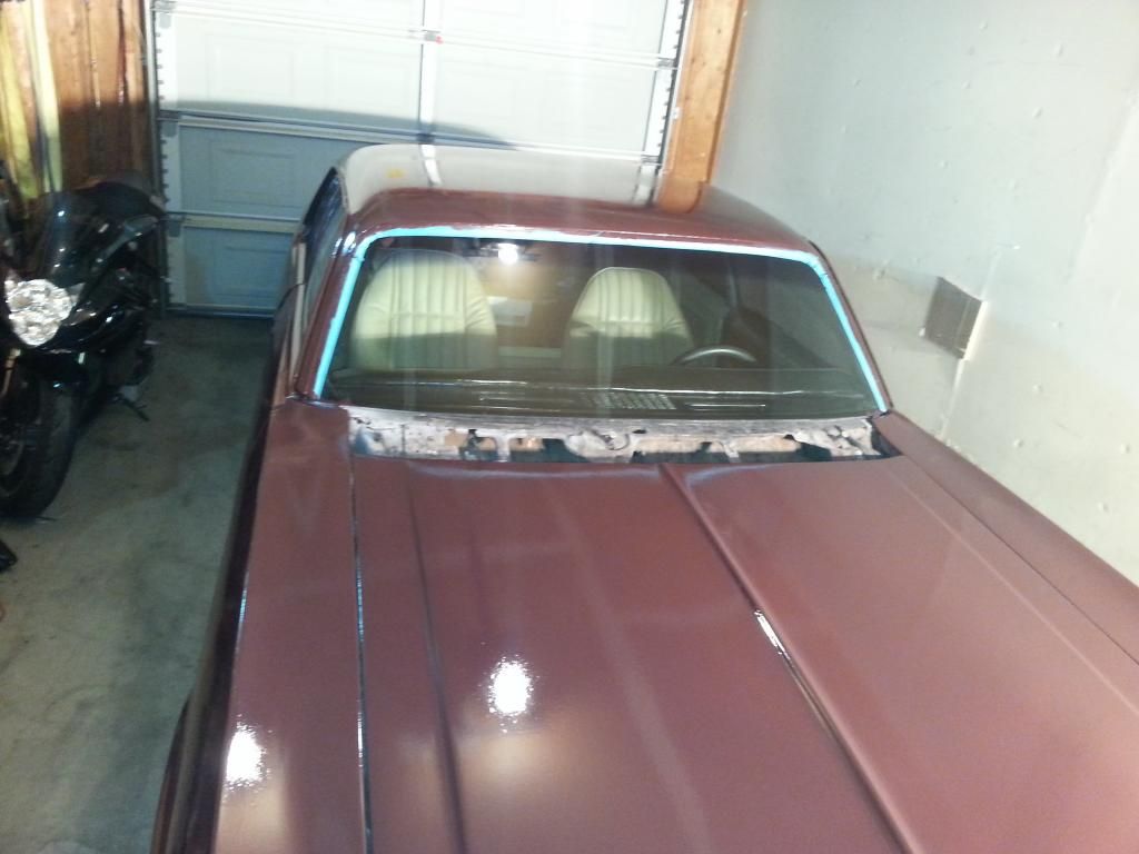

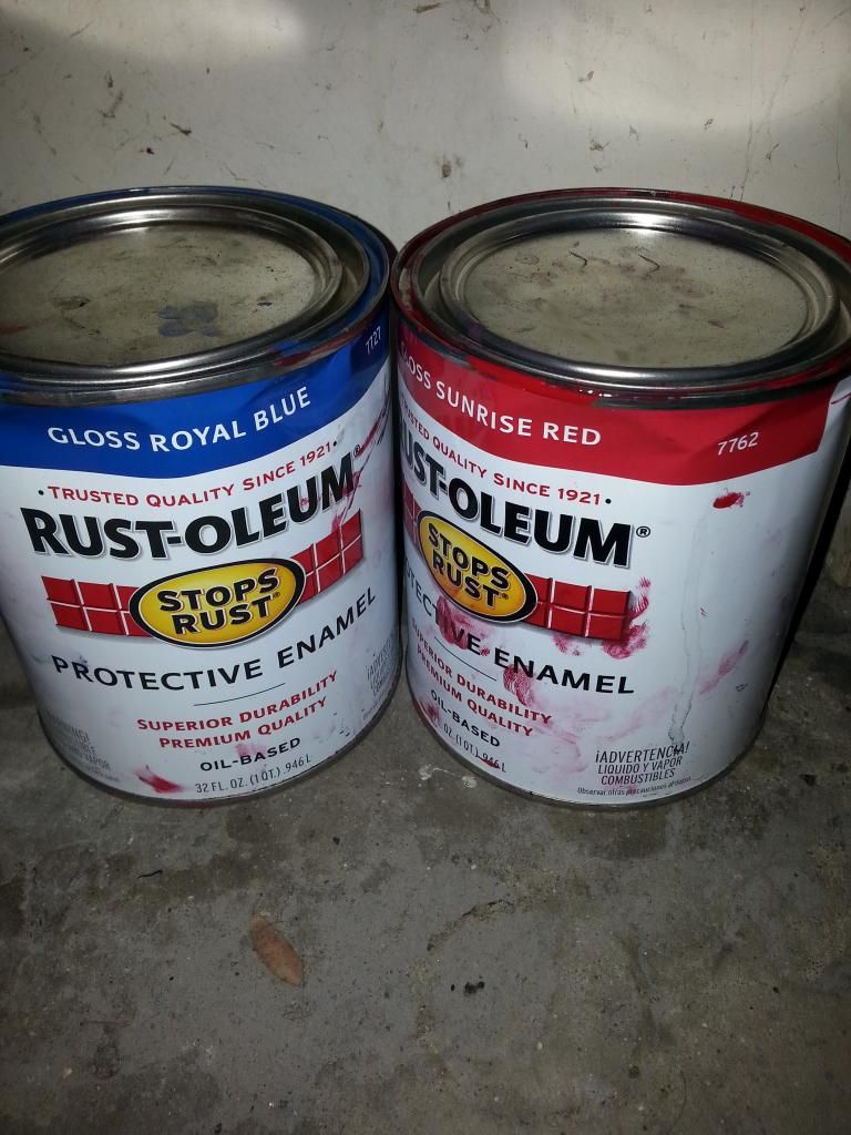

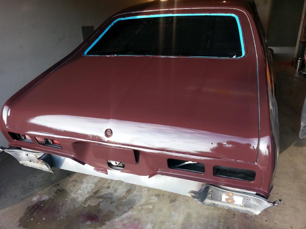

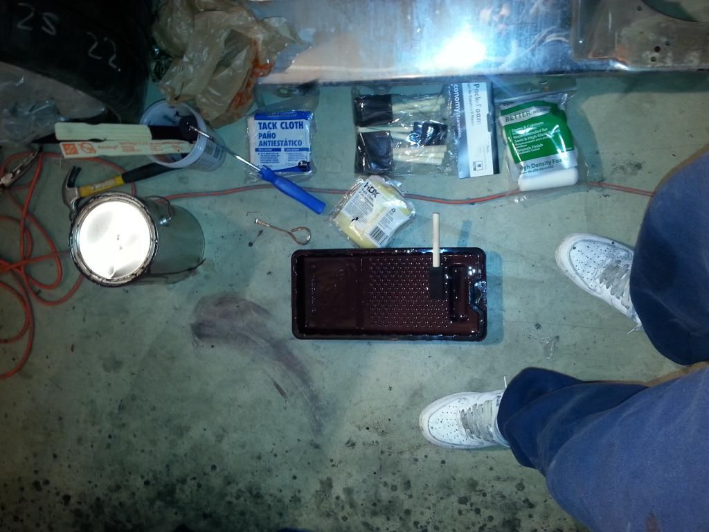

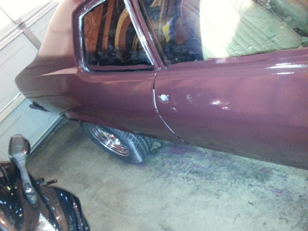

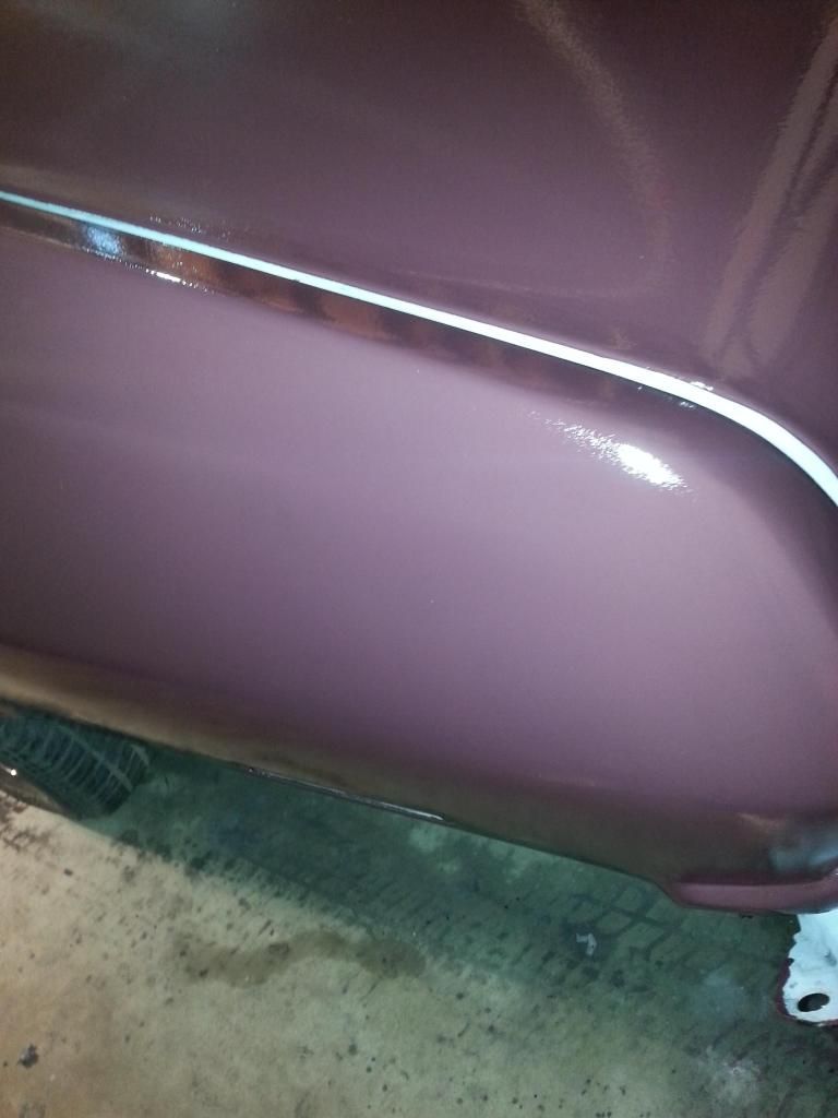

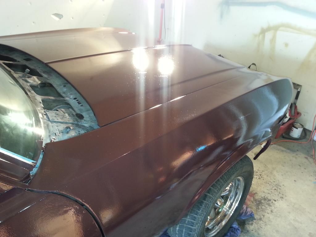

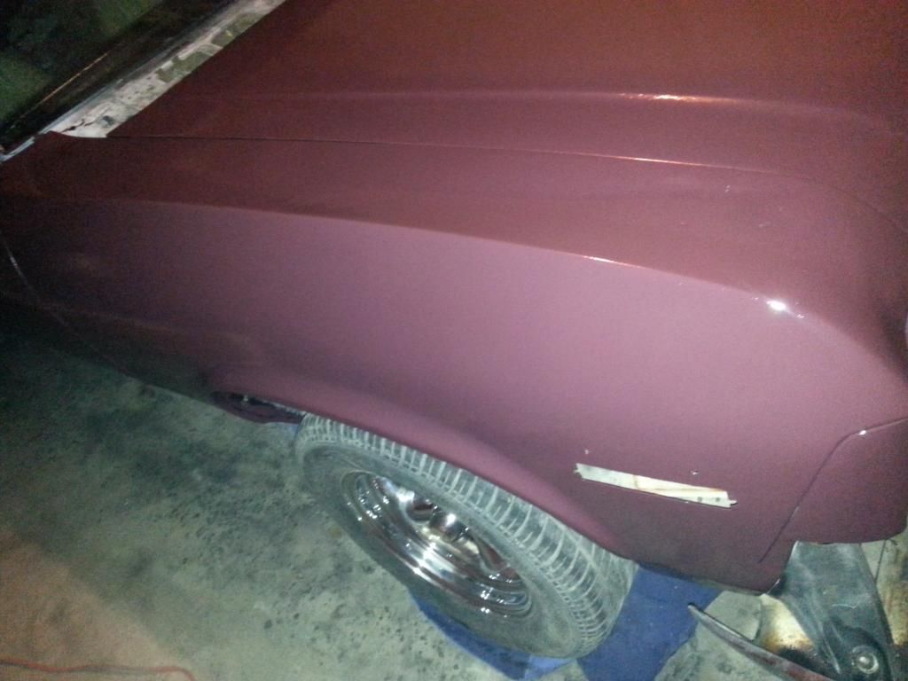

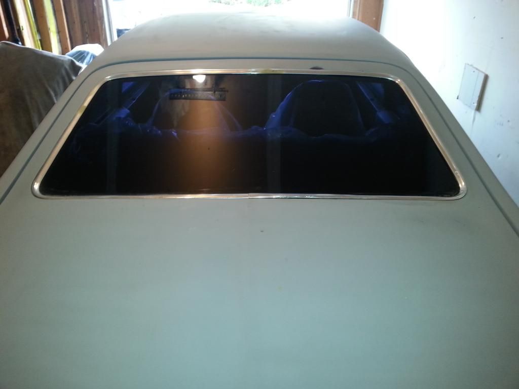

After weeks of studying and watching videos and etc. I decided I want to take the venture of painting my own project using the rolled on technique. I bought the car back in November and it wasn't running or anything. I got it started after about 2 weeks of working on it. The car didn't have any rust I checked thoroughly once i got it to my garage... It has rebuilt 350 Small Block and a TH350. I just laid my 2 coats of paint down about an hour ago. I was wondering if I'm doing it right. I mixed 3 different Rustoleum colors together to the color I was looking for.
I don't know what "MS" means. I added a little paint thinner to the paint while I was mixing the colors. Am I doing it right or not?

The number one rule in rolling is to take your time. You can not rush the process. I added a enamel hardener in with the paint and that cured it quicker than just straight paint/thinner.
Check out my 63 Falcon in the project file.
MS stands for mineral spirits.
Hope this helps. Ask questions or PM me if you need help.
Bob

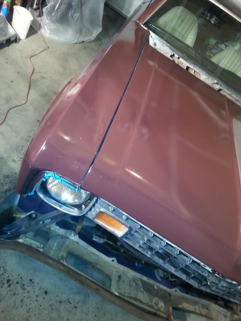

63Falconconvert thanks for the information. I have both mineral spirits and paint thinner. I don't think I really need the mineral spirits. the paint is rolling on pretty good to me. I laid my 3rd coat few minutes ago and Im impressed with the results. I dont think i will be doing the 8 to 10 coats tho.

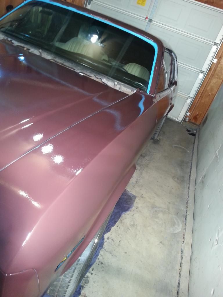

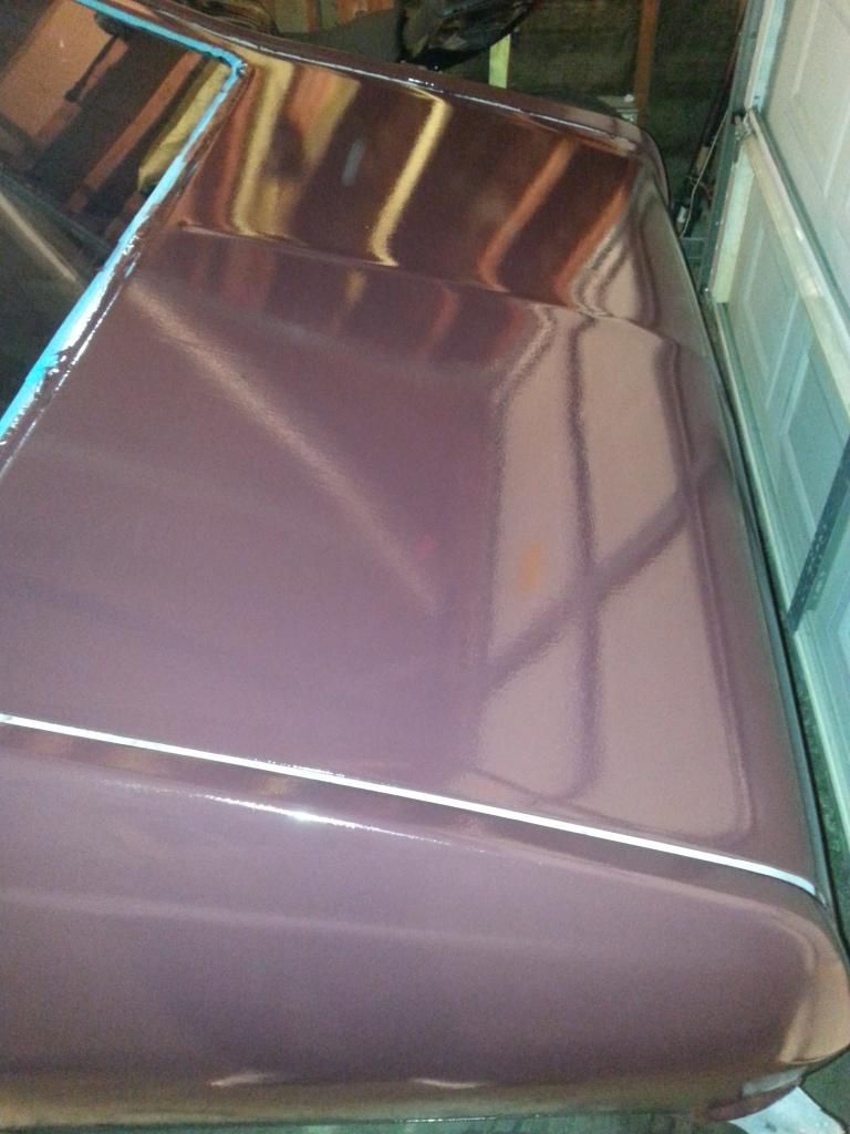

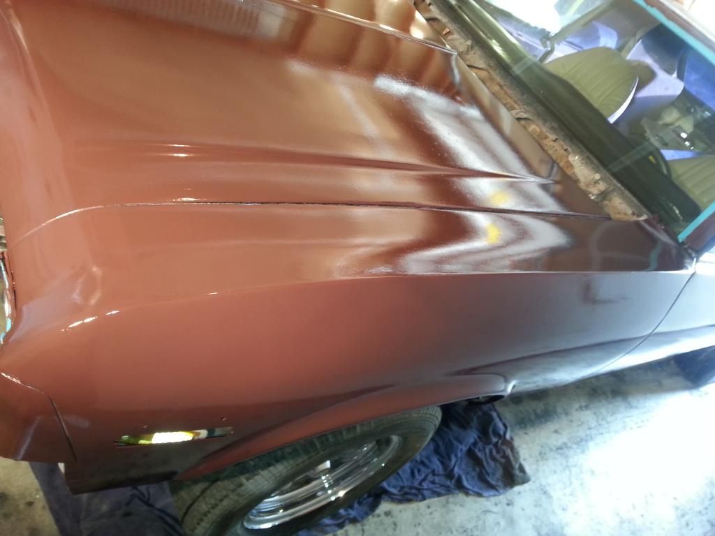

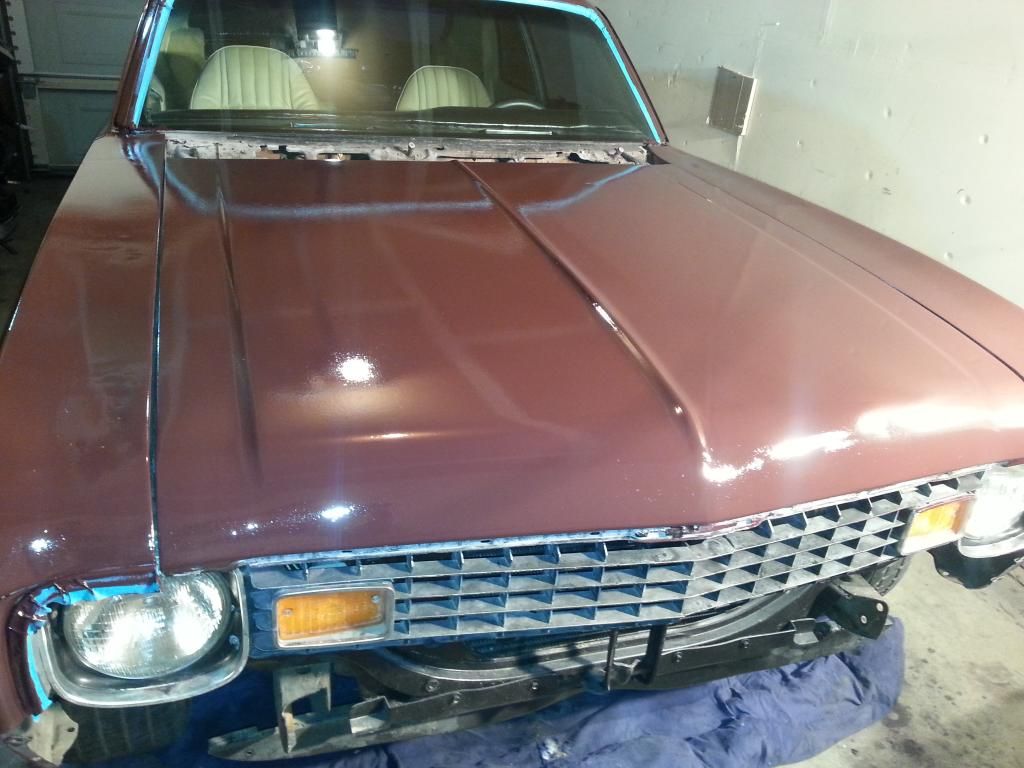

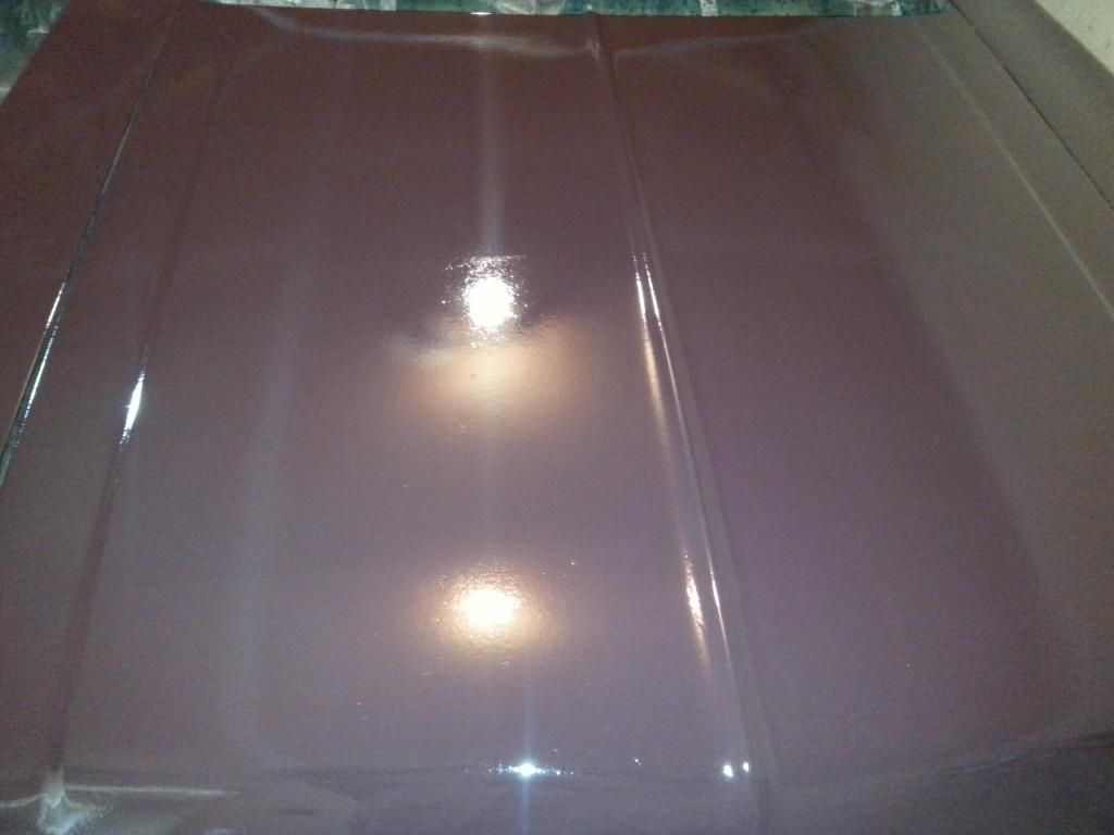

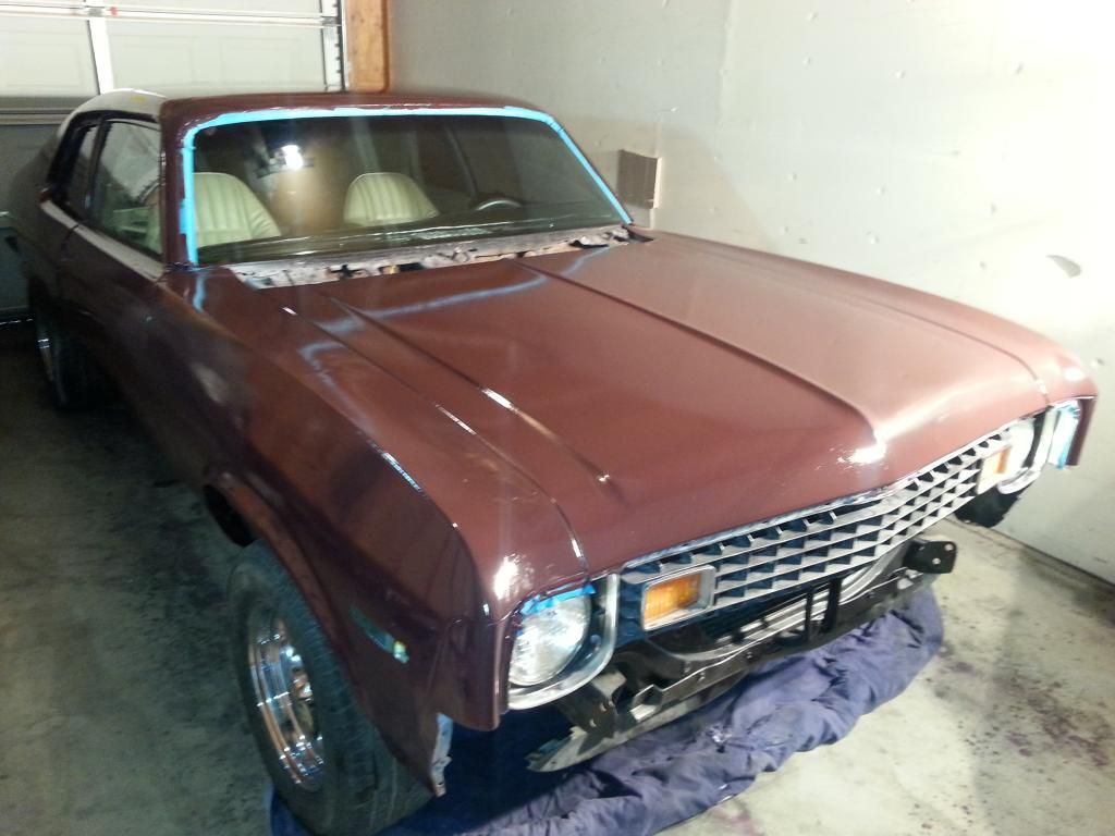

just finished with 4TH COAT. I'm really liking how this project is turning out....the more coats I put on the more shiny it's becoming. I have a vision in my head that this is going to turn out extremely well. Ive posted picture on Facebook of the paint on the car and everybody liking the color....I'm waiting for someone to ask me who's painting it??? Please give me your opinion and etc.

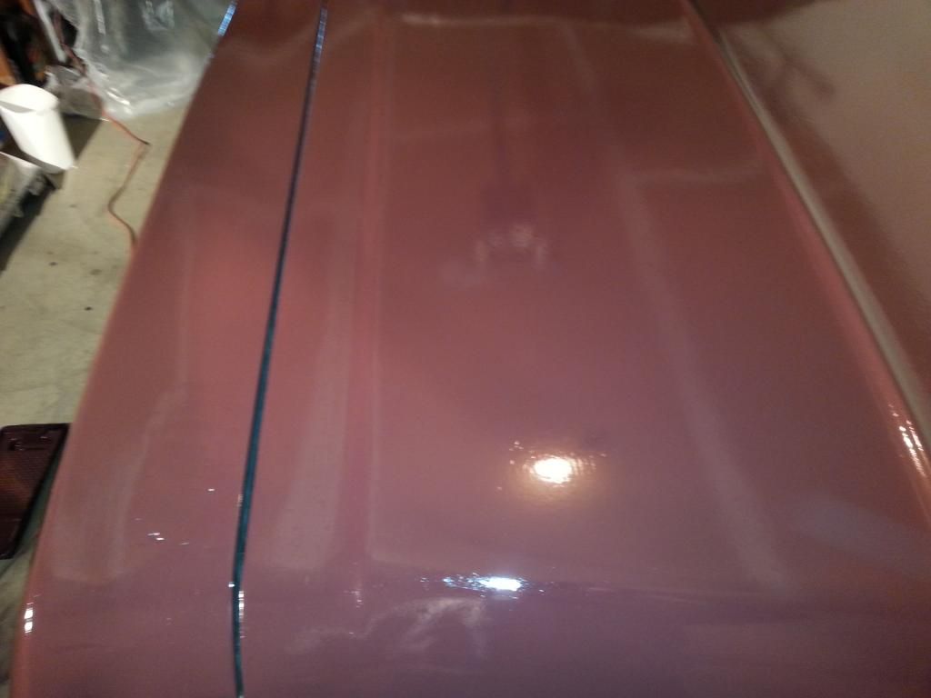

I'm pretty sure that 'MS' means Mineral Spirits. That's pretty good coverage for only two coats. looks like your laying it down pretty thick. What type of thinner did you use?
The thicker the paint the more Orange Peel you'll have. Just takes more sanding between coats. There are different schools of thought on how thick each layer should be. The thinner the paint, the more it 'self-levels'. But it does require more layers.

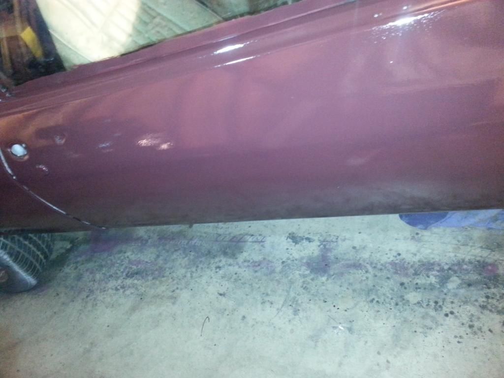

race-n-jason: I'm done with painting now. I only applies 8 coats I used Klean paint thinner. To be honest sanding in between every 2 coats wasn't that much orange peel. I'm in the process of buffing now. i was really hoping to get a lot of feed back on my work but its weird 151 views and no replies

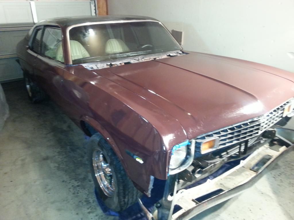

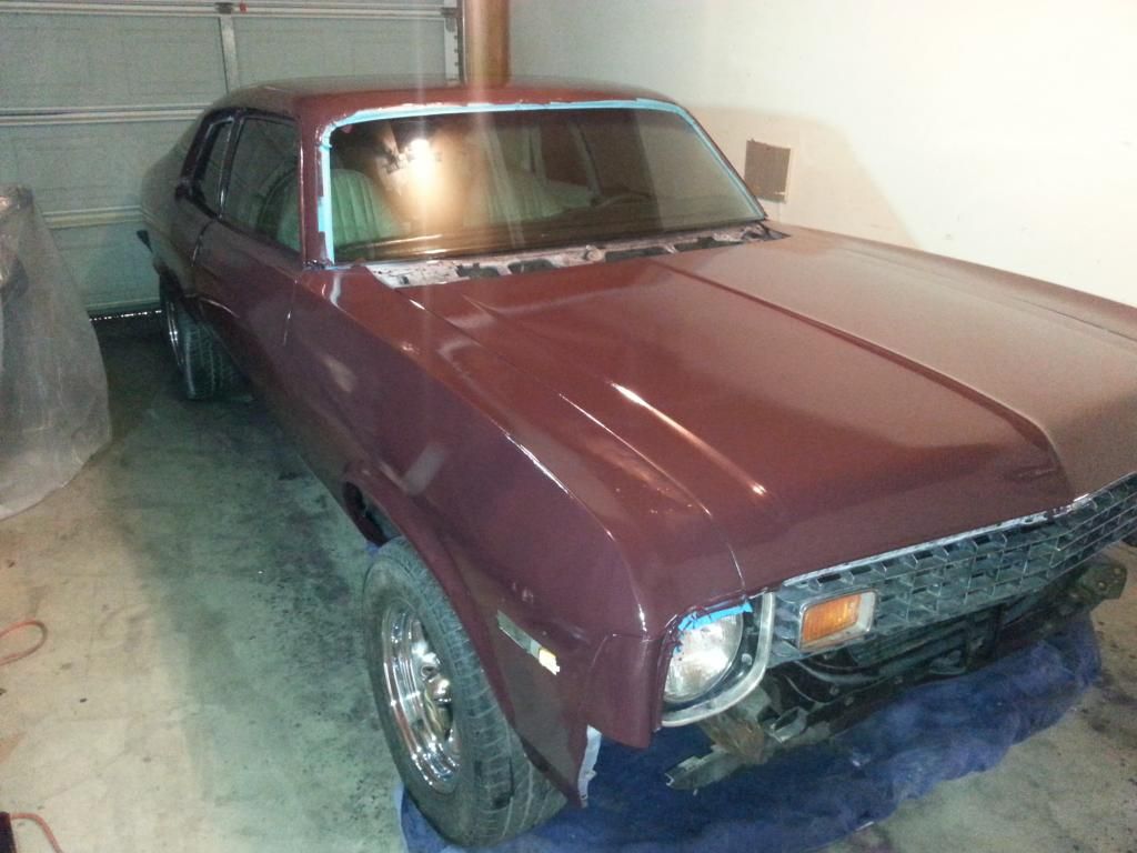

i didnt use a paint thinner till the last few coats... I would wake up in the morning do a coat and before i went to bed apply another coat. Let it dry over night and the following day about 4 i would wet sand and day after that apply more coats.
Right now im in the process of wet sanding so I can buff but i only do a section at a time because of my work schedule.

I also mix a little black in as well because I was trying to get purple and when I just mixed the red and blue it was too purplish so i added a little black to make it darker to the color I wanted
