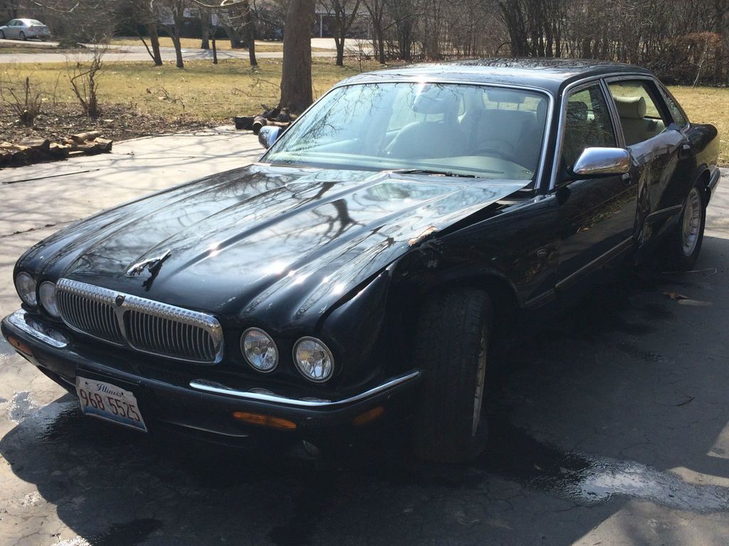

Post by Samilcar on October 25th 2015, 2:55 pm

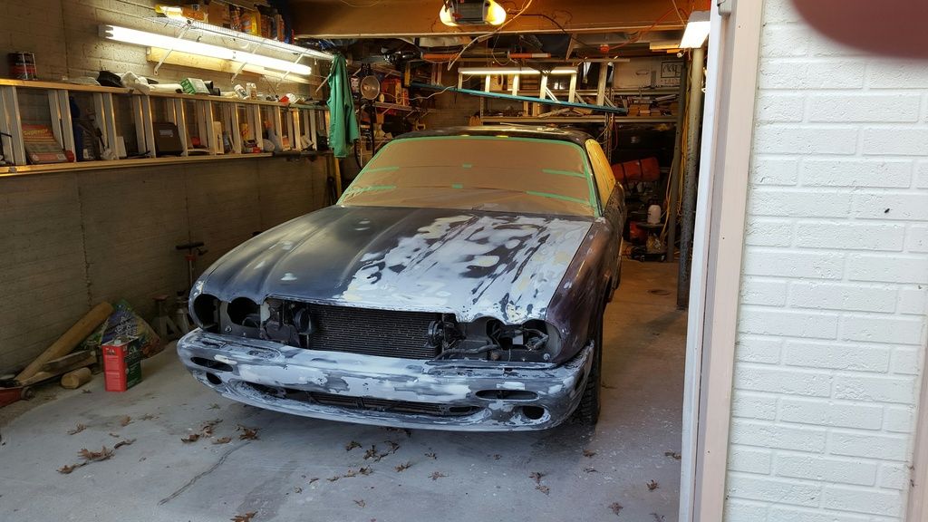

New project car I've been working on. Previous owner wrecked it in an ice storm, and it had been sitting outside for about a year and a half before I bought it off Ebay.
Number of posts : 74

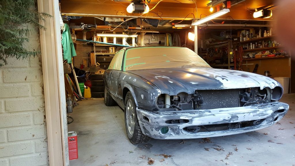

Re: 1998 Jaguar XJ8 Vanden Plas

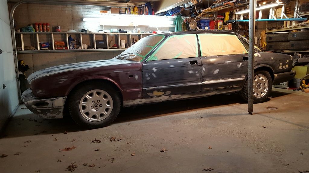

Post by Samilcar on October 25th 2015, 3:11 pm
Damaged door replaced with used part ($190 for door shell, $70 for window glass, $18 replacement window track, $56 door moulding, $34 sill moulding, $34 chrome window trim), damaged fender replaced with used part ($93). Original paint scuffed, dings and dents filled with body filler.

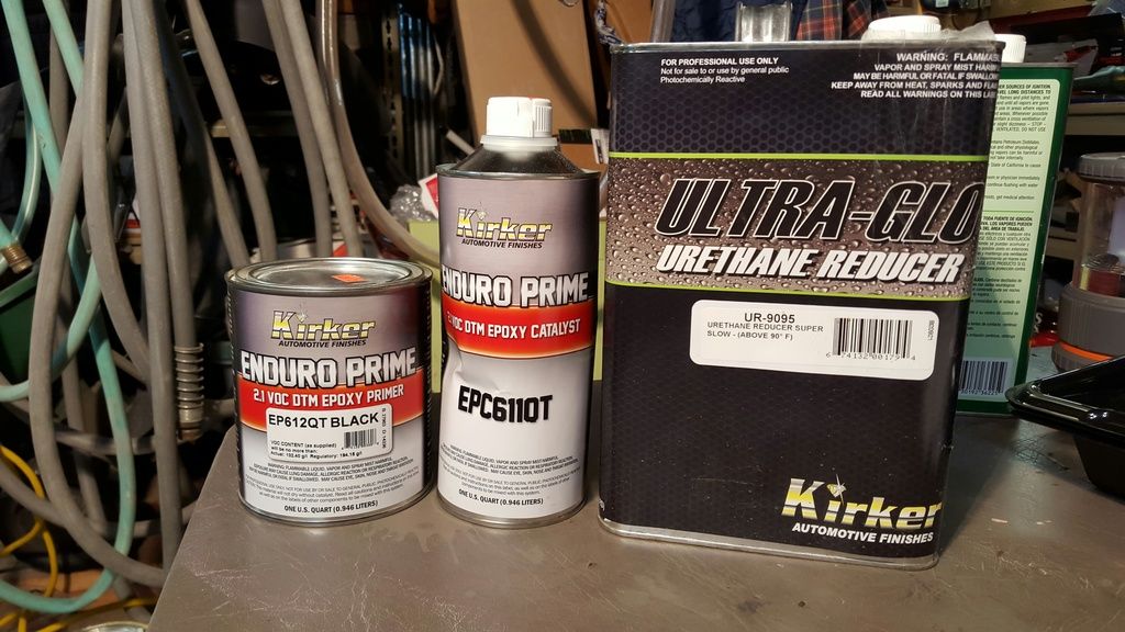

Post by Samilcar on October 25th 2015, 3:27 pm
Black epoxy primer ($43 combined for 1 qt primer and catalyst) and reducer ($35) I'm currently rolling on:
And single stage two-part urethane paint ($77 combined for paint and activator) that will be rolled (crosses fingers):

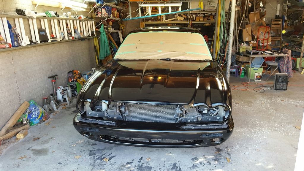

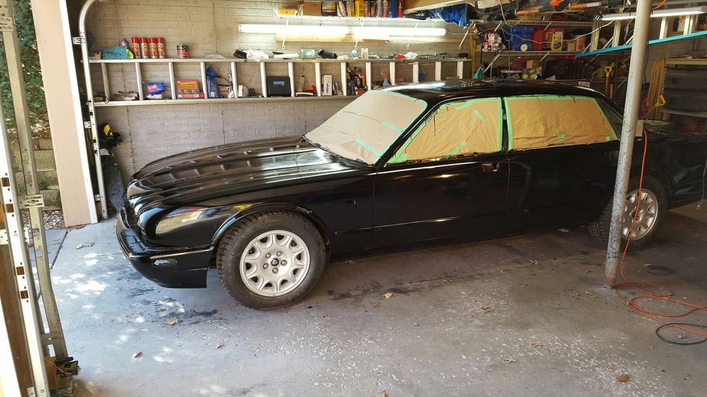

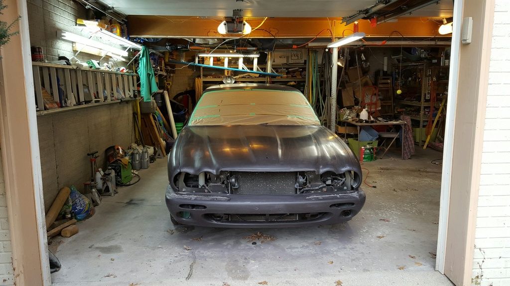

Post by Samilcar on October 27th 2015, 2:56 pm
Two coats of epoxy primer rolled. The first coat was a thin sealer coat (12 oz paint, 12 oz catalyst, 5 oz reducer), the second coat was full thickness (12 oz paint, 12 oz catalyst). Whatever solvents are in this primer did not react well with the foam roller, I could only use a roller for 5 minutes before it started to disintegrate. 3-4 rollers were needed for each coat. Both coats were wet sanded with 600 grit paper.
Post by Noah Zarq on October 28th 2015, 7:31 pm
That looks really good! I've never tried rolling on any premium primer, but it looks good. Last time I just used a really thick filler/primer and it came out lumpy. Yours looks good.
Post by Samilcar on October 31st 2015, 1:14 pm
Thanks. The first sealer coat had a lot of runs that needed to be sanded out, but that was mainly my fault. I was using too small of a paint tray, so I couldn't really squeeze out enough primer from the roller in the tray. I used a bigger tray for the second primer coat, so I was able to get a much less loaded roller and it turned out much better, with no runs.

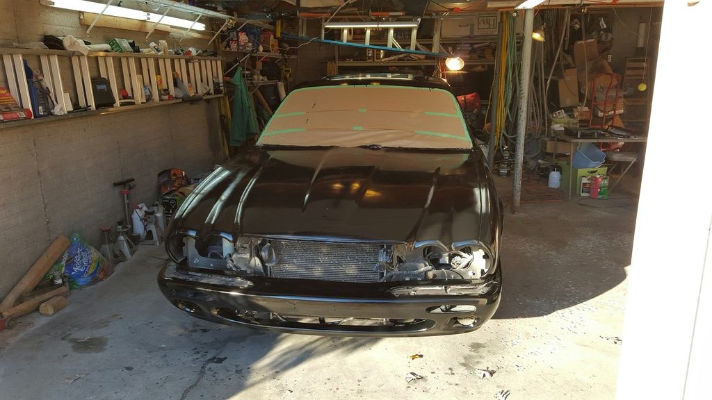

Post by Samilcar on October 31st 2015, 1:27 pm
Two coats of paint rolled on. The first coat was a little too under-reduced (16 oz paint, 5.3 oz catalyst, 8 oz reducer) and had a little too much orange peel that had to be sanded. There were bubbles from rolling that popped but weren't able to flow back down into the paint 100% before the paint flashed and solidified. This second coat had more reducer (15 oz paint, 5 oz catalyst, 10 oz reducer) and laid down a lot flatter, with just a little bit of orange peel. This paint also attacks the roller foam a lot less than the epoxy primer, no disintegrated foam bits in the paint.

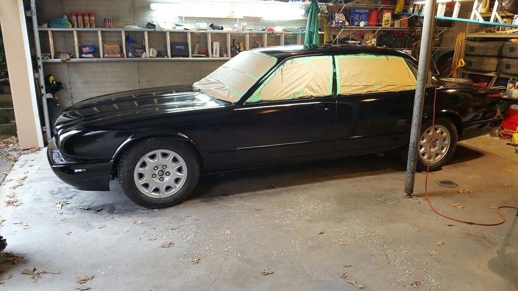

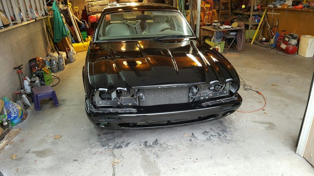

Post by Samilcar on November 7th 2015, 11:26 am
4th coat rolled. I dialed back the amount of reducer in this 4th coat (3 part paint/1 part activator/1.75 part reducer). This is halfway between the too thick 1st coat (3 part paint/1 part activator/1.5 part reducer) and the thinner 2nd and 3rd coats (3 part paint/1 part activator/2 part reducer). Gloss and orange peel with this last coat are identical to the thinner 2nd and 3rd coats, so I'll keep this mix for the remaining coats. 600 grit wet sanding between each coat so far, the next sanding will be done with 1000 grit.

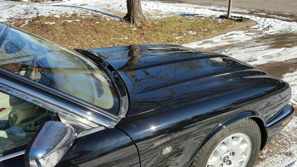

The hood was actually easy to straighten out. Vise-grips took care of the banged up edge by the fender, and a few taps of a hammer straightened a slightly bent hood latch post on the driver-side rear. I ended up stripping most of the paint on that side of the hood because there was already a pretty thick skim coat of body filler underneath the existing paint from a previous repair, I wanted to see how far this skim coat was applied (pretty far as it turned out). The bashed-in rocker panel underneath the damaged rear door was a different story, most of my body work effort was spent there. I ended up having to cut the top of the rocker panel and then pull it out with chains and that garage post you see in some of the pictures. The sheet steel of a 4,100 lb Jaguar is much thicker and harder to move than the sheet steel of a 2,100 lb Geo, believe it or not Very Happy

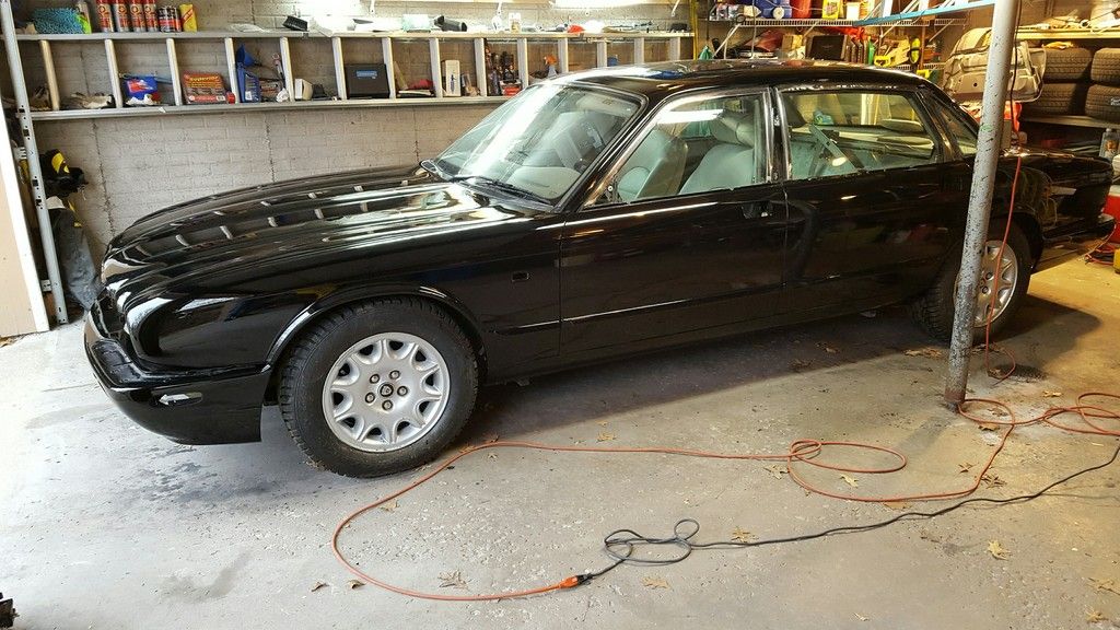

6th coat rolled
Post by Samilcar on November 14th 2015, 12:14 pm
1000 grit wet sanding after 4th coat, 1500 grit wet sanding after 5th coat. Reflections starting to become more defined with the finer grit sanding. I have just enough paint left to do a final 7th coat.

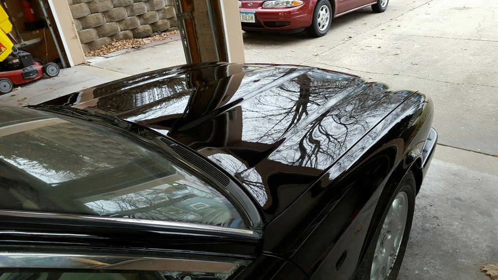

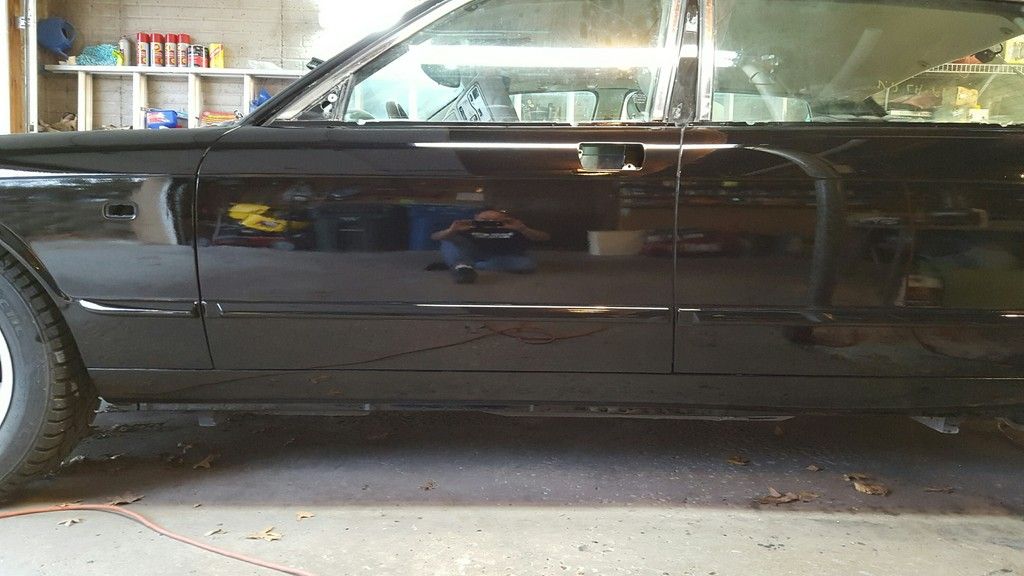

Last coat rolled, wet sanded and buffed
Post by Samilcar on December 6th 2015, 4:05 pm
7th coat rolled, wet sanded with 3000 grit, 5000 grit, compounded with Meguiars M105 and final polish done with Meguiars M205. Paint has what I would call an "OEM level" of orange peel in this final coat, which I think is acceptable for a daily driver. Probably should have stuck with the most reduced mix I used (3 parts paint, 1 part activator, 2 parts reducer) in order to get slightly less orange peel. Next step is to start putting all the trim and brightwork back on and put on a coat of Meguiars M21 sealant.
Post by wantajav on December 7th 2015, 5:20 pm
That's an OEM level job
Especially considering the pics also feature natural light I can see how great it turned out.
This is now the Apex of rolled on technology, actually painting black urethane to that quality. No hazing either which was a problem with many other black attempts. FYI A local paint shop looked at my 1998 mostly straight car but clear coat failures and chips ......$8,000-10,000 !!!! because they said they would only paint it if they stripped the whole car. I can paint the hood, mirrors, front fascia, and one quarter panel far easier and cheaper, THANKS Samilcar for showing us
Post by Samilcar on December 7th 2015, 5:33 pm
No problem. Some of the hazing I've seen on other attempts looks like "blushing" which can happen with high humidity. All of my coats were done on low humidity days (~50%), and I had the garage closed overnight with electric heaters going to keep the temp above 70░F, so that probably lowered the humidity even further.

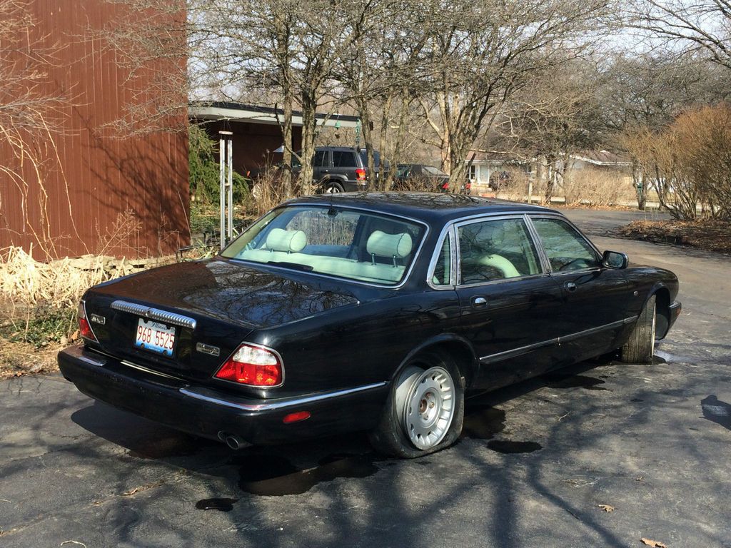

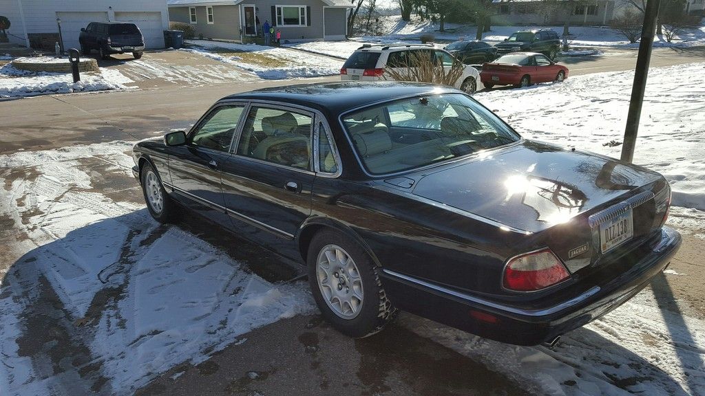

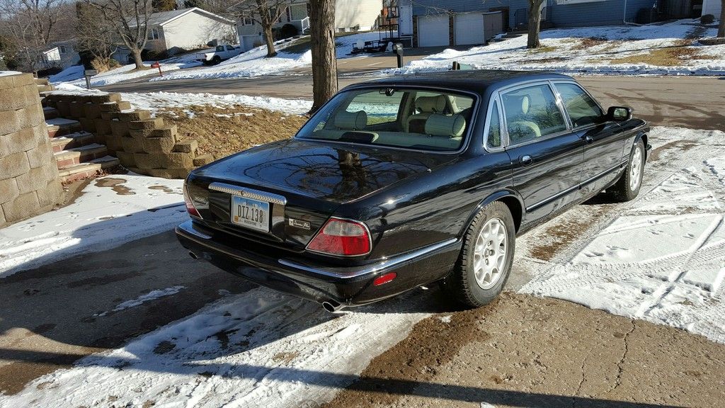

Finally all done.
Post by Samilcar on January 23rd 2016, 2:03 pm
Pics of the finished product. This past week has been the first time I've actually gotten to drive it, as it's been stuck in my garage getting mechanical/electrical issues fixed (transmission shift cable adjustment and non-working turn signal).
