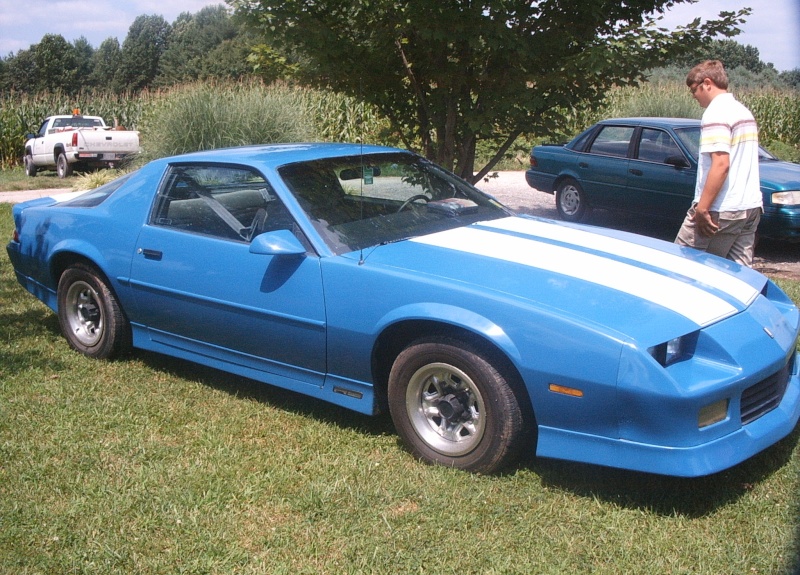

Go with the Brightside for my money It is the better paint for this type of thing. And it shines like a piece of new money even when the car is dirty and dusty. I have posted pictures of my paint jobs using both kinds of paint. You be the judge of the better looking paint.
Brightside
Rust-o-leum
nuff said
Brightside
Rust-o-leum
nuff said
