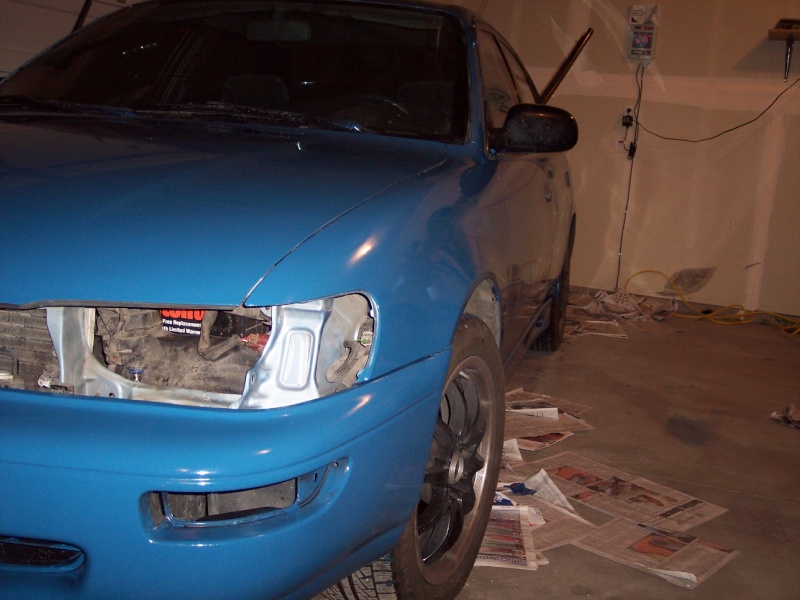

Update!!!
Post by Brakery on January 29th 2008, 11:07 pm
Well I have been working on this car for the past week or so. I could only paint about once a day due to the weather being so cold. Thank goodness for this site!! I wouldnt have been able to do this without it! Well here are some quick pics. These pics are after my 8th coat. I think im going to do 2 more. Tell me what you think. Sorry they are not the best quality. I will try and take some outside tommorow.
The last pic is the roof. Now I have never buffed or polished anything in my life. Please any tips (what kind of buffer/compound at a good price) would be appreciated!

Re: 93 Corolla
Post by JMJ Rick on January 29th 2008, 11:48 pm
Car is looking great! I like the blue.
As for polish and buff, I had never done it before either. I stuck with the Turtle wax polish as I heard it is not as strong of a compound as others so less chance of screwing up the paint. The down side I guess would be it took a little longer to polish than some of the other stronger brands. Now that I have done it once and know what to expect and look for I will probably try the poorboys brand others have posted about.

Re: 93 Corolla
Post by Roadking41a on January 30th 2008, 12:37 am
WOW The shine is great and it looks like it was sprayed on.

Post by btldigger on January 30th 2008, 1:28 am
Looks great so far. If you check my project near the end of page 1 I listed everything I used to buff mine out. I think I posted a link to the buffer in the supplies section it came from harbor freight. If you get it also pick up a twisted wool pad it works much better.

Re: 93 Corolla
Post by mazdawg78 on January 30th 2008, 12:11 pm
that looks real good thumbs up

Re: 93 Corolla
Post by Brakery on January 30th 2008, 4:32 pm
thanks for the comments, I think I will go with meguris, just need to find a decent buffer. As far as the edges around the windows, I took the rubber lining off. I dont trust my taping job lol.

Re: 93 Corolla
Post by pinoyxpryde on January 31st 2008, 12:13 am
did you go straight for 8 coats without wetsanding? if so good work!
pinoyxpryde
Number of posts : 32
Registration date : 2008-01-25
Re: 93 Corolla
Post by Brakery on January 31st 2008, 8:05 am
No I wet sanded after every other coat. Im thinking of wetsanding it with 1500 grit and putting 2 more coats on. There are still some spots that need some more paint.

Re: 93 Corolla
Post by Brakery on February 4th 2008, 11:16 pm
Well I was going to put 2 more coats on but for some reason it kept orange peeling. So I decided to just keep it at 8 coats. I used some meguiars polish and swirl remover with my ghetto coleman 6" buffer. There are still some sand marks in the paint. You have to get right up on the car to see them. To take them out I will probably have to get a better quality buffer. Well here are some pics. And no I did not put those tail lights on by choice. They came with the car.
