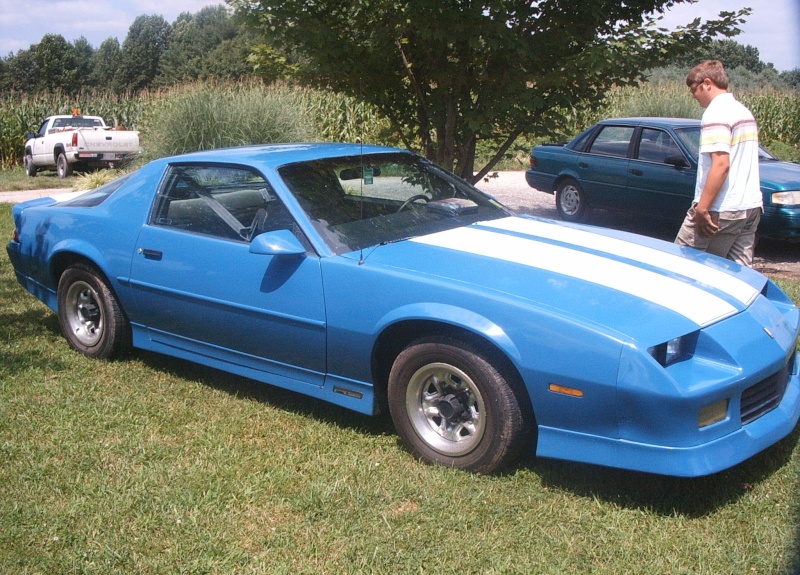

This the Camaro that my brother and I painted about a year and a half ago. The paint is royal blue and gloss white rustoleum pro.
These are a few pics of the car before we painted it. As you can tell the car needed a little TLC.
Here are some pics of the car just after the paint job was buffed out.
The stripes were painted on the car the same way that stripes were put on show cars in the days of lacquer paint. The stripe pattern was taped off first and the blue color coat was rolled/sprayed on. After the blue was dry, the tape was removed to reveal the bare area where the stripes should go. The blue paint was taped off and the white paint was applied in the stripe area. When all the paint was applied the masking was removed and the edges of the stripes were sanded down level so that the stripe transition can't even be felt anymore.
Here are a few more pictures that attest to the paint's durability. These were taken a year after the paint job was finished.

Hey man how are the bumpers holding up? Every camaro, vette, firbird, transam, etc... with the plastic bumpers that I've seen ends up with spider cracks. Just curious how well the rolled on paint holds together on a flexing surface
Re: The Blue Striped Camaro
Post by tzyoung on January 15th 2008, 2:11 pm
The paint hasn't cracked at all since we painted them. The only thing is that the existing cracks do show through because we didn't really take the time to sand them out. For some reason the front bumpers take a lot of damage on these cars and the bumper is showing some road rash but no flex cracks. I would have no reservations painting urethane or fiberglass with this paint.
