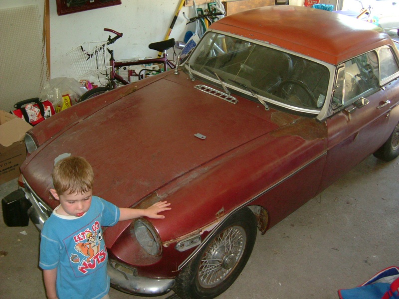

Well finally got around to posting some pics of my project MGB Roadster. Its a 73 1900cc (I think). The body was in OK shape - gone in the usual places, floor pans, rockers, fenders etc, but the basic chassis, rear quarters and trunk floor were in good shape.
The car sat on the back of a broken down breakdown truck for 4 yrs and then on my driveway for another 2. Its been in the garage for about 3 yrs, but have finally started putting thingfs back together. The welding is all done, bodywork (with the exception of the fenders) has been filled (only rubbing down to go), axles are off and re-furbed (de-seized, greased and painted). So next phase is to finish the fenders and get ready for paint in June. My plan is to have her back on the road by the end of the year (have been saying that for the last 2 yrs) and can actually see the end in sight.
Below are some of my pictures
This is what the car looked like when I got it
