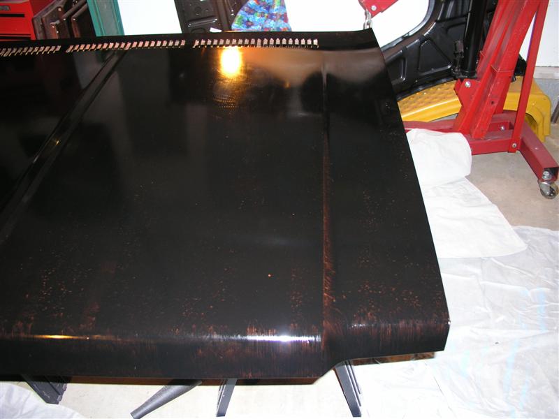

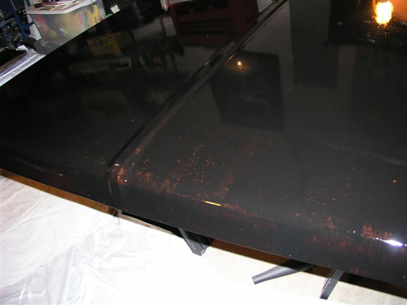

Of course, I already have a question. These pics would indicate I put the paint on waaaaay too thick, wouldn't they? If so, what do I do next? Think I should continue to follow the procedure and do another coat and wet sand with 600?
Here's the pics.

From the pictures it looks fine to me. What mixture are you using? Remember that your using black to cover dengy orange so the coverage is going to be great even with the first coat. Also remember that your first few coats will look terrible because it's thin, it runs, it has a lot of bubbles, etc... That's just the nature of the beast. After you wetsand and start adding more coats you'll see the results the way you wanted to. Keep us updated, your on the right track.

Post by Killthewabbit on February 24th 2008, 10:28 pm
Thanks for the quick response, Matt.
I used as close to 1:1 as I could get by eyeballing a mixing cup without a level surface. I ended up mixing up too much paint, but that's not really a big thing. I don't really mind the bubbles or the runs. The surface of the paint actually looked better than I expected after I ran the dry roller over the first coat. The lighting in my garage is crap, so I thought it covered more than it did. After checking out the pictures, it doesn't look quite so covered after all.
I didn't even think about the black covering the dingy orange. I was thinking it would show a lot more through, but I guess that happens more on colors like red, huh?
I'll keep on keeping on and try another coat tomorrow night or the next day.

Yep red is a PITA to cover and to paint. A lot of people say the best consistency is about as runny as milk. Mine was just a little thicker than that. I used a 2:1 mixture but it was around 75 degrees when I painted my truck.

Mine was prolly about the consistency of 2% milk, ala 69chargeryeeha's original directions. Actually, I figured pretty close to 50-50 would be a good place to start.
I'm so jacked about this. I hope it looks good. Me and a friend from work are going to be our cars. We've been talking about it for months. I'm happy I finally got started on something.

First coat does look a little thick. As for sanding, it depends on the texture. Being a little thick I would probably wet sand before 2nd coat, not to take off paint, but to be sure it is smooth before covering.
As for the "runny" look on the vertical parts, I had that problem on the sides of my car too, I found if I mixed a little thicker I did get better coverage, but had orange peel. If I rolled back over the vertical areas a second time with the dry roller it seemed to be better.

JMJ, I see your point. It's a lot thicker than I expected, even though it's not as think as I originally thought it was. Wet sanding shouldn't hurt anything except my arms, but will most likely help the next coat look better.
Hmmm....
I guess I'll wait until next session to see how it looks before deciding to paint or wet sand. I'm not 100% positive I'm going to paint/wet sand tomorrow, but I'll take some more pics and get yall's opinion then.

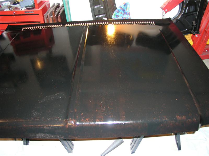

OK, here's pics after a day of drying. I haven't touched the hood at all since I rolled on the paint yesterday. I dunno how well it comes out in these pics, but the paint is laying down great.
On to the pics!
So what do you guys think? Should I go ahead and wetsand now, or put on another coat first? I'm going to take tonight off and do some work on a client's site, so probably nothing will get done to it until tomorrow at the earliest.

Looks good so far. The way I understand it it's 2 coats then wet sand.

from what i've seen and read, you've got a great start. just keep putting on thin coats and wetsanding and you'll have a great looking hood.

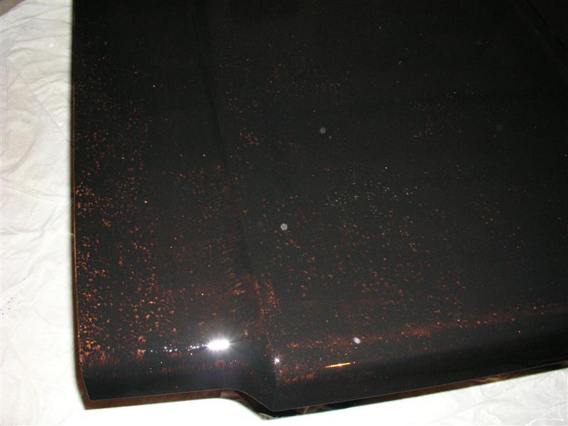

Well, I rolled on another coat last night. Here's some pics I took just now, so it's had almost a whole day of drying time.
I think I'm going to switch to a new dry roller every time. The one I wrapped up in a plastic bag after the first coat was still pretty wet and seemed like it wasn't popping as many bubbles as before.
I guess I'll be wetsanding for the first time tonight.

Well, I'm not a big fan of wetsanding so far. I have no idea if I'm doing it right or not, and it's hard to tell because it's still wet, even after wiping it off a few times. I did go sand through the paint in a few places, but I imagine that's probably normal.
I'll take some more pics when it dries off.

OK, the water's dry. Here's the wetsand pics...
I'm heading out now to do another coat.

Looks like your on the right track. The crosshatch wetsanding is a good technique because your sure to knock down the entire area. It's looking great so far.
