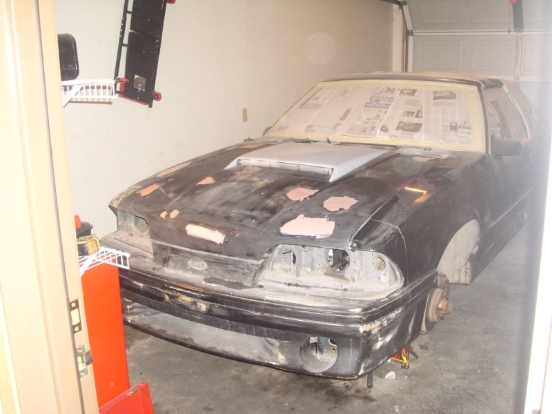

update: day 1
thanks for the fast post yeah i think its a great candidate for the job:D do you think i will have enough paint with just the one can? or will i have to go out and buy one more ? i have the quart of it? im thinking ill be doing around 10 coats-5 days mabey more just so i dont have to worry about burning through latter on! heres the update pictures with some of my supplys i bought from wallmart,fleet farm and advance auto parts lol around 50 bux so far. and i also started doing a little work on the fender im going to start there and work my way around the car. and the little x's in the picture are a idea of matts im useing i figure each one is around half and hour added to prep time.. whats a good way to repair my cracked front bumper? and if u look at the pictures do you think my hatch will be fixable or should i go find a new one ? also on the hood i think im going to give up its really dented up everywhere and i can get a clean smooth one for around 100bux. enough with my ramble heres some pics
-Thanks
Shannon
P.s. ignore the mess lmao i dont have much time to clean my little garage!

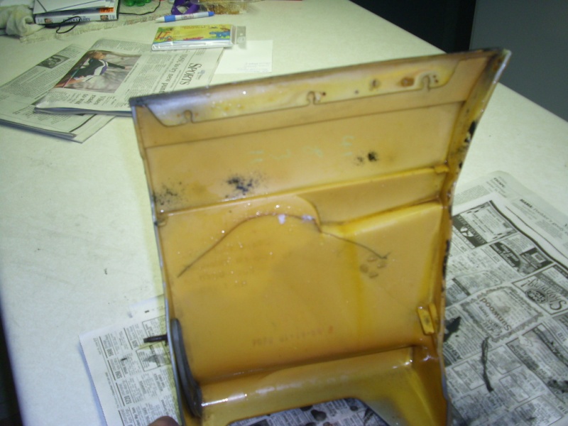

ok so heres how far i am now the car is completly wet sanded with 400g and has a even dull tone. im still waiting for a new hatch i got into looking at my bumper cover and side skirt and im going to just repair them and buy a new hatch and rear bumper cover. wont be till some time next week so it looks like ill be layed up another week before i even begin to paint. heres progress pictures.. the front bumper cover is going to take quite a bit of time just to get it ready for anything...:S i think it will be worth fixing though.
I used this as a test to see how well plastic weld and locktite superglue and a light coat of epoxy would hold ! worked great and i used the super glue as a filler in the seam of the crack and it works great! sanded down smooth and dosent crack under flex! im going to use this on the front bumper cover and get some bumper primer,flexible bondo, and some decent flex additive for the paint so it dosent spider crack! im also going to spray most of the side skirting with a hvlp gun so i hit every crevis and done have to worry about it as much! do you have to do as many coats when u use a hvlp style coat? vrs a roller?

Post by wct203814 on June 2nd 2008, 12:28 am
heres a post of the front bumper cover fixed~!
From this
