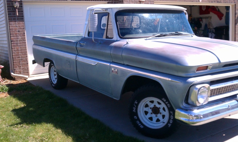

Post by 66oldgreen on April 6th 2012, 12:47 pm
Well, the paint job held up good for a few years. Was starting to have some surface rust come back, so I decided to re-paint. After seeing the other post on the faux patina c10, I decided to try it with mine. This picture was after painting the whole truck with flat black rustoleum then with rustoleum primer. I brushed on the flat black, and rolled on the primer.
This picture is after finishing a coat of the new color on the bed. I mixed rustoleum silver with rustoleum turquoise. I rolled on the color.
This picture is after finishing the white top and the rest of the truck:
These are pictures of the finished project, after sanding to give the truck a weathered look. This time the paint job went much quicker, since I was not trying to make it look shiney and perfect. I like it, most people that have seen it don't like it and can't understand why I would want it to look like this. My neighbors have already started asking when I am going to finish it and what color it is going to be, or if it is even the same truck. They never seem very happy when I say I am done Very Happy
