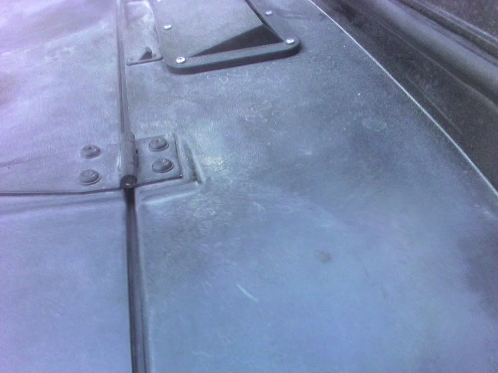

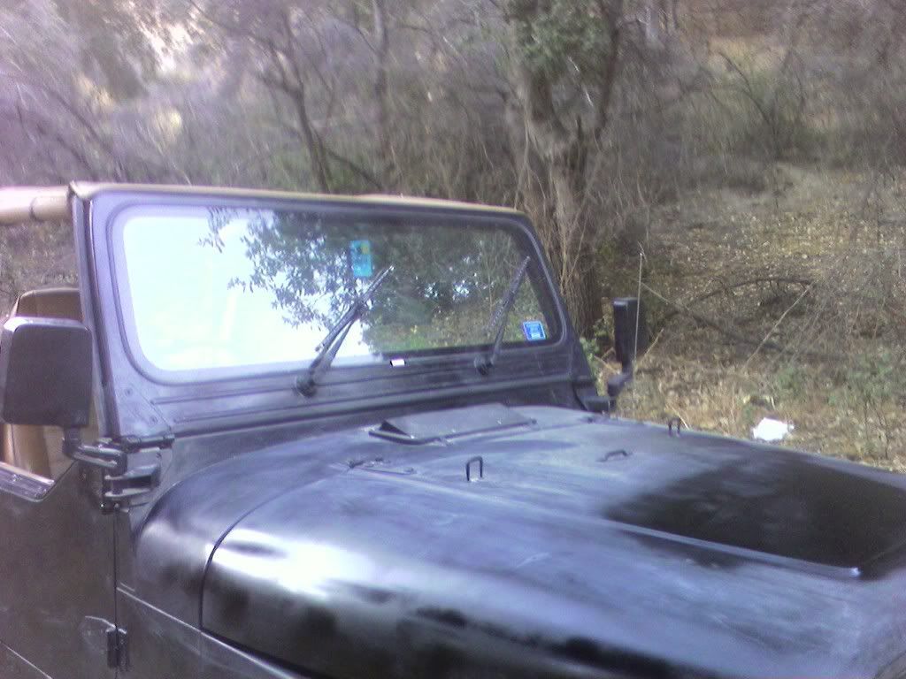

1. This is what I started out with: 1994 Jeep YJ with 150k on the clock and a finish that was definitely showing the mileage. As you can see, I had messed around with some Rustoleum spraypaint on a couple of areas prior to starting the body and roll-on work):

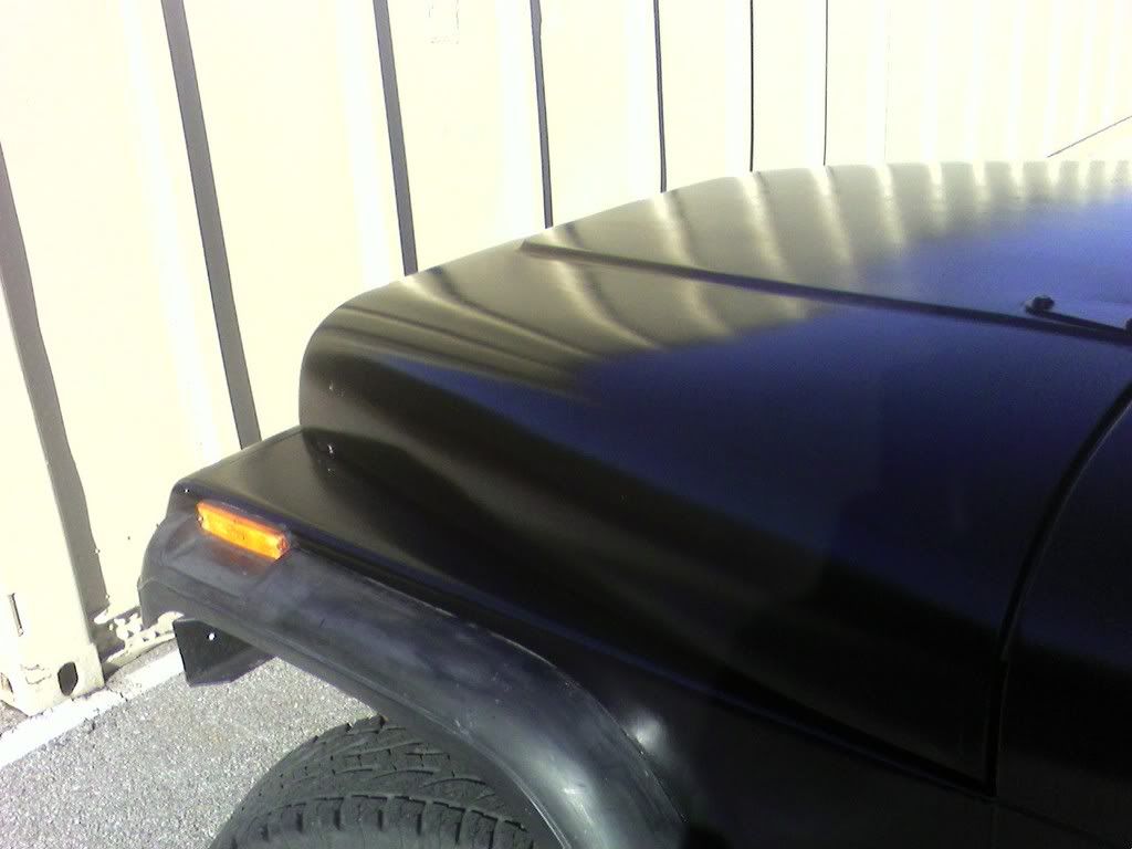

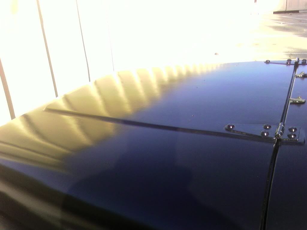

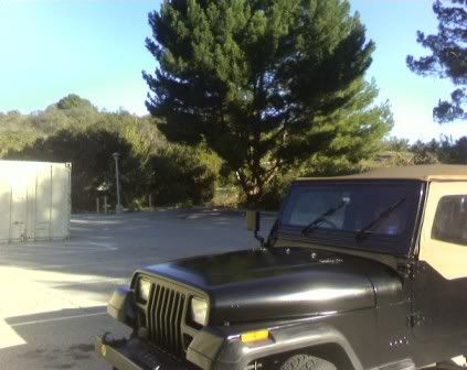

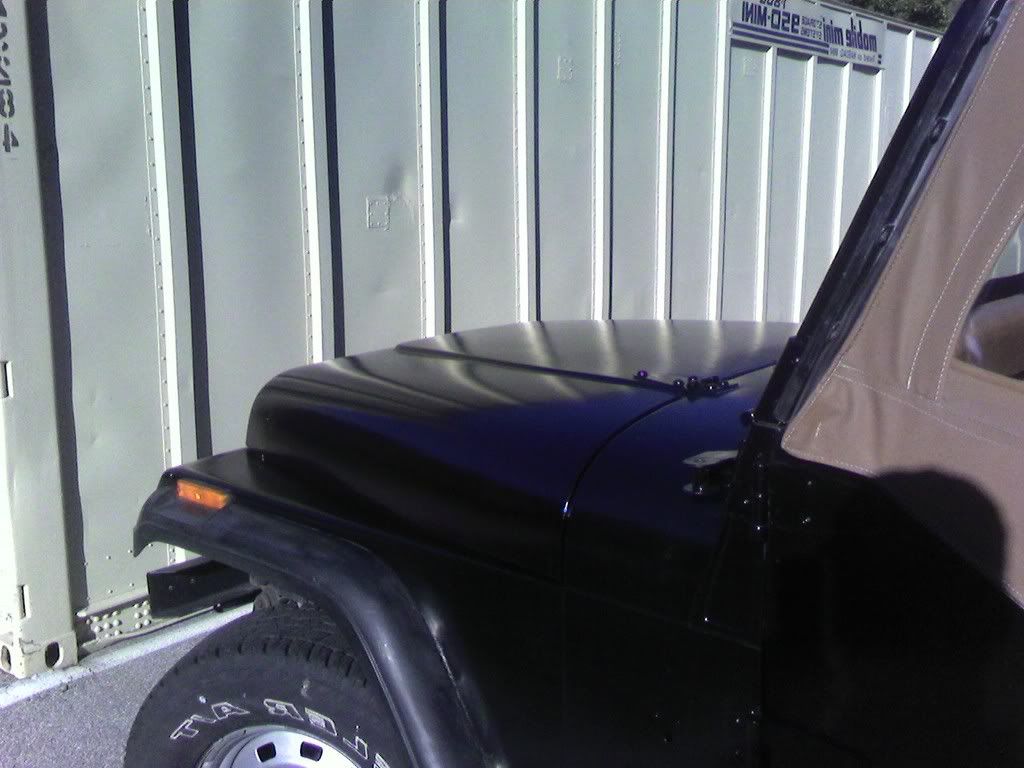

3. This is after 4 coats of the Single-Stage Blue Water Marine Polyurethane, Gloss Black, thinned 50/50 with mineral spirits and applied with 2 rollers (2nd to smooth out bubbles and remove excess paint). Finish results are much better than what I started with:
Haven't finalized the fine grain wet-sanding, compounding, polishing and waxing, but will get around to it in about 30 days. Will see how this Blue Water Marine Poly holds up, but its a topside boat paint with supposedly decent UV-resistant characteristics and all that stuff. Very Happy
