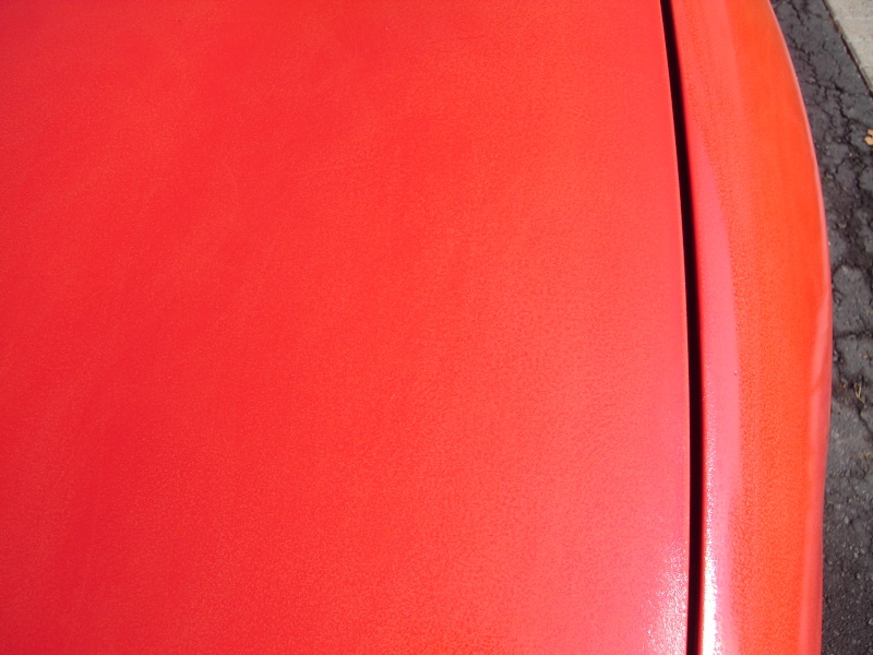

Now to skip forward a bit. My last set of pics was from the 4th coat of paint. I ended up doing a total of seven coats (!). I was still seeing shadows in the paint right up to about coat #5 under certain lighting. I think the reason for that is two-fold:
1) I was rolling on the paint very thin. My 7 coats are probably equivalent to 5 or 6 coats for most people.
2) Red is a real pain in the a** to obtain full coverage with. I remember a co-worker did a red accent wall in their house, and it took 11 coats of paint for it to look even, with no shadowing or colour variation. I guess cars are no different! Razz
I imagine with some other colours (i.e. white) many less coats would be necessary. If I had to do it again, I would make sure the undercoating wasn't such a varied mix of brown primer, white original primer, black bumper repair resin, etc. I should have grabbed a can of red Tremclad and just evened it out a little. Ah well, I know with seven coats the car body will last until the apocolypse.
Here it is with seven coats, just prior to the beginning of wet sanding:

On to the wet sanding. I used a combination of 600 and 800 grit for the first sanding (800 for the most part, 600 on a few spots where I had some worse-than-average orange peel). After that I moved up to 1000, then 1500, then 2000 grit, using plenty of soapy water to lubricate the paper and paint. After the sanding, I applied Turtle Wax rubbing compound (the coarser stuff for "severely weathered paint") with a cheesecloth. This was followed by Meguirs polish with the orbital buffer, then by Meguirs Carnuba wax applied by hand.
Here's what it looked like after wet sanding, note the overall dullness of the paint:
Note the shiney spot on the hood is my test case, where I did just a little polishing. I decided I needed to be more aggressive with the wet sanding once I did the test spot, so I recommend everyone do a test panel to see if you are satisfied with the results before you go too far down the wrong path.

Post by Grimace on November 27th 2008, 9:00 am
That's right Mark, I didn't do the jambs, under-hood or areas like that because the colours were so similar. But there were areas I couldn't get to with a roller. In particular, the front bumper cut-outs for the radiator were done almost entirely with the foam brushes. The brushes require a little more attention to get a smooth finish, and it won't be quite as nice as the bits you've rolled on *until* you wet sand - then you can't tell a difference between areas you've rolled, and areas you've brushed (as long as you spend the time to wet sand it right.)
I couldn't get to some areas of the front bumper with the buffer, so I did them by hand with a variety of cheese cloth, terry cloth towels and polishing rags. It takes a little extra time to do it by hand, but it's "character building". Wink These areas you can't get to with the buffer are usually not high-visibility areas, so you might be fine with leaving it unsanded/unbuffed. Here's a close-up pic of my paint before I started to buff or wet sand:
(Let me know if that image isn't showing up, and I'll re-host.)
You can see some texture to the paint, minor orange-peel, but its not too bad and the paint has great shine.
Now when you do the door jambs/underhood area, you have to clean *very* carefully, because of grease and oil in copious quantities that exist in these areas; Door locks and hinges get lubricated, and inevitably some will get on the paint. And of course, under the hood there will be a lot of built up grease, grime, etc. from over the years.
Hit it first with a product called Simple Green, undiluted, and give it a good scrub with some brushes (an old toothbrush works well for the crevices). Rinse really well. Note - Simple Green will dull your paint - don't do this unless you are sure you are going to go the distance. Follow up with dish soap/water and a really good rinse, then prep as normal.
If you don't get all the oils off the paint, it will "fish eye" and not adhere properly. There's a gentleman on this forum that had that problem with his Grand Am hood, you can see an example of what it looks like here about halfway down the page.
