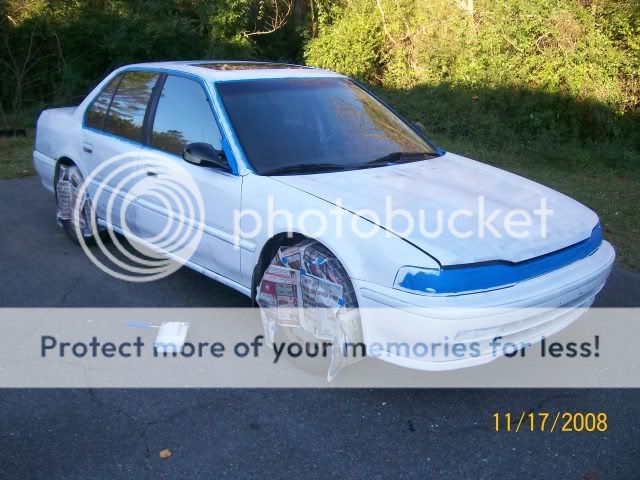

Hi, I'm new here and just wanted to share some pictures of my progress so far. I've put on 3 coats of gloss white rustoleum so far, ran out of daylight, so in a week, when I'm off work again, I'm gonna start wetsanding for the next coat. Right now, it's still pretty blurry looking trying to see reflections in it, but I know that will buff out in the end. Heres what I got so far......tell me what you think.... Very Happy
I've got a bunch more pictures of the in between stages, but I just posted up like a first, middle, last kinda pics...lol. Still have a ways to go, but I will say, so far, so good...

Don't forget details about your procedure..We love details! Well, I do and I'm sure others do as well. Very Happy

I'm just doing a regular old roll on job. I tried mixing my paint with mineral spirits, but it was so thin, it was literally running off the car...lol. So I just used the paint alone with no mineral spirits, and it seems to be working very well so far. I'm using rustoleum, gloss white, protective enamel. I've put on 3 coats so far, and haven't even started wetsanding yet. That will be my next step, then probably 2 or 3 more coats, then repeat as needed until I get the finish I'm looking for. Then when it's all done, buff, swirl remover, and wax, and hopefully, she'll look pretty good. I'll update as I work on the car too, so stay tuned... Very Happy

wow...you really should mix at least a little with it, it takes forever to dry without it.

Details and pictures. Thats what we like. We also like helping by answering questions so if you have any, just ask.
Most here mix their paint 1 to 1 with thinner and you are using straight paint. Interesting...............Please let us know the outcome and how much orange peel you get. I would think a bit of thinner would help with the flow out and help prevent o.p.
Looking good so far and just a reminder about your masking tape. Get it off as soon as you can after the paint dries. Good luck.

I'll try to mix with the mineral spirits again on the next coats, but when you are saying a 1:1 mixture, you're saying half paint, and half mineral spirits right? Thats what I tried first, and it looked horrible. Was fisheyed reeeeeally bad. Any advice. Just rolling on straight paint, it went on nicely, but has orange peel like crazy.....but I thought that was what the wetsanding was for. Oh, and I'm gonna start wetsanding tonight, so I'll put up some more pics soon too. Thanks guys for all the support. I'm sure you guys will be able to help me with any questions too.

If you thought the 1-1 mix was too thin, don't go that far but you need a bit anyway because that helps the paint flow out better and will reduce the orange peel so there is less sanding. The thinner the paint the better flow out but mix it the way you think you can handle it. If you like the way the first coats went on and don't mind the sanding then go for it but try a bit of thinner next time and see how you like it. I bet you will. Good luck
