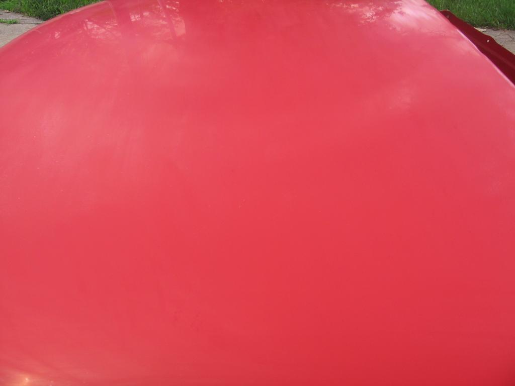

From a lot of pictures I have seen most folks stop with a decent finish. I personally could not stop myself until I was happy. I ran into the issue where either up close it looked great but from a far it looked very distorted, or vice versa. I learned that I wasn't doing my final wet sand very well. This is where I learned it did not matter if I rolled it or sprayed it, I was messing it up in the end.
The picture below is of my finished roof. As you can see it is very smooth and reflective. That is also with the camera right on the roof taking the picture, not zoomed in, during a normal summers afternoon.
To be honest, I had sprayed it with Rust-o-Leum Sunrise Red (rattle can). I had put down so much orange peel and over spray, that the day that picture was taken, I was actually sanding it down to respray. I used a 3M sanding block with 1000 grit paper. After a little bit I started to notice the paint flattening out so I switched to 2000 grit. You will notice a bit of a reflection in the sanded paint. That reflection is a sanded area that shows how well the paint was flattening.
Now the trick was the sanding block. From the spare engine lid I learned that when I used my hand to wet sand it would also sand the low spots. While a sanding block sands flat and kills the peaks of the orange peel paint. Here is where I think some of you have stopped. Again, I mean no disrespect, and I applaud everyones efforts in painting their rides.

Thank you for the comments about painting. Especially the one about using a sanding block and why. I have been painting as a hobby for 40+ years and I think sanding is one of the most misunderstood areas there is when you talk about painting.

Thank you for the compliments. It honestly took me awhile to figure out the key is sanding. Not only when you finish, but when you start as well. If you don't start with a good surface, you sure aren't going to finish with one. I also agree, sanding is a misunderstood art form all its own.
