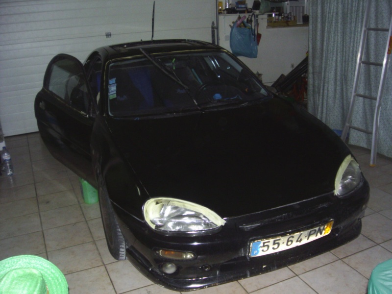

Now some pictures of today's work sculpt
Badged
De badged
Orange peel from yesterdays paint job
Tonight's paint
Close up of the wood. Last time I painted it there wasn't this marks and it was much more glossy. Also I notice that almost no bubbles this time. Maybe I put too much thinner in this job.
microshift

Post by microshift on April 30th 2009, 9:23 am
I did some 800 grit sanding on this 1st layer while reading moparts thread for some info on Interlux. It was pretty thin so much of the layer was sanded out, but leaved a surface more perfect than before.
Then I decided to switch from acetone to mineral spirits on the next layers.
Note: Mineral spirit is know as White spirit in Europe. Taked a while to figure it out!!
Paint with Mineral spirit as thinner is much better than acetone as it evaporates more slowly, leaving more time to paint and then paint has more time to level it self.
The result of this layer was very good. Very little orange peel. Almost perfect!!
But I have to put more paint over because it stills too thin for final sand and
polish.
Then I did the 2nd layer of this new state of painting with Interlux+mineral spirits.
Final result was not as good as before as more orange peel showed up. Maybe because it accentuated the little OP that was before.
And I had some paint dropping on the fender because I put too much paint on the roller on that part.
