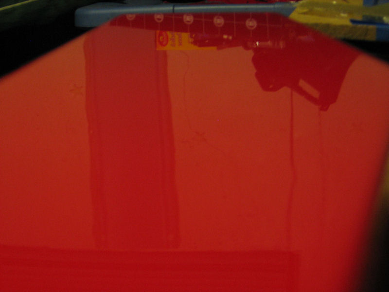

Got some updates. Still testing things mind you but I think I have it narrowed down. So far I am using Rustoleum Sunrise Red, Automotive (for acrylic enamel) reducer (medium), hardener, and mineral spirits. My mix consists of 4 parts paint, 3 parts reducer, 1 part mineral spirits, and 0.5 parts hardener. Yes that is 1/2 part hardener. I have also been painting with a foam brush, not a foam roller. The reason for the brush is because the item I am painting is literally 4 inches by 16 inches. Not very big so why use a roller.
What I have learned thus far. Rustoleum works very well with the above mentioned automotive reducer/hardener. When used in this combo the paint actually is stronger than when just mixed with mineral spirits. Wet sanding has become easier, it can be wet sanded sooner, and the paint dries completely in 4-5 hours.
I have also learned that you do not have to use the hardener until your final coats. This will save on supplies as well as the average 14 day open life of the hardener.
Right now I have put on the 4th coat (of this latest mixture) and the deep gloss shine is amazing. There are some minor brush strokes (very faint) that will easily wet sand out. Sorry my camera just can't zoom in as close as I would like. For some reason it makes the red look black. I personally like the TV reflection in the panel LoL.

That looks wonderful and its not sanded yet? Keep up the good work. I hope you are having good luck in your job hunting.
Re: Rustoleum advice!
Post by MR2Miach on June 6th 2009, 3:08 pm
Nope, it is not sanded yet. That is just dry paint that was brushed on. Thanks for the compliment Mike. Job hunting isn't going as well but that's life.

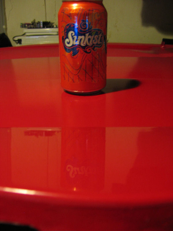

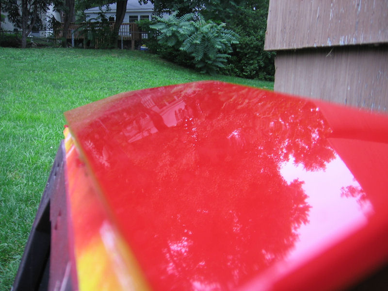

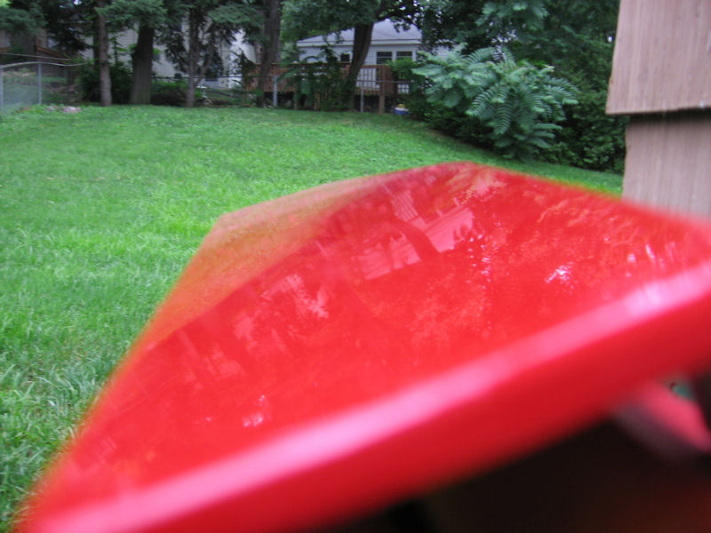

Post by MR2Miach on June 10th 2009, 9:31 pm
Here are some finished pictures of my test panel. Took some outside pics but of course it was cloudy so sorry about that. This is final wet sanded and polished. The last pic is of it sitting on my unfinished test hood with the Sunkist can 6 inches away. Enjoy.

Yep that's just with my mix. You can even see the Sunkist reflection in the hood in the bottom picture. The hood is half wet sanded lol but the side the can is on isn't and its on its third coat there. Haha thats funny, I just noticed it.
Anyway, primer usually dries much fast than paint so waiting until noon tomorrow should be fine. Oh and meant to ask before, when you wet sand are you using a sanding block? I found using a sanding block works far superior to using your hand. It sands flat so you are actually leveling out the painted surface.
