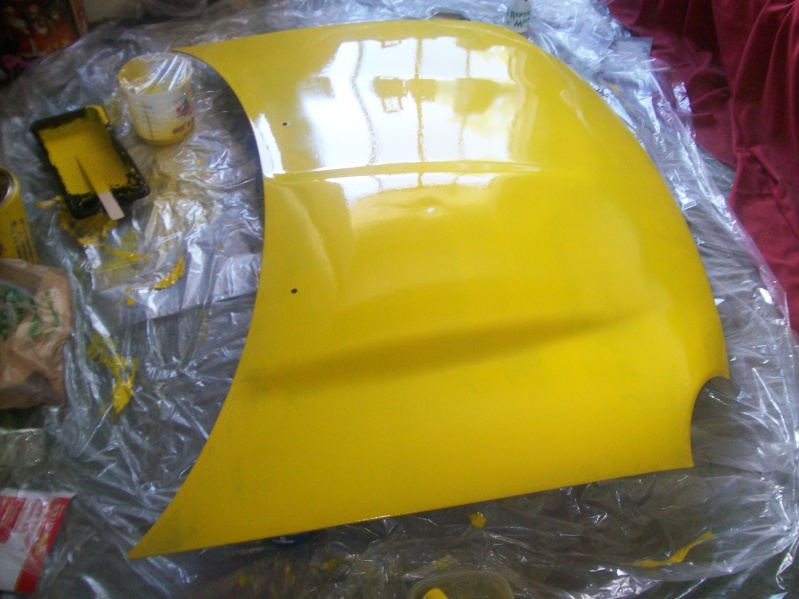

Alright, so I'm going to be painting my neon from the ugly fading purple it is right now to a bright yellow Very Happy The paint I'm using is the Rustoleum Safety Yellow. Before I actually started on the car I wanted to test my method a little bit and get a feel for how this is going to work. I was fortunate enough to find a guy giving away a neon hood for free the day before I went on vacation. I am currently on my 3rd coat.
Here are some pics of my process so far Very Happy If you have any suggestions let me know! Thanks
This is the hood after a quick sanding:
I decided to use a primer since the hood and car are two different colors; I don't want any variation in the end since I like this hood a lot more then the one I have right now Razz
I wet sanded that primer with 320 grit then applied my first coat of Safety Yellow:
2nd coat:
Wet sanded with 600 grit and I just applied this 3rd coat:
I seem to be getting a few roller marks :/ any way to avoid those??

Post by Techmaven on May 29th 2009, 10:56 pm
How much are you thinning the paint?

Post by Lil Neon on May 30th 2009, 2:40 pm
I'm thinning it at about 2:1. It seems to be just a little thicker than the consistency of water with that mix. Do you think I should thin it more?
And a question about the wetsanding. I decided to wetsand after the third coat because I felt like I hadn't done a good enough job last time. I used a sanding block and went to town. When I was done the entire surface was very smooth to the touch but it still looked like there was orange peel even though it was totally flat. Am I doing something wrong or will this not be a problem in the final coats?

Post by Lil Neon on May 30th 2009, 2:49 pm
Okay so like I said above I decided to wet sand again after the 3rd coat dried:
It looks like there is still orange peel but it is super smooth to the touch Suspect So I'm not too sure about that. If you guys (or girls) have any insight on that I'd love to hear it
Last night I put on the 4th coat and I just put on the 5th coat this morning. secret

Post by retired plumber on May 30th 2009, 10:49 pm
Yep, Thats orange peel. When the entire surface is dull then it is smooth. The shiny spots you see are the bottoms of the peel that haven't been sanded down to yet. You have to use a sanding block of some kind (hard) to level the surface. Some people try to use a sponge and squeeze the water out as they go but the sponge follows the surface and sands everything. We don't want that, We need to sand down to the bottoms of the orange peel. However there is a point when you can say "that good enough. This is NOT a show car" and stop there. I try to get the hood, tronk and around the windows as perfect as I can and the rest is......,well thats good enough.

Post by Lil Neon on May 31st 2009, 4:35 am
Thanks for your input plumber Very Happy my sanding block thing kinda has a foamy bottom which I think is making wet sanding a lot more difficult and which also forces me to use the edge of the block alot. This of course led to me slipping and catching the paint with a corner doh
So I guess I'll just have to sand a little harder and pick up a better block :/ anyone know where I can get some wet/sand paper in decently large packs for a good price? Gotta get back to wet sanding now!!

Post by Lil Neon on May 31st 2009, 6:02 am
So I spent a few hours trying to get that hood looking perfect... I pretty much was about to throw the hood out the window mad3 It seemed like every agonizing sanding motion was just bringing out more orange peel.
Then I just looked at the hood and exactly like Plumber said I was at that point where I thought, "That's enough". My last few coats are going to receive the most wetsanding that I can sanely give and no more grin

Post by retired plumber on May 31st 2009, 11:21 am
Cracked bondo has to come out and be redone. Clear down to the bottom because there will be moisture down there which will cause rust if it is covered over. A note about sandpaper.......Stay away from ebay stuff. It comes from China and is cheeeeep but it is junk. Spend the $$$ on brand name stuff. It will outlast the China stuff 3 to 1. I know that for a fact because I have a bunch of it LOL.

Post by retired plumber on June 5th 2009, 12:33 pm
I suspect you will have runs. The trick is to not have much paint on the roller. That is one of the reason for so many coats. When you see one just go back and roll over it again. Some people have a clean roller in their pocket just for that purpose.
