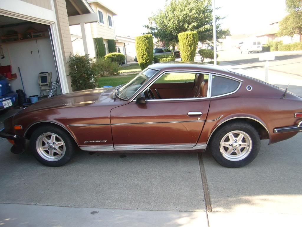

Whats up fellas. Alright.. i started the prep work on the car and i have removed all of the decals and have sanded the down with 100 grit by hand. I am going to go over the entire car with 400 to smooth out the paint as much as possible before i start painting. There is some minor body work that i have to do (door dings and a couple of depressions... nothing major) In addition to that.. my door hinge is sagging a bit.. but doesn't seem to be a threat to impede my progress... I figured it can be resolved post painting. I went to HD and got a hold of some gloss white (later i've read that there's another marine paint that has a better quality) but i'll go with what i have. Pics are coming once i get the first coat on.. I know they wont be pretty . ha. but its a good effect to show the transition to how good i think this car is actually going to look with the white because from what i've gathered hides imperfections in the body work pretty well. Any pointers on getting a good quality white? cheers. Mike. (PLZ excuse the night photos)

Don't worry- the Rustoleum White works fine.
My tips to get a good white finish:
1. You might want to cover first with a few coats of rustoleum white bare metal primer since you have a darker surface to start with (brown like my blue). Not too thick- I diluted with about 30% mineral spirits and I think it was still too thick. I found the best consistancy is that of nonfat milk.
2. Thinner is better. Do not worry about runs- it can be picked up with a pass with a drier roller when still wet. Too thick is a total pain. Remember it is much easier to roll another thin coat then it is to sand out a thick coat.
3. Did I mention that thinner is better?
4. Use spray cans for tight spots.

Yes, you need a white or very light underbase (primer) to make the white really look white and pop.
I would suggest you address the door hinge before you paint if you can because of the risk of scratches or damage to the new paint during the change.
