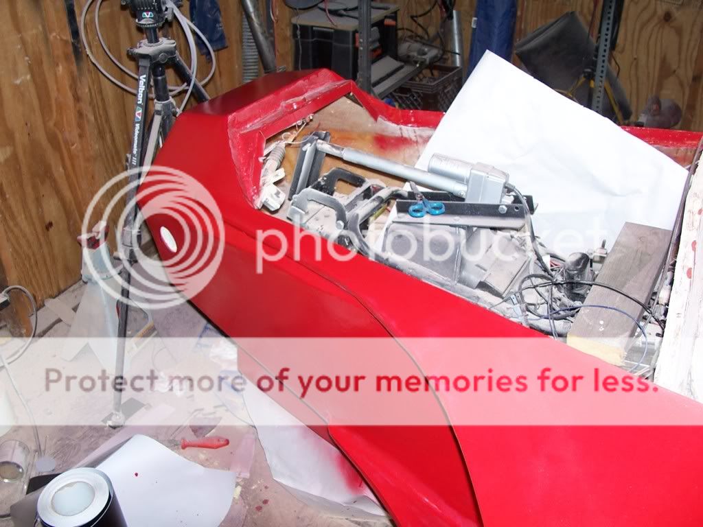

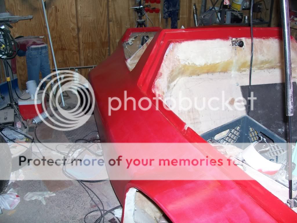

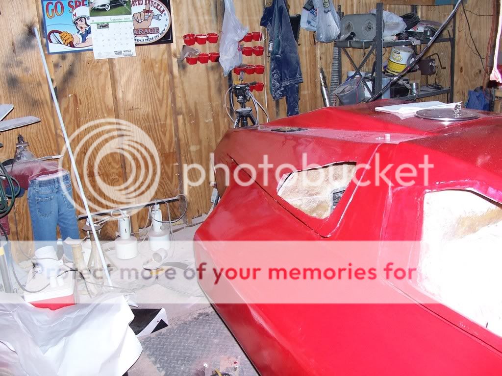

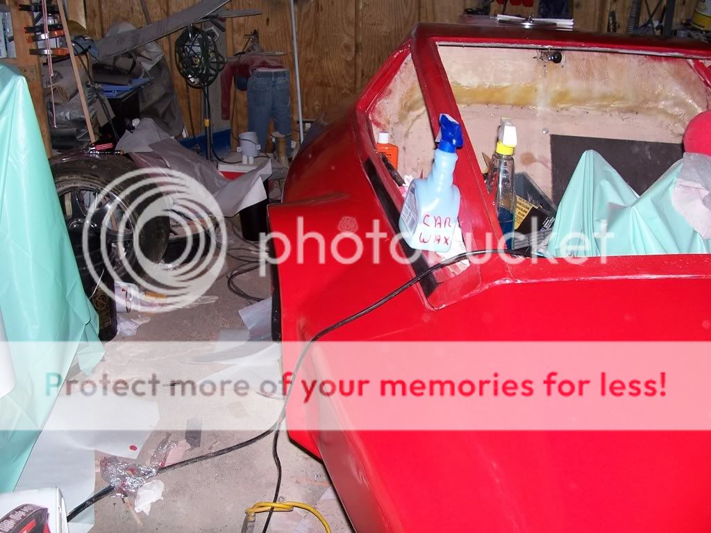

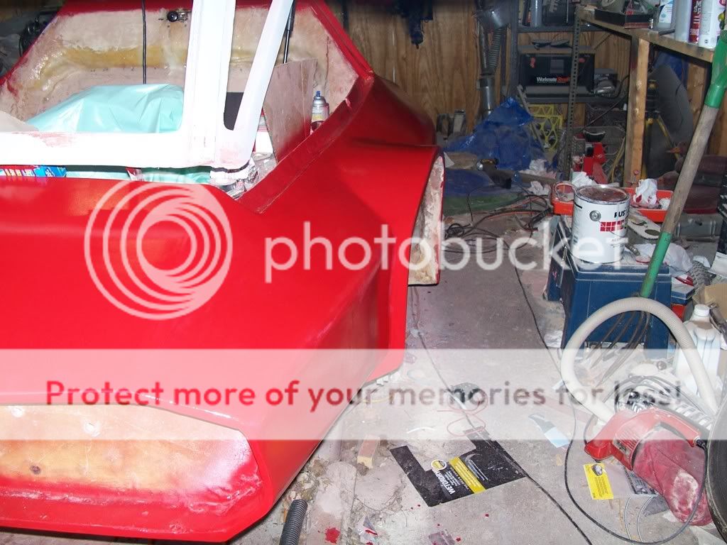

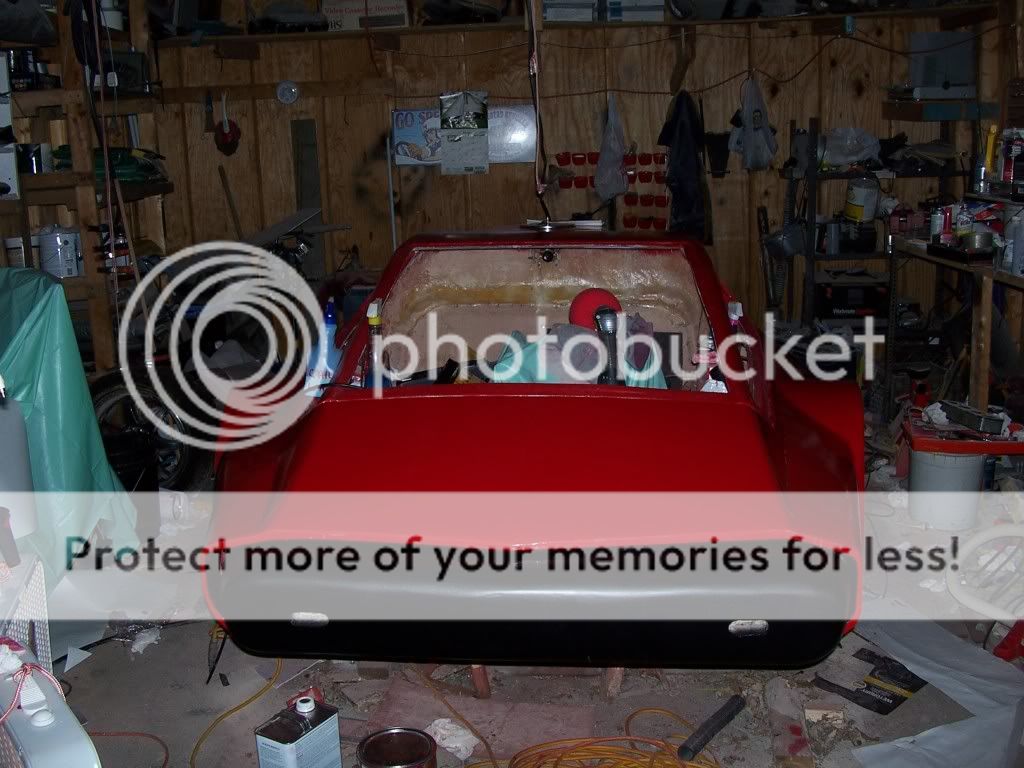

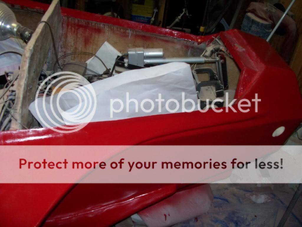

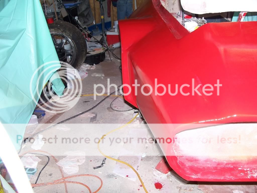

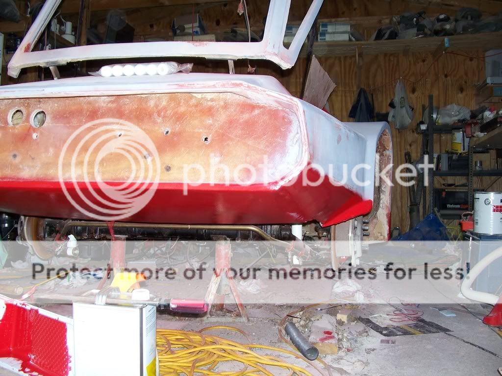

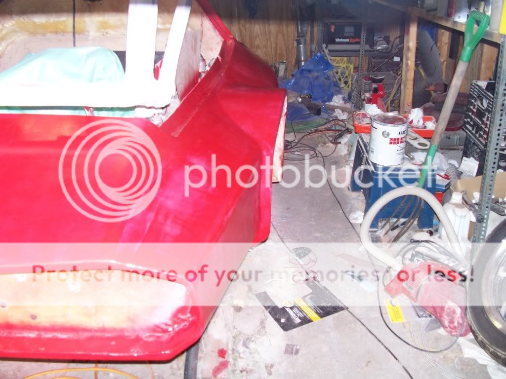

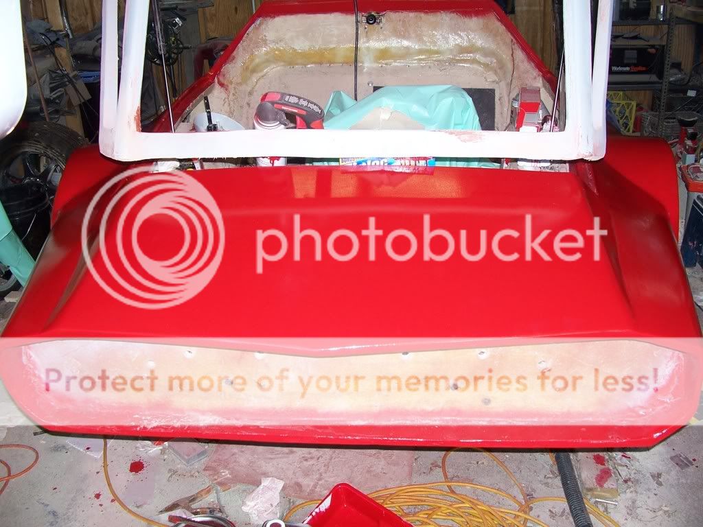

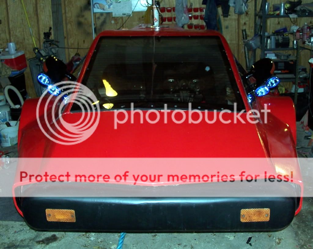

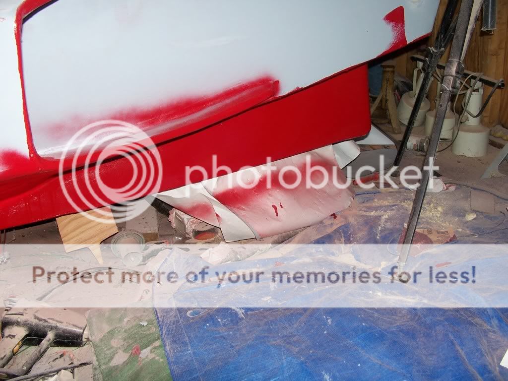

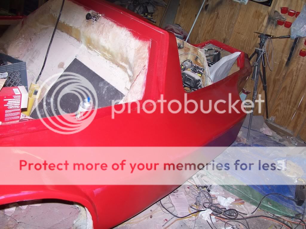

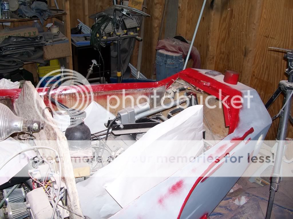

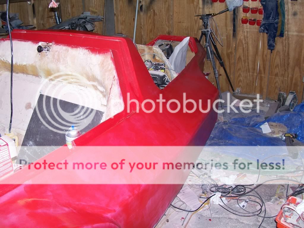

The time came and went to get it painted . This trike is built from plans there was no kit for the body built mostly from Urethane foam sheets and plywood. So it's not quite as smooth as a production body since I'm not Chip Foose lol.
I ended up with seven coats and right now it's all the rubbing out and polishing . The Mothers Powerball seems to work really well for compounding and the yellow one for the polishing.
Painting the flanges
First coat Second coat It was done with like a 60/40 paint to thinner ratio 60 being the paint. The temp was in the 75-85 degree area fairly humid.

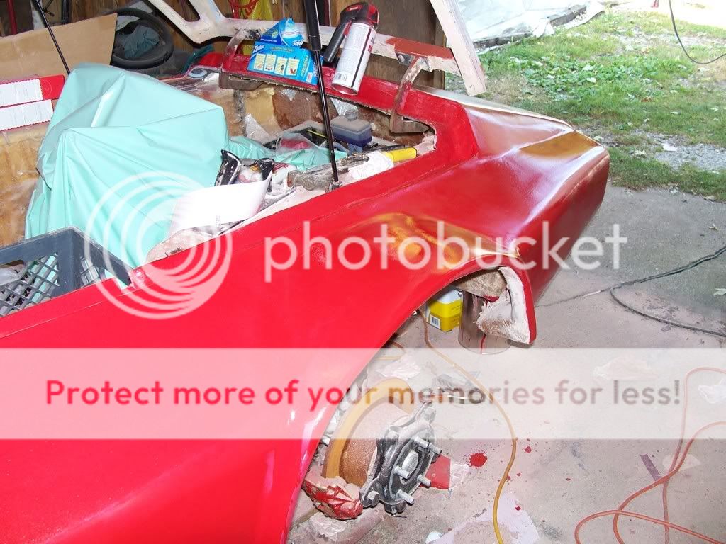

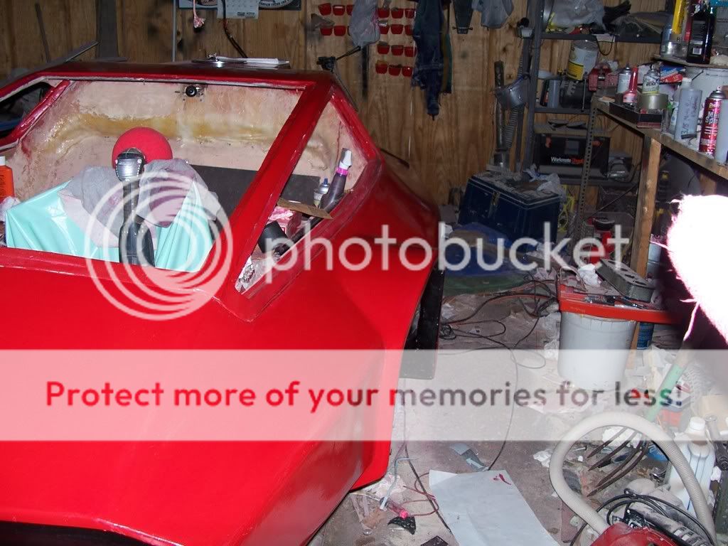

Well this is what it looks like today
Still needs be finished it's like the endless project when you build stuff from scratch lol. It's powered by a Kawasaki LTD 1000j might still be quick definitely different. I don't own any normal cars the yellow one is a TVR and it was proffesionaly painted so kinda off topic.

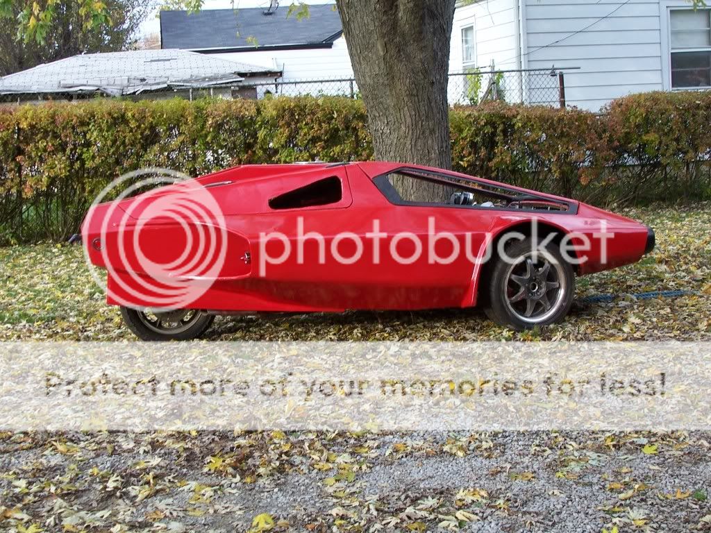

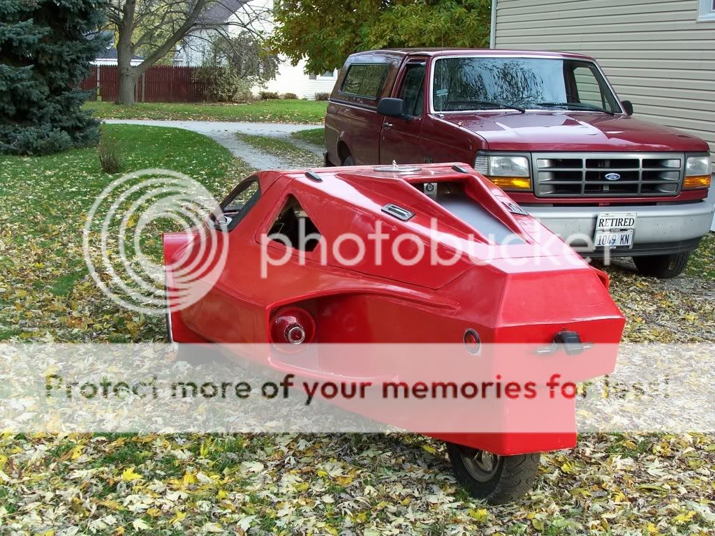

Post by trimagnum on October 25th 2009, 8:03 pm

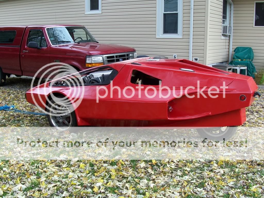

Well it's outside so I took a few pics . I needed the shed to bring the TVR home . It's getting traded for a pair of Crosleys if it works out.
It's not lookin too bad the taillights are a mix of 63 Ford 59 Caddie then it's on to windows carpet and lights

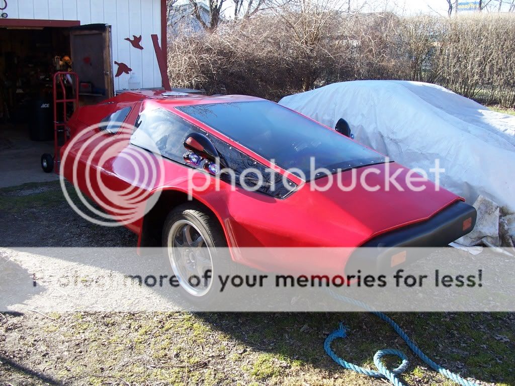

Post by trimagnum on January 25th 2010, 2:42 pm
Well now it has windows and lights . It was stored outside and the paint took a mild beating from the tarps . It bubbled up but when you heat the bubbles they go back smooth. I bet something on the tarps got to the paint.

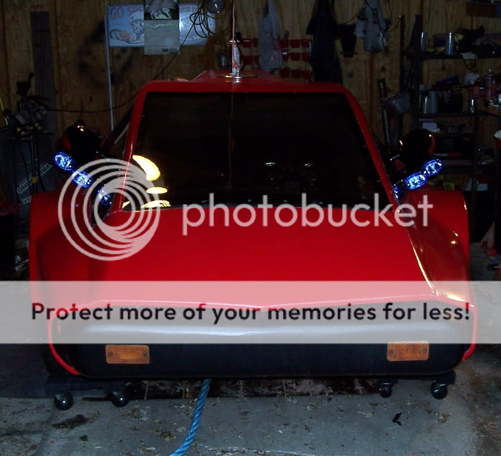

Post by trimagnum on March 15th 2010, 2:48 am
Well it's a wrap . The insurance cards are coming and it's time to drive!
