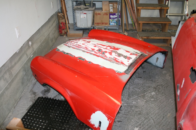

Update as well as advice needed
Liberated riveted scoop from hood
Underside of hood has rubberized paint... what should I do with it Sand it all down or paint right over it?

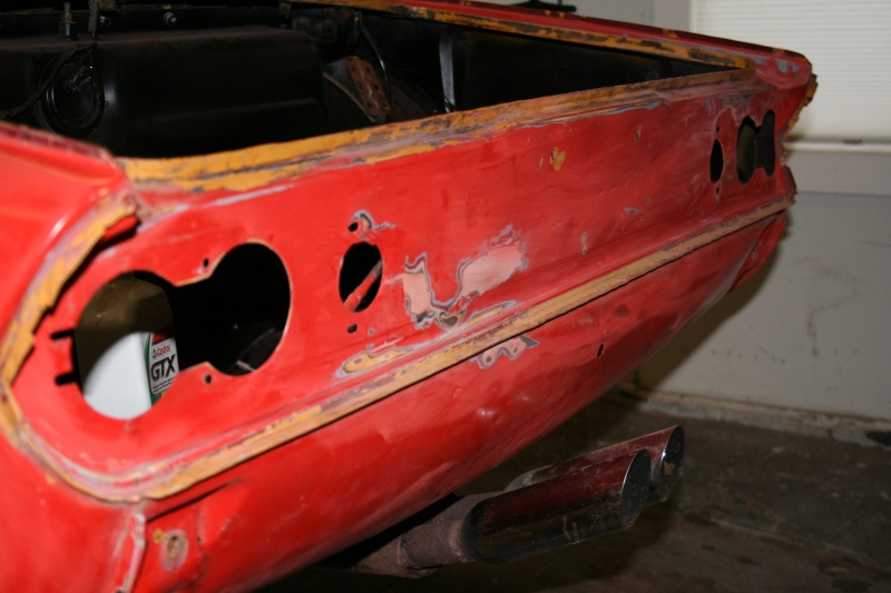

Another dooozy...
Not sure what I can do with this. Any advice?

Re: 1971 Triumph Spit6 Project - Introduction
form a piece for it, then cut it out and weld the patch in, or use panel bonding adhesive.
2.3turbo- Rank
- Number of posts: 1
Age: 33
Registration date: 2009-03-06
What 2.3 turbo said. Nothing else will work for that. Go to the wrecking yard and try to find a fender with the same curves and get it. That will save you a lot of headaches. Then cut away the bad metal and cut the jy fender 1in bigger all the way around and glue it on. They make a flanging tool that puts a recessed step in the parent metal so the added piece is flush. I say glue because you don't have to mess with welding distortion and this panel is not a stress bearing area. You also will want to address the inner rust also.
If the rubberized stuff is adhearing well I would just wash it down real good witk laquer thinner and see if it will scuff a bit with sandpaper and then paint it
retired plumber- 800+ Poster!
- Number of posts: 968
You could use por 15 on the uderside of hood or get some undercoat in a can so it will be nice an black again. ?
