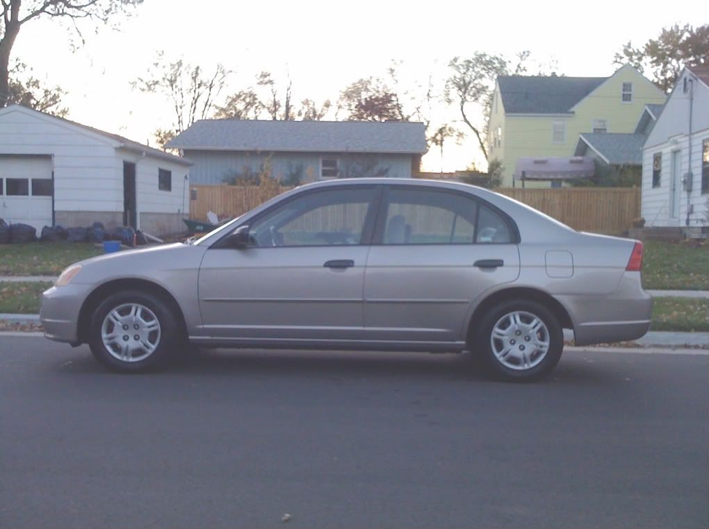

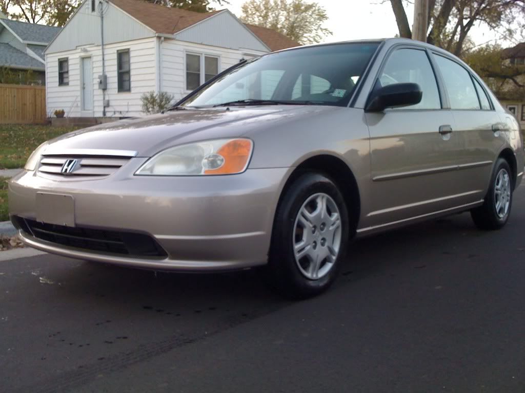

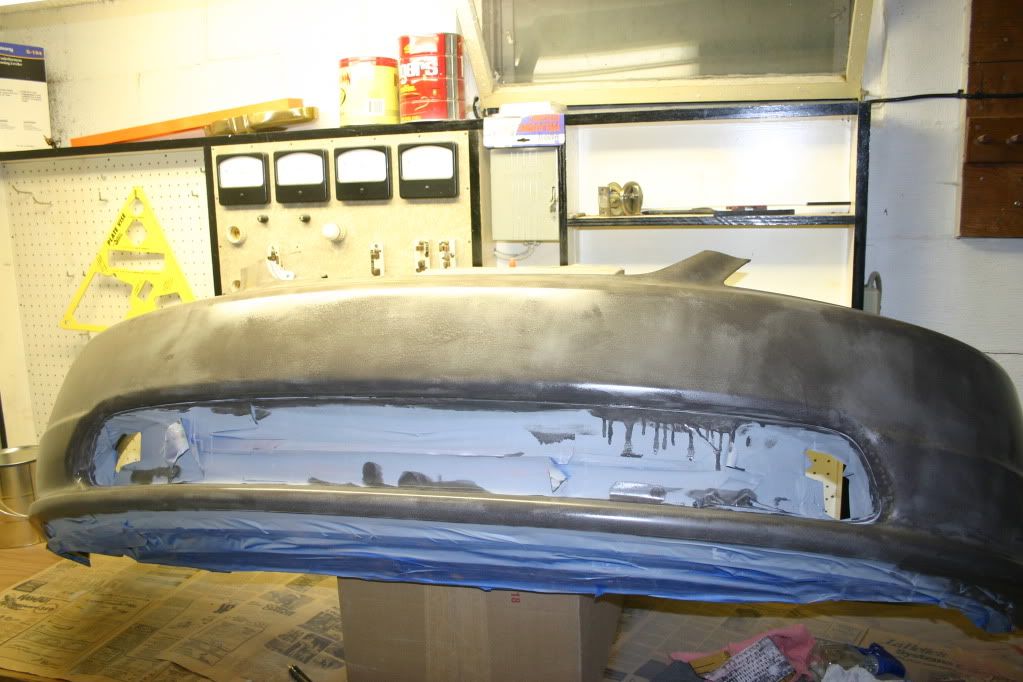

I am about to "roll" my 2001 civic (below for pics). I've seen some excellent results here and am hoping to have a good outcome as well.
I am thinking of going white or black at the moment...don't want anything too flashy.

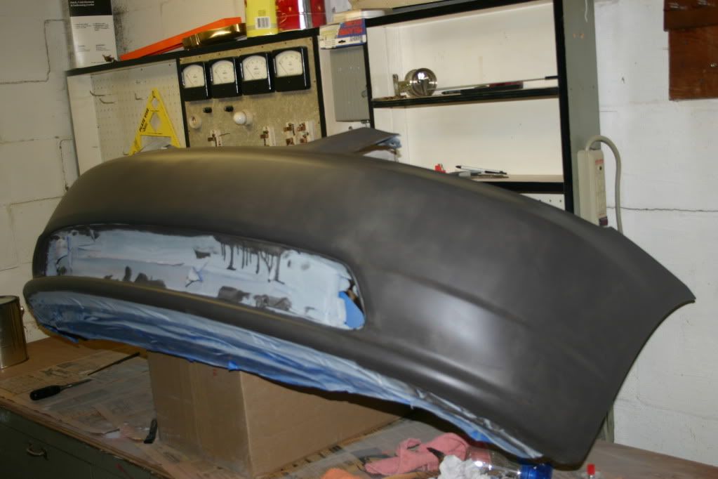

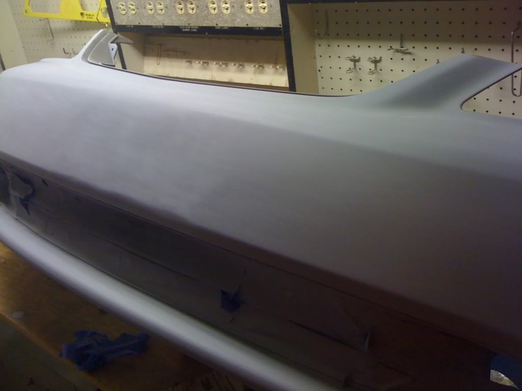

So far, I've pulled the bumper off. I have sparyed several coats of "sandable primer" and wet-sanded with 400 grit paper.
I think I'm gonna need to recoat the whole bumper again because I'm getting some bare spots.
Should I use a roll on primer instead of a rattle-can primer???
Please feel free to comment.

Re: 2001 Civic - about to take the plunge
Post by RoboGeek on November 29th 2009, 7:22 pm
I sprayed my primer.. but I used the rusty metal rustoleum because .. well.. I had rusty metal!.
I rolled on primer on my hood and upper body areas - mainly because I wanted it to fill in rock chips and where the clear coat failure made the surface rough
So I'd say use what work right in each area. Some areas its much easier to spray - like inside wheelwells

Thanks for the tip. I have some rock chips as well, so I'll try out the roll on primer.

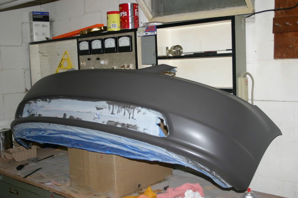

Looks like you're coming right along. One thing that I do when applying primer, after your done with the 400 grit, filling chips and so on, right before I apply color I prime one more time (spray) and lightly sand with a green scotch brite pad. This leaves a nice surface for the paint to "grab"ahold of. Again there are many ways to paint a car, and everyone has there own method, this is one of mine. Keep the pics coming and good luck.

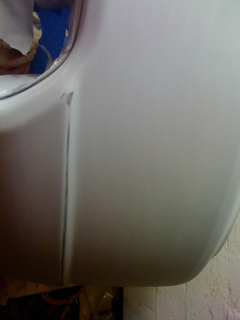

For your rock chips you could fill them with polyester glase. It comes in a tube and is made especially for that. Get it at the auto parts store.
Post by BlackNDecker on November 30th 2009, 9:25 pm
I got some glaze and filled in the rock chips. I assume it's OK to glaze over primer??? I will prime over the glaze as well...

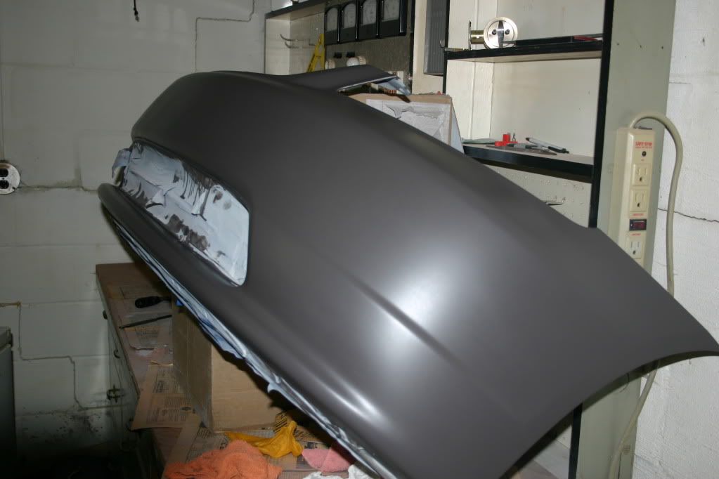

Post by BlackNDecker on December 7th 2009, 11:33 pm
I finally chose a color. This was the inspiration:
Found a really close match. Rust-oleum FTW...
First coat...
Two coats...
Dry sanded Shocked with 600 grit...then coats three and four:
Post by RoboGeek on December 8th 2009, 9:24 am
the fun begins!!! w00t!

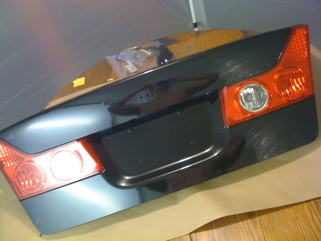

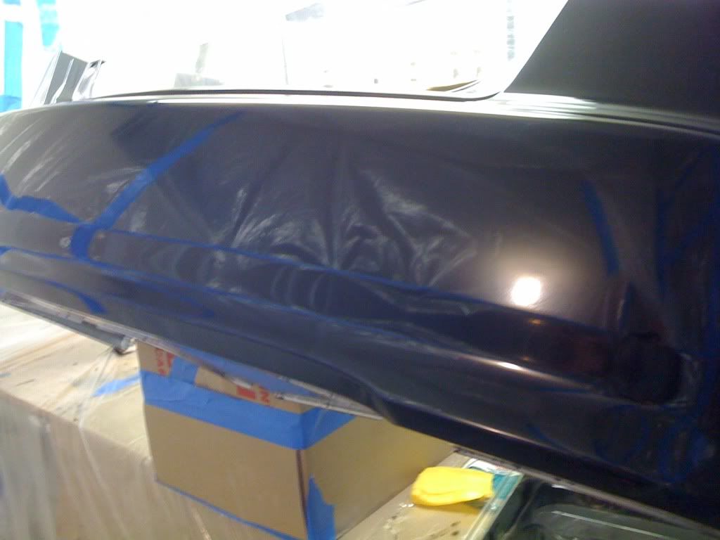

Took a new direction with the paint. Decided to go gloss black...the paint surface was too fragile with the semi-gloss. Every light scrape left a mark.
So...I purchased a gallon of Rust-Oleum "Professional" Gloss Black and mixed it 1:1 with paint thinner.

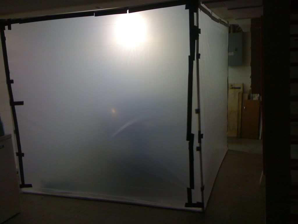

I also constructed a paint booth out of PVC and plastic:
Here is the rear bumper:
Here is my reflection in the rear bumper:
Here is a shot of the trunk lid:
Compared to the OEM paint job:
BlackNDecker
Registration date : 2009-11-29
Post by retired plumber on February 10th 2010, 9:21 pm
That looks nice. How many coats and is it buffed out? anyway, looks to have a pretty good shine as is.

Looks really good. Good shine. I would like to see what the semi-gloss bronze would look like with a gloss clear sprayed over it.

retired plumber wrote:That looks nice. How many coats and is it buffed out? anyway, looks to have a pretty good shine as is.
mike
Sorry for the late response...been painting the fenders and hood.
I put around 8-10 coats...with wet sanding between every 2-3 coats. I stopped painting when the desired smoothness was achieved.
I haven't buffed anything out yet...I was gonna reassemble the whole car and then buff it all out at once. I'm actually scared I'll mess it up when I buff it out...hate to mess up all this work:naw:

If you do mess up a spot when buffing its not the end of the world you know. Just put a bit more paint on the spot, let it dry and buff again. Thats the neat thing about going without clear because you can fix spots without doing the whole panel.
