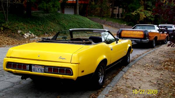

I have used this method on several cars now, Two complete, a third almost finished and just starting on a forth, On another car I removed the old vinyl top and used the rolled on method on it.
My 1973 Ranchero Squire Cobra Jet. I painted this one three years ago, The body color is a mix of Rust-Oleum gloss Dark Hunter Green and Gloss Black.
The wood grain is a base coat of Rust-Oleum satin Summer Squash and topped off with MinWax Polyshades stain. I live in the Mountains above the snow line and I do not have any covered parking. The Rust-Oleum paint has been holding up well through the Winters.

November 29,2009
My 1973 Cougar Convertible I painted last year just before winter with Rust-Oleum Gloss Sunburst Yellow and Gloss Black.

Thank you both for the welcome, I have no real secrets to using this method. I like many others originally found out about this painting method from the Mopar board and just like many others I was not sure about how it would come out. I had never painted a car before but I had done my own prep work before and knew that any paint job is only going to be as good as the surface preparation that is under the finish paint. I practiced my roller technique and paint consistency on a few spare parts before applying it to a car. I also prefer to paint one section at a time, I feel I have more control over the quality of the finish that way and I don't end up rushing myself running around the entire car making sure everything is smooth and even before the paint dries. I find it is less overwhelming one section at a time.
As for the Woodgrain finish, I found this process to be just as easy as the roll on paint. I had originally planed on just woodgraining the surround trim and applying new vinyl woodgrain to inside the trim, but after finding it so easy to to grain the trim I decided to try and woodgrain the side panels myself and if I did not like the results I could always just use the vinyl woodgrain siding. Not only did I like the results I like it much better than the look of the darker vinyl woodgrain. Although it is possible to paint the woodgrain to have the dark brown finish of the Vinyl woodgrain, but I prefer the lighter looking grain. The only real tips I have on this process is to use good quality nylon brushes when applying the stain over the paint. The cheap brushes will shed bristles on the surface you are applying the stain to. Feel free to ask any questions about applying paint or stain, I just don't know what has been covered already in other postings.
I find that both the roll on paint process and the woodgraining process to be very easy, inexpensive, and produce good quality results.

I sanded the surface smooth and applied a base coat of Rust-Oleum Summer Squash satin which is a light yellow color. To create the grain I applied Minwax Polyshades stain over the base coat with nylon bristle brush creating the grain appearance with the movement of the brush.
