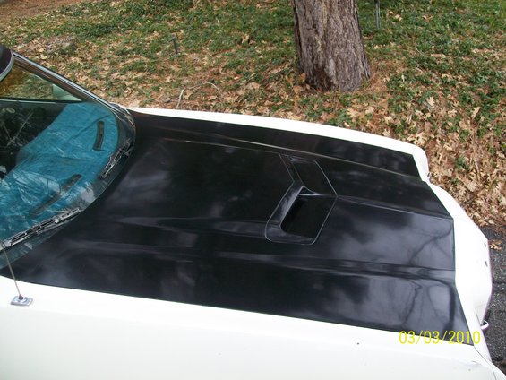

The reflection I am referring to looks like unevenness and smugges in the paint when in reality they are the reflection and shadows of the trees above. The only spot I am aware of any orange peel is in the upper corner of the hood and that is because I did not fully sand it out of the original paint which had some orange peel in it. When I get to painting the entire car I plan to address those corners. Where do think you see orange peel?
Re: Roll on paint plus Wood grain finish
Post by retired plumber on March 6th 2010, 3:14 pm
Maybe I'm seeing things. I agree it is shiny but the reflections on the right side and right front corner look blury to me. However, camera angle and lighting play tricks and I may be wrong. If you are happy with it , that is what counts.
Post by RoboGeek on March 6th 2010, 6:33 pm
it looks blurry to me too. Maybe its the topside paint?

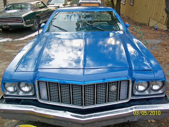

It is hard to get good photos of black. Here are a few more, the last one is a close up but it started snowing again which is why all the spots. When the weather clears again I will try to get some better shots.

Here are the latest on my brothers Ranchero.
So far I have been able to do 12 coats on the hood and cab, while getting 8 coats on the rear quarter panels and 7 coats on the doors and front fenders. I am stopping at twelve coats on the top surfaces and will be stopping at 8 coats on the side panels. So, only one more coat on the doors and front fenders and then final wet sanding and polishing once the weather changes as it is snowing again.
Here it is as it sits after another dusting of snow. The weather has been crazy here lately, it will snow one day and the next couple days it will be sunny and 60 degrees then snow again.
That is not paint on the side view mirror, it is blue masking tape which is almost the same color as the Rust-Oleum Royal Blue.

How are you sanding the final coat? Are you using a sanding block? If not you need to. The close up picture has orange peel. It is shiny but the reflection is not clear and I don't mean the spots. It should be like you are looking into a mirror in that picture. Maybe the orange peel is in fact gone but you need to go over it some more with a polishing compound this time.
That also has an effect on the final finish. I usually color sand up to 1500 grit and then buff with a course grit compound lightly and then the fine compound. Occasionally it will still look kinda blury but a final buff with a foam pad and polishing compound almost always taks care of that. Go to http://www.meguiarsonline.com and look at some of the finishes there. Of course those are pros but it gives us lesser people something to shoot for Laughing

As for the Blue Ranchero, that is regular Rust-Oleum gloss Royal Blue, I have yer to do any final wet sanding or Polishing yet, I still have one more coat on the fender and doors to do then I will wet sand with 1500 and Polish. I think the Two tone turned out pretty good. It certainly looks much better than how it looked when it arrived here in mid January.

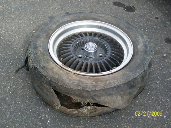

I feel pretty lucky I only ended up with a flat and a torn fender.
This picture was taken the day before the blowout.
Here is the damage

I am just glad to know about the old tire issues, I had always thought an old tire was one that was 15-20 years old with cracks in side walls, what I learned is, any tire over four years old regardless of wear is prone to blow out as a result of the tire braking down from the inside. From what I have been told and also later read is the newer tires are made with more environmentally friendly compounds that brake down much faster than the old compounds which will cause the tire come apart.

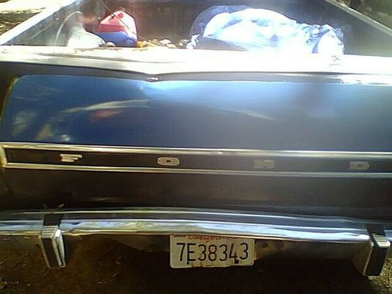

I have had a crazy 24 hours. Yesterday I went outside and found that an animal with claws had climbed onto the hood of my 1972 Ranchero GT 4 speed, the one I just painted Black. Being the car was parked on a steep driveway the animal must have been slipping around and scratched the hell out of the hood. So I sanded it down again and applied a coat yesterday and another one today, I think I will apply another two coats and evaluate at that time if it will need more.
As for my Brother's Ranchero. I finished applying the paint. 12 coats on the hood and cab and 8 coats on the side. While I am waiting for the paint to harden a little before final wet sanding and polish I installed some trim on the tailgate which required removing about 60 screws from the inner panel and cap in order to install the Ford Emblem. After I finished installing the Emblem on the Tailgate I decided I would install his bed cover for him today. While I was in the bed installing the mounting brackets for the bed cover the car slipped into gear while parked on the steep driveway and rolled back with me in the bed. I was lucky my 1973 Squire was parked in front of it otherwise I would have rolled down another 100 feet or so and across the street into a gully and ended up against an Oak tree. As for the car, the tailgate was down at the time it rolled and hit the rear bumper of My 1973 Squire. Myself and my Squire came through with no damage but the tailgate of my brother's Ranchero did not do so well. It appears the Column shifter on My brothers is a little loose and even with the parking brake engaged it still popped into gear and rolled backwards on the slope of the driveway. Well, here are a few pictures taken with a cell phone camera.
Tailgate coming to rest against bumper.
Damage to tailgate
Now I get to look for another tailgate and paint it.
