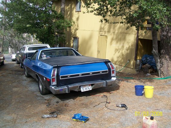

Well, I finished up on my brother's 1974 Ranchero GT. I had no luck finding a replacement tailgate, so until I do, I went ahead and pulled out the dent in the old one as best I could do. I do not have experience in dent pulling but I think I did alright with what I had to work with.
The top trim cap is still banged up but I got most of the damage out of the tailgate itself and used the can of touch up paint of the original color I found in the car to fill in around the top edge that had been damaged.
Here is the car after paint and polishing.

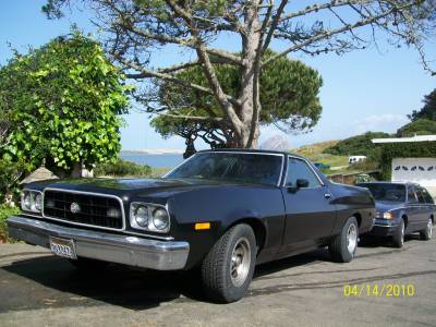

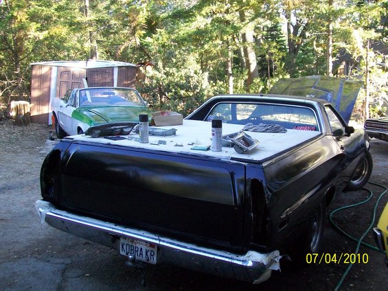

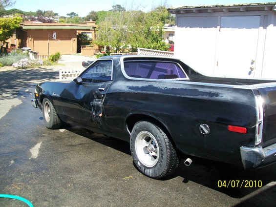

While visiting my Parents back in back in April and May I replaced a damaged door and repainted the 1973 Ranchero 500 Cobra Jet that belongs to the family that works for my parents.
Here is what it looked like after a neighbor backed into the driver door.

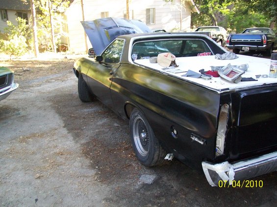

I replaced the door and painted it using 6 coats of rust-Oleum Gloss Black mixed with 50% Mineral spirits and then 6 coats of Rust-Oleum Topside Gloss Black mixed with 50% Mineral Spirits.
Here it is after 12 coats and before final wet sanding.
The son of the owner took the car out of town before I could get to the final wet sanding and polish.
Now I am back in town visiting my parents again and the owners son has come back into town so I have been able to start on the final wet sanding, polish and now that it has been a few months waxing as well.

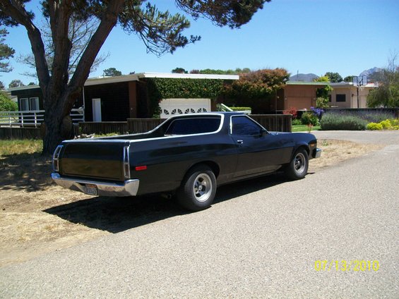

Here is the tailgate sanded, polished and waxed. I hope to get to finish the rest before I leave for home at the end of the week.

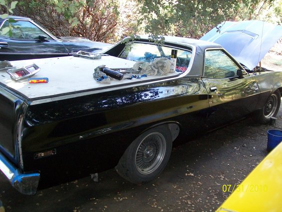

Post by Squire Cobra Jet on July 14th 2010, 2:13 am
Well. I got the passenger side polished and waxed, now I just need to do the top and the driver side.
Re: Roll on paint plus Wood grain finish
Post by Squire Cobra Jet on July 19th 2010, 3:25 am

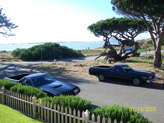

Here is a better picture of the Passenger side.

Post by Squire Cobra Jet on July 21st 2010, 5:13 pm

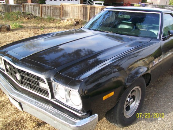

I finally was able to get to the driver side to finish it up. I had to do some touch up paint on the rear quarter panel so it did not get waxed.

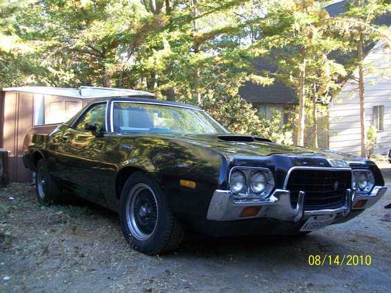

Post by Squire Cobra Jet on August 1st 2010, 2:57 am
I am back home and on to the next project.
I actually started this one before I went out of town, but now I am home to finish it.

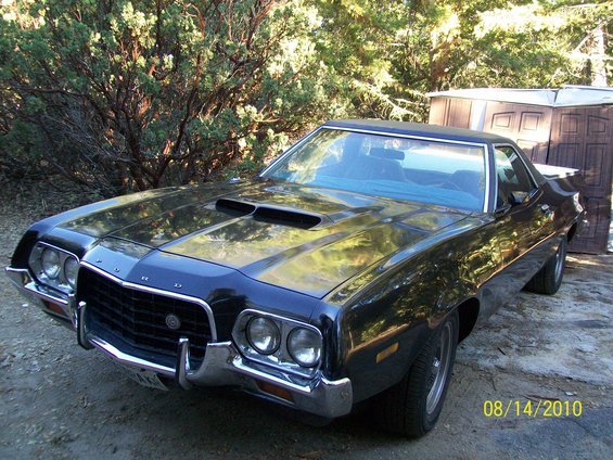

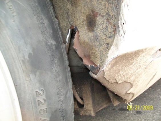

This is my 1972 Ranchero GT 4 speed Cobra Jet. I just rebuilt the engine so I thought it was time to address the body issues. The original hood I replaced because of rust around the edges and the replacement hood was going to need to be painted to match the car and then last year I had a blow out that damaged the driver side fender as well as there being a few other small dings that needed to be addressed.
Here is what the fender looked like after the blow out.
I was going to replace the fender, and when I went to pull it I decided to go ahead and see if I can pull out the part that folded completely under. To my surprise not only was I able to pull it back out I was able to repair it and reuse the fender.
I decided to switch from the White paint job that was on the car when I bought it to a gloss black finish.
The first eight coats were done with a 3-2-1 combination of Rust-Oleum Gloss Black, mineral spirits, and Penitrol. Original finish was wet sanded with 400 grit and then the car was wet sanded between every two coats. I start with 400 grit and progress up in grit to 600, 800, 1000, 1200, 1500, and a final wet sanding with 2000 before applying polish which brings out the shine.
I will over lap the progression in the use of the sand paper. The first wet sanding after new paint will be 400, the next sanding will be 400 followed by 600 and the next sanding will be 600 followed by 800 and so on.
Here is what it looked like after 6 coats.
After 8 coats I switched to using the Rust-Oleum Topside brand Gloss Black again mixed with 3 parts paint, 2 parts Mineral spirits, and 1 part Penitrol, which is a product that helps to prevent brush or roller marks in paint when it dries. The Topside brand has a higher gloss than the regular Rust-Oleum and also has U.V. protection. The topside cost more than the regular Rust-Oleum which is why I don't use it for all the coats.
Here it is after 10 coats.
Here it is after 14 coats and polish. I only have finished the passenger side rear quarter and door. The front fender is sanded waiting to be polished.
Here is a close up, that is the reflection of the Cyclone GT parked next to it.
I ran out of Polish and I will finish polishing it as soon as I get some more polish. I like using Meguiars Ultimate compound which I can't find on the Mountain and will have drive down the Mountain to get more. I also still have to do the door jams, bed and bed cover, and I am planing some stripes for the hood center and along the sides. I will post more photos as I progress.

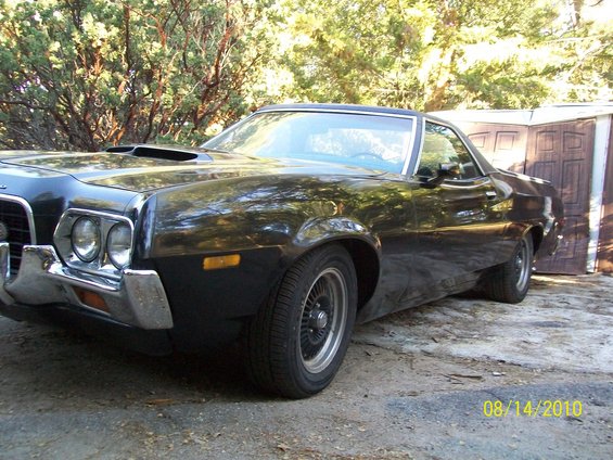

I still have not gone down the mountain yet to pick up some more Meguiar's Ultimate Compound.
I went ahead and collected the four other polishes I had on hand and tested them side by side on the hood. What I found was all four polishes seem to give different results, two left very cloudy finishes but did a very good job of leaving a clean smooth surface, one was less cloudy and had a better shine but did not do much in the way of cleaning the surface and the last polish I tested left a very clear finish and shine but also did not seem to do much in the way of cleaning like the first two polishes. All polishing was done by hand as my buffer is broken. I ended up finishing the polish job on the driver side and hood by going two rounds with the turtle wax polishing compound which seems to do the best job at cleaning the surface followed by one coat of Meguiar's Scratch X2, which did a good job at cleaning up minor surfaces scratches from sanding. Next I went with one coat of Meguiar's Deep Crystal polish which improved the clearness of the finish but not very glossy. the final coat of polish I applied was Duragloss 101 which really gave it a clear glossy finish.
None of these polishes would have done a very good job on their own but using them together I ended up with a decent finish. Meguiar's Ultimate compound which I used on the passenger side as well as other cars I have painted with a roller by far does the best job and better than all four of the other polishes I used to finish the job. What I might do in the future is use the Turtle Wax polishing compound for the first go around and then finish up with the Meguiar's Ultimate compound.
I went out to take more picture of the completed polish job and the batteries went out on my camera, so I ended up taking some pictures with my cell phone which does not take very good pictures. I will post the cell phone pictures now and take some better ones with my camera as soon as I pick up some new batteries.
Close up reflection on door.

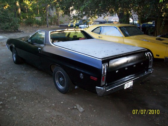

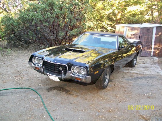

Post by Squire Cobra Jet on August 15th 2010, 10:10 pm
I picked up some new batteries for my camera and here are some new pictures. I still have to paint the bed and cover ans well as I plan on side and hood stripes, but I am going to wait a few weeks before applying the stripes.
