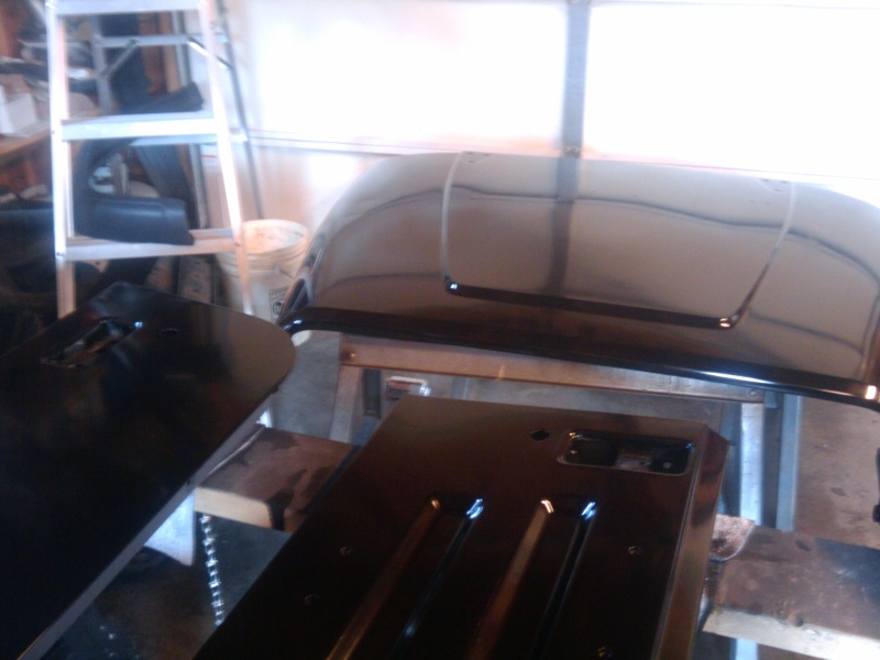

More photos after "3 1/2" coats! I wet sanded the lint out. I ended up grounding the jeep and other parts with chain to it did seem to help with my lint problem...Thanks to everyone for the suggestion!
I'm going to post these photos and get back to work on a couple rusty "under the Jeep" parts that I would like to clean up while I wait for the paint to dry....it is going to be a little warmer today, so I may get 2 coats on it.
I will say that I have 100% coverage after 4 coats with no real orange peal, but keep in mind that the Jeep was primered dark gray.
Enjoy the photos, many more to come

yup.. I remember that dull orange peel look! Thats gonna look good all sanded - and jeeps are easy cuz they are so flat. You'll be able to get it looking like a mirror.
Are you using any hardener?

I am not using any hardner. I have time so wait between coats and sanding so it is not a problem...but I do plan on putting it back together this Sunday. I am going to just apply the final 2 coats and drive it to Vegas, I will sand and polish after it has been out in the sun for a month or so.

Quick question.... I wet sanded down the doors and fenders to get the lint out after only one coat (with 3 under it), the rest of the Jeep looked great. But now I only have one coat on these parts and 2 of the rest of the Jeep. Should I just put one more coat on the whole jeep and wet sand so I do not have a blending problem or just paint the parts with one coat? I'm sure it is not going to make a big difference either way but wanted to get feedback. Thanks!

I think its always best to have the same amount of paint everywhere. That way , when you sand and buff it will all look the same. If there is less paint in some areas you have a chance of going through a couple of coats and ending up with that part looking "mottled"(sp).

I finished the 5th coat and it is looking good. A little grey haze in it, but that should come out with the polish. My plan is to do one more coat, wet with 1500 then 2 more coats and drive it to Vegas and let it bake in the sun for 30 days....do you guys think it will be ok to leave the last 2 coats on without sanding for 30 days and to drive it 2700 miles? It will sit for about 2 weeks before the trip

No problem. Just make sure you take any tape off.
