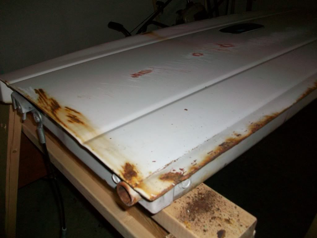

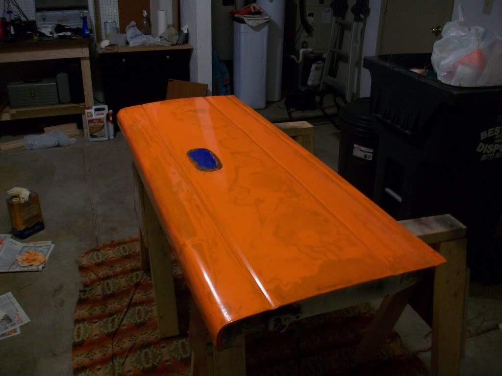

I am going to post some pics of my tail gate. I have done five coats so far. I don't know if I am thinning the paint too much because I am not getting good coverage. I thought I was going to see coverage after 4 or 5 coats.
Here is what I started with.
I dropped the tailgate while driving down the interstate at about 70 mph. It was late at night and when I looked in my rear view mirror, all I saw was a shower of sparks...(the most majestic thing I ever saw!). Anyway, this is what I am left with a year later.
Here it is prepped.
Here is the third coat of paint. The 4th and 5th coats don't cover any more. (messy garage)
The paint is very smooth and extremely hard. Am I applying the paint too thin?

Might be a little thin, but because of the color change I would have primered it all to start with one color

looks great! love the orange.
