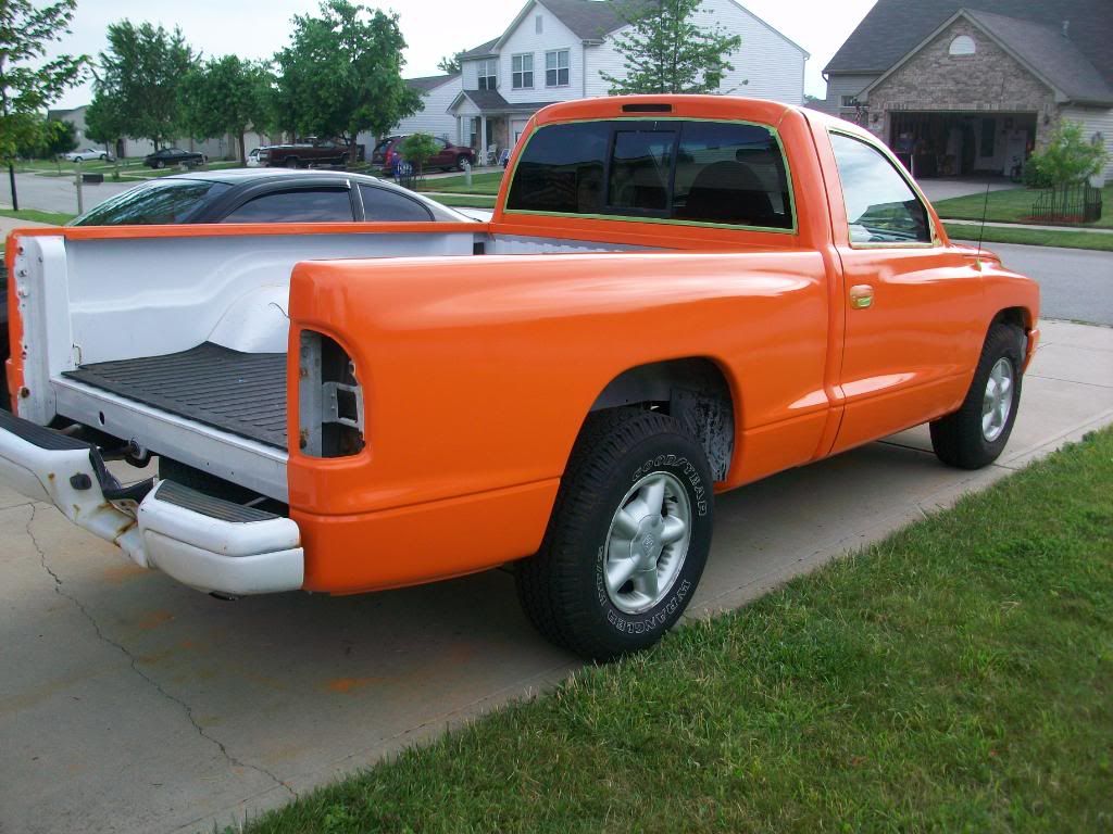

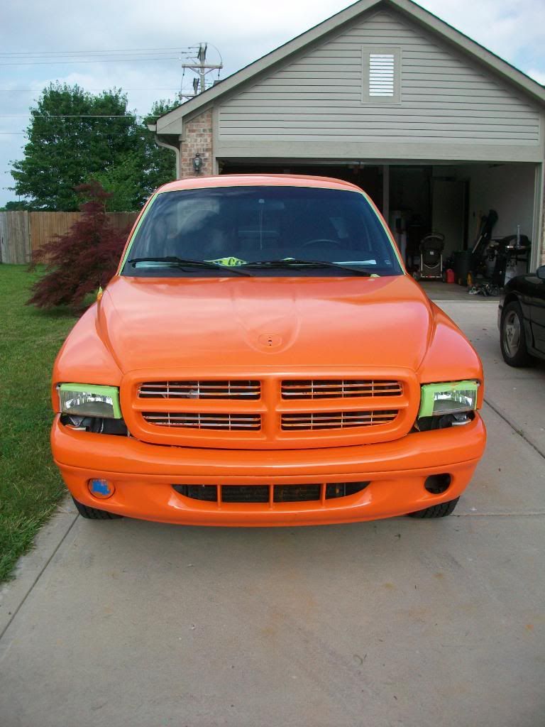

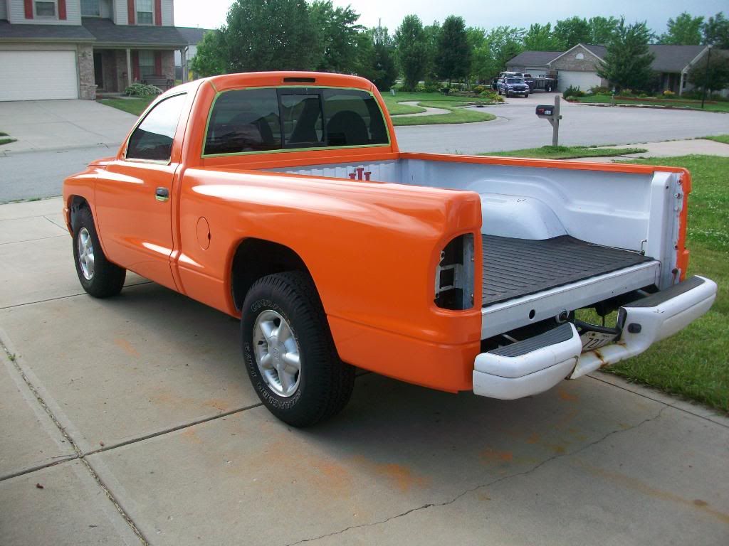

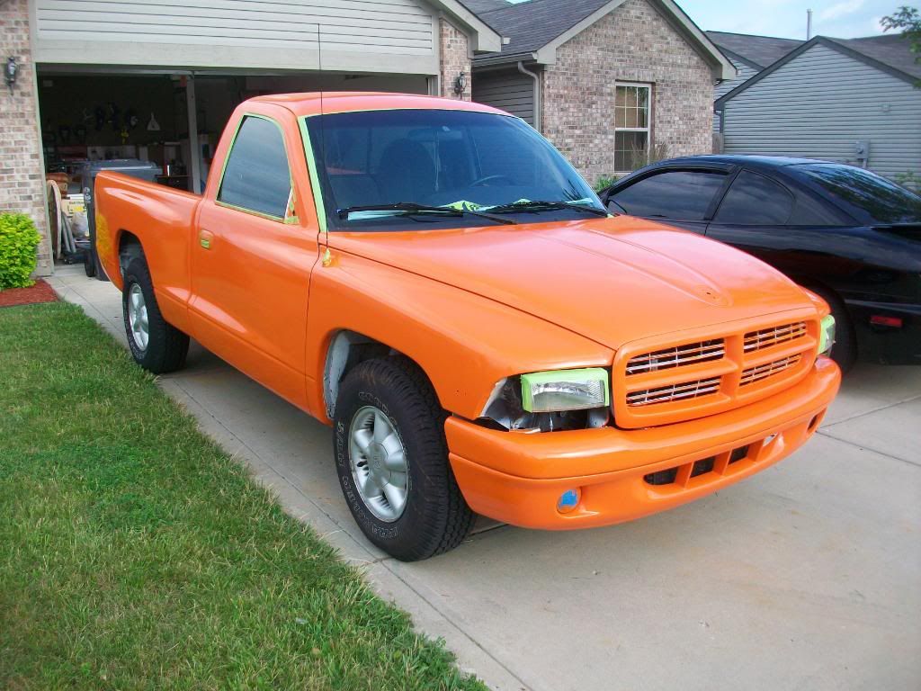

Here we go! I've got pics of the 5th coat of paint. I am really impressed! The pictures don't really do the paint job any justice. I almost don't need to sand and buff. It looks that good.
I have a few problems though. Around the places that I have taped off (i.e. door handles, windows etc.) there are some runs and I don't know how I am going to fix that but I'll get to it when the time comes. Anyway, here are the pics.
Thanks for looking!!

An old painters trick is to put tape on each side of the run and then shave it down with a old style safety razor untill you are level with the tape. the tape protects the surrounding paint and since the razor blade extends out over the tape, it can't go to low. Then very carefully sand it down smooth with 2000 grit on a hard sanding block. Takes patience but I know it works because I have done it.
By the way, the truck is looking NICE.

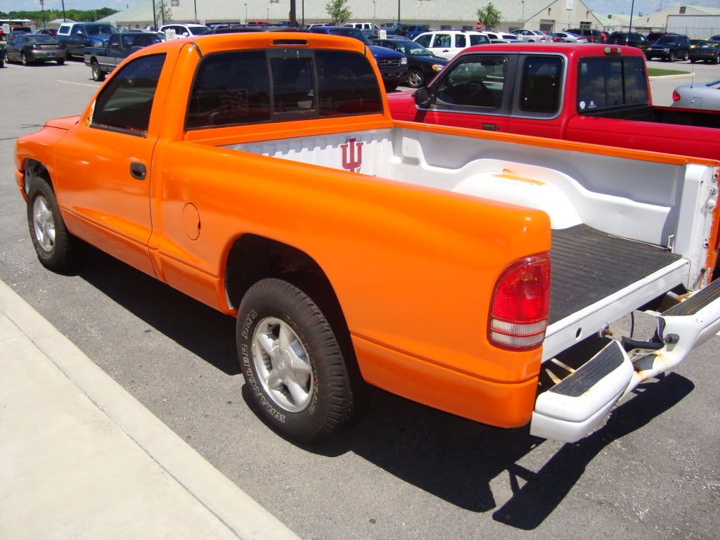

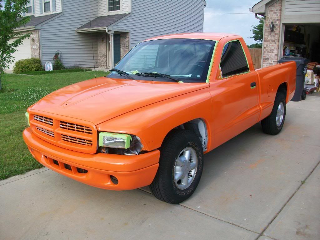

Okay, I didn't take pictures of the 6th coat because it rained like crazy here. I couldn't get my truck out of the garage. I did get some sunshine today so I took pictures of the 7th, and hopefully final, coat. The truck looks really good from 5 feet away; however, it has some orange peel and runs but I will hopefully get most of it out with the final wetsanding. Here are the pictures of the final coat.
Thanks for looking!

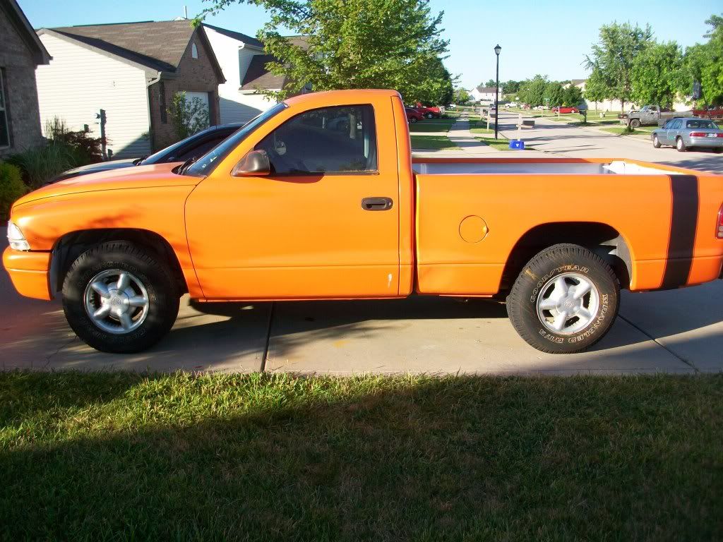

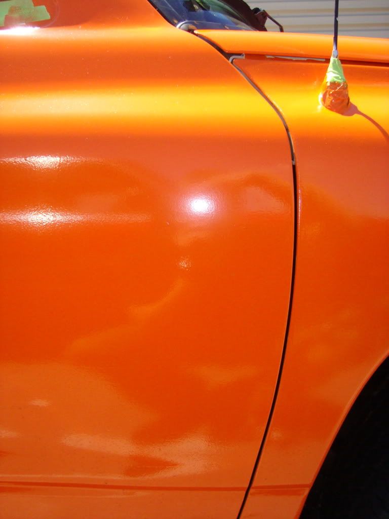

Last night I spent about an hour wetsanding the driver's side. I didn't go any further than the bed of the truck. Today I look at it and it seems that I need to do a little more sanding though. I still have a few roller lines and I found one drip that I need to address. Other than that it looks really good though. I am happy with the results so far. I am trying to get the bed of the truck done so that I can paint the flat black stripes. The stripes will dress the truck up nice.
Tonight I will hopefully get the other side done, and then on to the stripes.

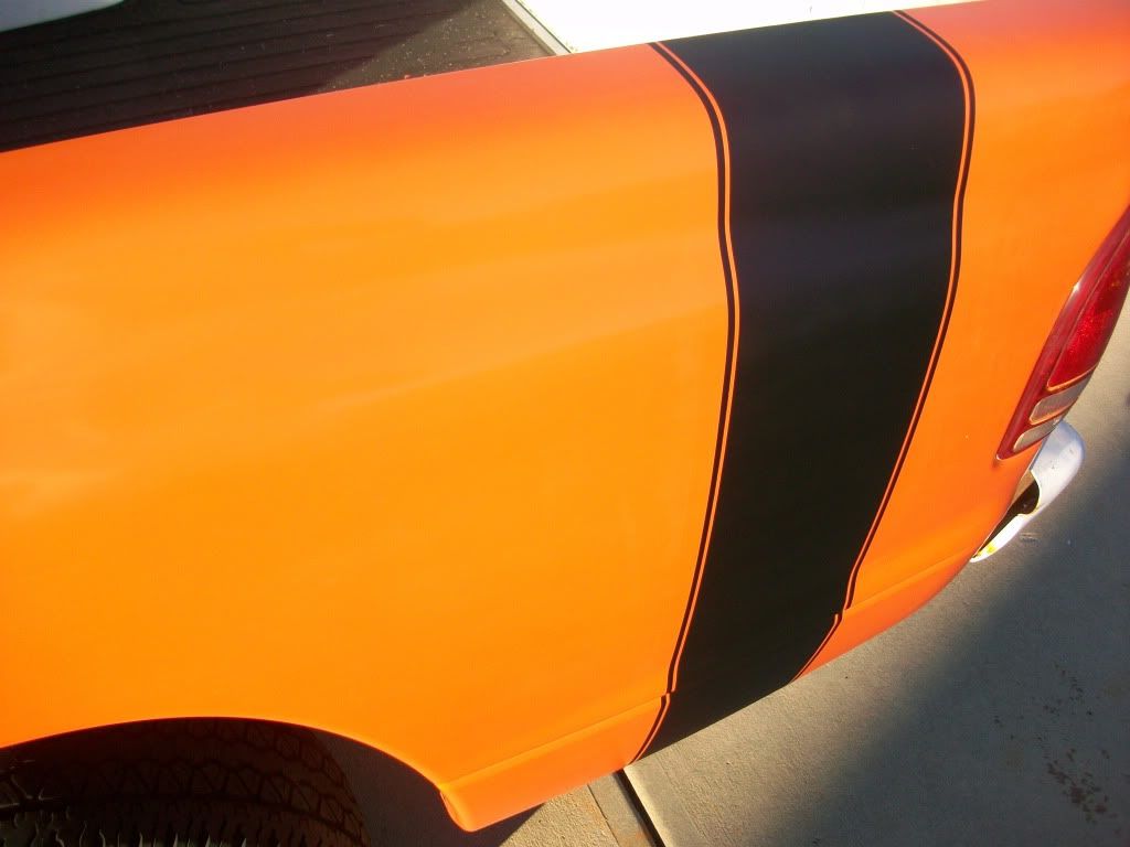

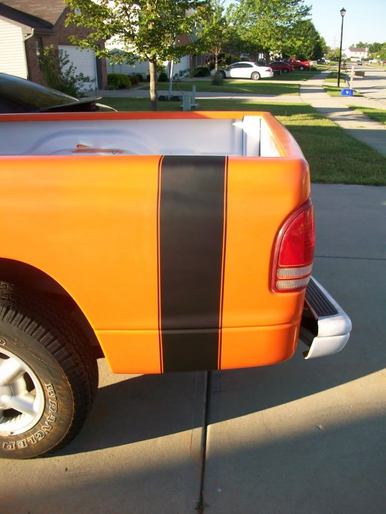

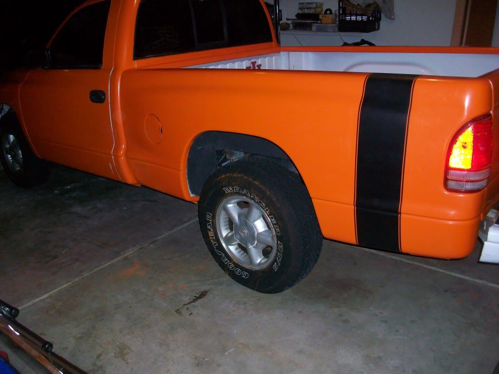

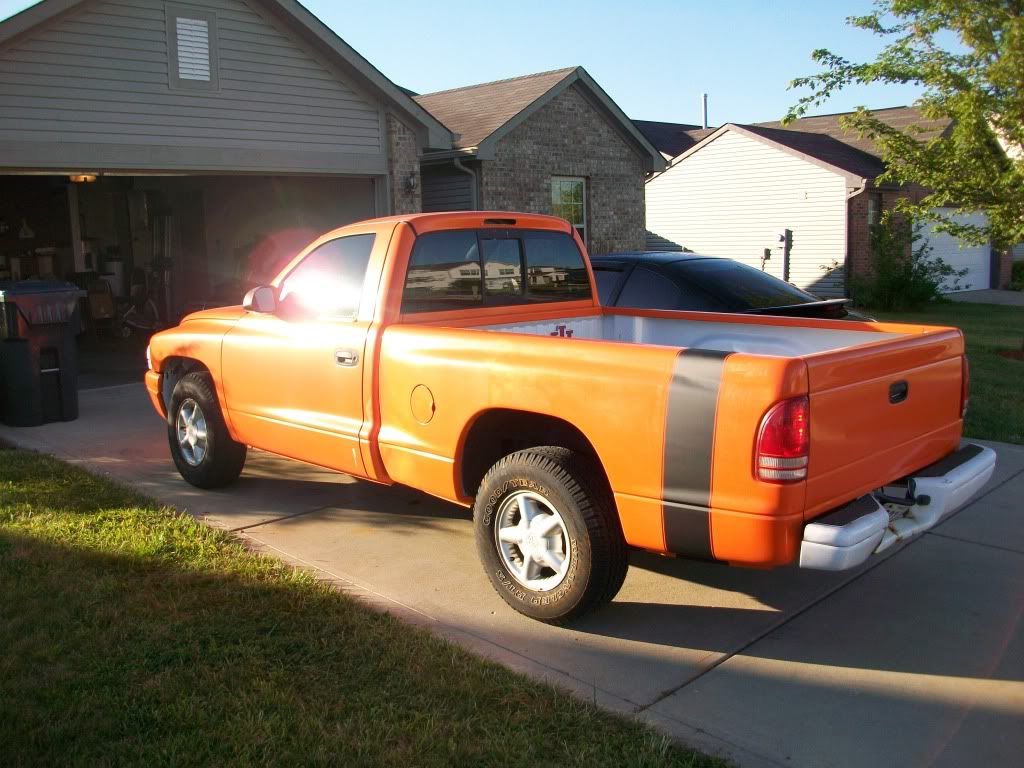

I spent about 20 minutes last night trying to get the dent out. When I look at it during the day time, it doesn't look as bad as I thought. It is only a dent and the paint didn't chip at all. So I started sanding and buffing on the back half of the bed of the truck. I sanded briefly on the dent and all the smudges went away. So if I can get the dent out without having to do body work then I will be fine.
I wanted to bring my spirits up last night. So I started applying the stripes. I sanded and buffed the back half of the bed of my truck. I cleaned it and laid down the first stripe. It appears to be slightly off from vertical but I think it is just the pictures because when I look at it outside it looks really good. The only thing that I would change is I would have made the pin stripe and the space between the pin stripe and main stripe wider. It still turned out really good though. I put two coats on last night with a rattle can and it turned out really good. NOTE: you can see the dent on the lower rear quarter just behind the driver's side door at the very bottom.

Re: 1998 Dodge Dakota Sport 3.9L V6
Post by JimVonBaden on July 2nd 2010, 2:52 pm
That looks great!
IF you wanted to make the two outside stripes a little wider, maybe double their current width, that might look good. On the other hand it looks nice the way it is!
Bummer about the damage! Good thing is that you can fix the dents and blend it in and it wont show!

Post by JohnnyV on July 2nd 2010, 5:24 pm
JimVonBaden wrote:That looks great!
Jim Cool
I like the stripes. They turned out really good but from a distance, the pin stripes kind of blend in. Had I known that would happen I would have made them a little wider. Just more sanding and buffing to go now before I cab call this project done.
Post by T.Hadley on July 2nd 2010, 9:23 pm
Sorry to hear about the damage, but it don't look to bad.
Like-en the stripe...
Post by Squire Cobra Jet on July 3rd 2010, 12:42 am
Looks good, and nice job on the stripe. thumbs up
Post by sinformant on July 3rd 2010, 9:22 pm
paint and stripe look really good! only thing i would have done different, is i would have layed down the one stripe where you have that one and then peeled up the pin stripe toward the back and then layed down another flush with the other stripe further back to make it a wider stripe like they have on the newer dodge ram daytona's. but that's my opinion and people have different tastes.
