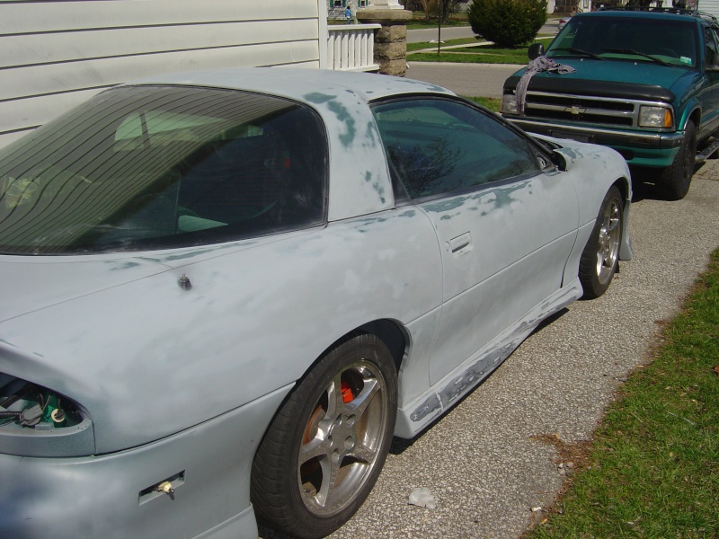

Hi everybody, I have been trying to get my car repainted since my car got keyed. Well My ex did not like what the judge had to say really. anyways I work on the car a lot and wanted a paint job that I could do and maintain. after looking at the price to get the color changed to what I want for once in my life. I could just not see spending 5K+ on a paint job that is going to get scratched anyways. not to mention I just like the look of the old enamel jobs better than the clear coat base coat. besides this leaves me more money for go fast parts! I will update this thread as I get more progress done to it!
this is my brother's car nose to nose with mine depending how mine turns out he will do his the same way.
more random pics of it getting primed and sanded smooth.

looks like its nearly ready for some paint!!

there was so much orange peel in the factory paint that I need to put at least two more coats of primer to make it nice and smooth. you should have seen after the first round of primer and sanding it looked like green and gray marble!
