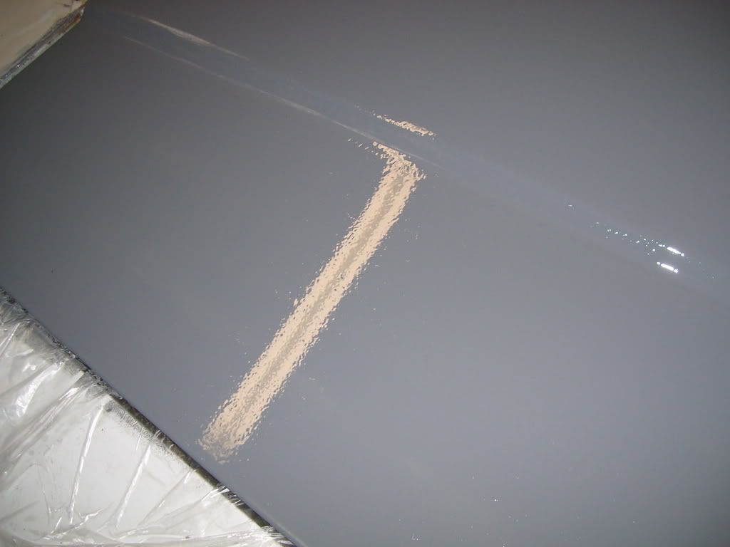

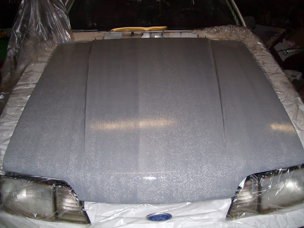

Post by coreyd on December 21st 2007, 11:40 pm
Just put the first coat on the hood, just testin out the color. I really think im gonna like it. It has a lot of bubbles in it but i guess that is normal from the mineral spirits thinning it so much. I mixed 2:1 (paint to thinner)
i may mix 3:1 on the 3rd and fourth. Have to see haw the 2nd turns out. I will post pics as soon as i get done.

Are you dry rolling? That will pop most of the bubbles. The rest will pop while it dries.

Post by coreyd on December 23rd 2007, 1:25 pm
1st and 2nd coat, got a lot of bubbles

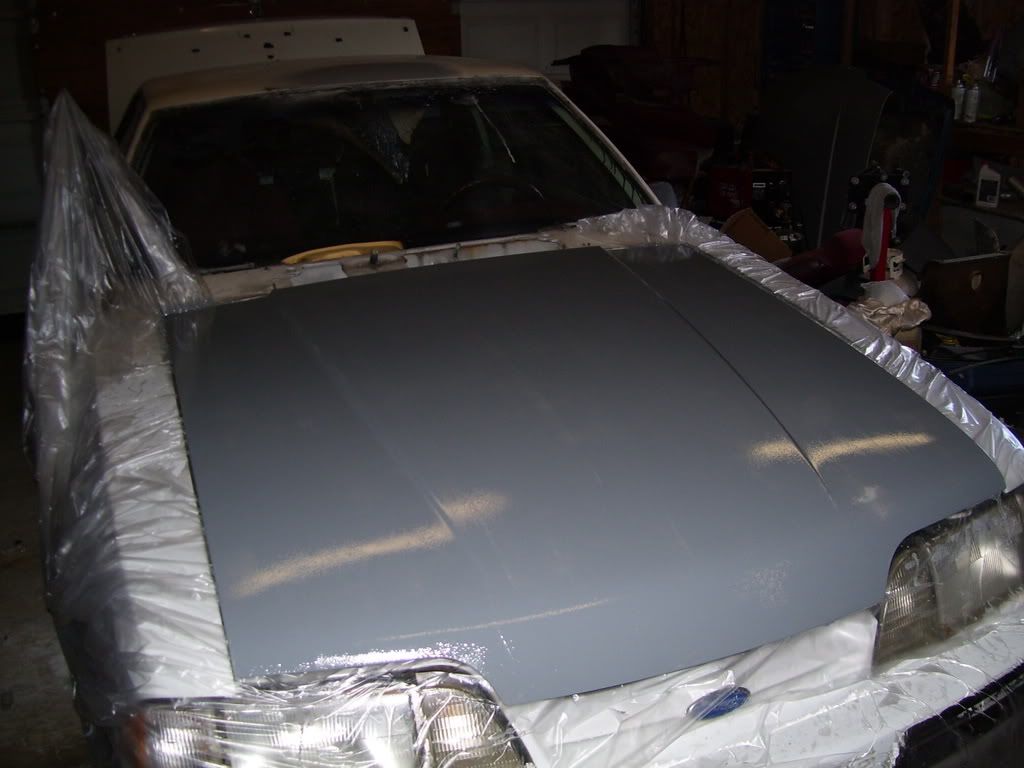

Post by coreyd on December 23rd 2007, 1:27 pm
3rd and 4th coats were better but took longer to dry with 3:1 mix

Post by tzyoung on December 23rd 2007, 2:31 pm
Just wanted to say... Looking good thumbs up thumbs up . Looks like you got this rolling thing down pat. I think the grey looks much better than the white paint jobs I have seen. Now do the rest of the car and post pictures so we can all drool.

Post by coreyd on December 23rd 2007, 9:57 pm
I wasnt happy with the turn out of the 3rd and 4th coat, so i wet sanded until the paint was completly smothed out which took quite a bit of paint off. But i switched back to 2:1 on the 5th and sixth coat, waiting for the sixth to dry now.

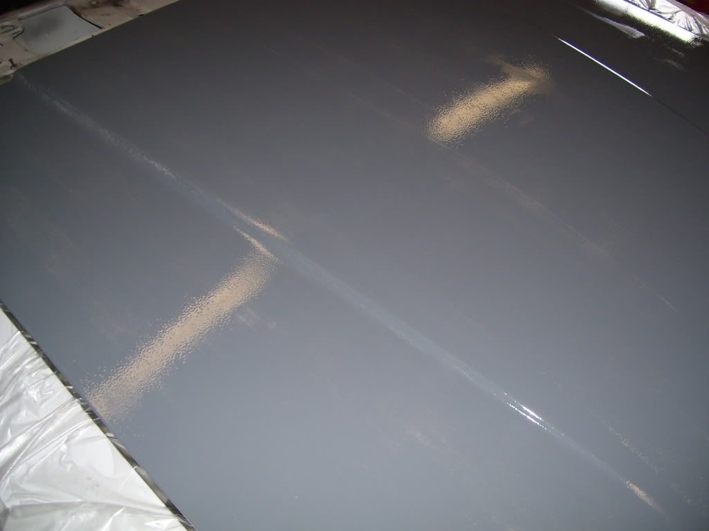

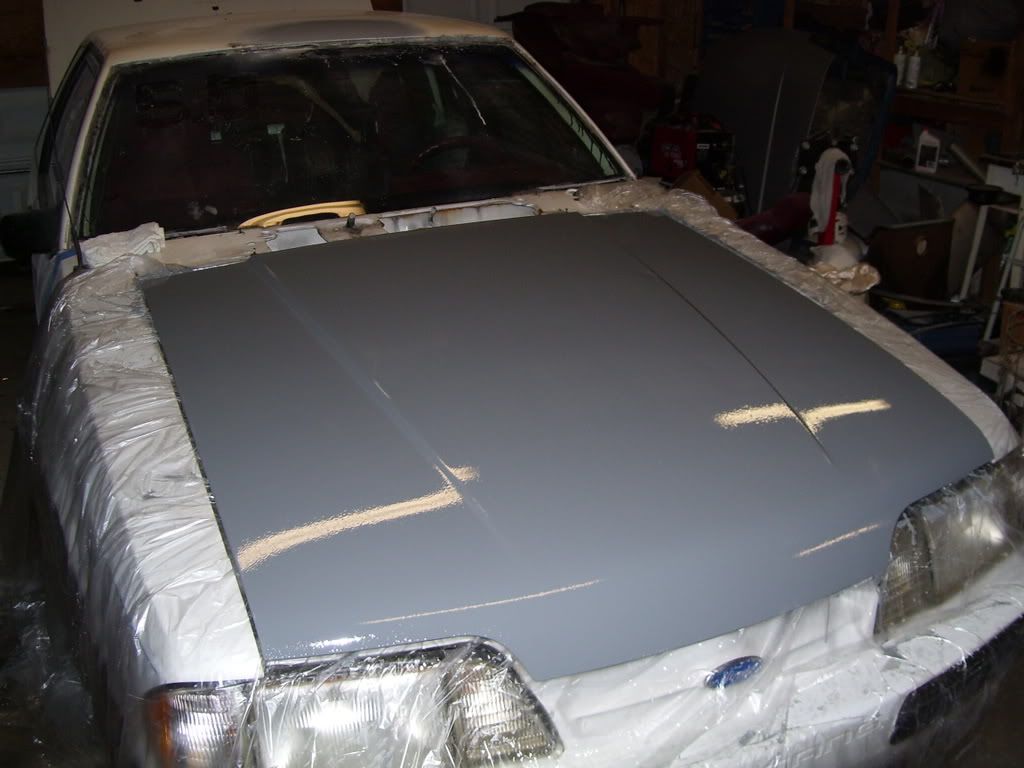

Post by coreyd on December 24th 2007, 6:58 pm
Wow, 1:1 is so slick its not even funny
coreyd
Number of posts : 71
Registration date : 2007-12-16
Re: 93 mustang project
Post by coreyd on December 24th 2007, 6:59 pm
this is the 5th coat

Post by dumkopf on December 25th 2007, 12:12 am
Shocked In the last picture it looks really slick. In the other pics however it looks like a whole lotta peel. I don't get it.
