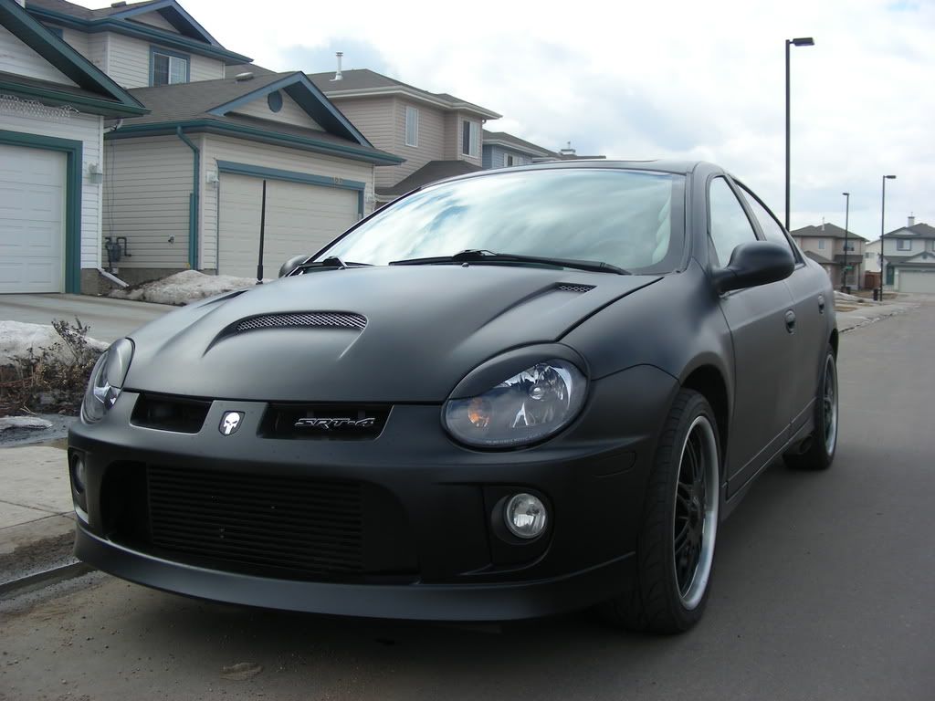

Yup, I am spraying my replacement hood with ACE Rust Stop satin black. Just finished my first coat and I have a BUGTRAGEDY. Did not want to spray in the direct sun, but looks like it will be the only way. First I have to wait for the coat to dry so I can sand those little buggers off.

Bugs sanded off fine. I waited till the sun was hitting the hood and then painted again. I was surprised how easy it was. I figured the paint would dry too fast, but it laid down good. The hood is not quite dry in the pictures. You can still see some of the spray lines, but the longer it dries the less noticeable they are. I laid down 4 coats of paint. Two back to back, waited 1 hour and two more. I like the way it looks, but I am a little concerned about how durable it will be when washed, or hit with something. I will let it dry a couple of days before I start handling it again. George.

Looks pretty good. I would have questioned the painting outside in direct sun tho. I have sprayed outside several times and tryed to have a high overcast day tho. It all depends on how hot the metal gets tho. If it feels really hot to my hand I won't spray because the paint will set before it will flow out and self level. With that said, I was talking about auto paint. Satin rusto might be different tho. I don't know because I have never sprayed that. You should be able to handle it in 8 hours.

I got the hood on the car. Looks much better.
