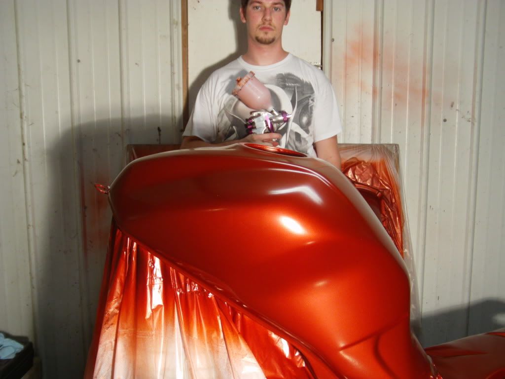

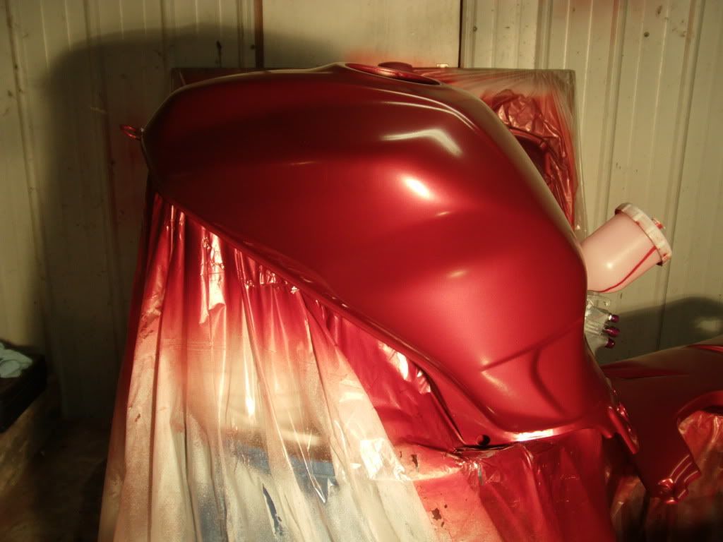

tank after spraying basecoat.
me behind the tank holding the gun i used(this shot shows the color better)

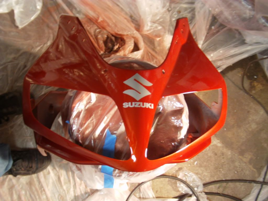

the front fairing after decals and clear

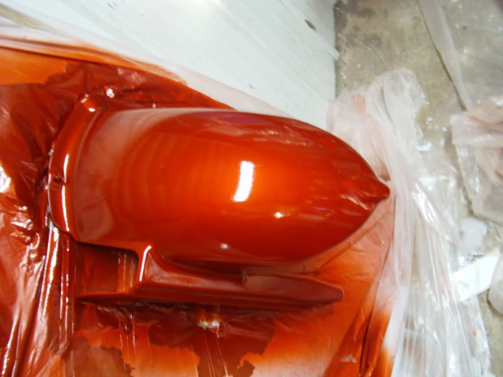

front fender, center for the tail, and rear hugger after clear
another of the hugger after clear

another of the front fairing, where you can see the pearl really pop in the light!

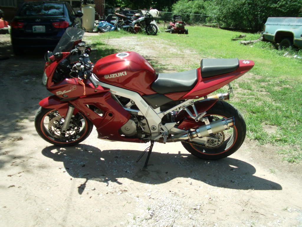

and here is the bike fully assembled! still hasn't been sanded or buffed. very dissapointing that it looks red in these photos! it really shows up a beautiful pearl orange kandy color in the light!

Nice looking bike and I love the color. Its to bad it looks red in the together pix. Props for taking all the safety precautions. The isos in the hardener is very bad for you when sprayed.

yeah i did alot of research and asked alot of people's advice. i even had a guy that has done painting for 28 years tell me i should start a side business painting bikes. i think i could have done better if i had a proper booth to paint in. and thanks for the compliment! i really enjoyed painting alot! it was more fun for me than work! and im really surprised how well the paint and clear layed down, cause i used a medium reducer and the temps got so hot in there i really should have had a slow reducer. next project i think ill experiment with some custom mixed pearls.

Great job on the paint. One question,what color base did you use? If it was Red that the reason for the red tint to it. Try a silver base before the orange.

oh i actually got rashed up pretty good! i swear i always wear my leather jacket and the one time i rush out the door and don't grab it this happens. got both my forearms got rashed pretty good, my left knee got rashed pretty bad, both my shoulders and my left side got rashed, and i bruised my hip good. as well as bruised my left thigh pretty good from my cell phone. thank god i had my helmet on, that is something i never compromise on! oh and as for the red tint. the earlier pics were taken with my Sony video cam and for some reason it doesn't capture certain colors right. the last ones of it wrecked were taken with my Kodak camera and they show the color pretty much how it looks in person. as for the base i just layed it over a light grey primer. I was gonna lay down white or silver first, but was running out of money and patience. it was nice riding weather and i'd had the bike for a few months in wrecked form as i built it up and wanted to get it on the road finally. this time around i will definitely use a silver first.
