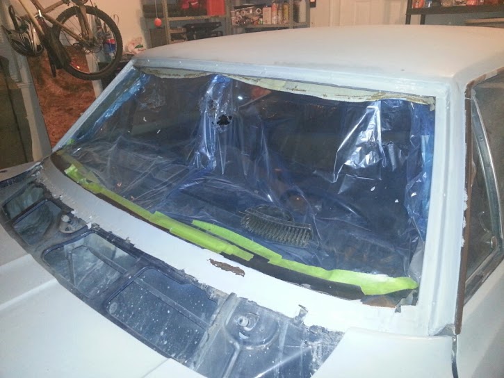

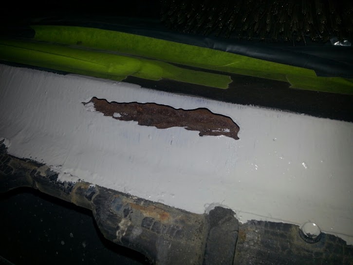

Last time I wrote I had pulled the windshield and started on the filler. I've done quite a bit more since then and we'll say I've got 3/4 of the filler work done. I've still got work to do on the driver side sail panel and front quarter. I'll let the pictures do the talking.
Freshly sanded windshield pinch weld.

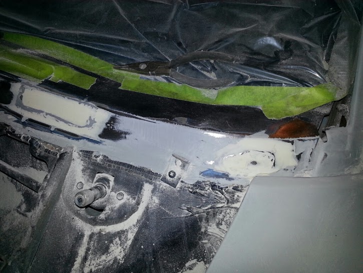

Freshly primed windshield pinch weld. Notice the ugly rust void about 5" long by 1" high near the driver side wiper arm motor.

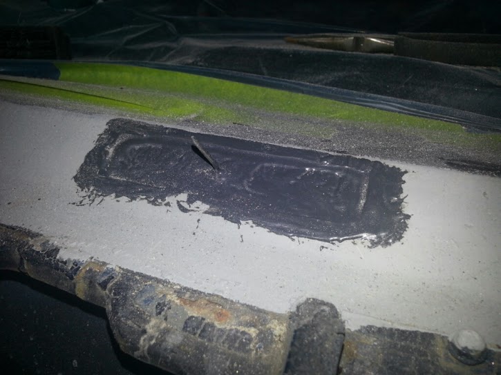

The void appeared as I sanded. I hit it with the grinder until the rust broke away and this is what I was left with, after primer.
I cut the void rectangular then cut a spare piece of my old quarter panel just a bit bigger than the void. I JB Welded a nail head to the face of the new piece, then JB Welded that piece into place behind the pinch weld. Then coated the face of the piece with JB Weld. The nail was there to give me a spot to clamp on to hold it in place. Now I can just cut the nail off and make it smooth with a skim coat of filler. Good as new.

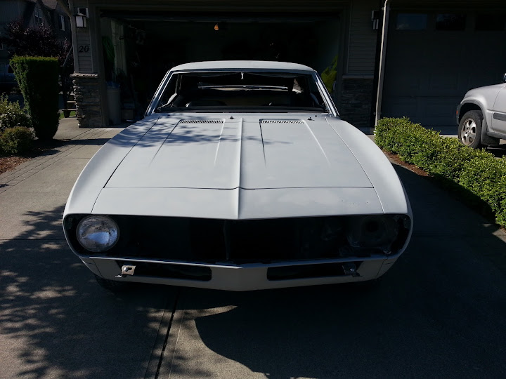

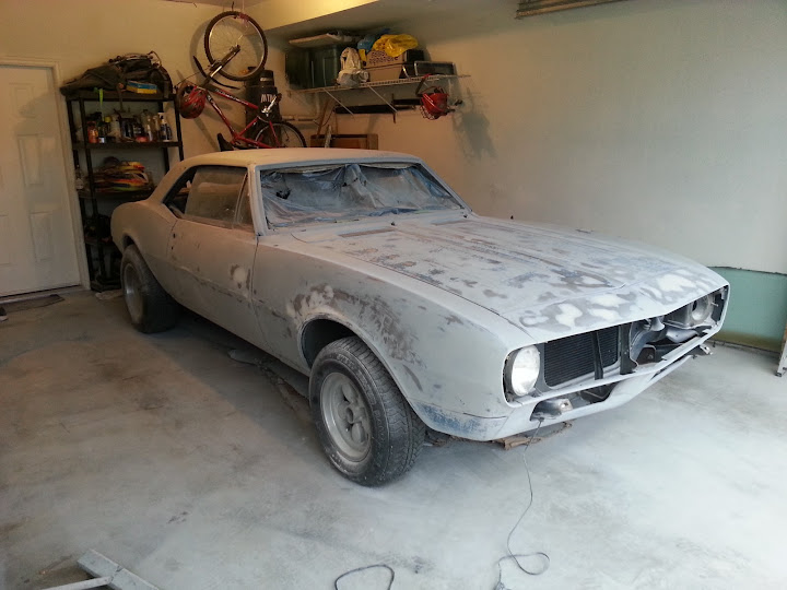

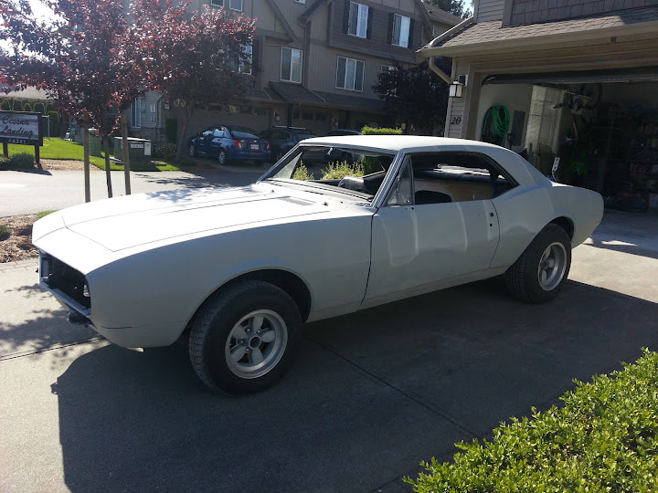

Still not painting yet but getting really close. The car is now fully back in primer and 95% of the bodywork is done. I was going to roll my new Rustoleum Filler Primer (yep, drove over the border and 2 hours into Washington to get some) but decided to use the rest of my Tremclad Rust Primer first. I hope you like pictures...

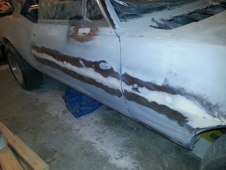

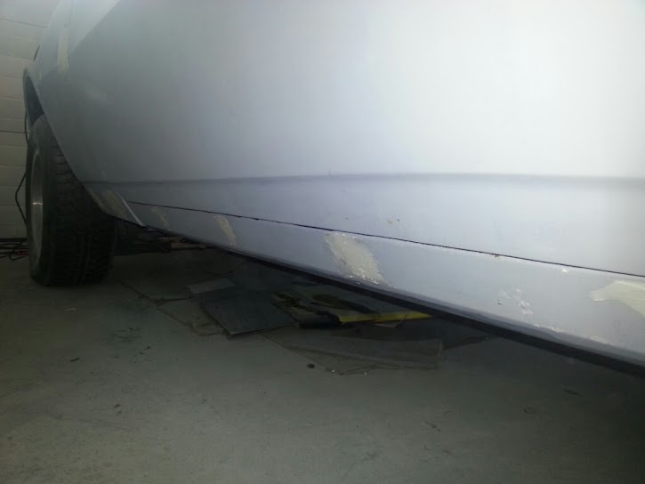

The passenger sail panel was quite a valley of weld spots but after several applications of filler, and what seemed like a never ending amount of sanding, it is ready for primer.
The passenger side of the car is ready for primer. The body line was skim coated and sanded pretty sharp.
The driver side body line wasn't as much work, and is ready for primer here.
The windshield pinch weld had that hole and other rust. I sanded the rust spot away and smoothed the JB Weld patch I made and applied some filler.
The driver side rear window seam was a tough spot. The quarter wasn't flush with the upper trunk panel so when I blocked it, I kept sanding too far and having to reapply primer. It's done now, but was time consuming.
The rear window pinchweld had a couple missing clip mount "nubs" that remained as small holes. I JB welded the holes and smoothed it with filler. All ready for primer here.

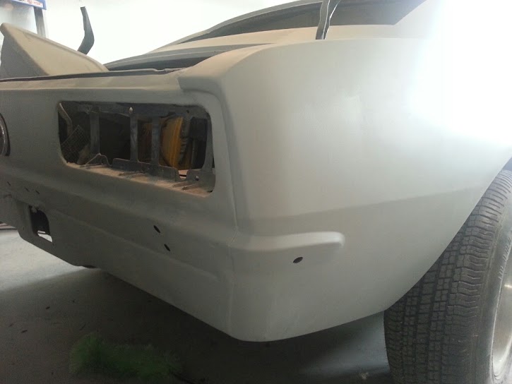

The tail panel seam wasn't too tough. It would have been a lot harder if I had decided to get rid of the visible seam. Still have a dent to fix to the left of the seam.

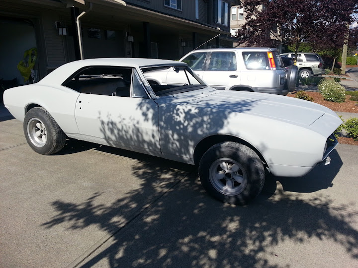

Two nights ago I rolled the Tremclad primer on only the areas that were sanded or went to bare metal. I'll probably do some light sanding on this primer and then roll at least 1 solid coat of the Rustoleum Filler Primer on before I start rolling black Tremclad. I want to scuff and spray the door cil plates and jambs before the filler primer too, so there is work to be done. Here are some of the results post primer...
The passenger side rear window seam primed well. I think the primer went on a little thin on the quarter panel side but overall its good until the Rustoleum Filler Primer is rolled.
The tail panel seam primed well. I'm happy with the result as this was one of the harder areas to make flush when the new quarter went on.
The driver side body line was almost flawless to begin with. It needs a good wipe down but it looks good otherwise.
The passenger side body line needed a full skim coat and a few extra layers of filler around some door dings. It actually turned out well but the line is too sharp along the door and will need to be rounded off ever so slightly during final pre-paint sanding.
The passenger side sail panel primed but has a small area that needs to be sanded (can't see it in picture).

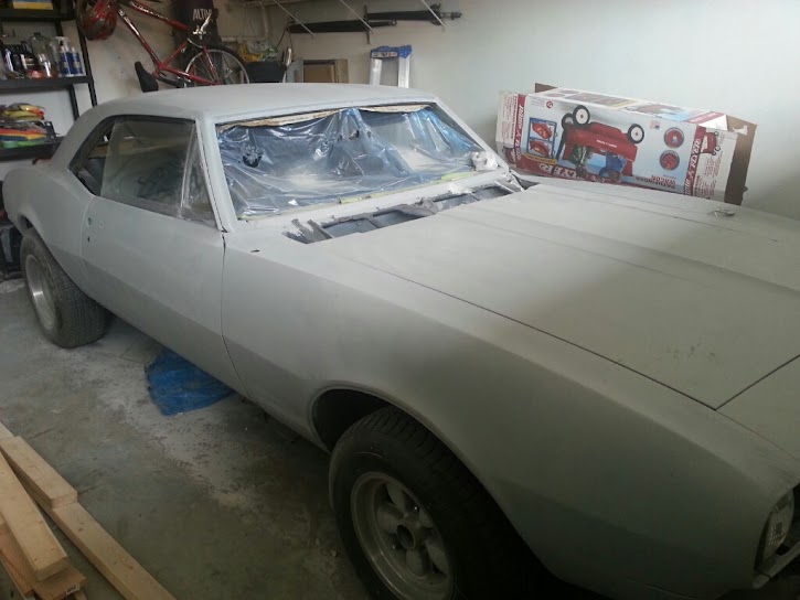

Tight space in the garage but it's worked so far. Clearly a great reason to roll and not spray.
Going to have to do something with that windshield and hood panel soon. The spoiler is waiting for some attention too.
I'm hoping to get the door jambs and other inconsicious areas primed and spray bombed before the middle of next week. If I have a lot of time I'll put a coat of the filler primer on as well, but that'll probably happen next weekend.

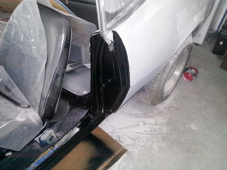

Tackled the tail panel dent, roof dent, door jambs, trunk weatherstrip area and cowl vent grille area. Doesn't sound like much but to repair the dents and prime/paint (Tremclad Oil Based grey primer & Tremclad Gloss Black spray can) the other parts it took almost 8 hours. I went inside for dinner and forgot to take pictures while there was good light. I snapped a few but they're not the greatest. Hah, don't mind the mess in the garage/interior.
I wanted to get a good clean finish right in where the trunk weatherstrip goes, as well as the lip there. I also sprayed the trunk hinges while I had them. That mask/tape job was time consuming.
The results were just what I wanted. My masking failed in a couple spots but it'll sand off easy and now I have something for the weatherstrip goop to stick to.
Driver side door jamb. Took quite a few boxes, cut just right to prep these jambs for paint. I ended up doing the jamb, sill plate, hinge area and the inside edge of the door. Unfortunately my pictures don't capture the door, but you get the idea.
Driver side sill plate and hinge area. Obviously I didn't waste paint on the inside face of the door as the door panels will cover them.
Passenger side door jamb. I taped off the door lock striker as the black would eventually get scraped off by the door and that would look ugly. I'll probably clean them up and just leave them be.
The passenger side sill plate and hinge area. Turned out as good as the other side, the Tremclad spray paint seems to go on quite thick and leaves a nice gloss.
I apologize again for the picture quality. I used a "contractors grade" matte black spray paint under the cowl grille panel as I didn't want it to look glossy through the cowl grille slots. I didn't spend a lot of time masking/taping as it's going to be covered.

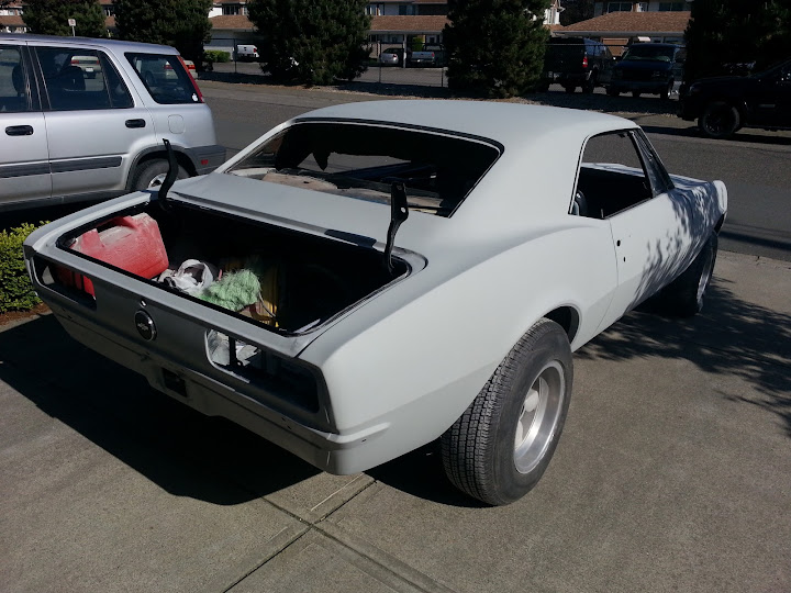

I decided to clean off the car (with a final coat wipe solution) and start rolling the Rustoleum Filler Primer...
...but I was really suprised to see how thin the primer was. It's the consistancy of milk and I found that it just soaked into the roller and didn't seem to roll very well. I tried to lay it on thin but when I tried to roll over edge lines, the primer started to ball up and turn into little clumps. Almost like peeling back a layer of dead skin....
I tried shaking the can for a few minutes, thinking that it might have settled, but it seems to me like it's just very thin, and dries very quickly, and rolling over it is just not a good idea.
Does anyone have any experience with this, or any suggestions/tips before I continue?
***UPDATE***
I did some reading on this filler primer and have realized that I should have read the application instructions a little closer. The product is thin, but dries thicker and demands a re-coat time of 5-10 minutes. So I need to roll it on quick and smooth, and re-coat the areas that need it. I'll just have to block sand out any roller lines, instead of rolling over the partially set primer. My main concern was that the ProForm solvent I was using to do my pre-cleaning wasn't compatible, but I think I was just treating it too much like the Tremclad Primer I've used on previous coats.
Re: 67 Camaro - Black on Black
Post by cac1967 on May 19th 2013, 12:36 am
Ian, the rusto auto primer is laquer based, from your pic's it look's as if the rusto primer may have reacted with the tremclad.
Post by Ian67 on May 19th 2013, 4:33 pm
cac1967 wrote:Ian, the rusto auto primer is laquer based, from your pic's it look's as if the rusto primer may have reacted with the tremclad.
Yeah I think you're right. The Tremclad primer is an oil based primer and like you said, the Rustoleum is lacquer. Several forums say this combo is a bad idea as lacquer runs hotter and can cause all sorts of adhesion problems.
I wish I wouldn't have jumped the gun on that primer and researched it better first. I could bought 2 quarts of the Tremclad primer for the cost of the Rustoleum one. I guess I can save it for a future lacquer paint project. I wonder if anyone sells a high build roll on oil based primer around here :-\
Edit: the Tremclad can says "do not coat with laquer based products..." in the fine print. I really needed to read up in things before I blow my limited budget on things I can't use.

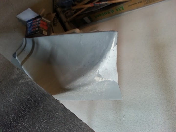

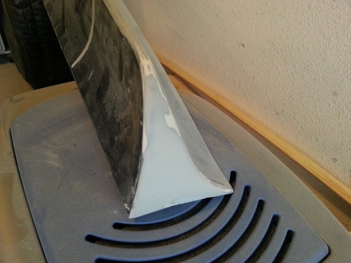

Today was a day of progress. Probably another 6-7 hours in, and I managed to repair the spoiler and finish dry sanding the car. Put a good hour or so into cleaning the garage, but still a lot left to do in there. Here are some pics of the spoiler:
When I sanded it years ago I took a chunk off the side.
Slapped some Might Putty on it and shaped it by hand a little.
Applied some filler and sanded it smooth. Still needs a coat of primer before paint.

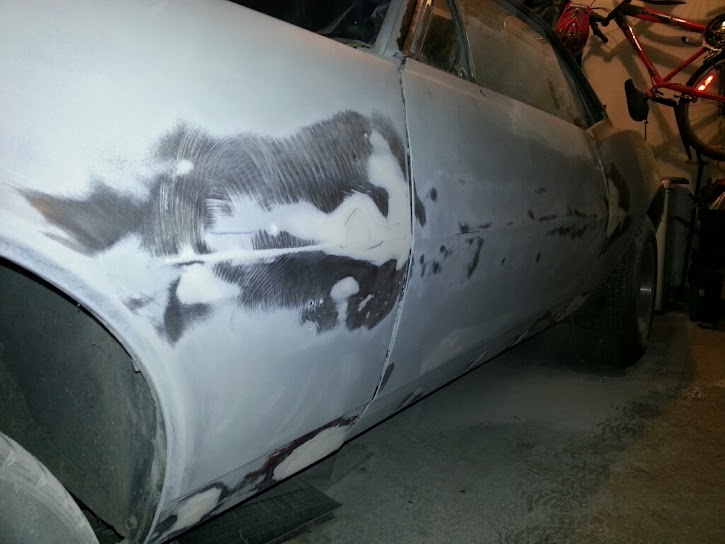

So, I decided to stop screwing around (like I did when I started the trunk lid) and really block it down. Before today, I did a little selective blocking here.. and there... but over the last day or two I buckled down and sanded it as smooth as I could. I had to apply a lot more filler as I found a ton of spots that were low. I cracked out the hammer and dolly in a few spots too, it was a bodywork day to be remembered. Less words, more pictures:
Lots of blue, filler and primer now. But I can't get it any smoother with 220g.
I thought the driver side door was straight... how wrong I was.
I'm not sure why I left that headlight in. Maybe so I could remember how to install it.
Tail panel has a big dent that I filled a bit, but I couldn't fix it fully without dropping the gas tank, and that's not going to happen this time around.
The roof was a pain. I had to get the ladder out to reach the middle.
Driver side sail panel turned out good. That quarter overlap it had really concerned me but I'm happy with the results.
Not the clearest pic but the quarter panel seam is officially gone. It's probably the thickest area with filler.

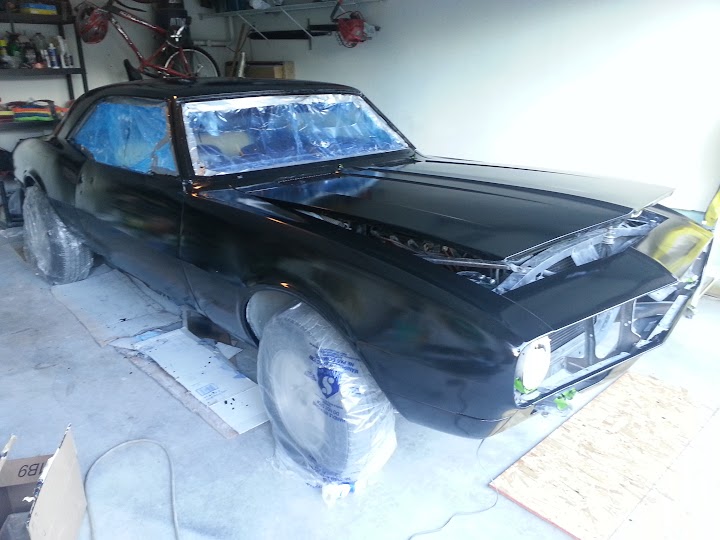

Post by Ian67 on June 8th 2013, 12:14 am

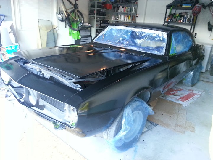

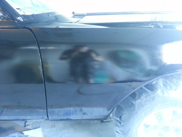

I've rolled on coat #1 and #2 over the last few days. It looks good but I've noticed a few minor flaws in my bodywork, I blame the black paint, and yes.. you told me so Wink
I used a tack cloth to wipe off the car before each coat. Roller stored in a zip lock bag and used for both coats. Mixture is 55% paint / 45% MS.
Coat #1 - First full coat finally rolled and I'm surprised by the coverage.
Coat #1 - Looks like a dent in the door... it isn't. I used a small foam wedge brush to do the drip rails and other tight spaces.
Coat #1 - Hard to believe there was once a big seam here from the new quarter panel. Happy with the results so far.
Coat #1 - Front quarter shows some of my re-sculpted body line and wheel well lip. Can't see any issues... yet.

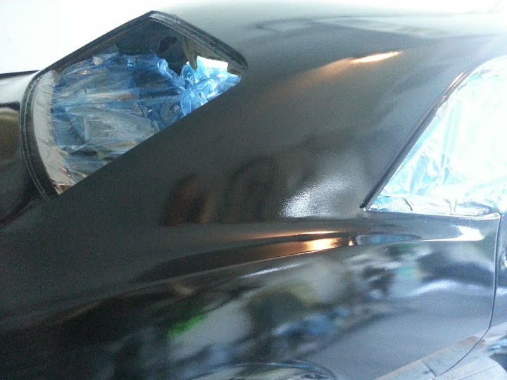

Coat #2 - Coverage is about 90% now. A little thin in some spots but you can already see how deep and shiny this black is.
Coat #2 - This side of the car looks mangled, but it's just reflections playing tricks. The spoiler is off to the side but I've forgotten to snap pictures of it.
Coat #2 - Great covereage here but check out that orange peel. Good thing the 400g wet sanding is coming next.
Coat #2 - Going to use this spot as a guage of paint clarity and reflection. You can see me, but not very well yet.
So, If I decide to fix any small dings or low spots, should I just sand the spot with 220g, apply filler, sand the filler smooth, and start Coat #1 & #2 in that spot? I'm not against putting paint right on filler at this point, but will filler on top of paint be an adhesion issue?
Plus, my last question, do I just use the small wetORdry sponge block to wet sand now, or do I want a bigger one?
